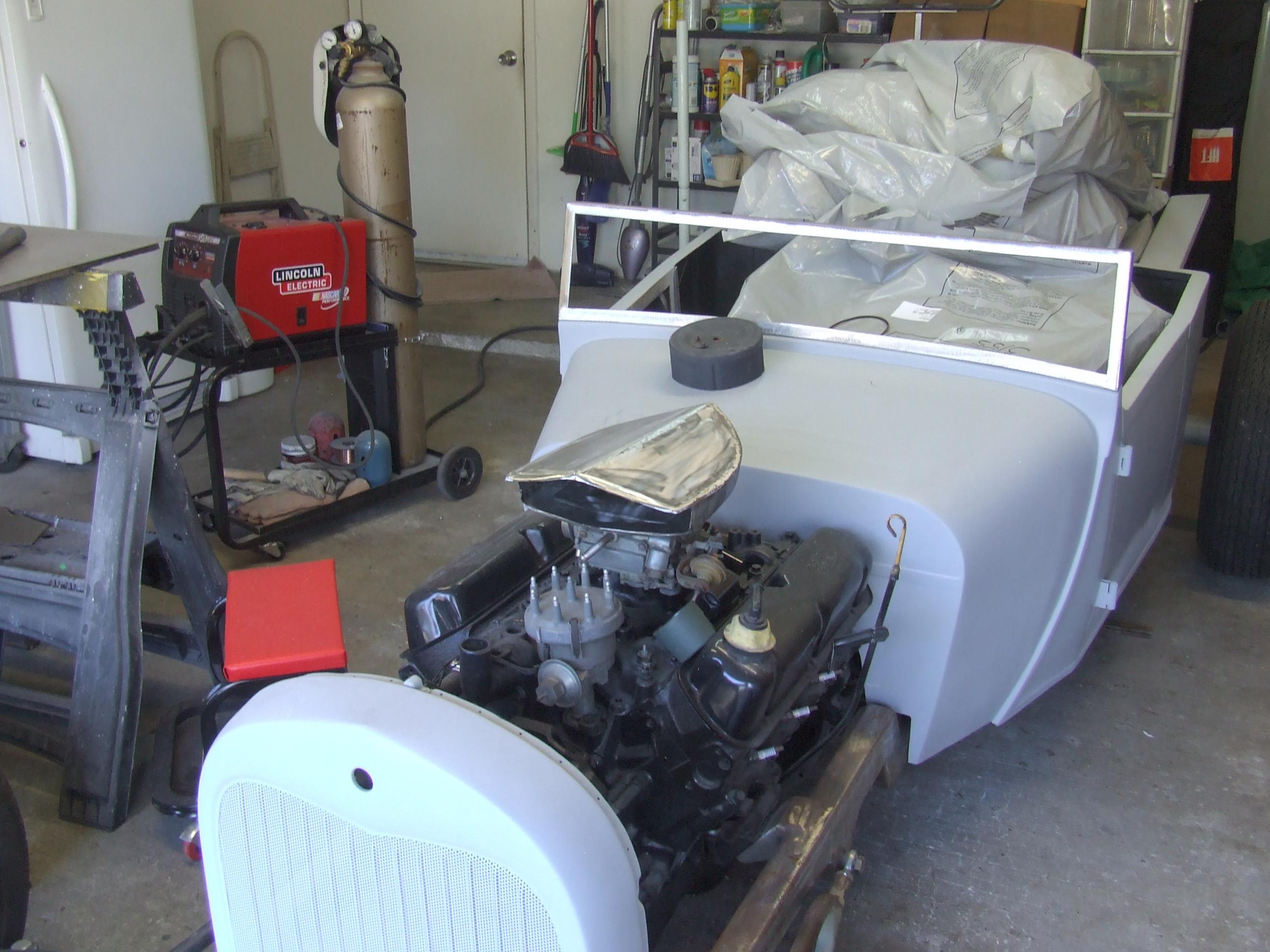

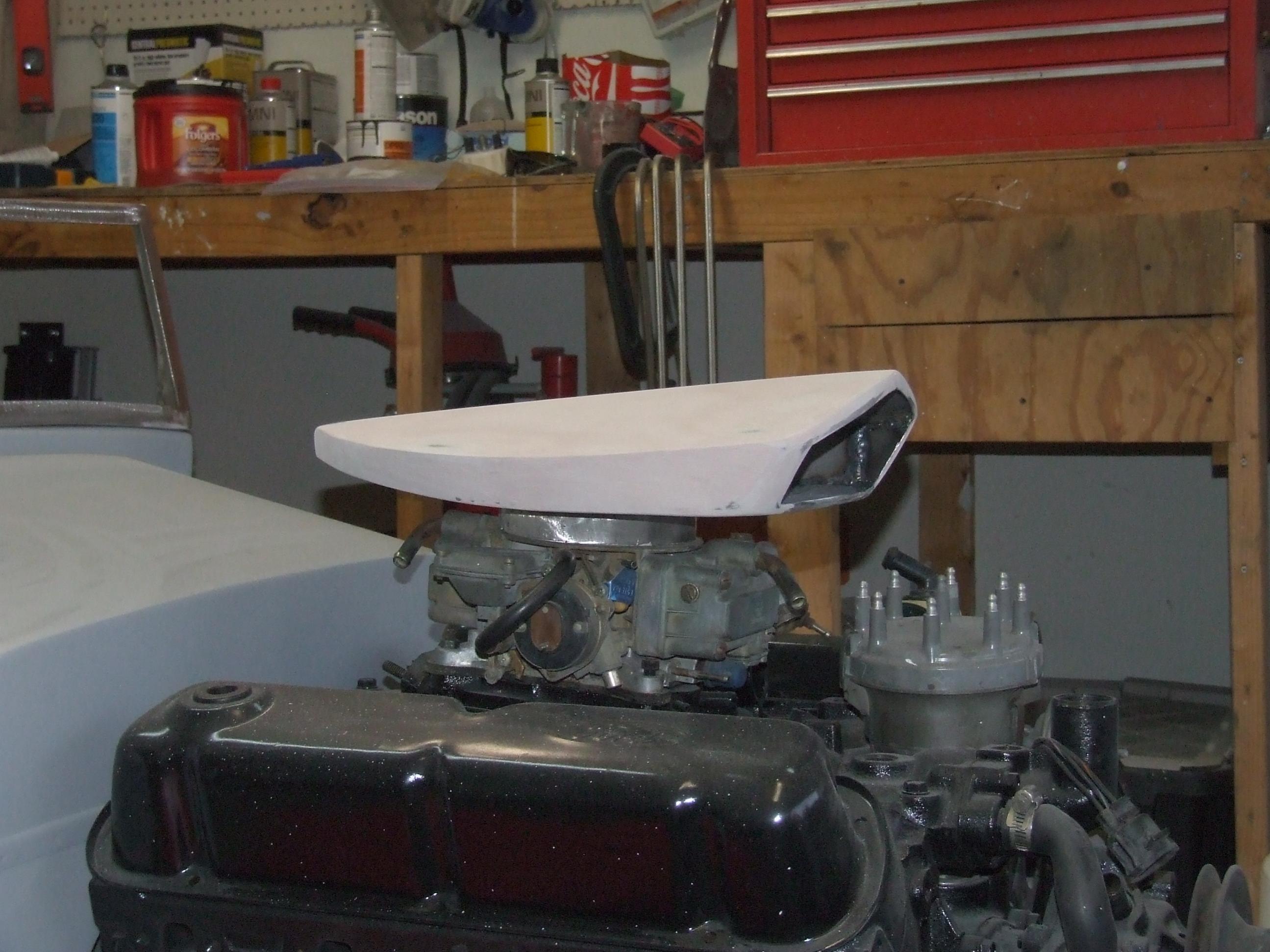

    Hey guys, its been a while but finally had sometime to work on the rod. I built an old school air cleaner and am almost finished just have to prime it.

    Great Job on the Air Cleaner!!!

    from louisanna
    Thanks! just wanted something different.

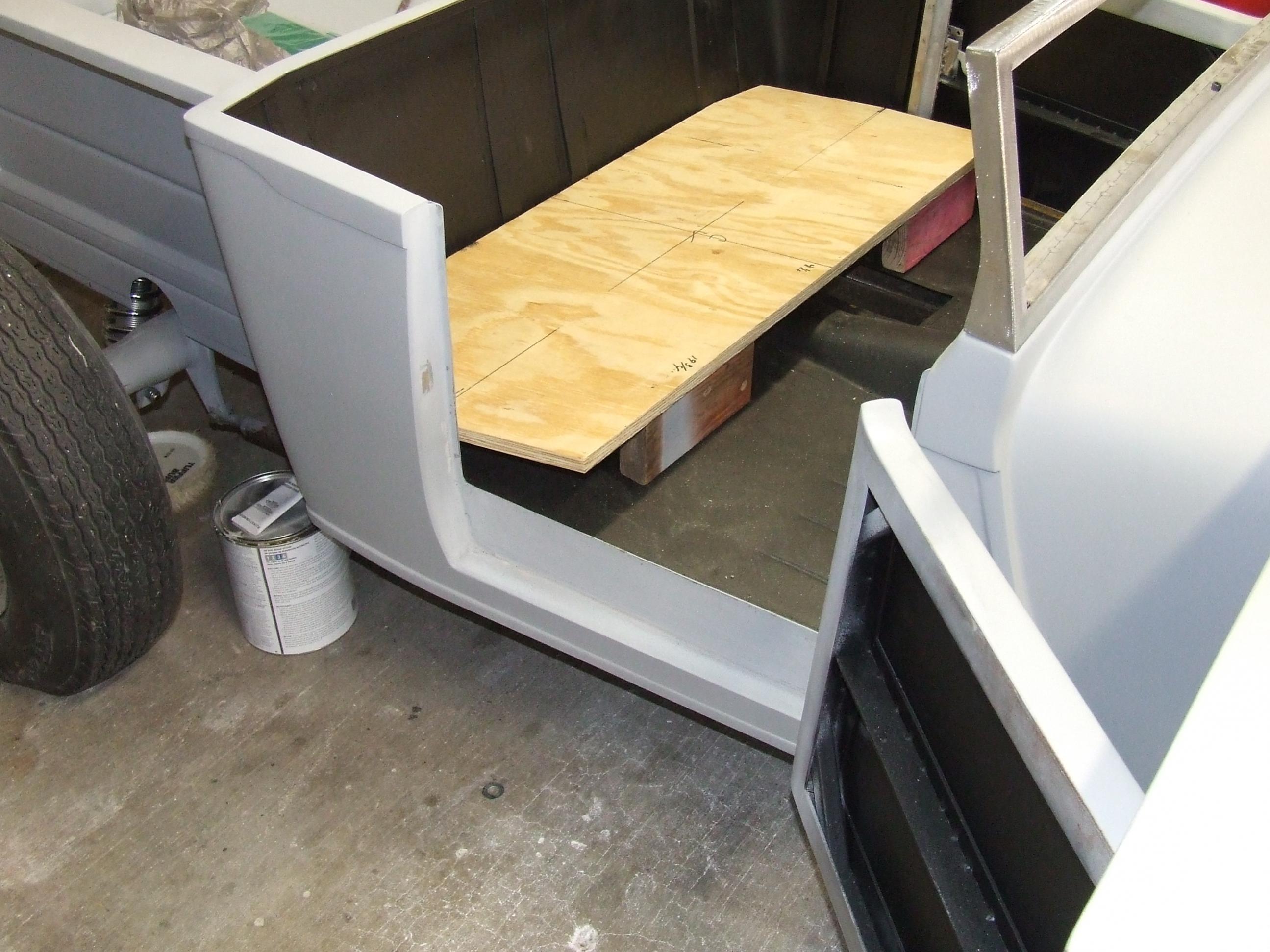

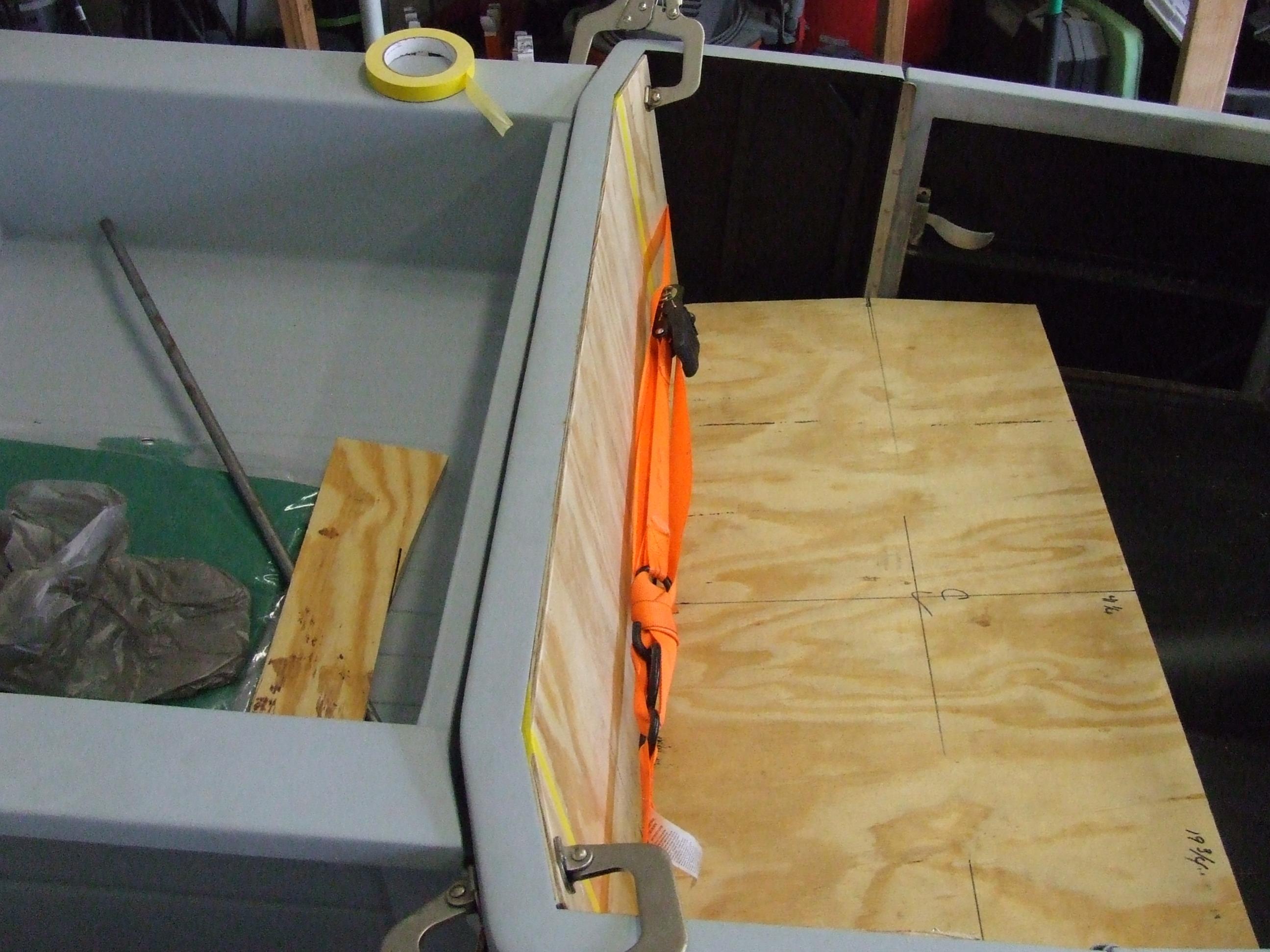

    Hey guys had a little time this afternoon and started cutting the plywood base for the seat and marking out the top portion of the seat back. here's a couple of pic's!

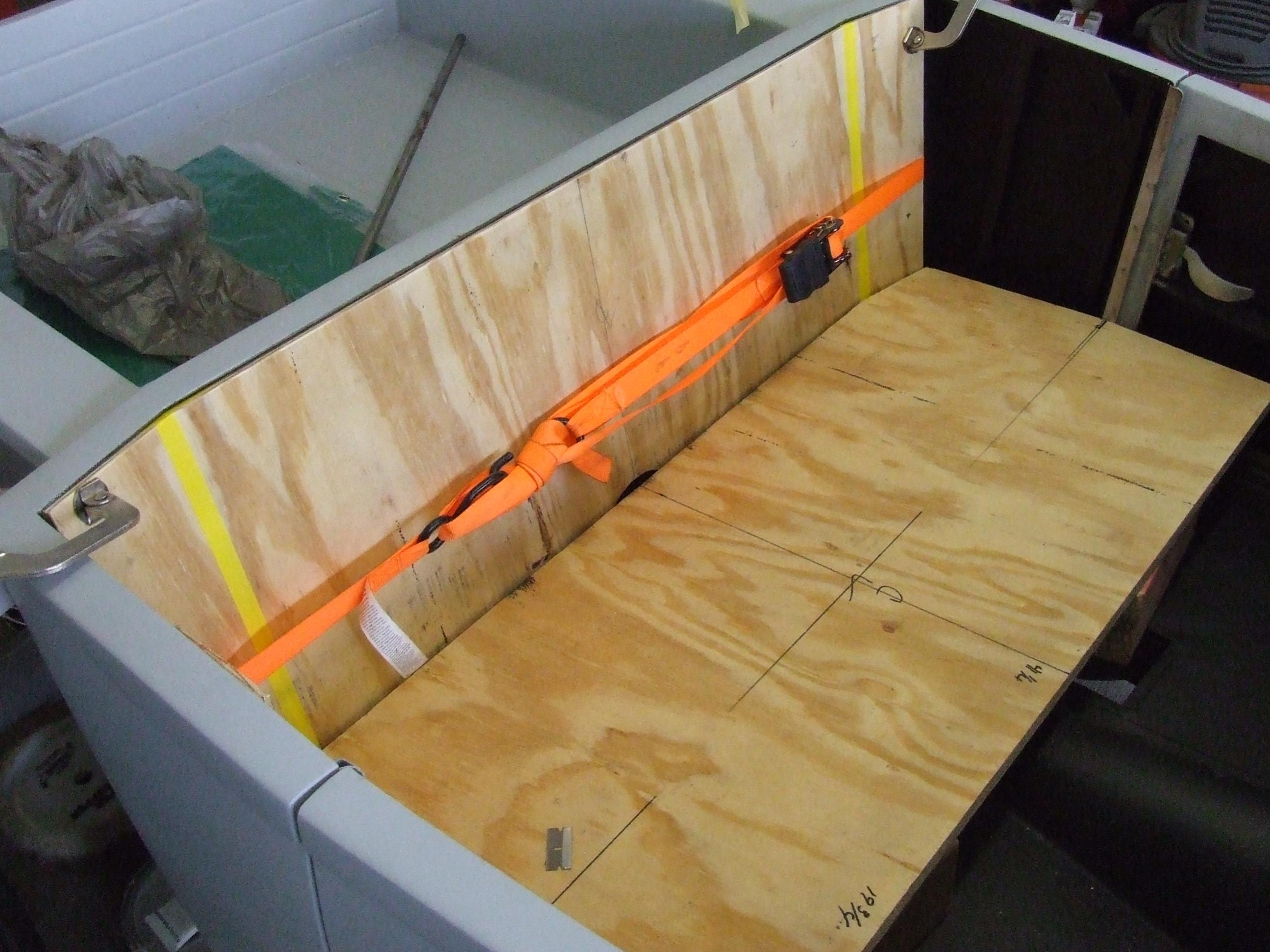

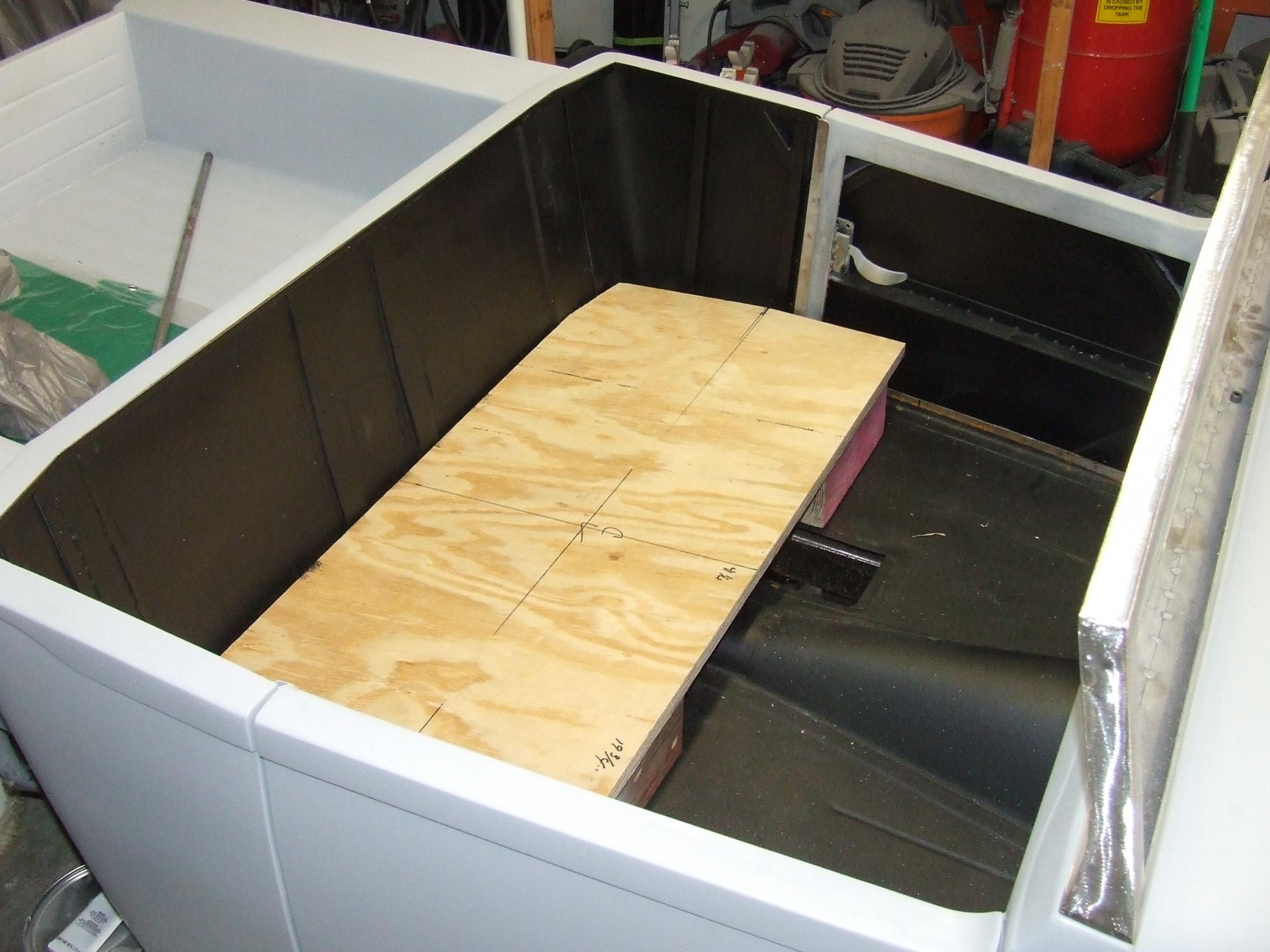

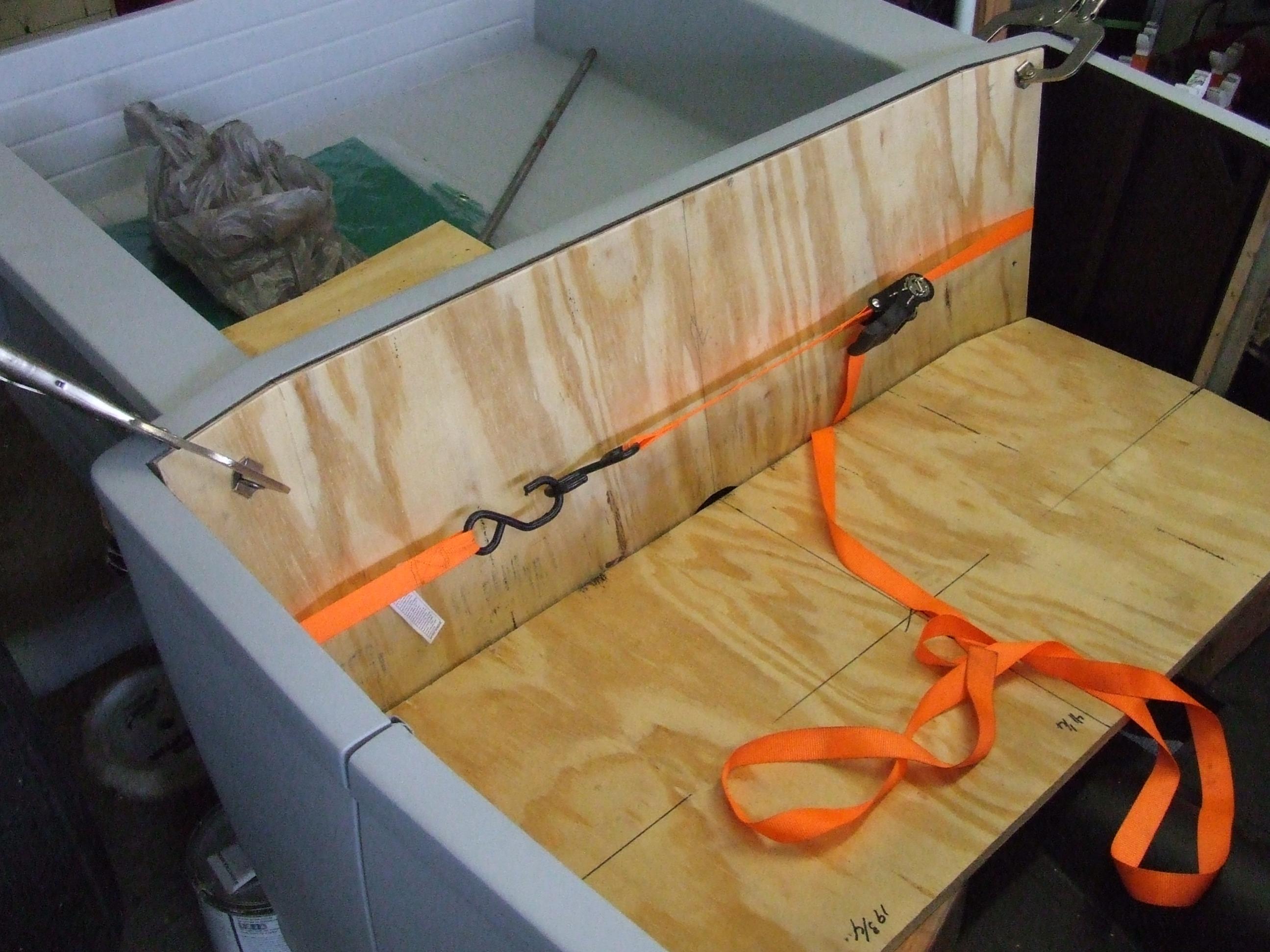

    Hey guys, built the base and back for the seat had to slice the back to match the contour of the rear panel and built the underside of the bottom seat still have to cut out the center of the base to install webbing prior to gluing the foam on. Here are a couple of pic's!

    Oops missed one!

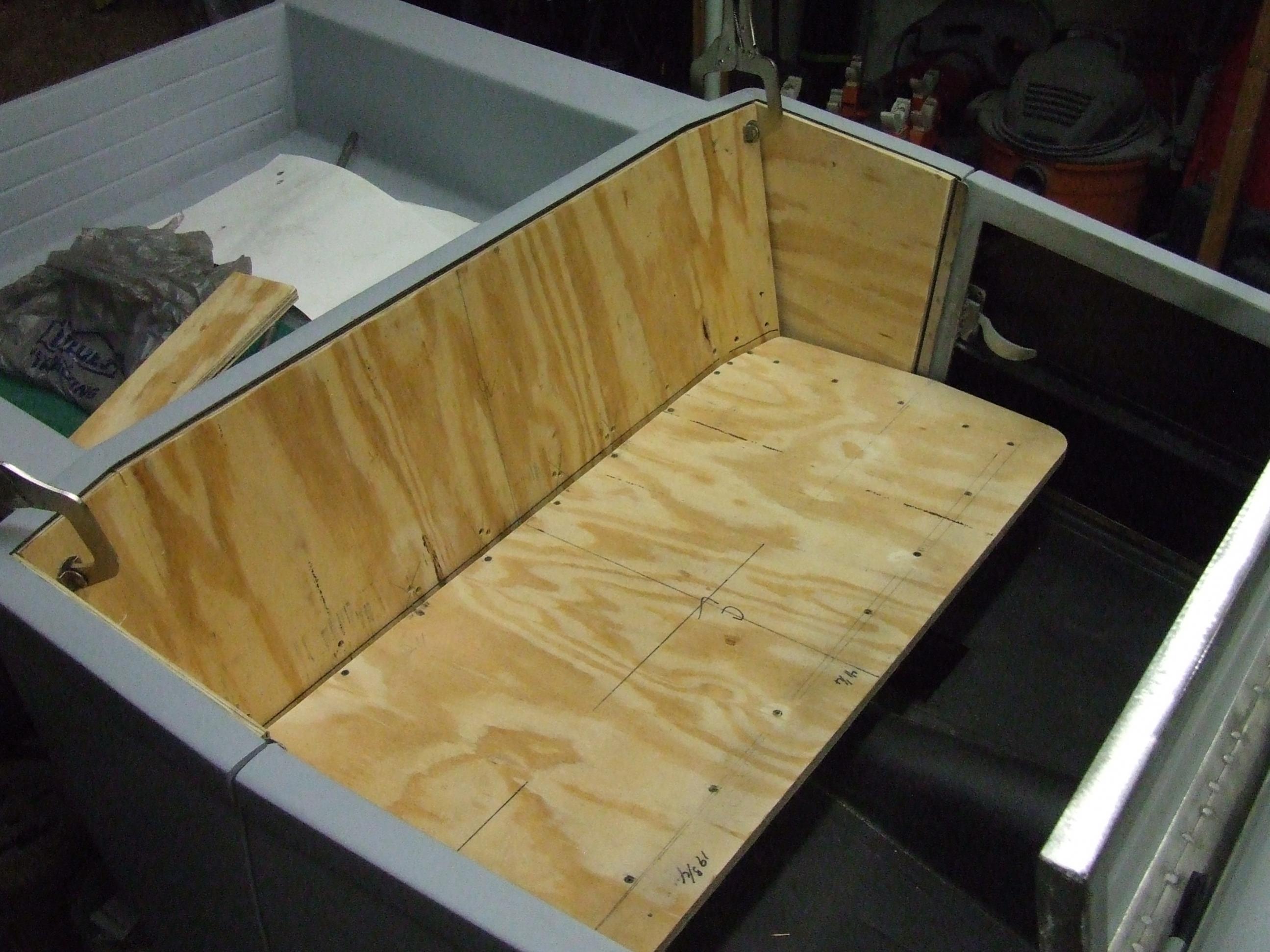

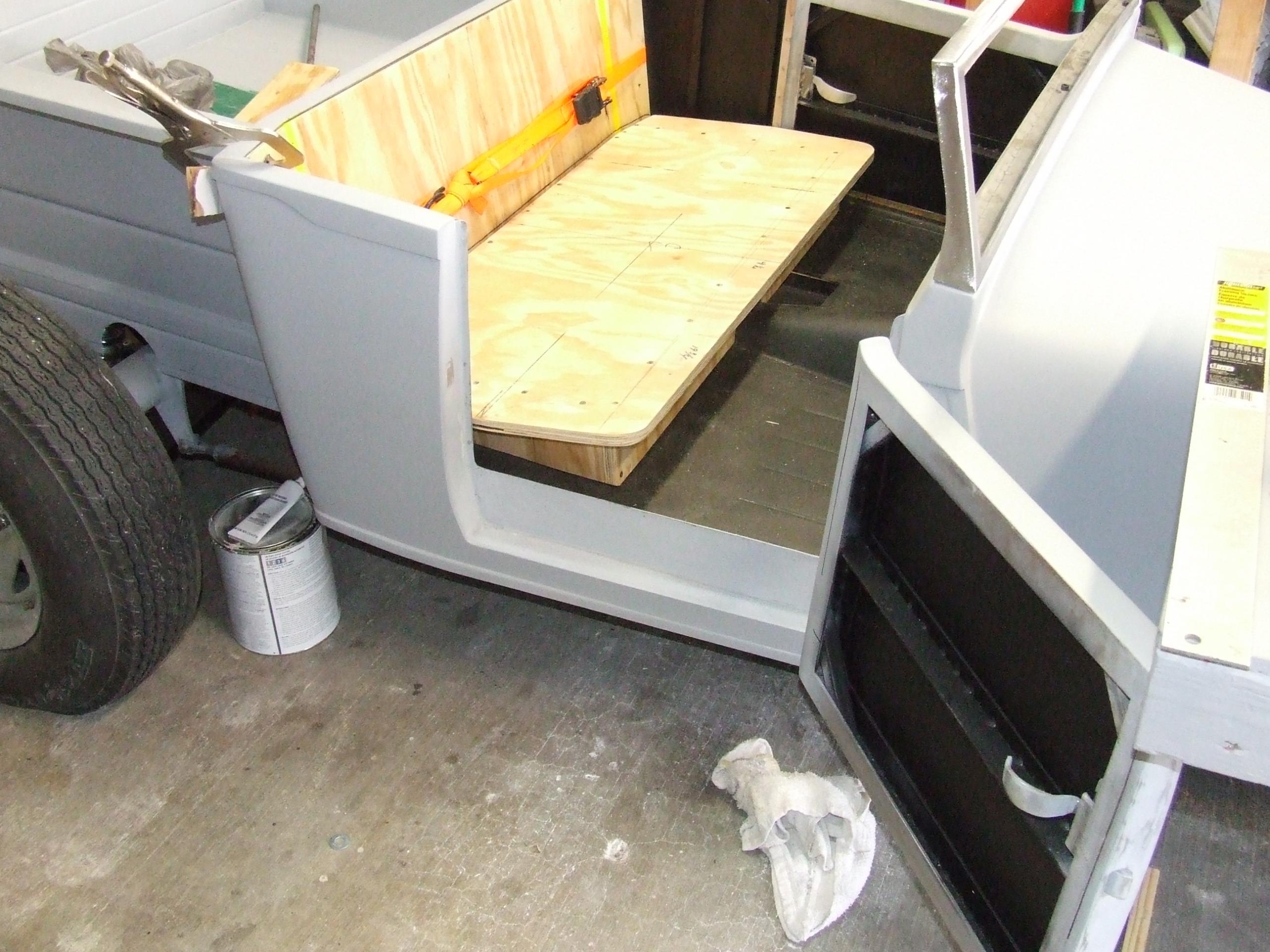

    Hey guy's finished the foundation for the seat as well as the rear panels all that is left is the door panel and the left and right side panels at the cowl. Here's a pic.

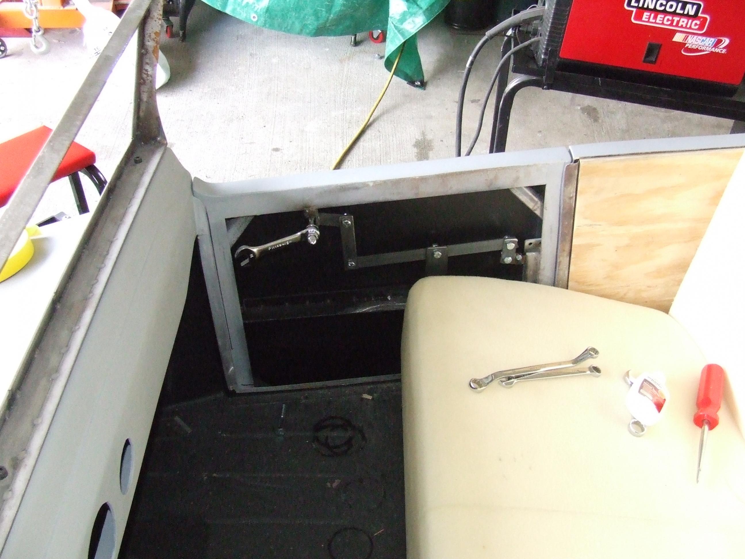

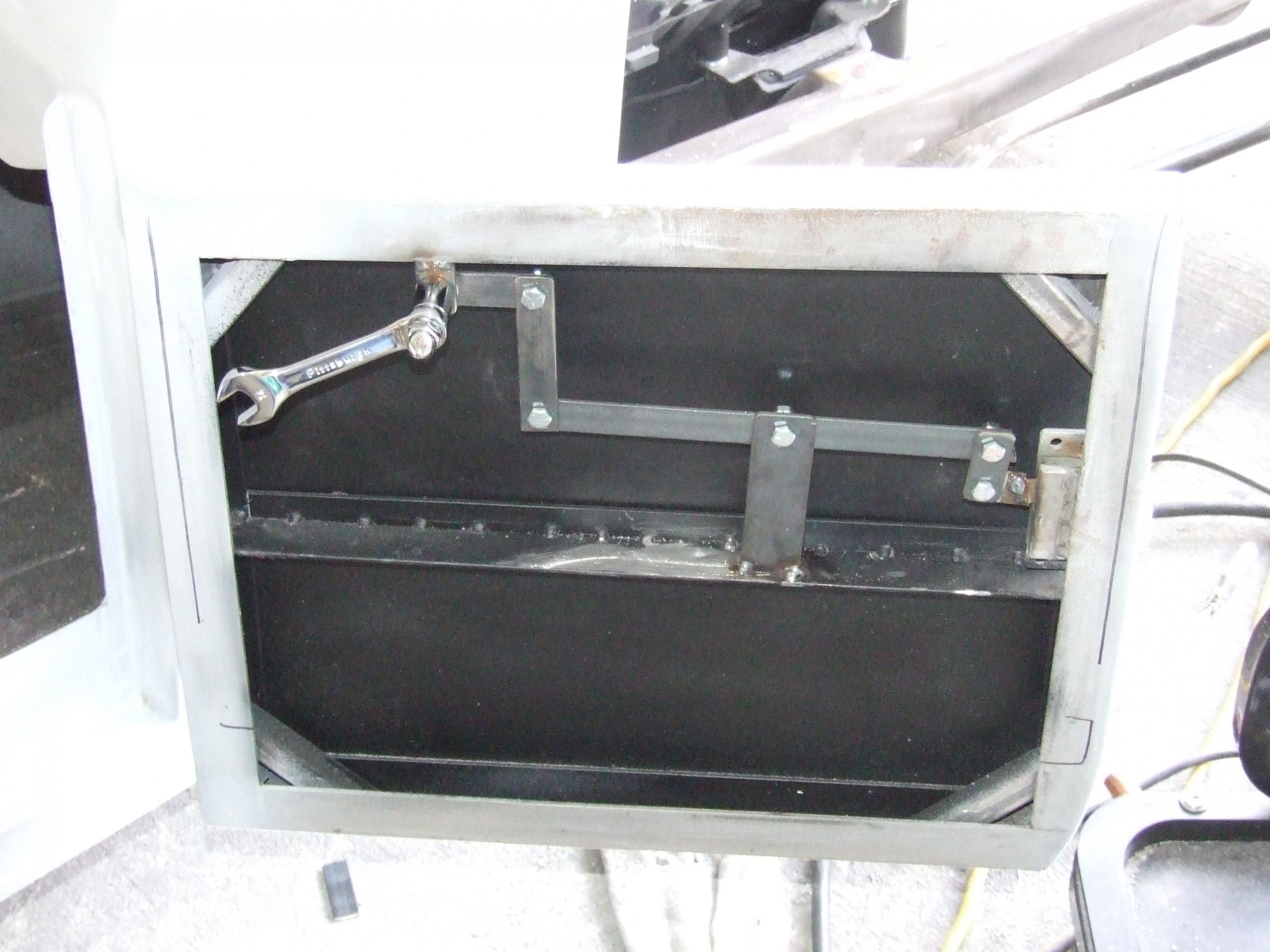

    Hey guys, once the seat was built the door latch handles were to far back so I designed and built my own bell crank system. Here are some pic's.

  30. CoronetRTguy
    Joined: Dec 26, 2012
    Posts: 826
    CoronetRTguy
    I like how you did the doors, that is just awesome. This whole project has been awesome from the get go.
