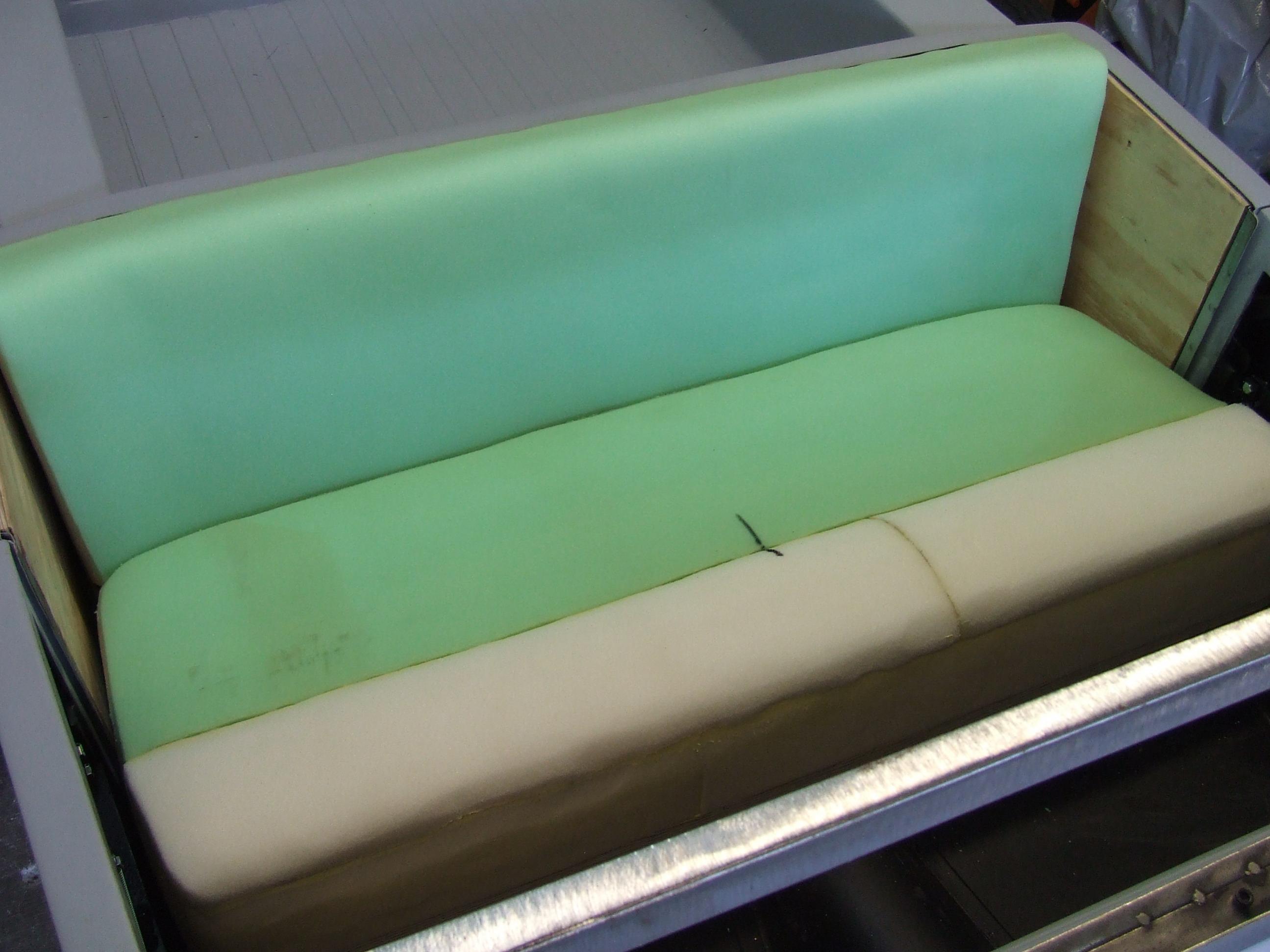

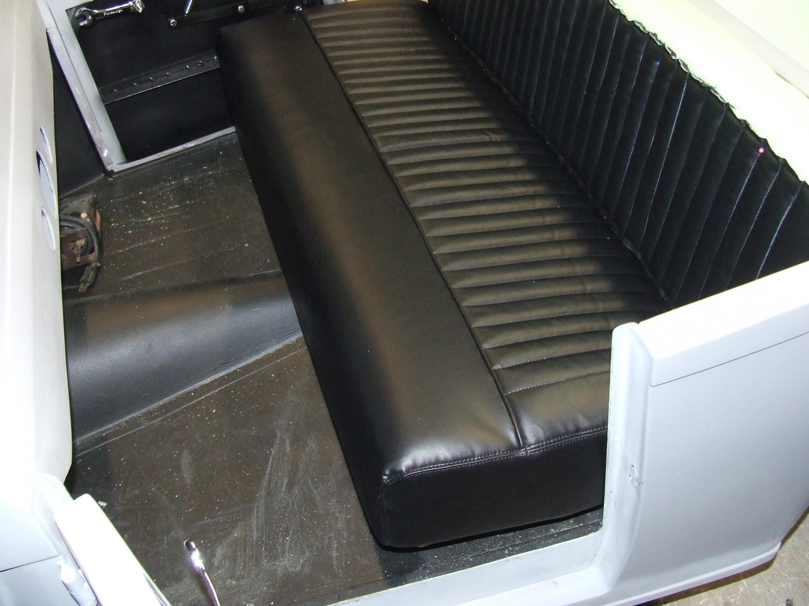

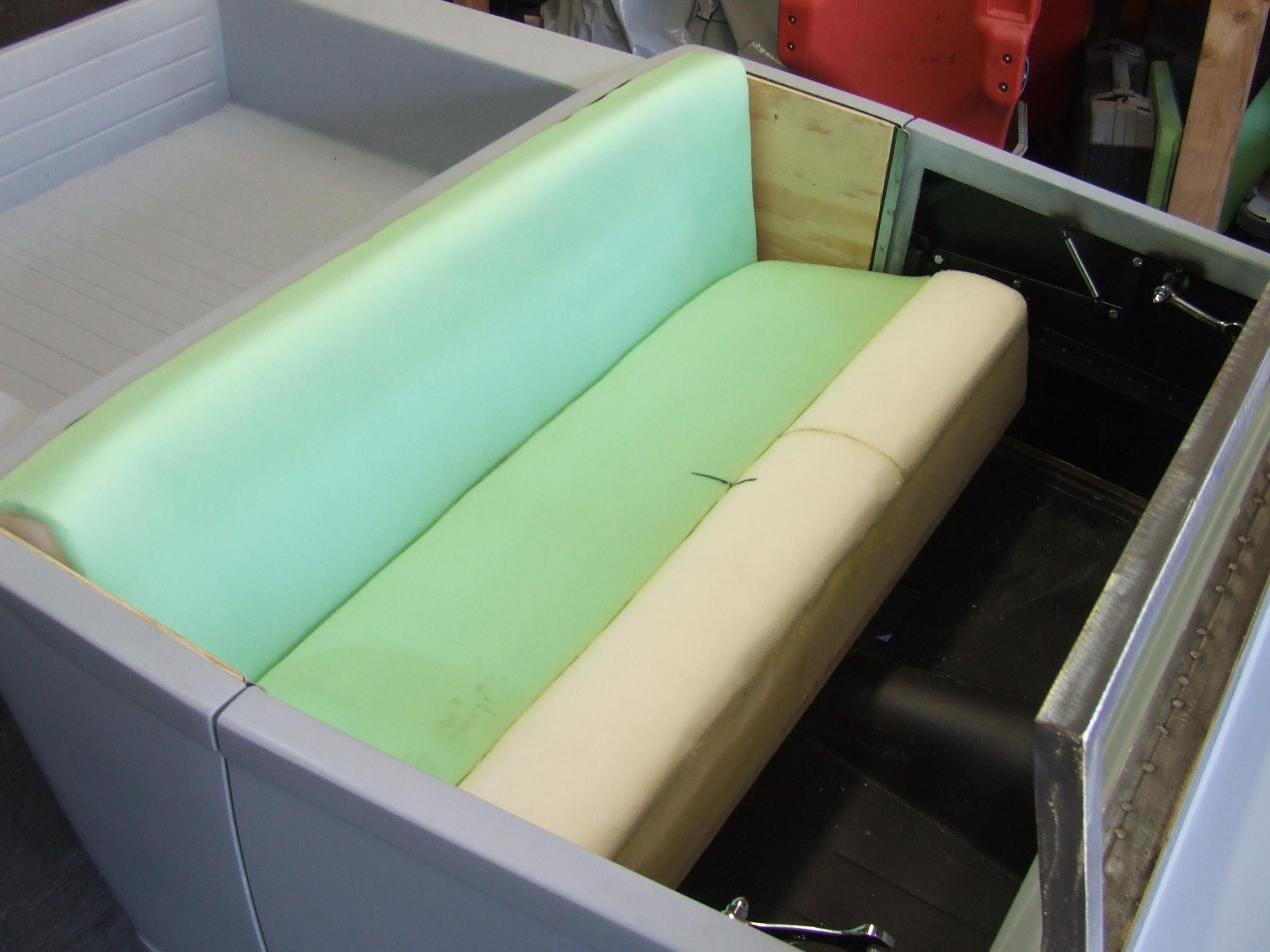

    Finished making the seat to the final shape' next is buying the materials to sew the covers. Here are some pic's

    Great job on seat!

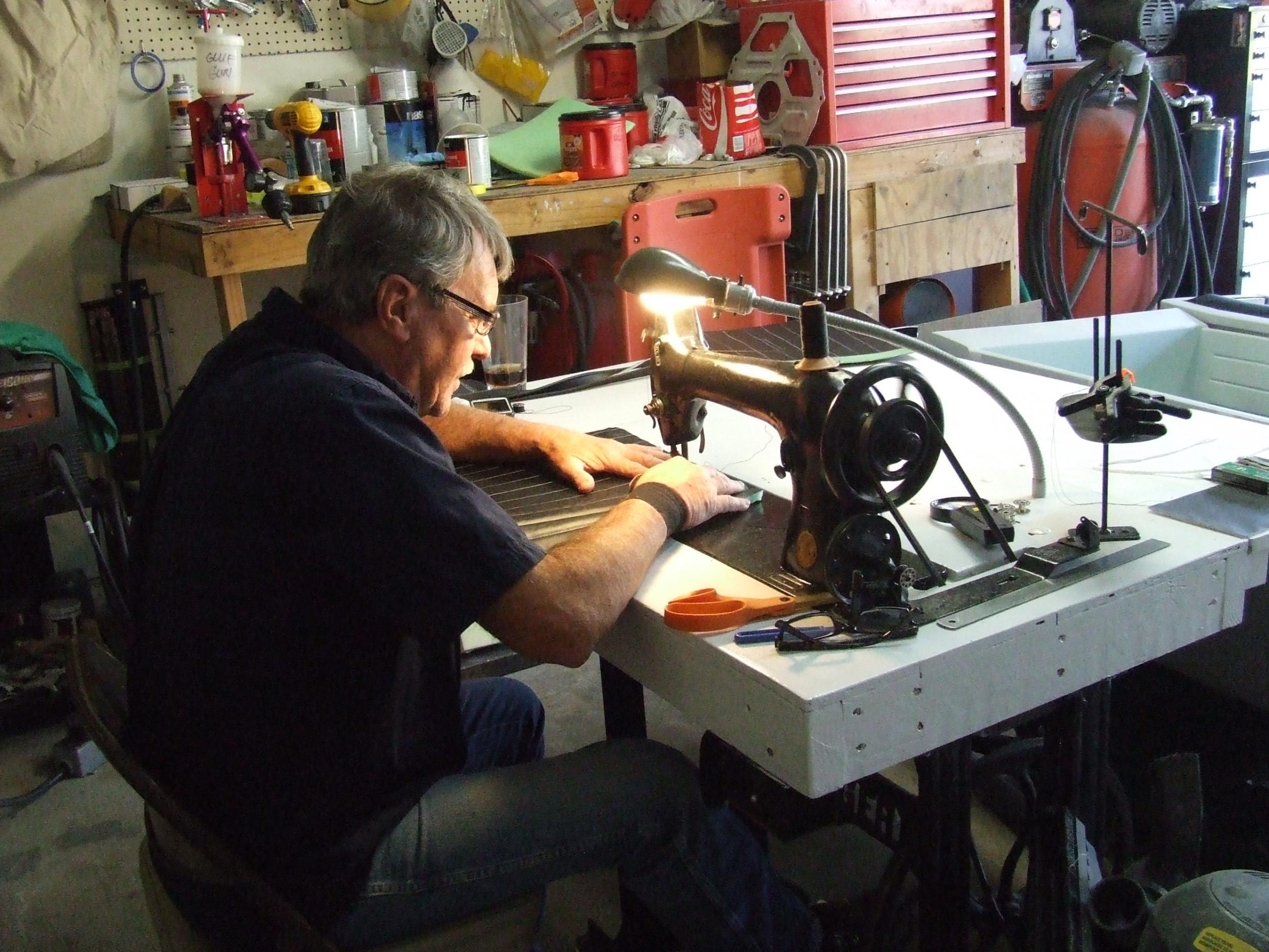

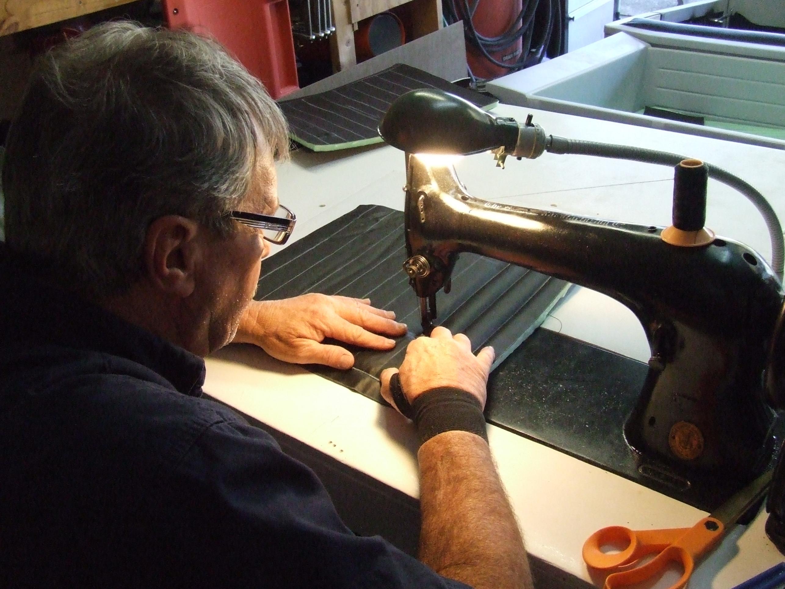

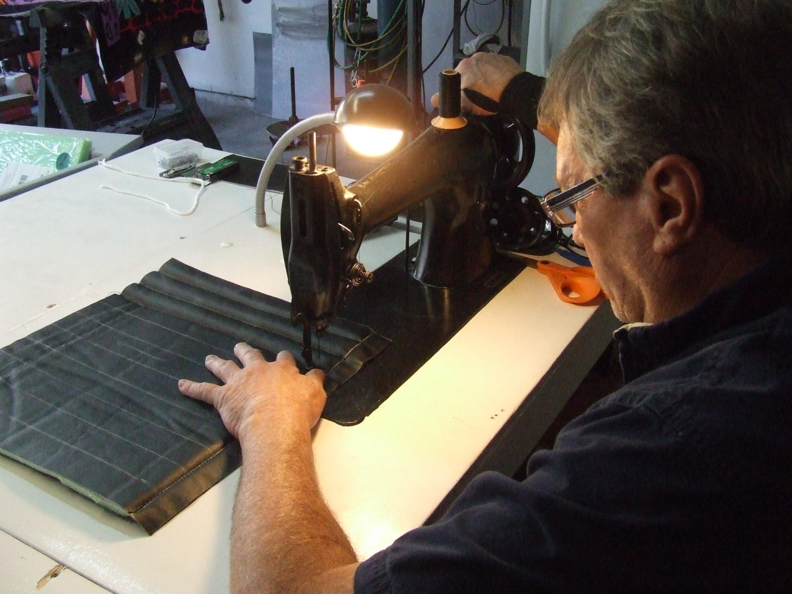

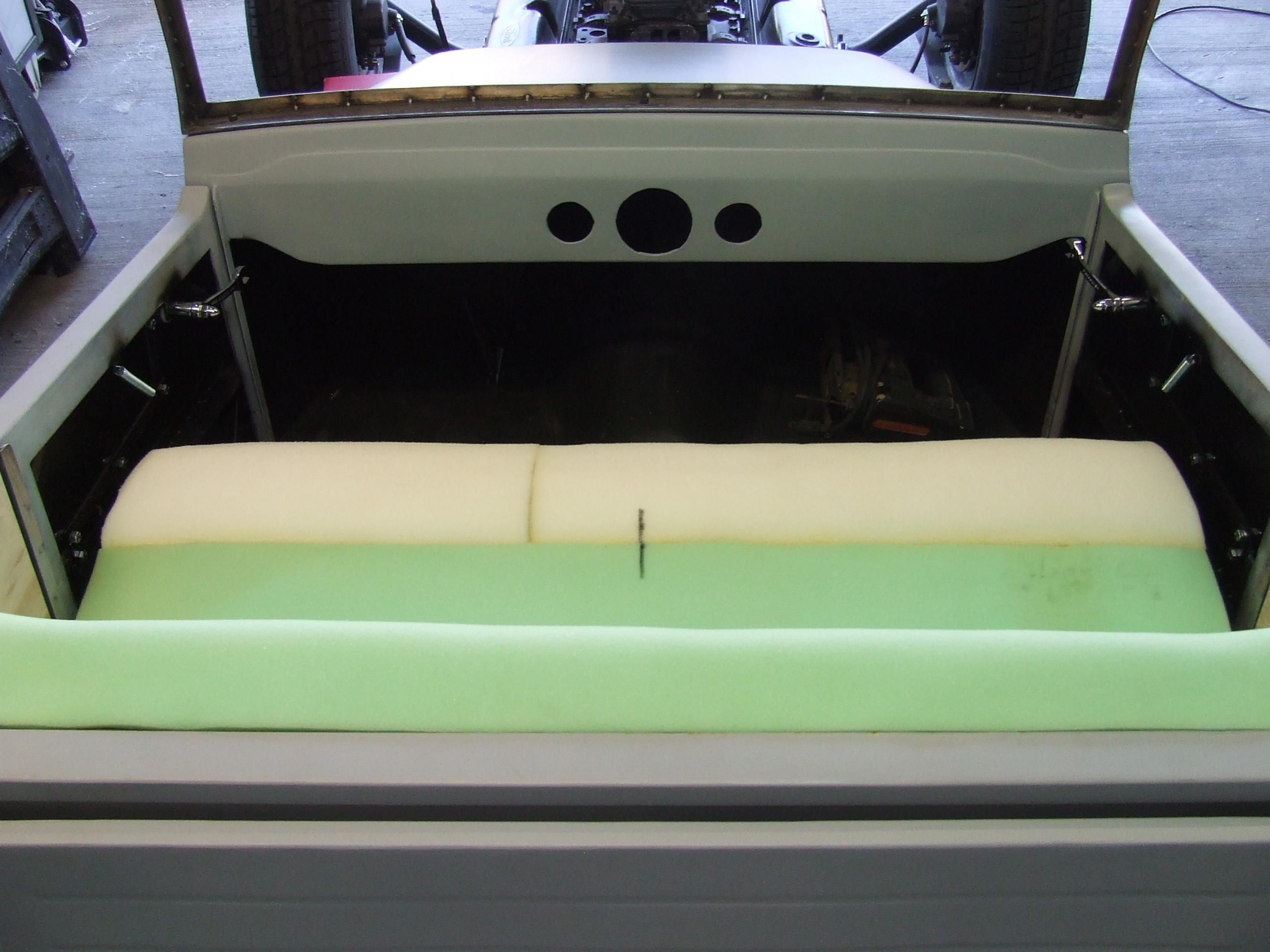

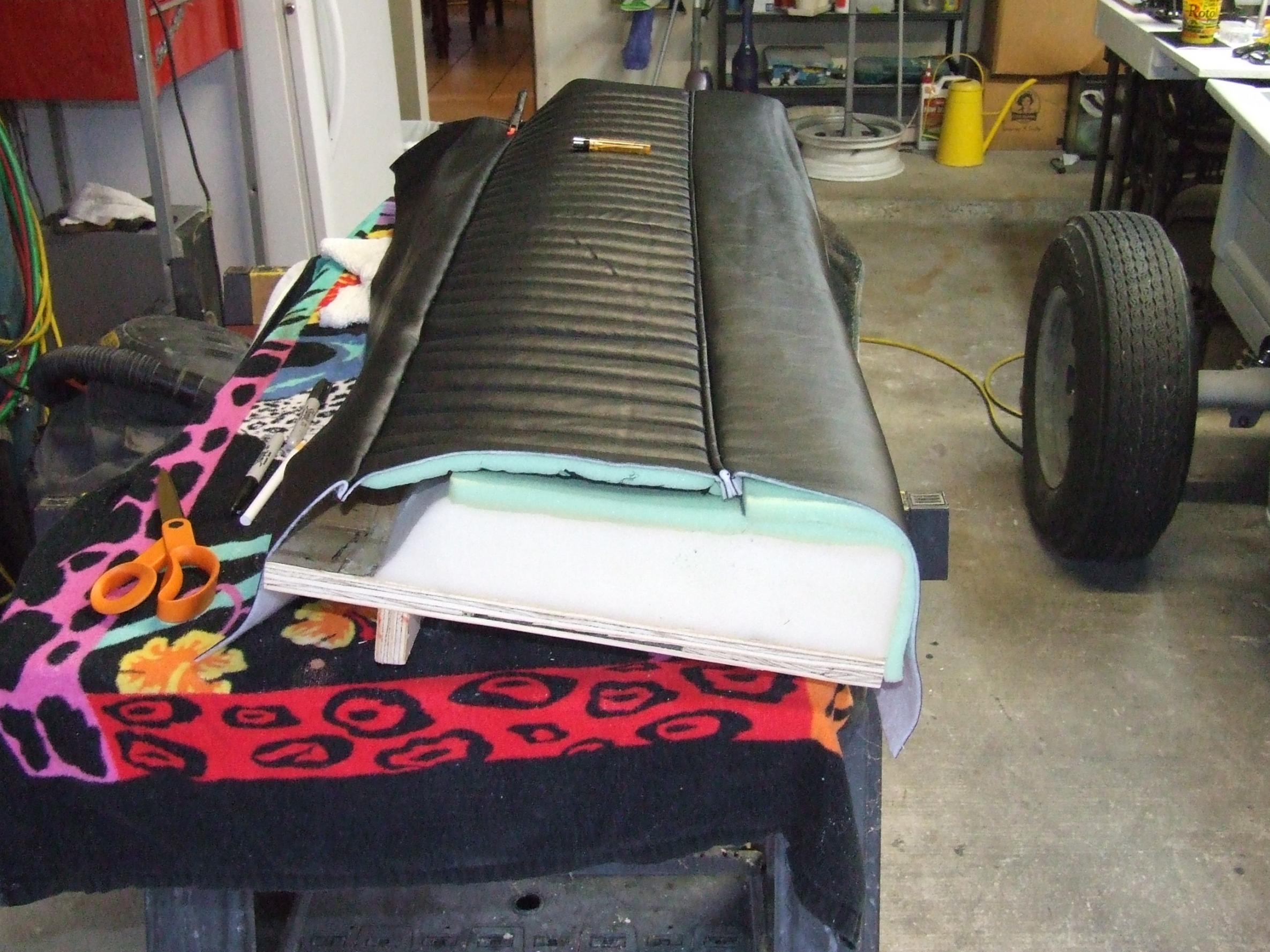

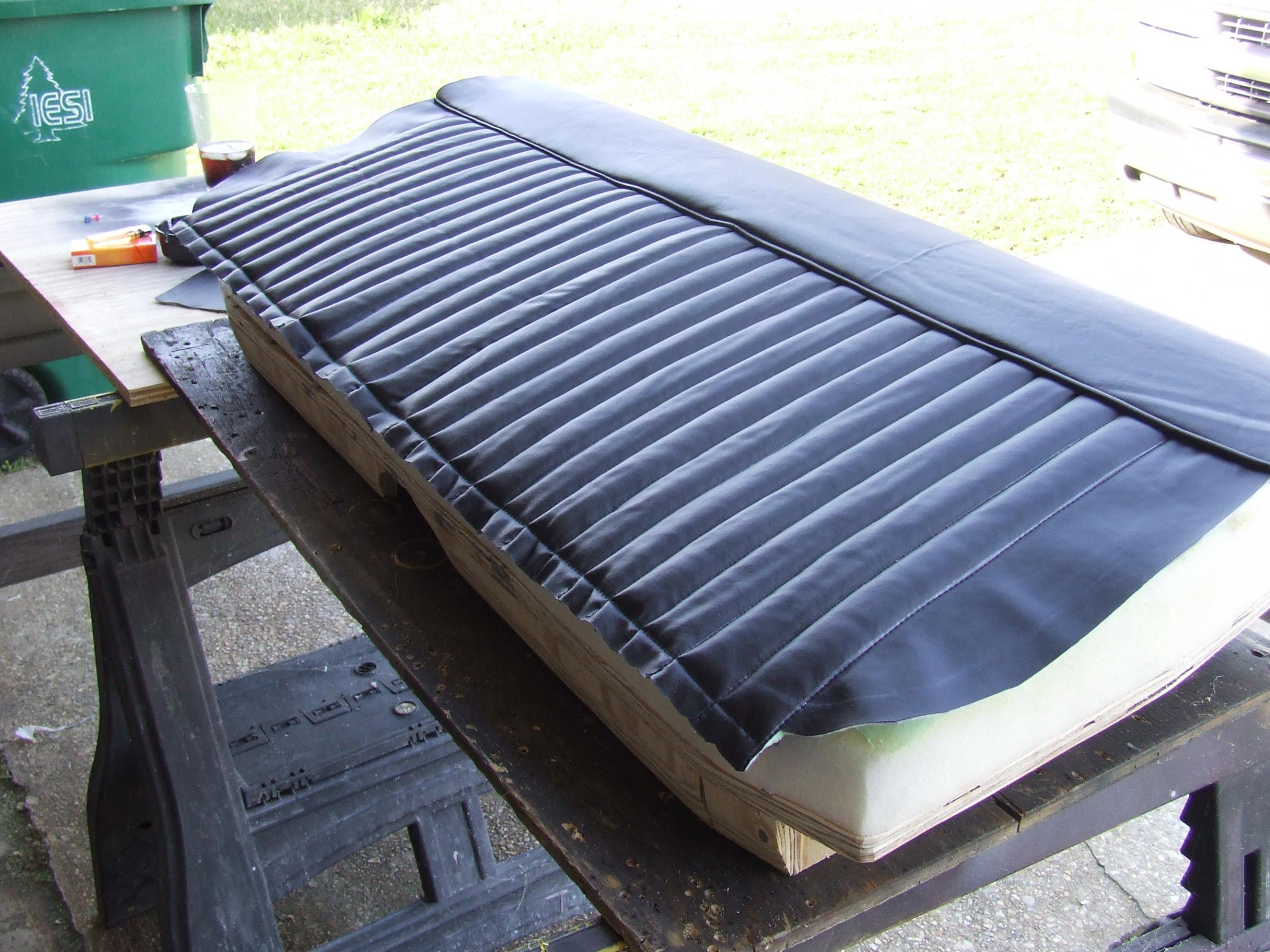

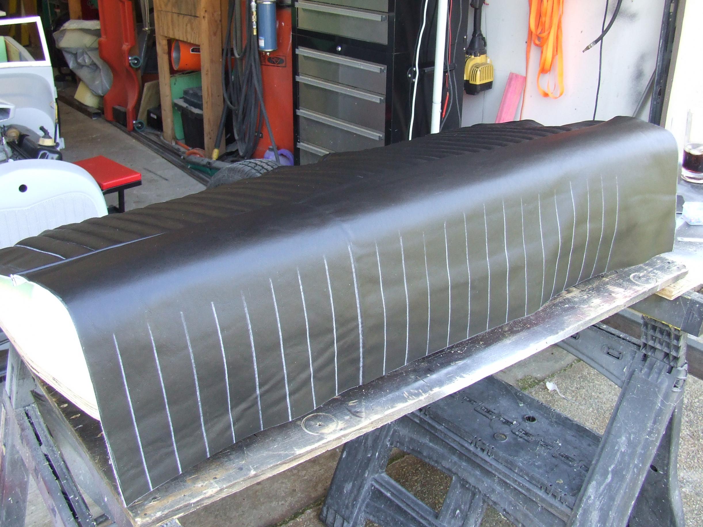

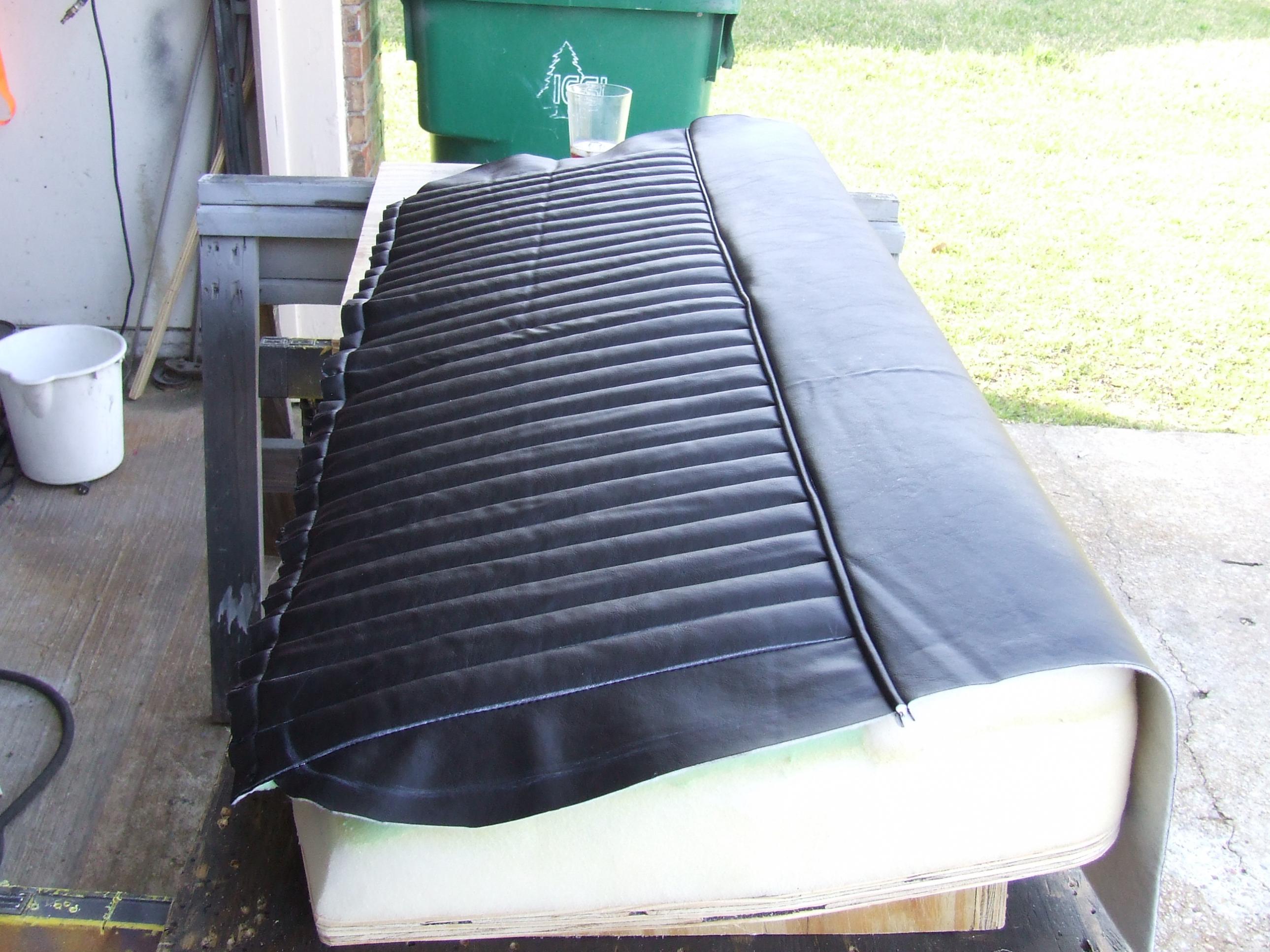

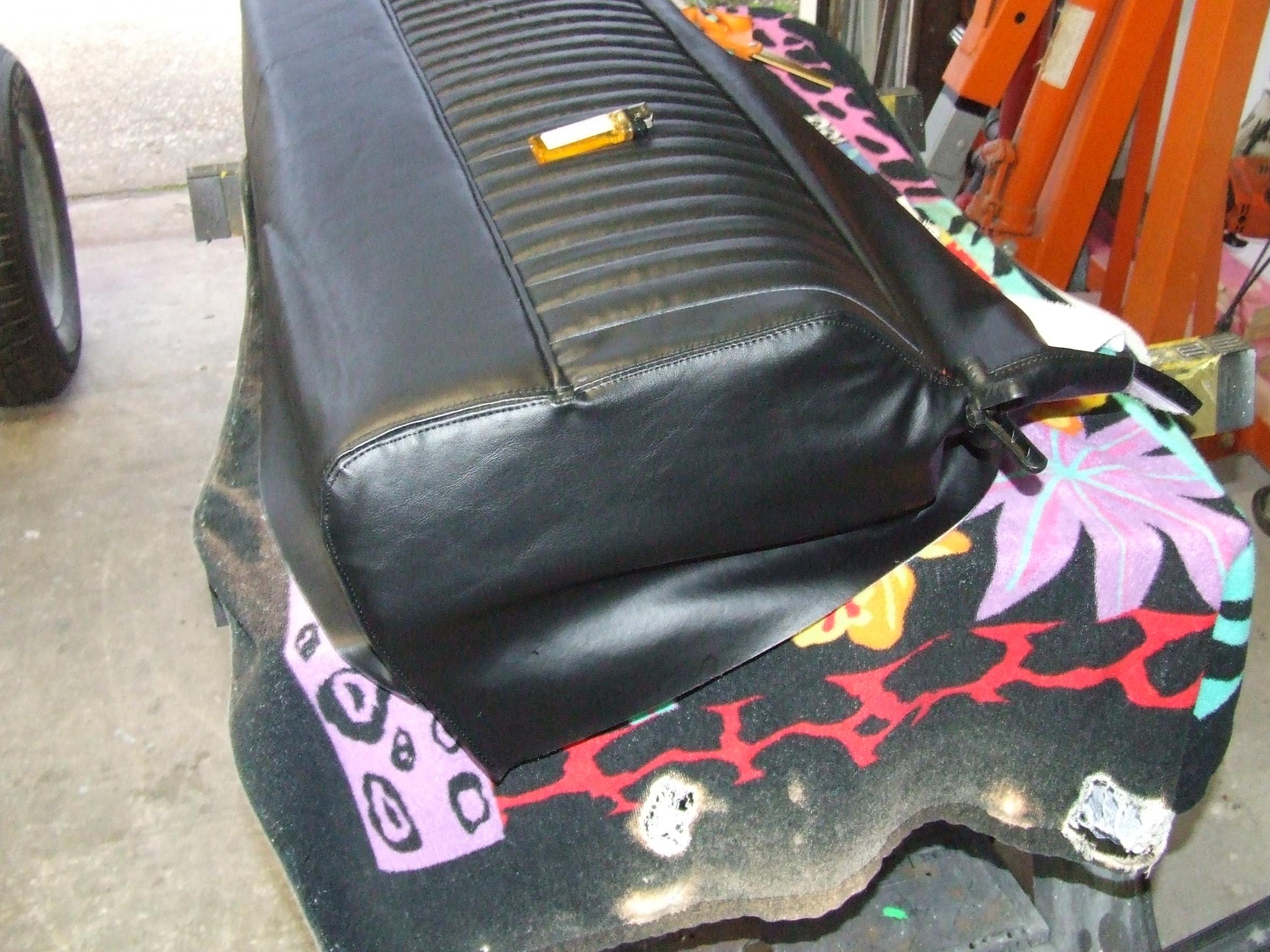

    Okay it's Saturday and I had already picked up the materials for the seat covers Friday so here goes. I first cut my patterns and then the material top is vinyl over 1/2 inch foam with muslin under the foam these were glue together prior to sewing. Marked out the pleats and sewed them thru the three layers of material this took awhile as I am out of practice. the Hardest part was making the edge welt. that required folding vinyl over a 5/32 inch cord and sewing it as close to the edge of the cord so it would be tight.

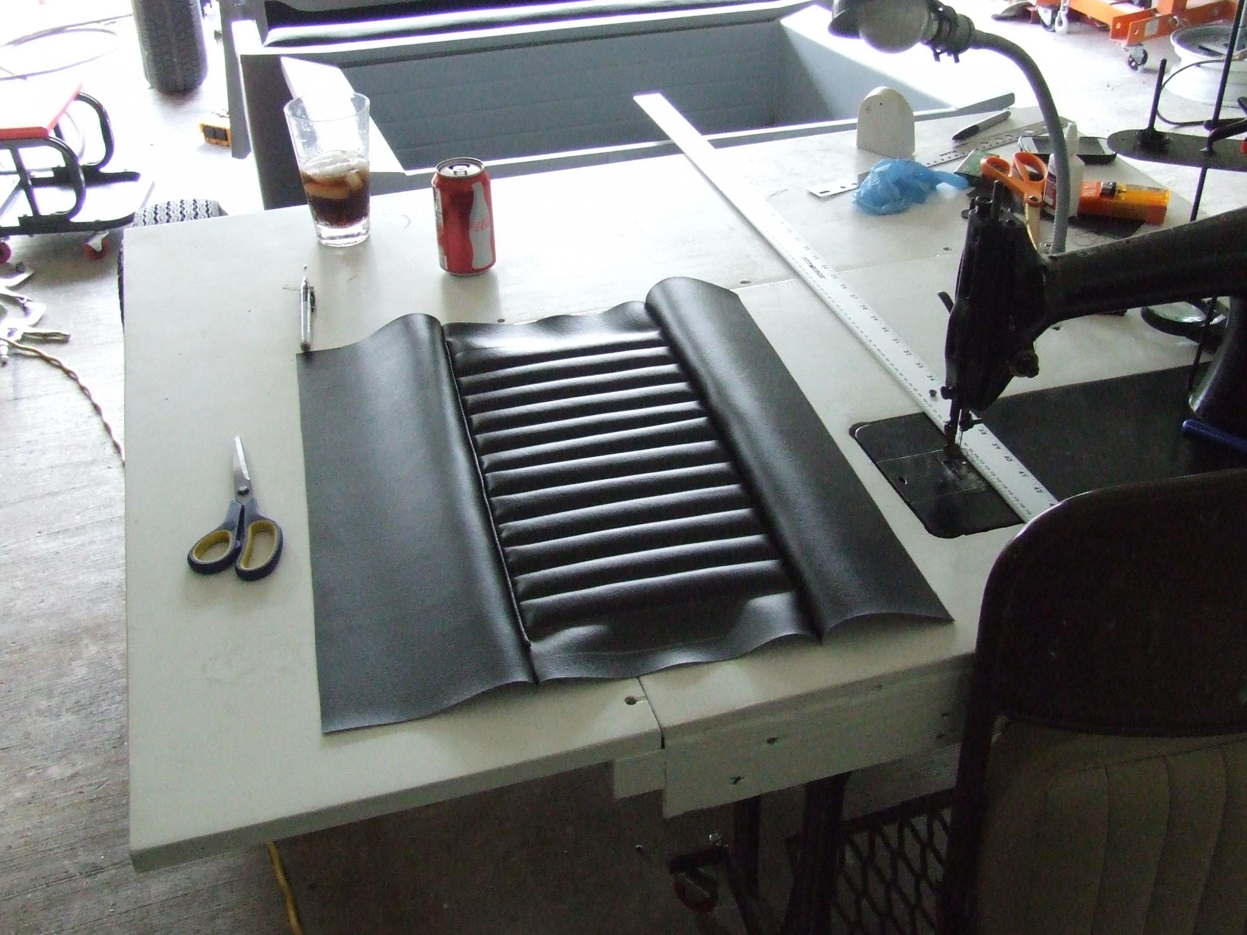

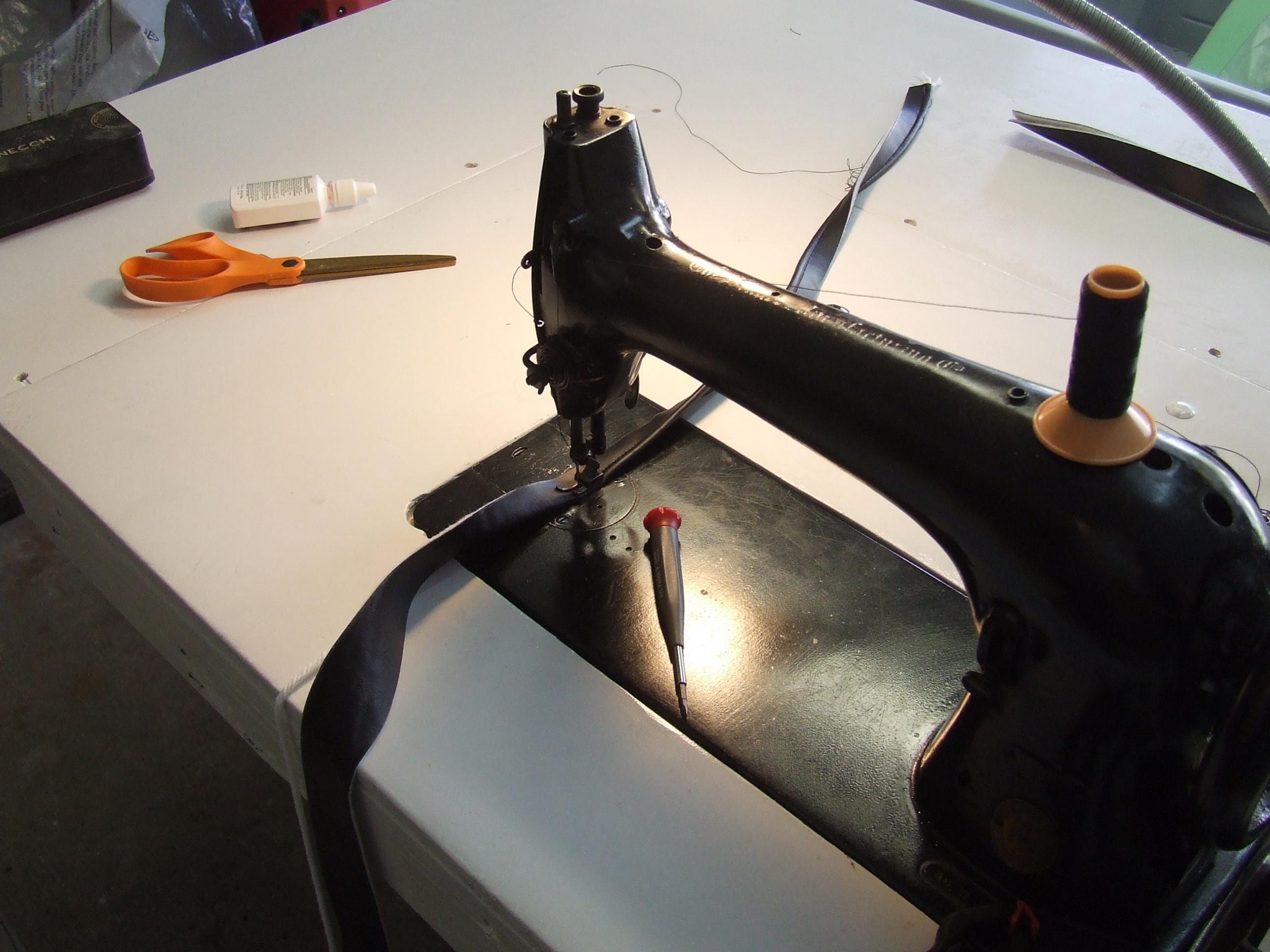

    I manage to sew the bottom cover less the side panels which I did cut out. Include in the photo's is a pic of the sewing machine I got from my aunt No it did not look that good when I picked it up. I cleaned and repaired the machine an built the table it sits in. Here's some pic's.

    Hey guy's had a little time to work on the rods interior today and finished sewing the bottom cover, I think it came out nice. I have never made a seat or seat cover from scratch so I was leary. I got over that quick after getting several prices from some shops they were insane least expensive started at $1800.00 and topped out at $3100.00.
    As of this post I have aprox. $70.00 in materials from plywood, foam, contact cement and vinyl not bad! Can't count my time because I am enjoying working on the interior. I figure that,s what hotrodding is about and I can say I did it all myself. Well here's some pics.

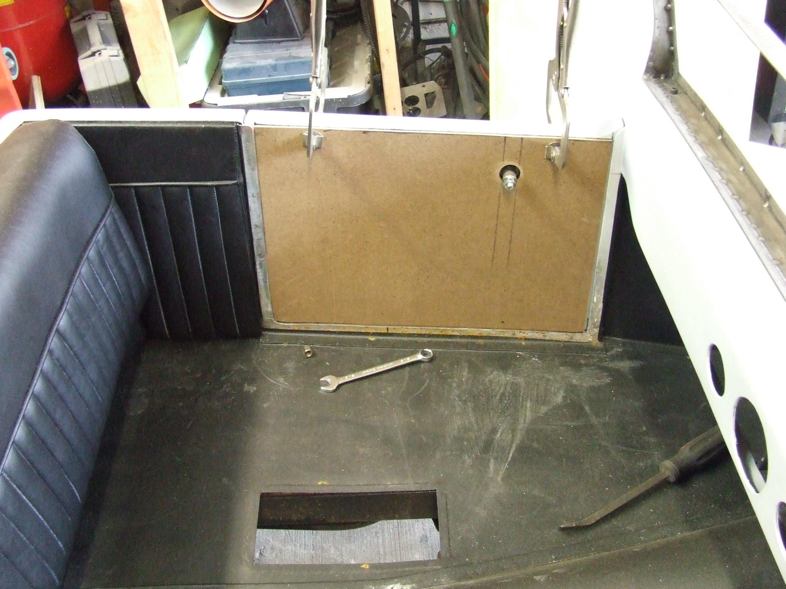

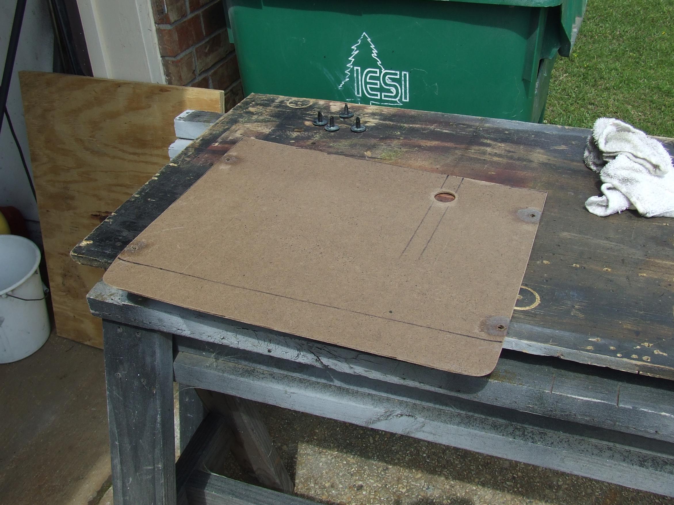

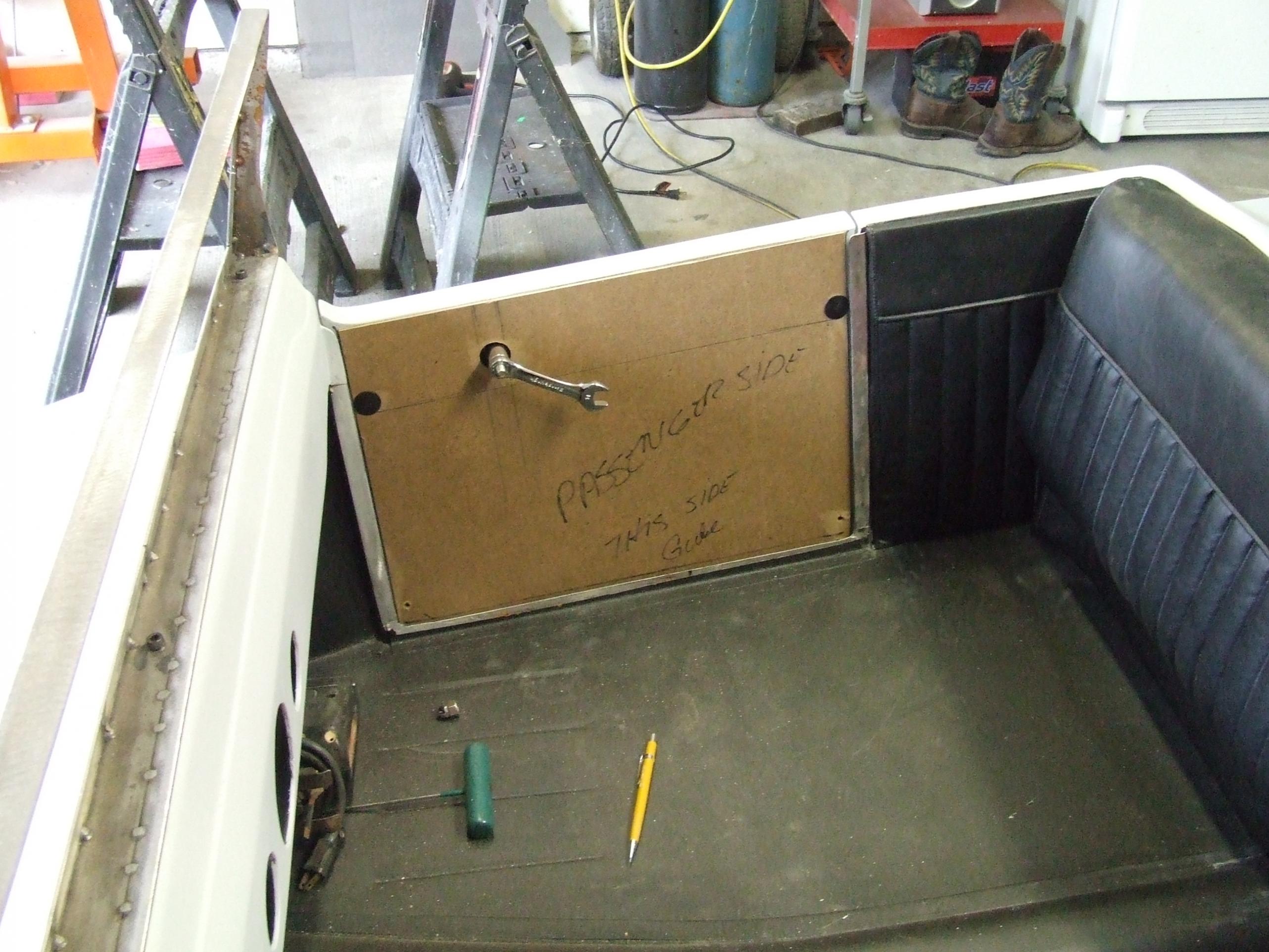

    Hey guys. Today I cut out the door panel backing wood and began sewing the door covers. Here is a couple of pic's.

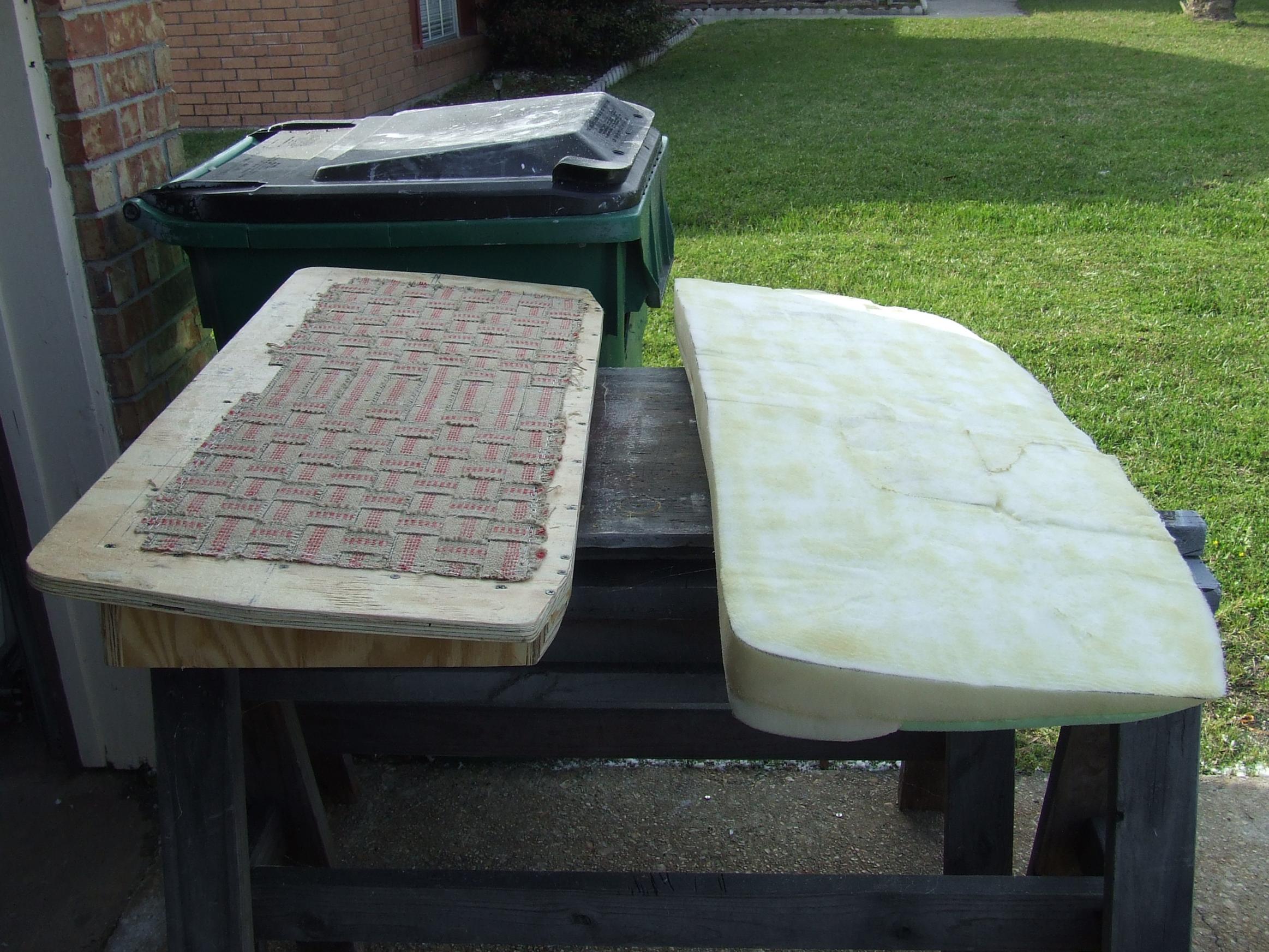

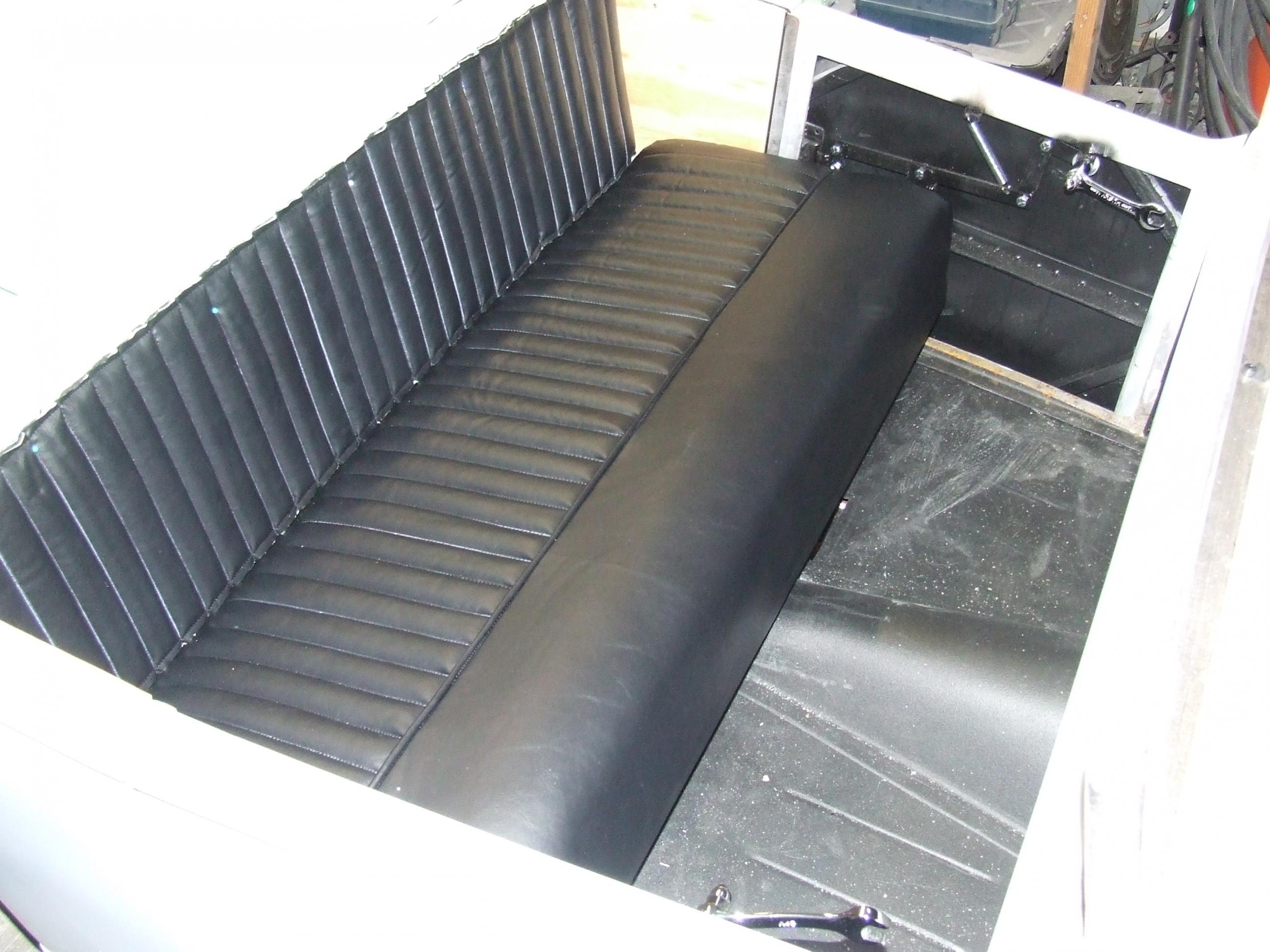

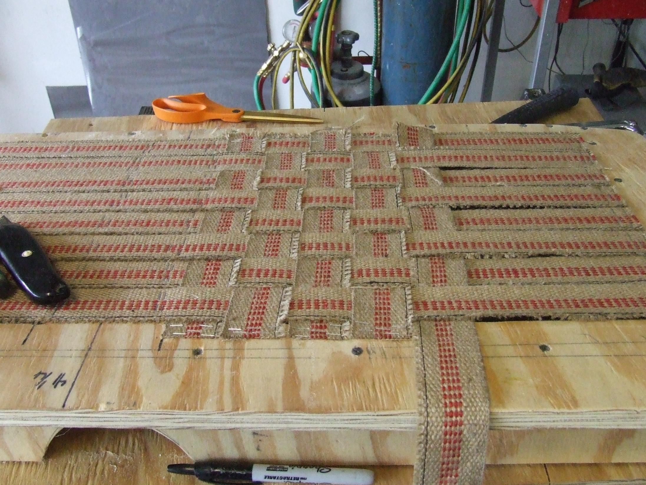

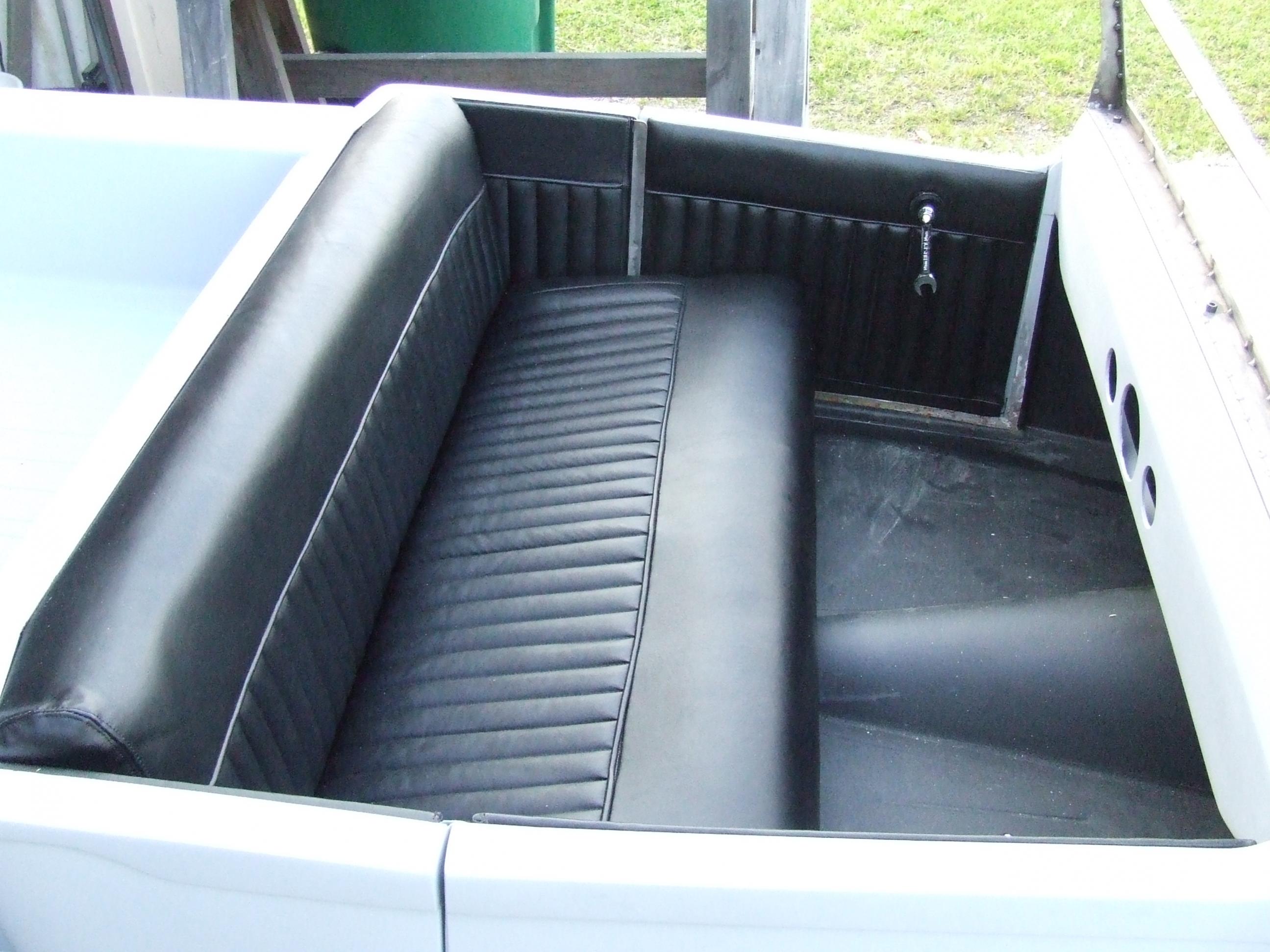

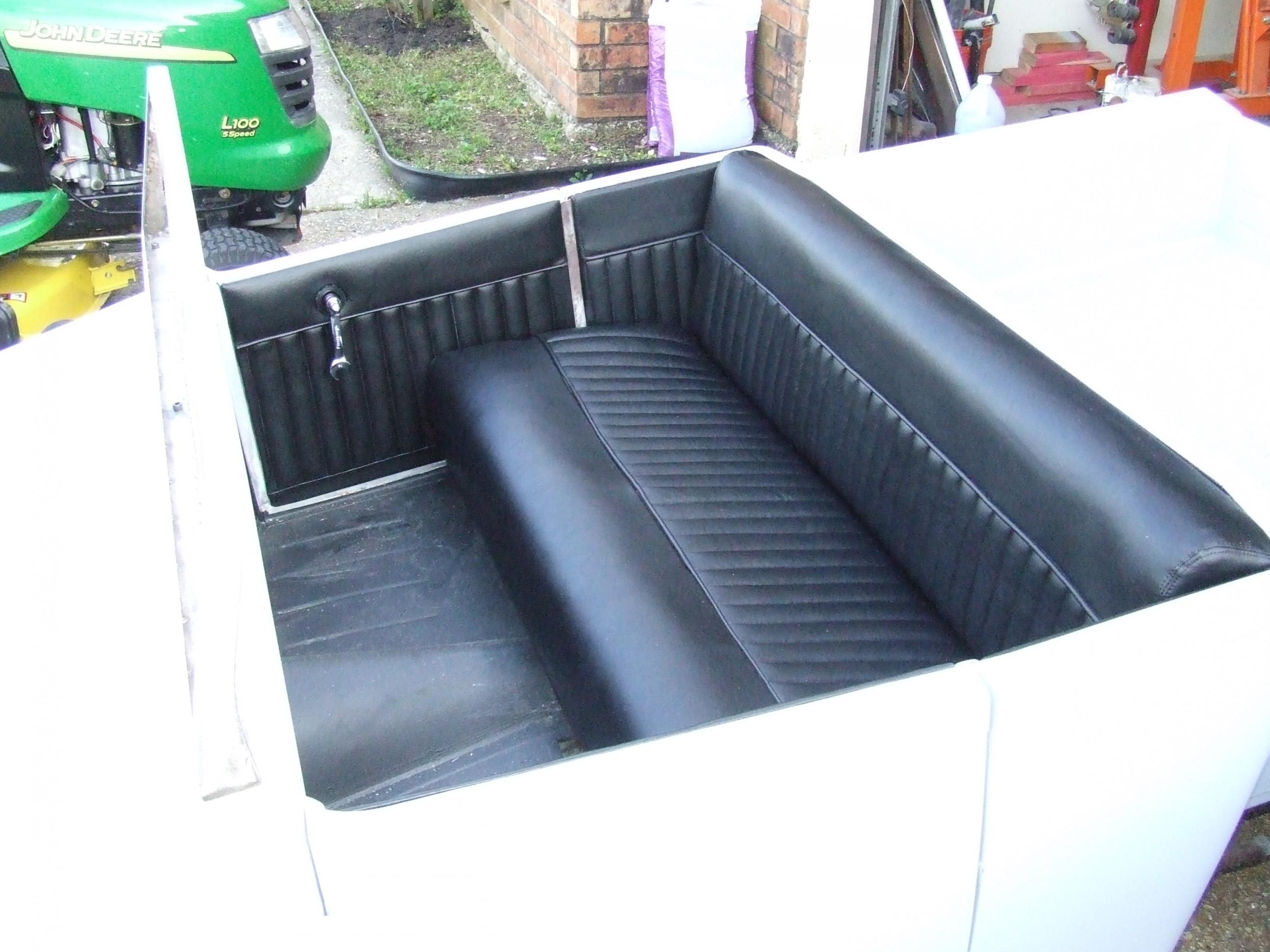

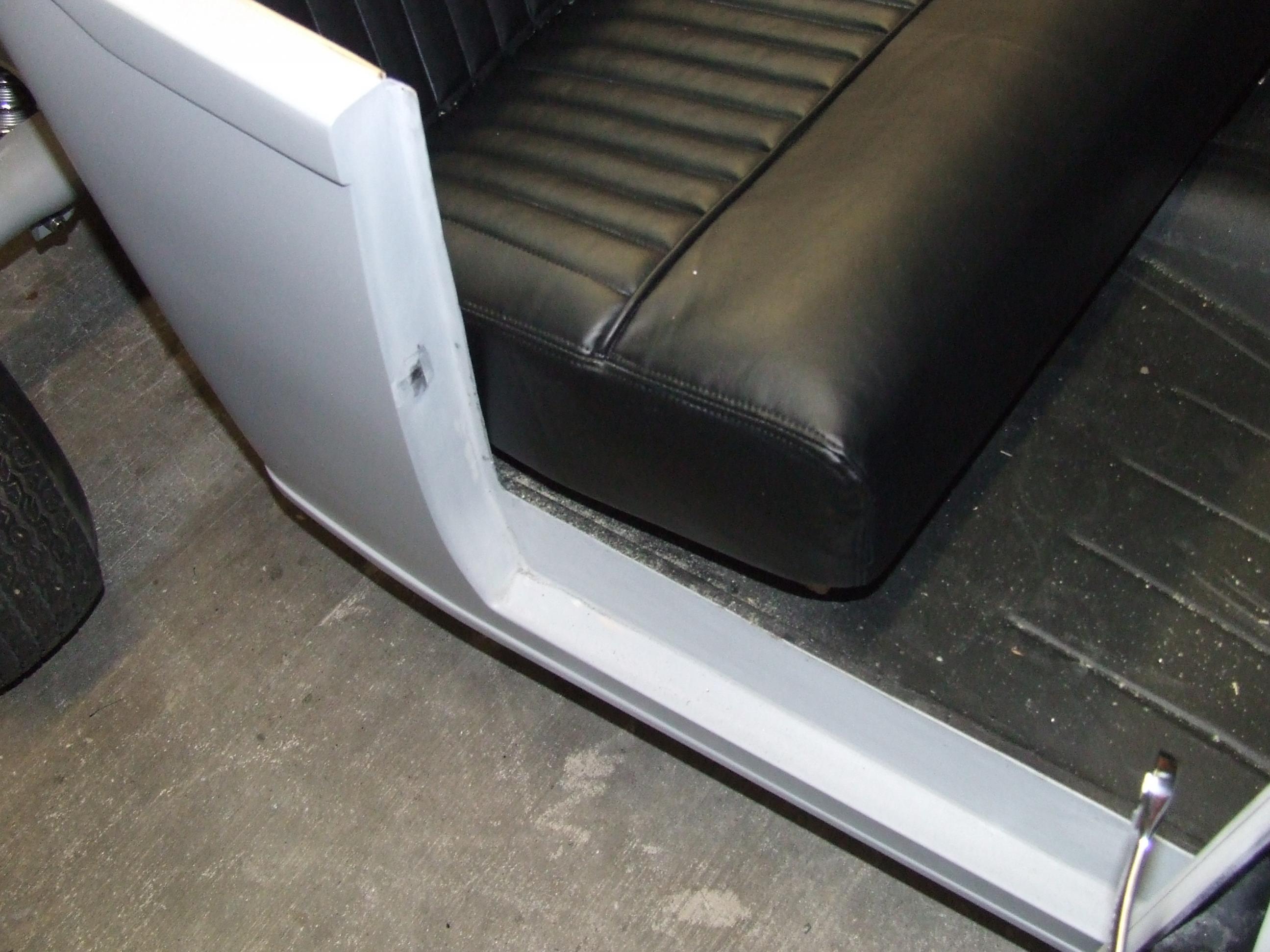

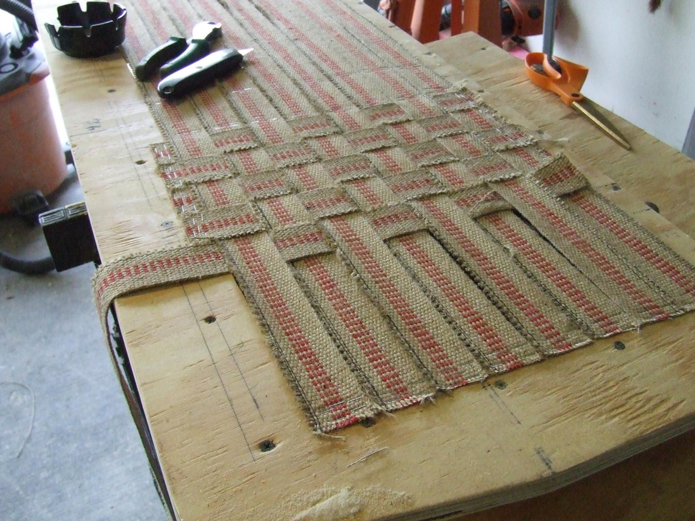

    Hey guy's had a whole day to work on the rod! Started with the driver door interior and finished it. After looking at the completed interior I didn't like the bottom seat cushion it was not comfy. I hadn't cut openings in the bottom plywood prior to gluing the foam on. So I cut two square holes and stretched and laced webbing across the cutouts and cut the foam down. I then reglued the foam to the plywood and installed the cover. Here are some pics of the finished interior less carpet.

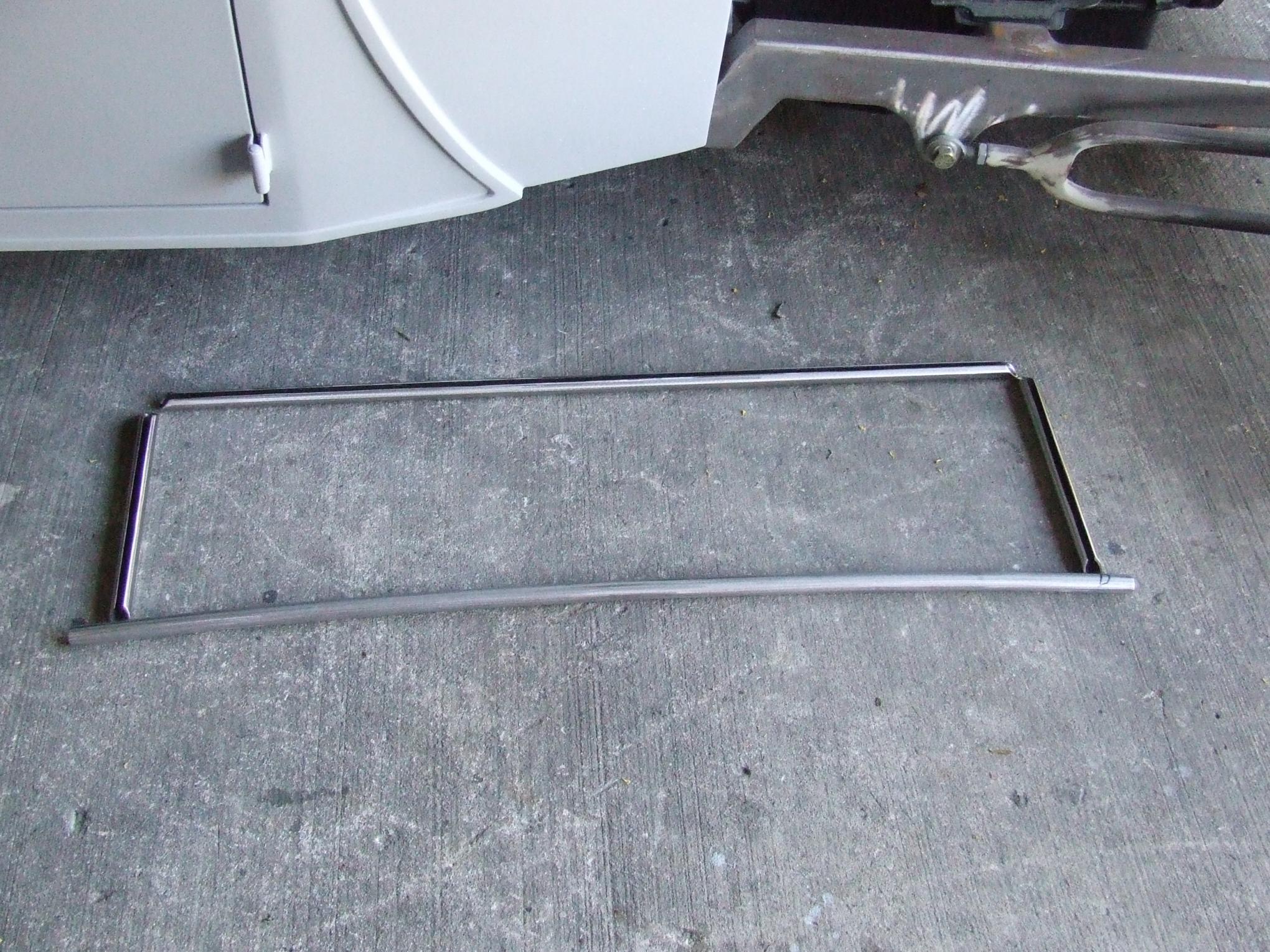

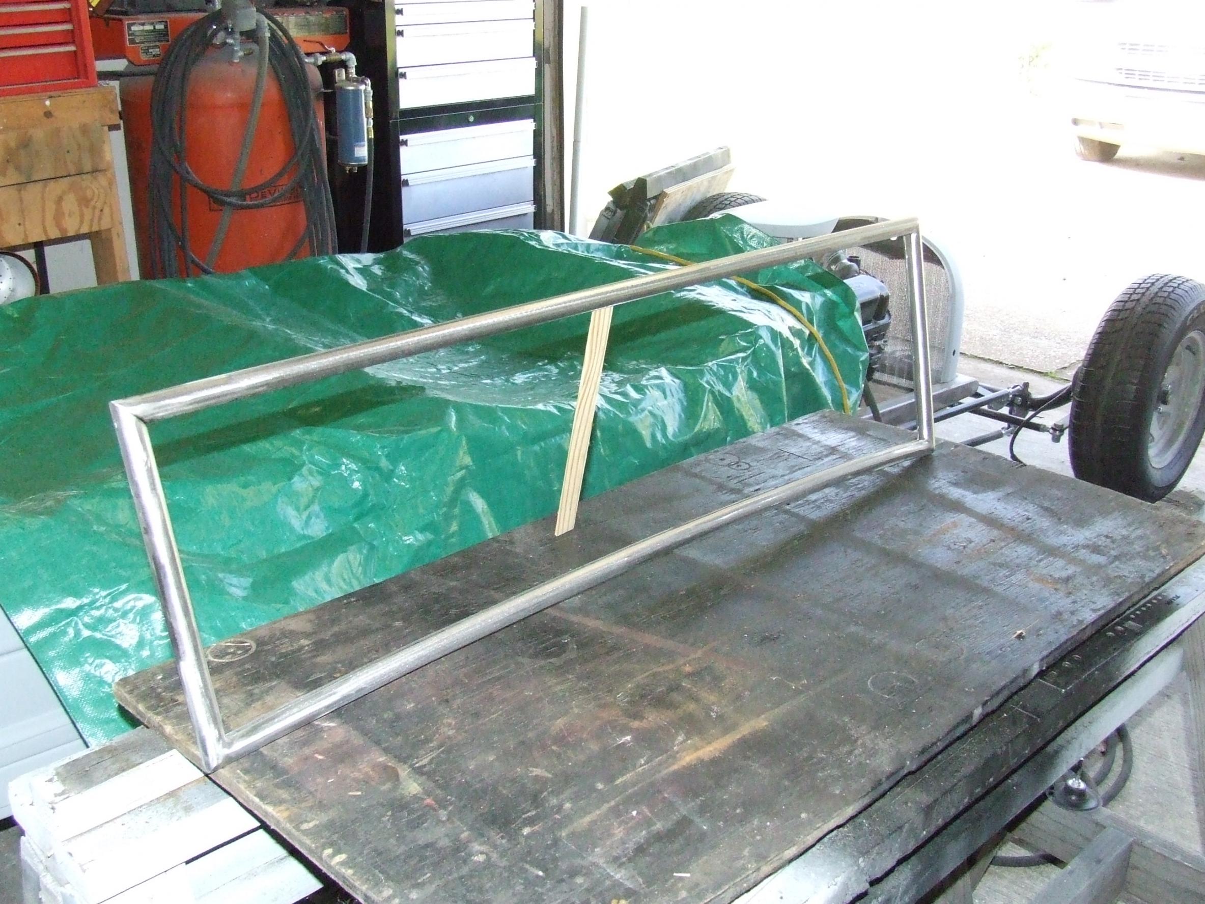

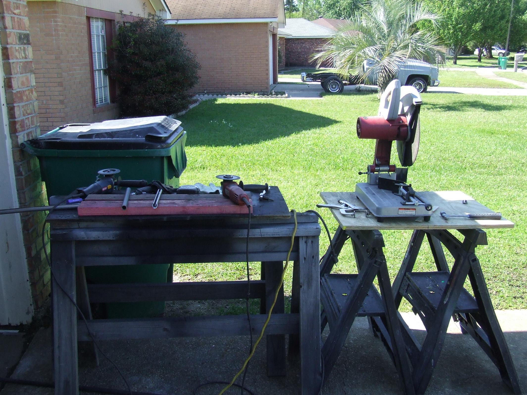

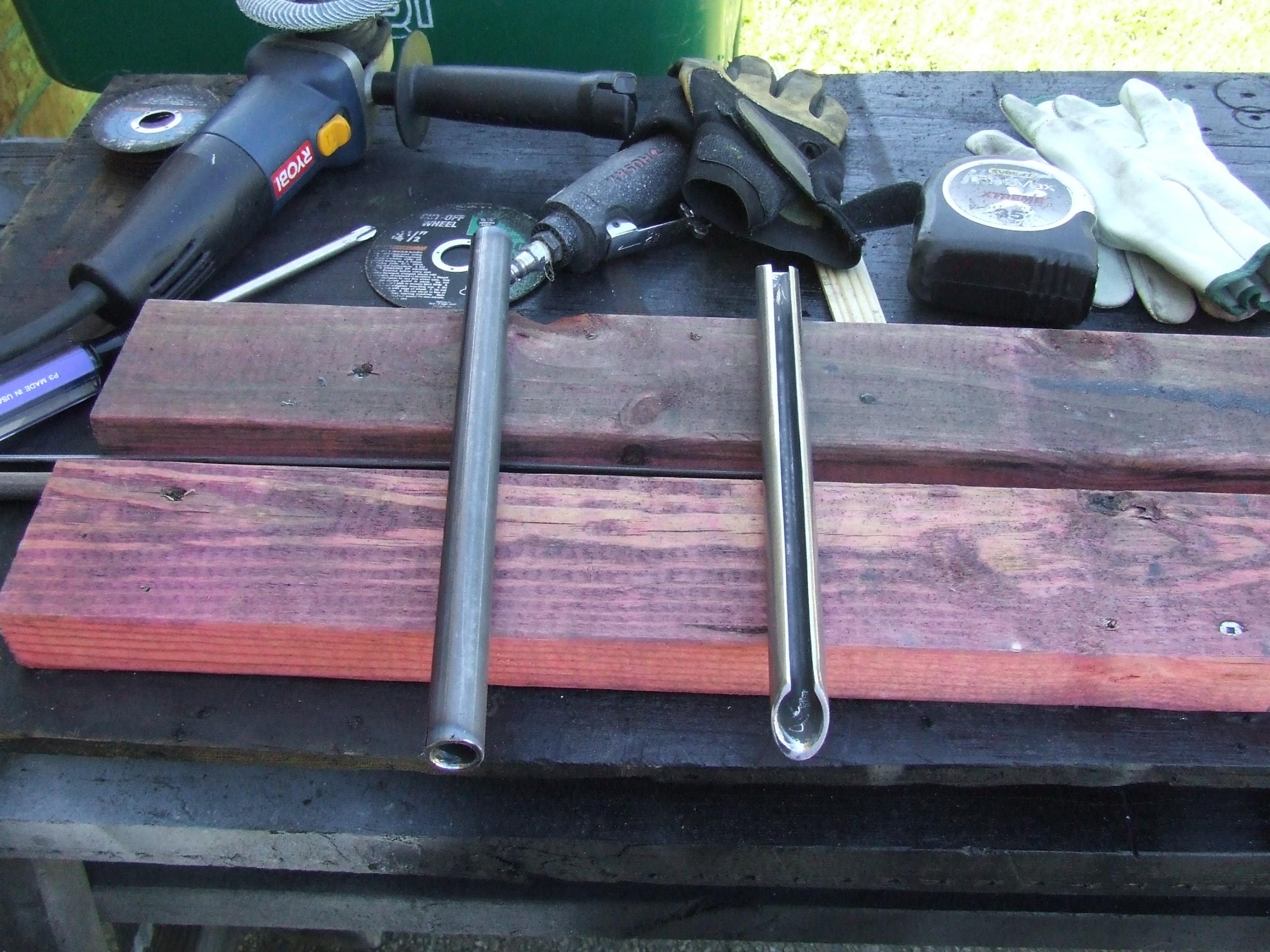

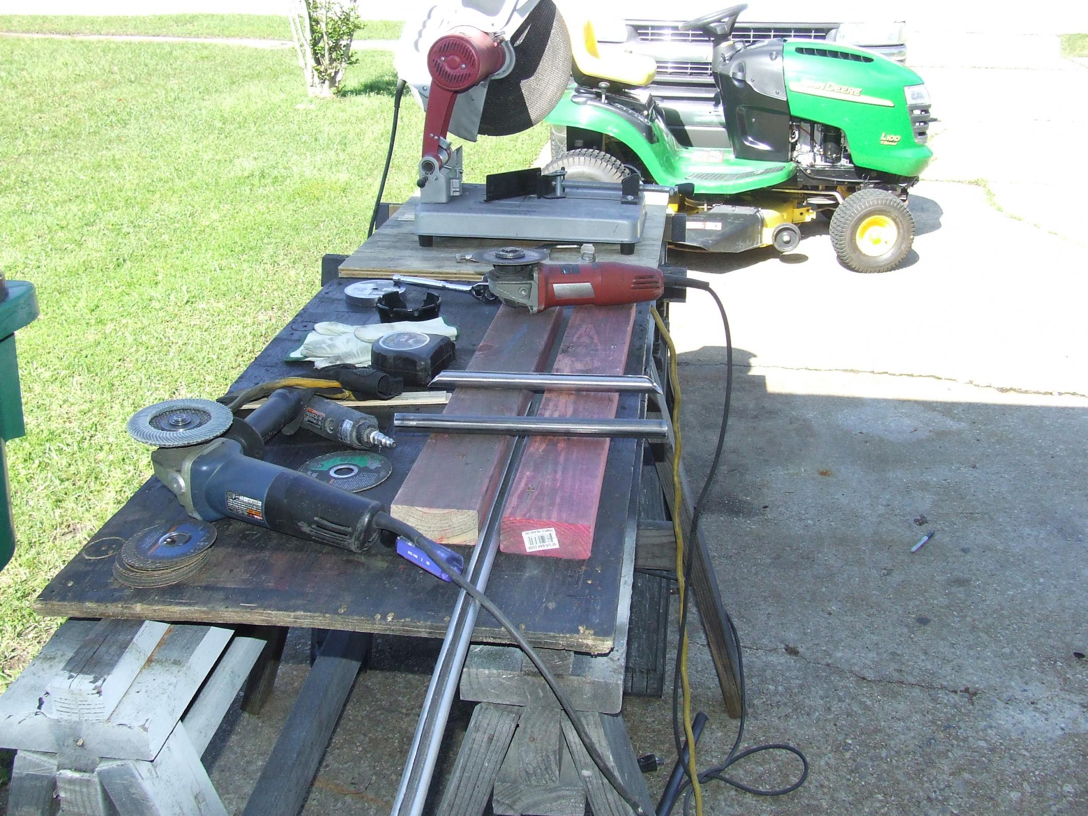

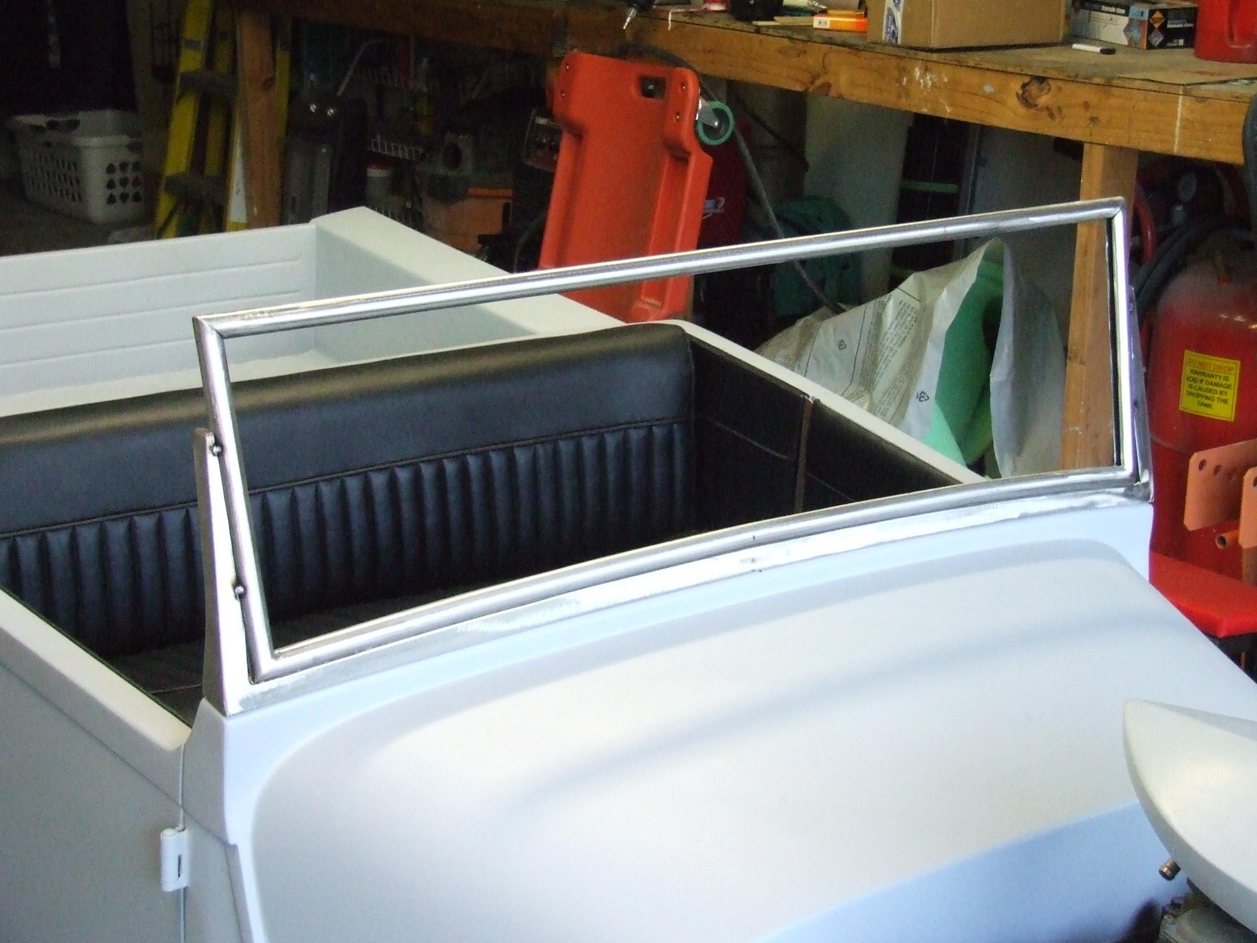

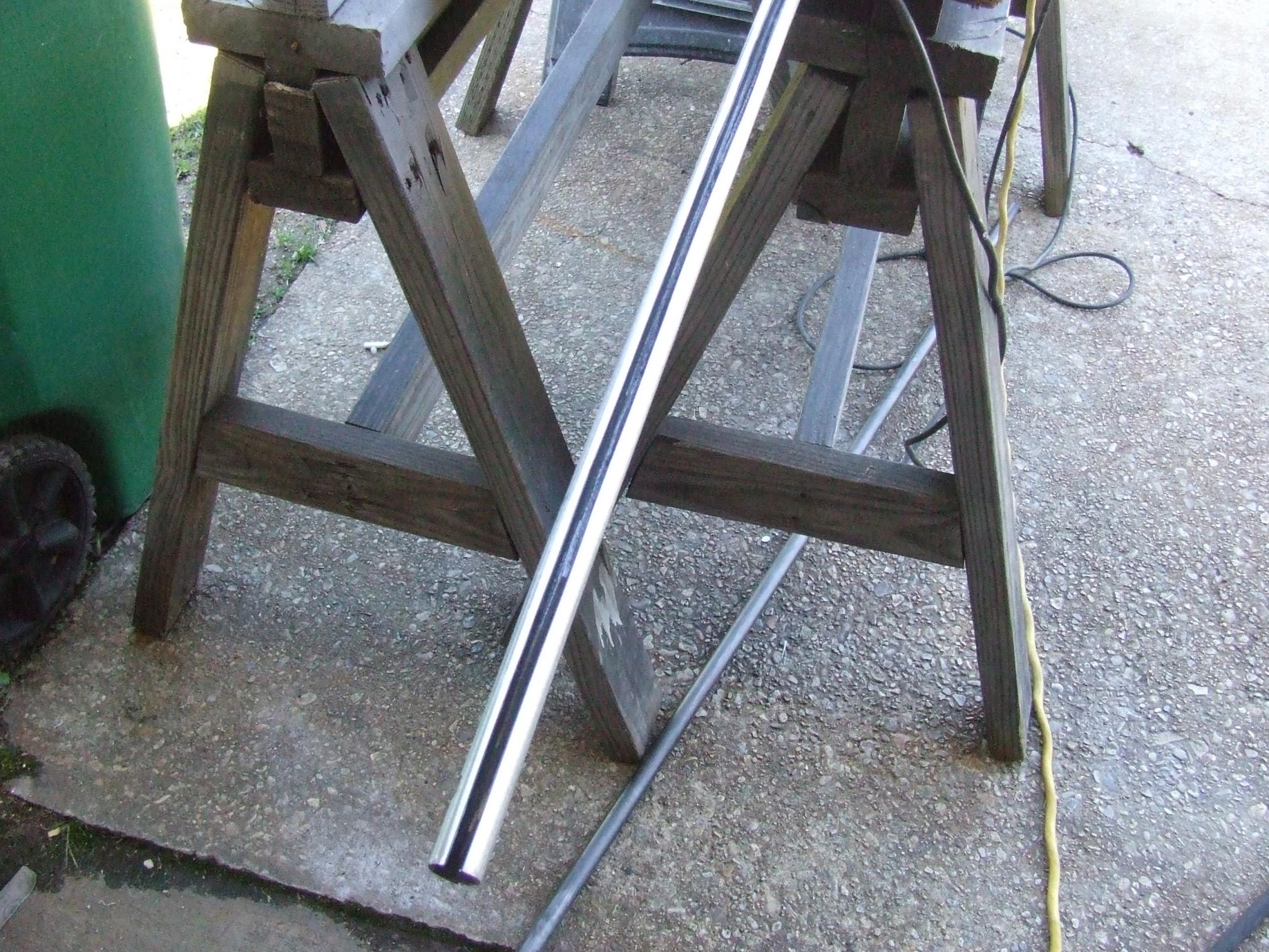

    Hey guy's, had a chance to work on the rod today! After looking at the windshield frame I had made previously I decided I didn't like it. So I had been looking at the tech archive and found someone had a tech article on how to make a model A windshield frame. I can't remember who it was but he did a good job. I went and purchased some 1/2 inch water pipe. The pipe in the article was done with a mill I am not that lucky, I made a jig with plywood and two by fours and cut the slot for the glass with a 4" grinder. I had bent a slight arc in the bottom tube prior to cutting the slot. All that's left is to cut the 45's on the bottom piece and tack the sides to the bottom and make provisions to bolt the top tube to the sides so it is removable to insert the glass. Here's a few pic's!

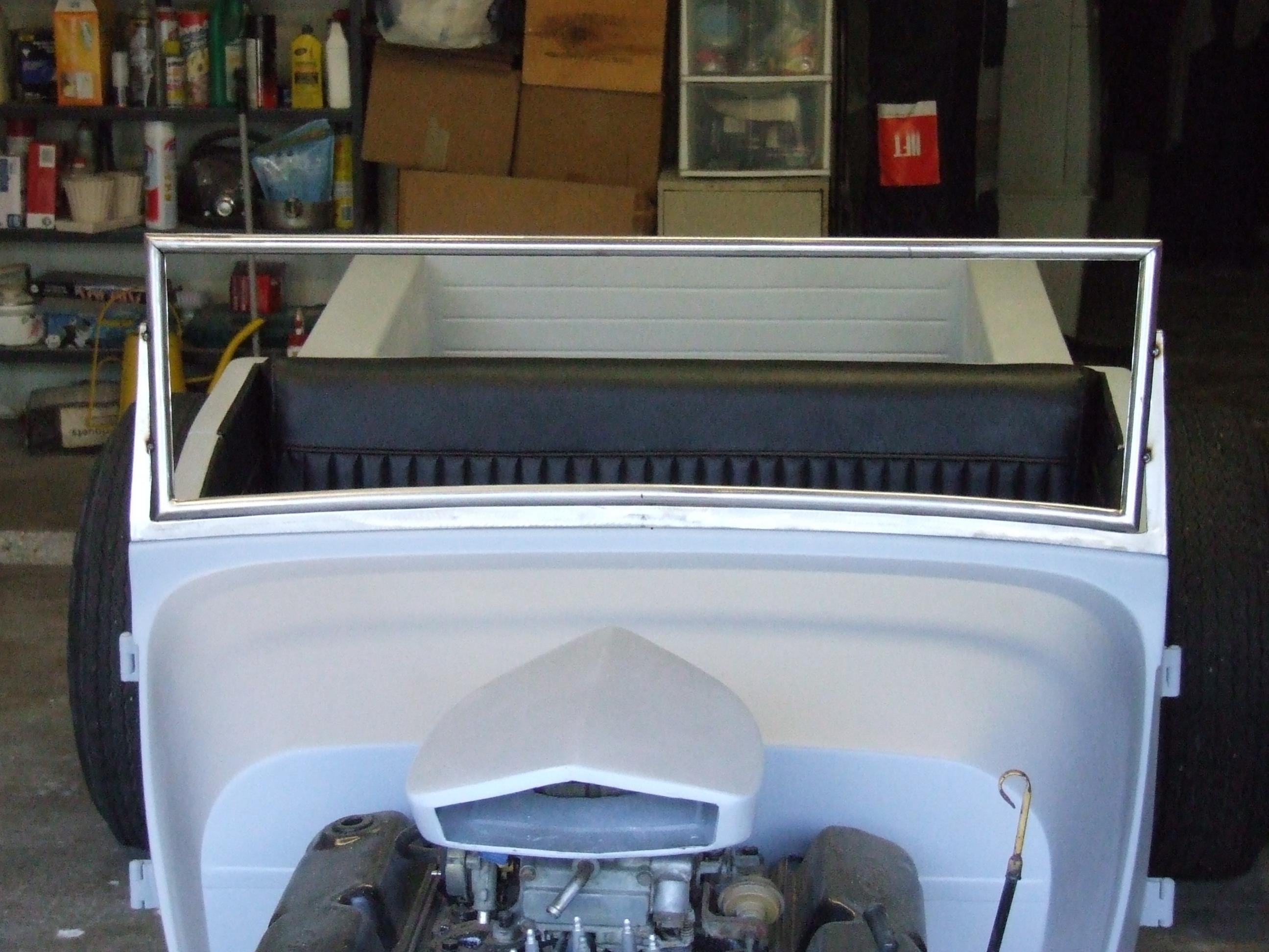

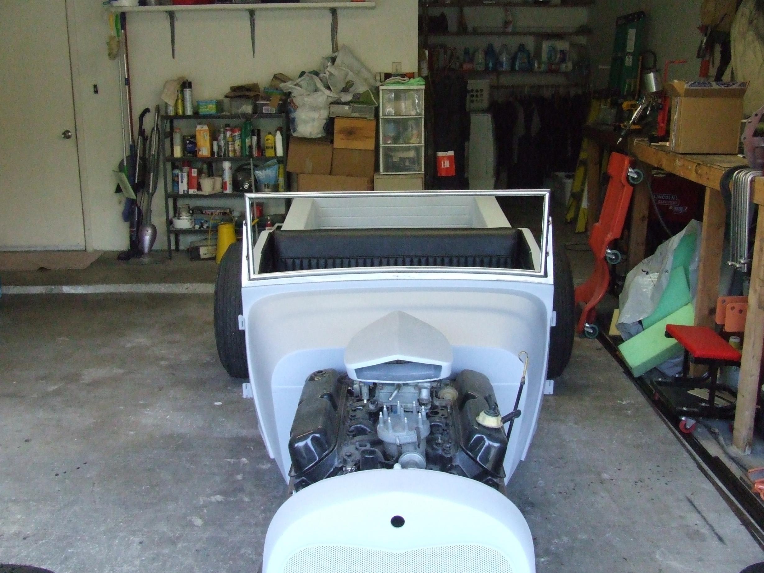

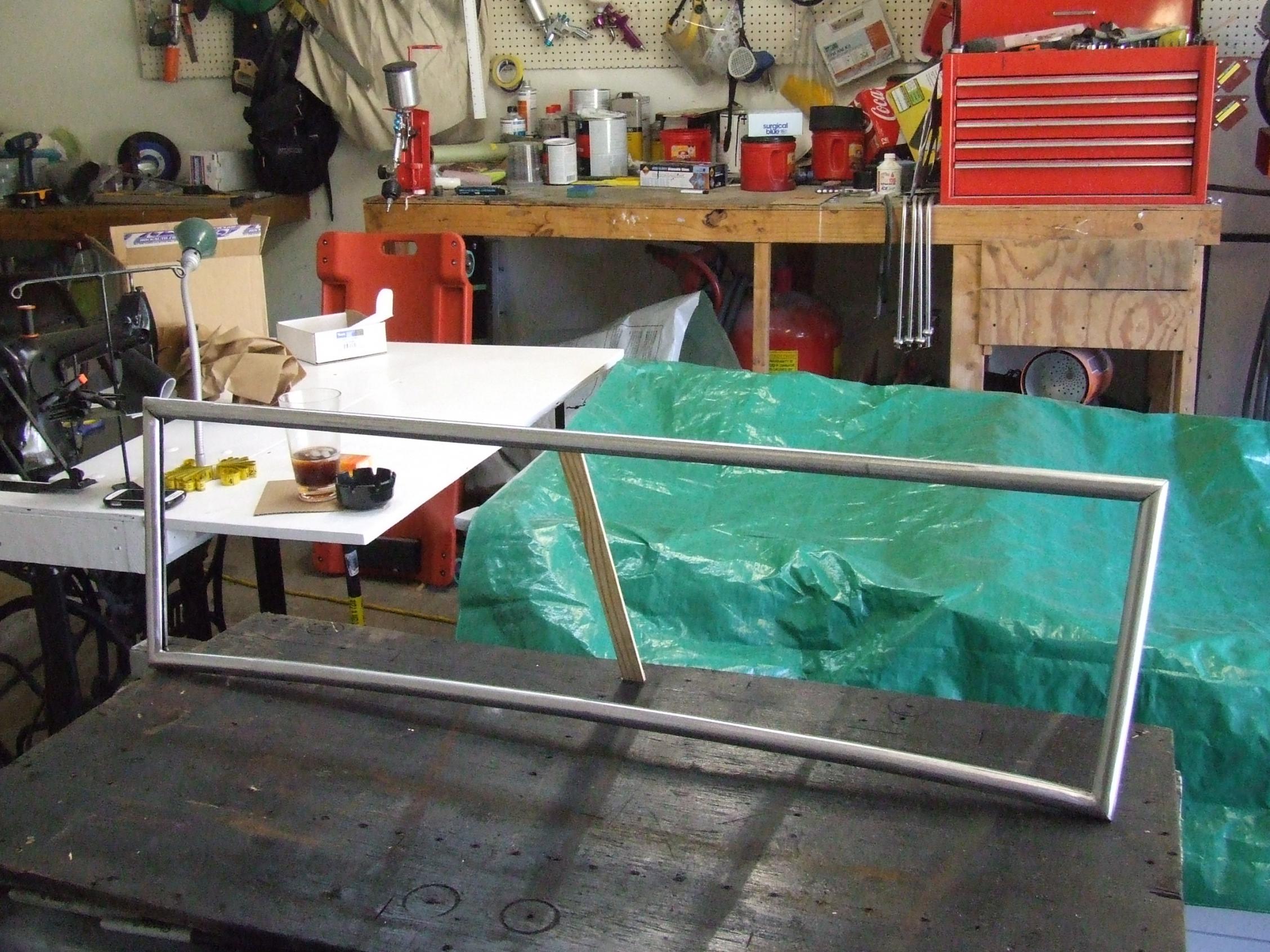

    Hey guy's, Got the windshield frame put together and welded. It wasn't to easy to align the top with the rest of the frame and drill and tap for the 8/32 screws. To accomplish this I used two ratchet straps side to side and top to bottom. I then drilled and tapped it and it worked out. I then used the existing windshield frame and cut the top off of it and used it for the mount.
    I then aligned the old frame and the new frame and tack it in place to see if it looked Ok. I was pleased with it and will make the new mounts so the windshield will be able to open like a factory one. Here are some pic's. I think it looks much better than before!
