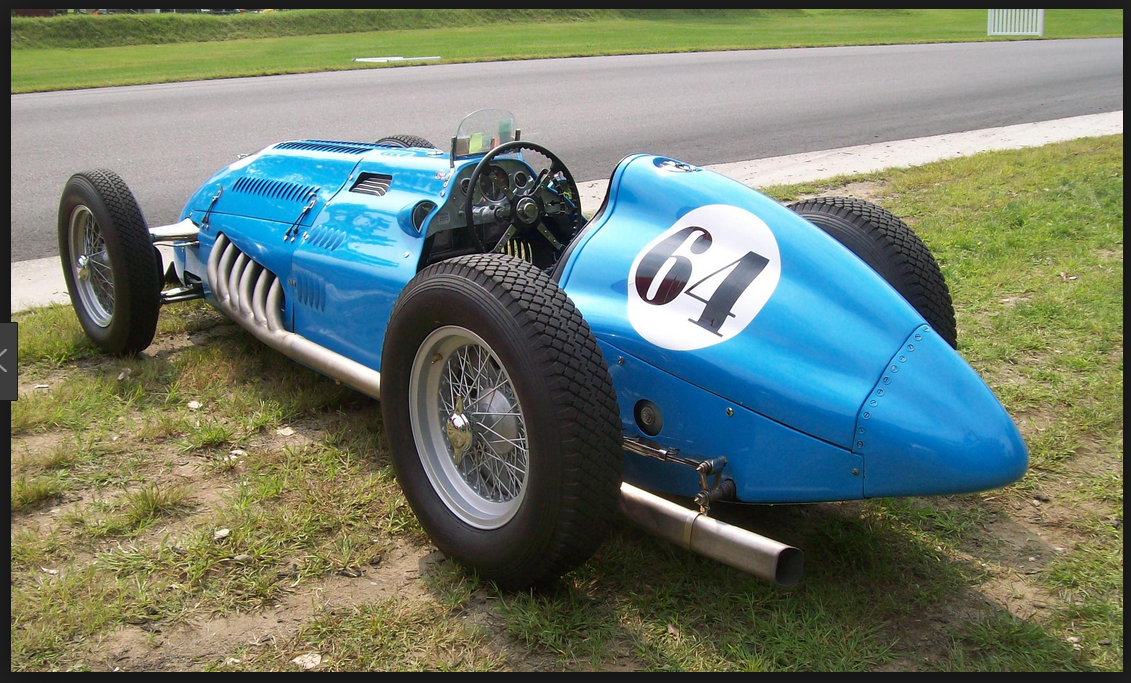

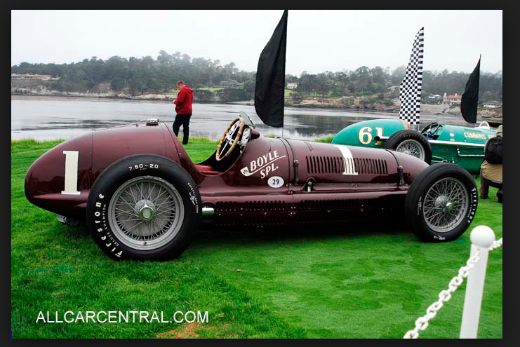

    Bildschirmfoto 2019-03-18 um 02.00.12.png Bildschirmfoto 2019-03-18 um 02.02.28.png Reminds me a little to Talbot T-26 C and the Maseratti 8CTF " boyle special " but yours more harmonic... thanks for sharing your progress, absolute astonishing your work.

    Thank you!The Maserati (Boyle Special )is one of my all time favorites. It’s so beautiful.
