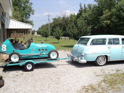

    Here is my Crosley .. Run ***le for ***le?
