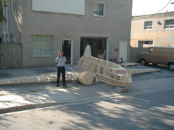

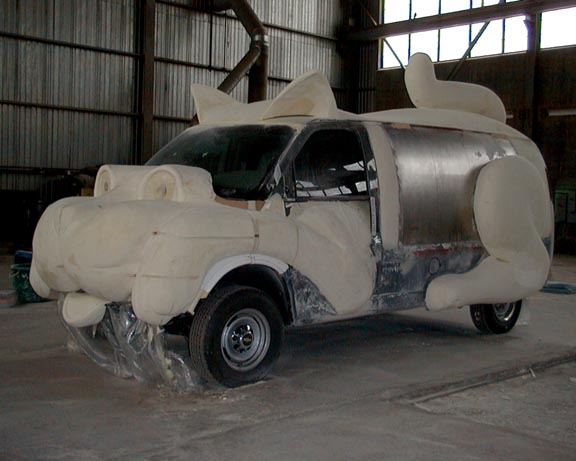

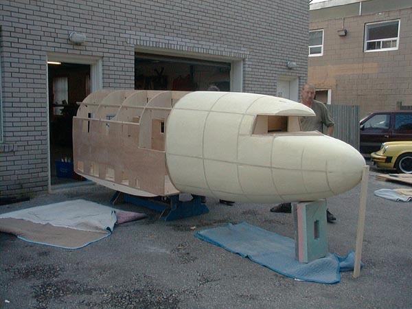

    I' ll try not to get too long winded on this but I've always had good luck with building a plywood "eggcrate" Some of these (Like the Fiero pictured) I've done almost freehand and used a router to make a mirror set for the opposite side.
    Others I've drafted and cut with a CNC like the DC3. These one's are exact and perfectly symmetrical.
    The structure is then blown full of urethane foam. Same stuff they're using commercially for home insulation now.
    It's then ground back to the edges of the plywood and smoothed out. Skinned in gl*** and body fill. Primed, polished and then we'd pull moulds or use it as a finished piece.
    For a car body you'd need to either pull a mold or skin it in sections and remove these and graft them back together.
    Urethane foam is the only thing compatible with polyester resin. Regular, pink blue and white styrofoam will work with epoxy resin but then the problem is that polyester fillers will not cure over epoxies.
    Here's a few pics which might help to explain some of this.
