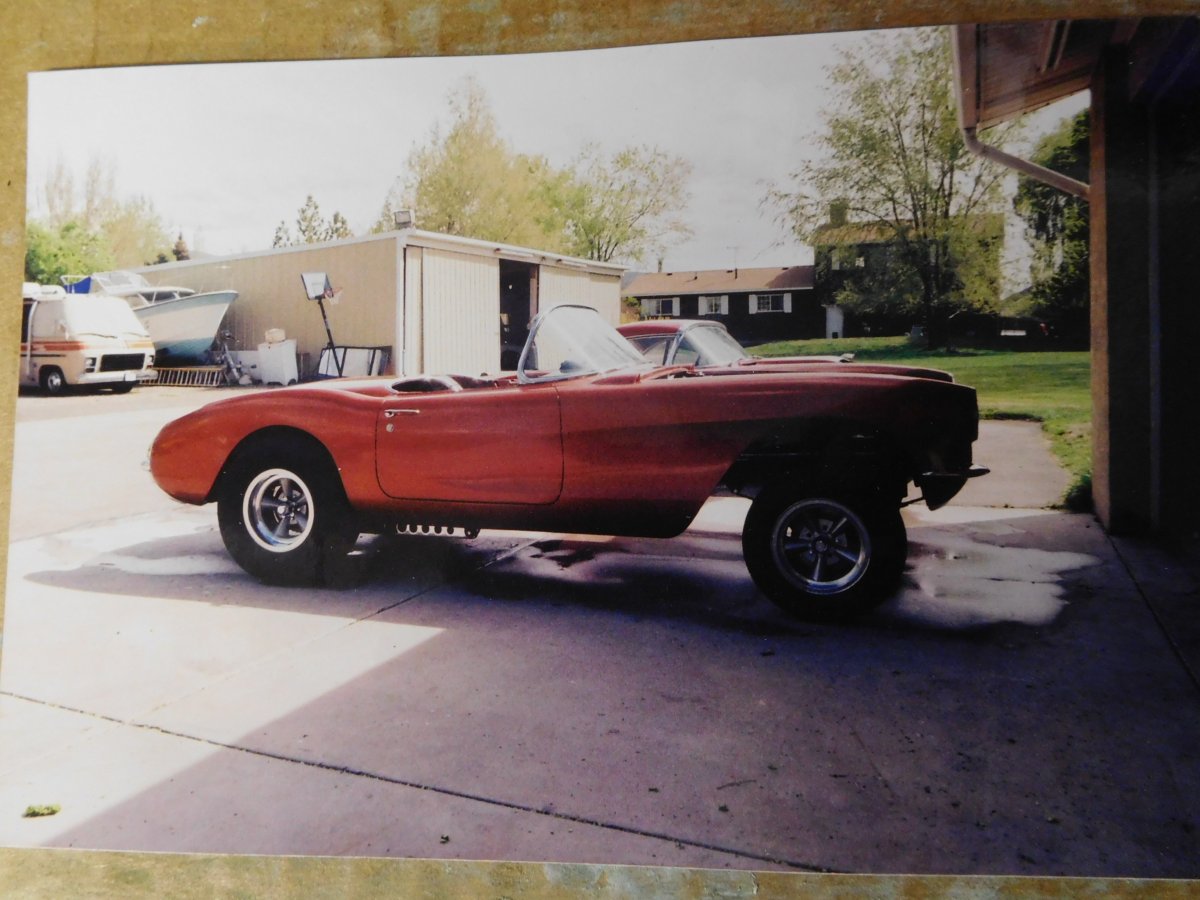

    Most of the exterior trim is on now. Waiting for the tail lights to return from the chrome shop. Still need to run the exhaust out the rear. The pipes will run inboard of the frame rails so as to not block the ladder bars from view. The hood scoop is from a 1970 Cougar Eliminator. I had a 57 Corvette in the 1970s that ran one of these and I always thought it looked like it belonged. It fits perfectly between the power bulges and curves to match the surface of the hood. No interior yet. Really starting to look like something now. 570002.JPG 570003.JPG CIMG0118.JPG

    Wow! That thing looks awesome!

    Now that is a CORVETTE!!!

    Another one Saved !! Well done !!
  25. Just Gary
    Joined: Oct 9, 2002
    Posts: 6,050
    Just Gary
    Wow- you nailed the stance and wheel/tire combo.
    The drilled & chromed ladder bars are perfect jewelry- they're a highlight, but not so gaudy as to be a distraction. :cool:

    The color and stance (and wheels) are spot on. Good to see another old derelict saved.
