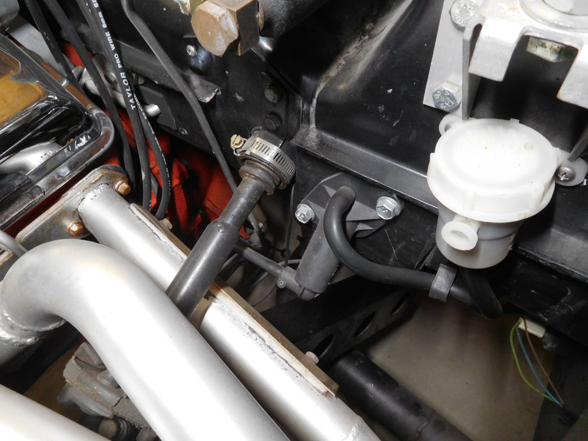

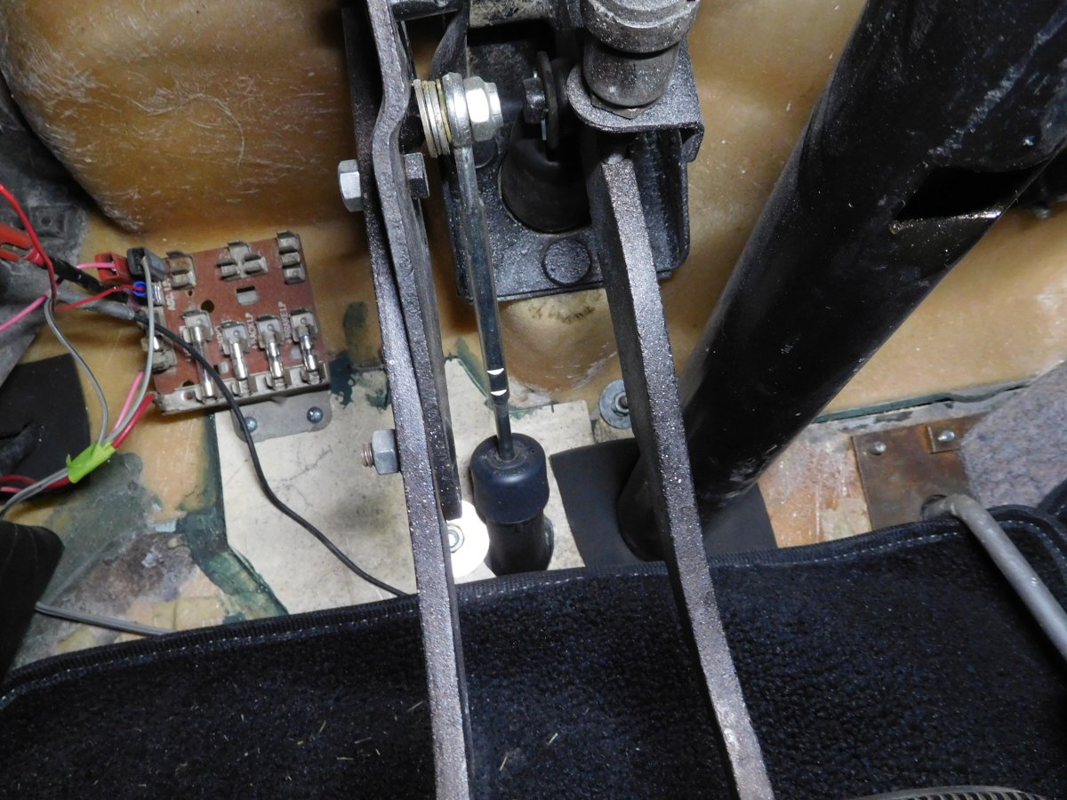

    Since I was using a T-5 and bellhousing out of a Camaro I thought I would try the Camaro hydraulic clutch set up also. I didn't have any of the original Corvette stuff and to buy it would cost hundreds of dollars. The Camaro stuff was about a hundred bucks for everything. With a reinforcement panel on the inside of the firewall the master cylinder mated up with the firewall nicely and the rod length was just right to the pedal. I mounted the remote reservoir by the brake cylinder. It fit really well. The pedal effort is so light you can easily push the clutch in with your hand. I made a heat shield for the header to prevent possible melting of the plastic hose. DSCN2183[1].JPG DSCN2185[1].JPG

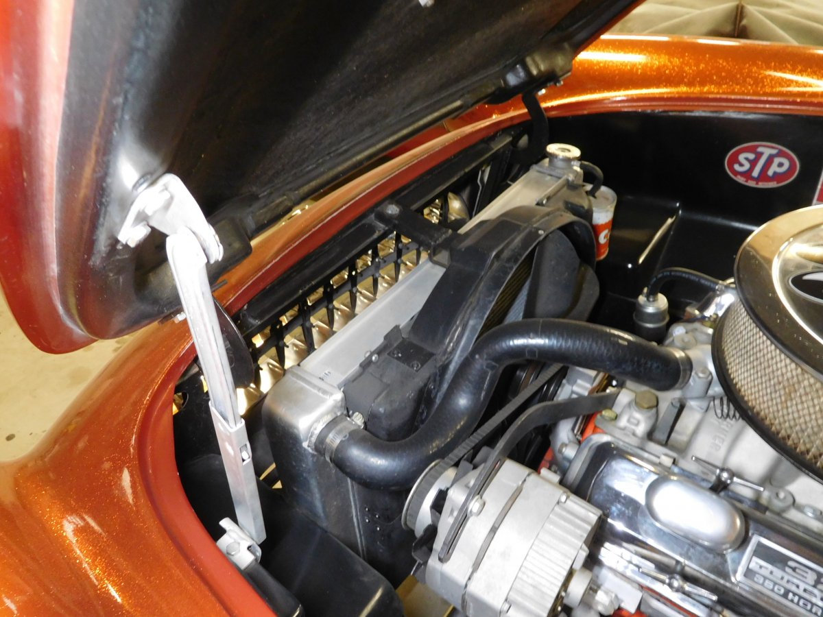

    For a radiator I decided to go with a griffin type aluminum. Once again choosing light weight and efficient. Corvettes use an angled radiator support originally and I wanted to mount the radiator vertical and closer to the engine for better cooling so I built my own . This also allowed me use a simpler fan shroud. DSCN2186[1].JPG DSCN2187[1].JPG

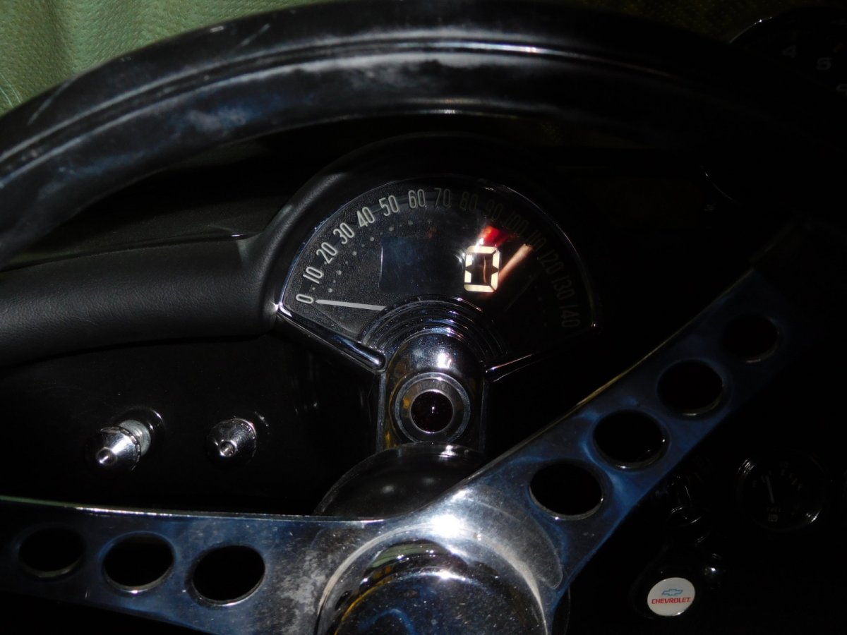

    One of the final things I needed for this car was a working speedometer. I only had a chrome speedo frame and a lens with the numbers on it . I used a piece of black plastic with a piece of pin-striping tape to create the look of a real speedometer and needle. That looked good for a while but I wanted a functional speedo. I got on E-Bay and found a cheap GPS speedo. All it needs is 12 volts to work. It was $26. It works great! I cut a hole in the plastic and used some 3M tape to stick it in place. Comparing it to my GPS app on my phone it's dead on. It's pretty slick. No messing with gears or cables. DSCN2261[1].JPG DSCN2262[1].JPG DSCN2267[1].JPG

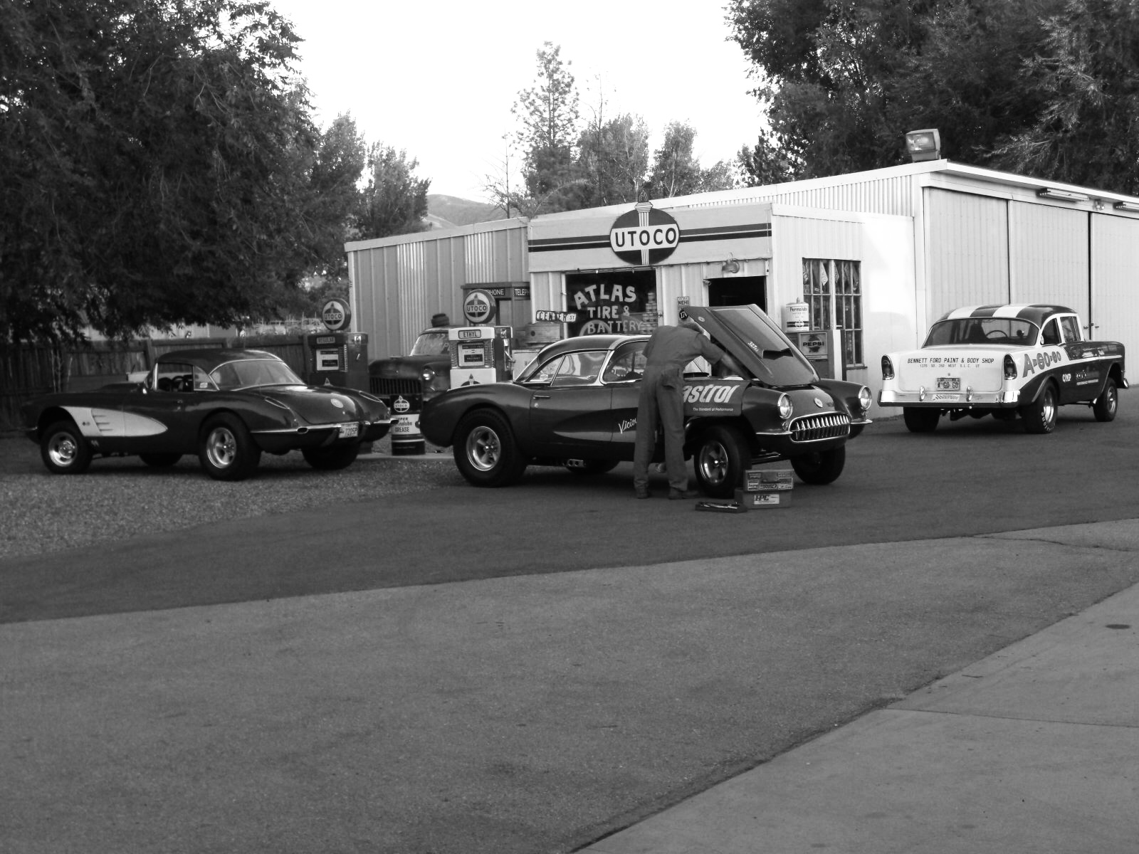

    I rounded up a couple of friends the other day and attended a local car show. My buddies ratty 56 stole the show. IMG_4991.jpg IMG_4992.jpg IMG_4995.jpg IMG_4996.jpg IMG_4997.jpg IMG_4999.jpg IMG_5006.jpg IMG_5007.jpg
