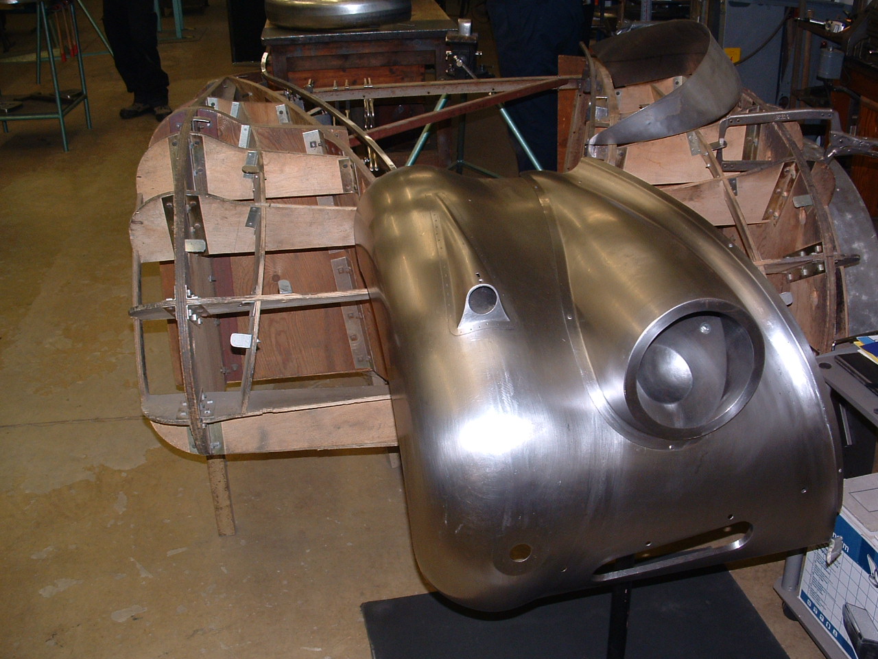

    Joe scratch start CAN work just fine. The panel below was made by Contour Autocraft in the UK and that is all they use (and teach with on their courses).
    At least that was the case when I was there.
    There are 11 or twelve welds (all fusion welded) in there - I could only find half of them......
    All the other stuff is great to have, but you definitely don't NEED it.
    Like Johnny says, it'll make you better when you can step up one day - going the other direction would be a lot tougher//
