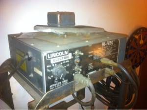

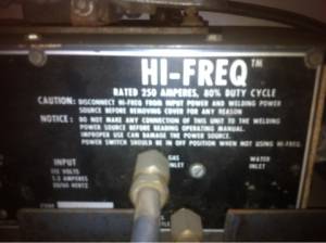

    Yes you need DC for scratch start Tig on carbon and stainless steels.
    You can Tig weld with an AC power source, but you would be using it for aluminum.
    In order to use an AC power source for Tig welding you need a separate high frequency unit to ***ist in arc starting and cleaning. (If the machine is not equiopped with it)
    The high frequency boxes were often used with AC power sources to allow welding of aluminum, or with AC-DC power sources, also to allow the Tig welding of aluminum when the machine was not equipped with high frequency.
    A lot of the newer machines are high frequency equipped when built.
    An example is my Miller Diversion 165, an AC-DC inverter power source. DC for welding carbon and stainless steel with high frequency for arc starting, and AC with continuous high frequency for welding aluminum.
    The old high frequency boxes.
