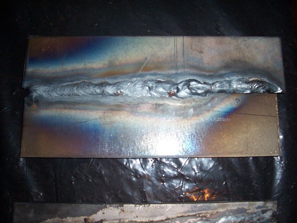

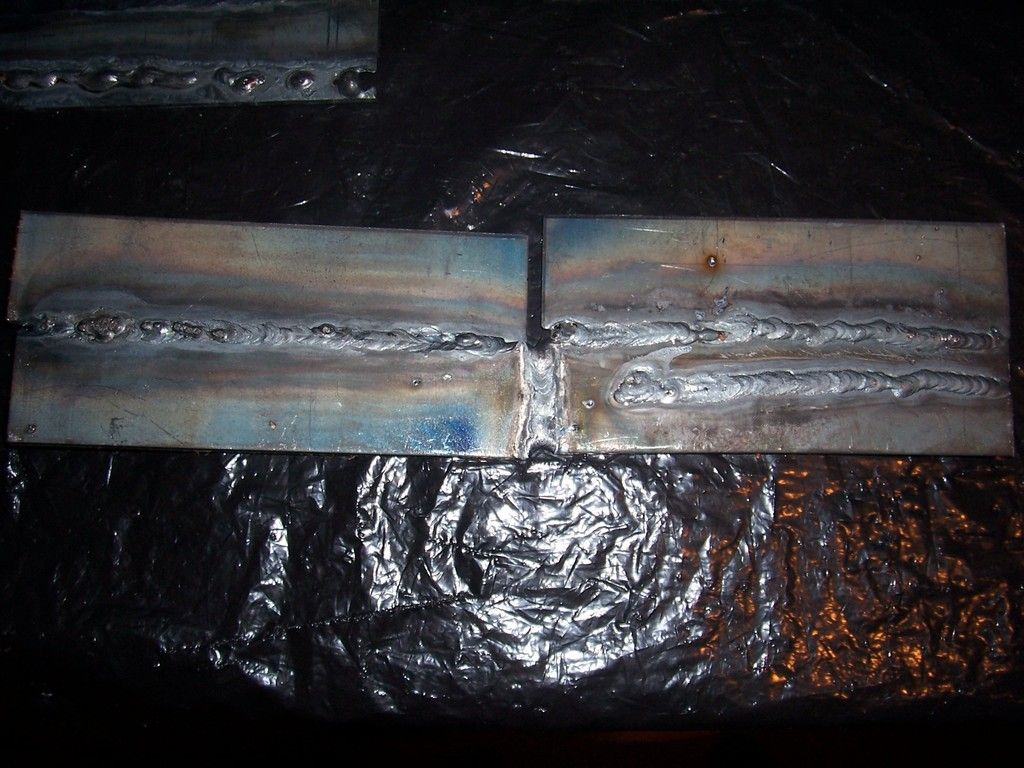

    First scratch-start TIG attempts:
    These were done with no pedal, amps set between 70-85 i don't remember which one was which and it what order.
    Gas was set a 25 gph which i think may be too high but that's what the instructor wanted so..............
    Feel free to comment, criticize, augment etc. Don't hold back----any helpful critisizm is appreciated and welcomed.

    Clean off all mill scale tig must be squeaky clean.Just run some puddles without filler rod and practice freezing the puddle and then move on again freeze again til you get the puddle under control.Don't worry about filler rod till you can read the puddle.Then attempt to join cupons with your puddle control and filler rod.Ask lots of questions.How thick was your metal what filler rod size and what amps and what welder?all is important to give a solid resoponce.
    Tig
  13. WAY too much heat for the thickness of material. Bleed through should be no higher or wider than the material. Bead size at FAR right of pic #2 is getting close to the correct shape/size. You can get the weld done with far less heat if you open up the root gap. Typical "rule of thumb" for steel is 1/2 metal thickness. Can't really tell what thickness you are welding, but it looks like about 14ga?
  14. Yep, clean the scale off first.
    With that scale there you need way too much heat to break it down and melt it, when melting it that contaminates your weld. Too much heat makes for a wide puddle.
  15. c-10 simplex
    Joined: Aug 24, 2009
    Posts: 1,371
    c-10 simplex
    So, you're saying i need to cut down on amperage?
    i think it was 11 gauge and when i first started i put it on 71 amps but one of the instructors said i need more amps, so we put it up to 85ish. (?)
  16. Here's the problem with dirty metal and tig welding.
    (tig likes clean clean clean metal) sometimes you can't have what you want - if its not then ....
    You will need more heat to burn thru the ****, junk, oxidation, and scale and god knows what else is on it. It's difficult to get a pure ground and the arc can't get to pure steel and there for ground.
    When you turn up the heat to burn that **** off some of it vaporizes and contaminates the gas covered area - its no longer inert. Some of it gets into the puddle and contaminates the weld. Some of it gets stuck on and bonded to the electrode and when that happens you need even more heat . It's a viscous spiral.
    You'd be surprised at what a little bit if dirt (especially paint) will do to your really nice bead

  18. 11 ga is about .090 give or take. 85 amps is about right, so I'm gonna say you are too far away with the tungsten, or it's not prepped correctly (dirty, or not ground correctly). When you regrind, rotate the tungsten under a light and look at the reflection. If you see "facets" like a diamond, the arc will wander. the tungsten should throw the same reflection the whole way around as you rotate it.
