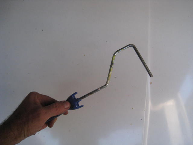

    I drank the Koolaid! I am a board-certified cheap bastard so it was a no-brainer for me. And my helpful $.02 for anybody doing this (regardless of which brand you use) is to try using one of these handles from a foam roller brush. It was PERFECT for smoothing out the stuff into all the nooks and crannies! :cool:

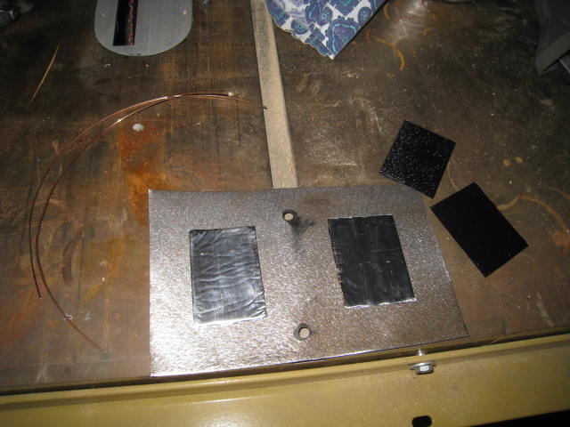

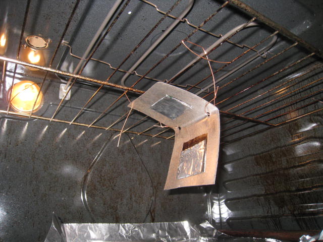

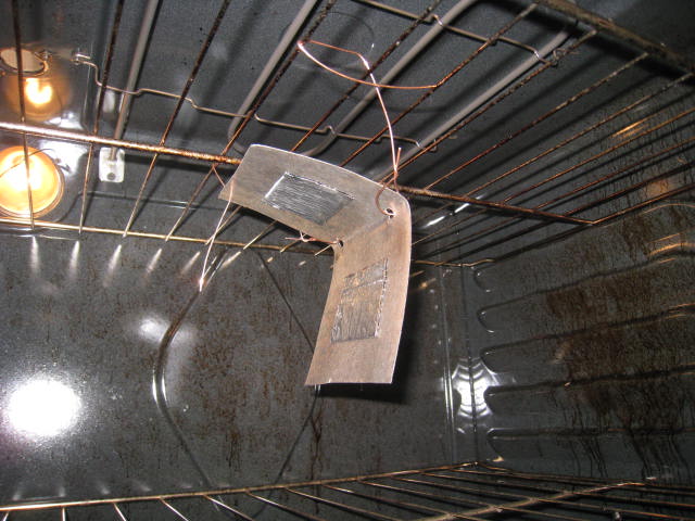

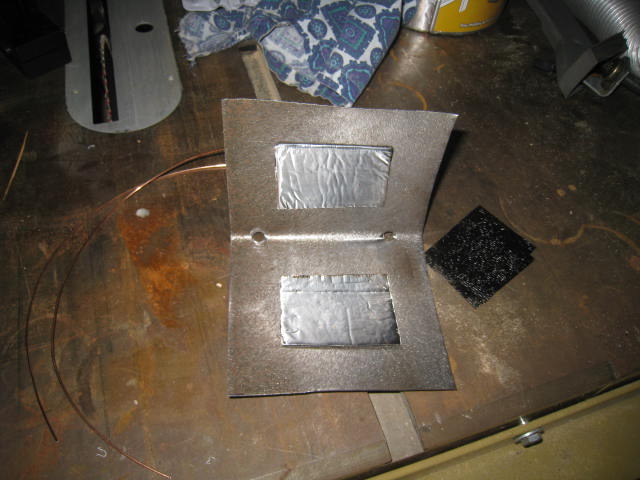

    Some have posted their concerns about this stuff melting in hot temps and I thought it was a legit point. So I rigged up a little test while the wife was away and used our oven to find out how hot the Home Depot stuff could get before it did something bad.
    The lowest the oven would go is 170* F so that's where I started and let it soak 30 min at 170*. Next I went to 190* and then to 210*. The vertical piece started to sag a teensy bit at 190* and a lot at 210*. But the horizontal/upside down piece didn't melt and fall off or anything even at 210*. So my conclusion was that I will go ahead and use it on my interior roof because I coated it with spray can bedliner (cheap-ass lizard skin) which will knock the temp down a bit and my cab roof has almost no vertical sections.
    I should also mention that I didn't notice any strong odor from the tar. There was a slight one at the start but by the time I pulled it out after 1.5 hours the heat and partial melting of the mat didn't seem to produce a powerful tar smell at all. (Your results may vary.)

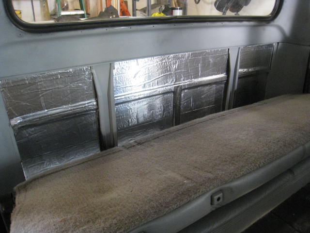

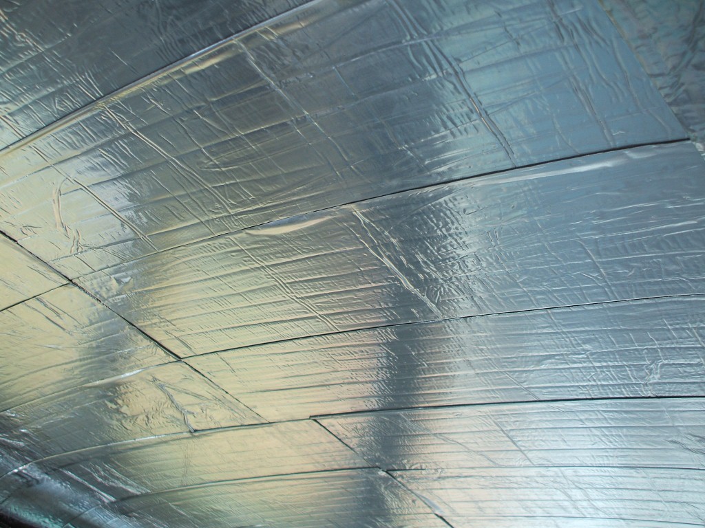

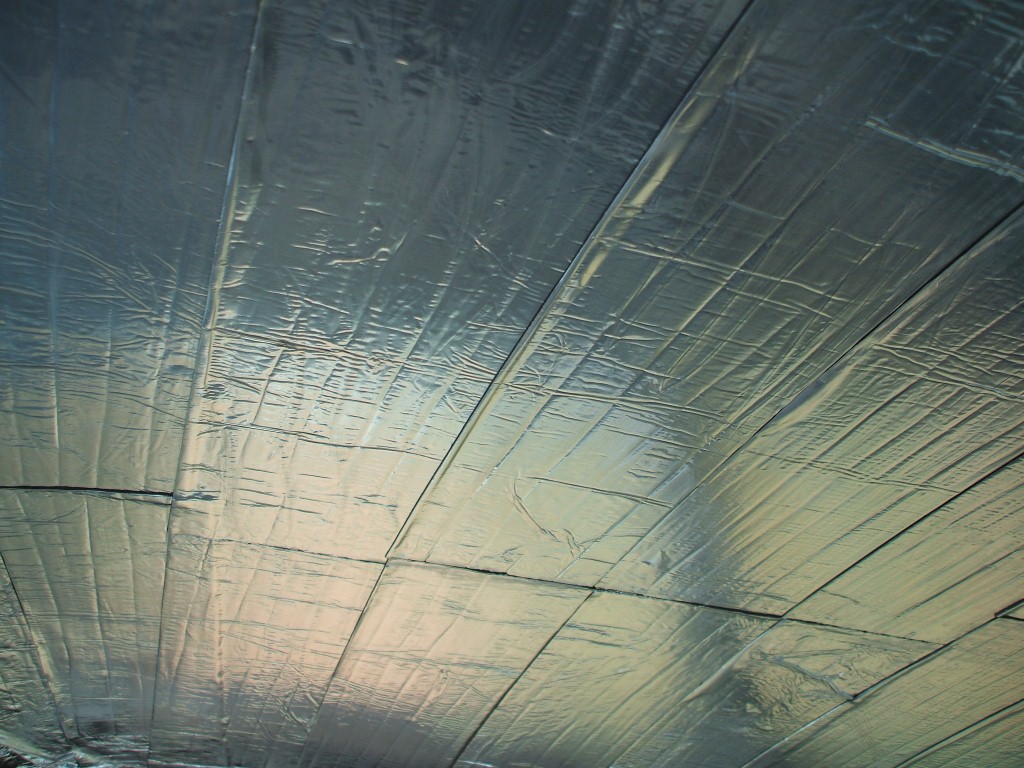

    Thought I would do an update since a Social Group member brought up this subject,my Peel and Seal has been on about a year even used on the roof of my '54 and zero problems or issues.Keep in mind we are even two days away from a record for the most days over 110 degrees here in Phoenix,I give the product two thumbs up! Here are two pictures of the roof installed,see my earlier post here because you don't want to forget the seam tape.

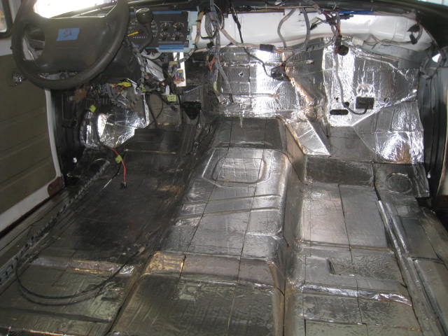

    [​IMG] Used FatMat XXX Rattle Trap (3x's thick as FatMat) on the main floor. Then Peal-n-Seal the wheel wells/trunk. Both are very good for the investment. Will double the floor and do the remainder after the Cheaters Show Sat. with both products.
