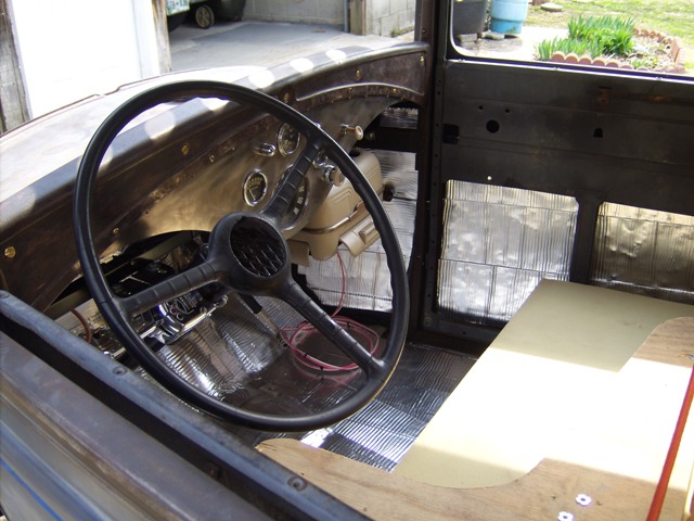

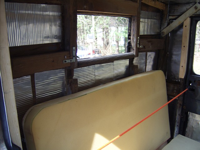

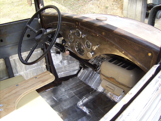

    I used a different product from Lowes. It has foil on both sides with a layer of small bubblewrap between. It is a little thicker but insulates very well. Another difference is no peel n stick. I used 3M spray adhesive and it worked great. No tar and less weight.

    I have used the regular bubble wrap type shiney foil insulation from Lowes. Its cheap, Its very lite weight, and most of all it works very well. I think its insulates 99% of heat transfer, it has a small R value which doesnt matter to me, Heat transfer is a car is what gets ya.
    I used spray adhesive and duct tape, and It has been great.
