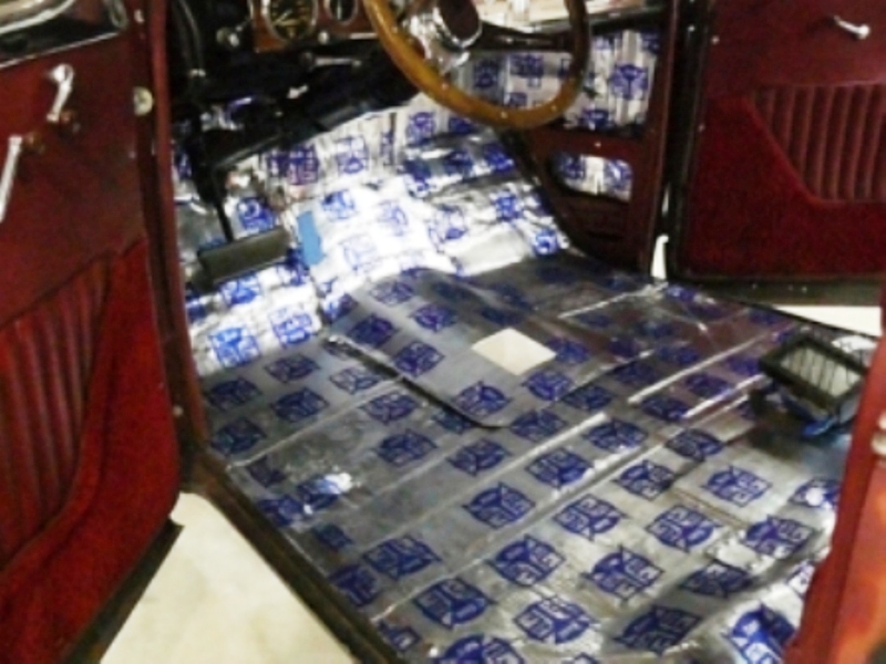

    Glad to hear someone else has used this product. I did the complete inside of my 1930 Chevrolet and it works great.

    way cool, that looks exactly like dynamat

    This looks like a clean and easy install. What did you all use to cut and smooth it out?

  10. i use it and the foil bubblewrap in tandem i cut the peel and stick with either sissors or a razor blade knife its easy quick and cheap

    I did zero prep and it stuck fine inside my door I went right over the rust and buildup. I then used a wheel to press it down and it's on there for good unless it gets really really hot apparently. I highly recommend it. It was such a big difference
