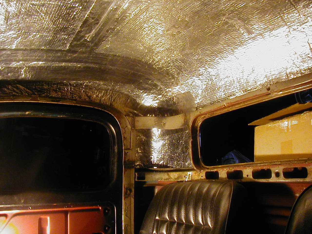

    Posts: 1,012
    unkamort
    I used the jute with reinforced foil on the roof and rear panel. I used aluminum 'duct' take to seal up the seams. You could tell the difference from the first time the door was closed.

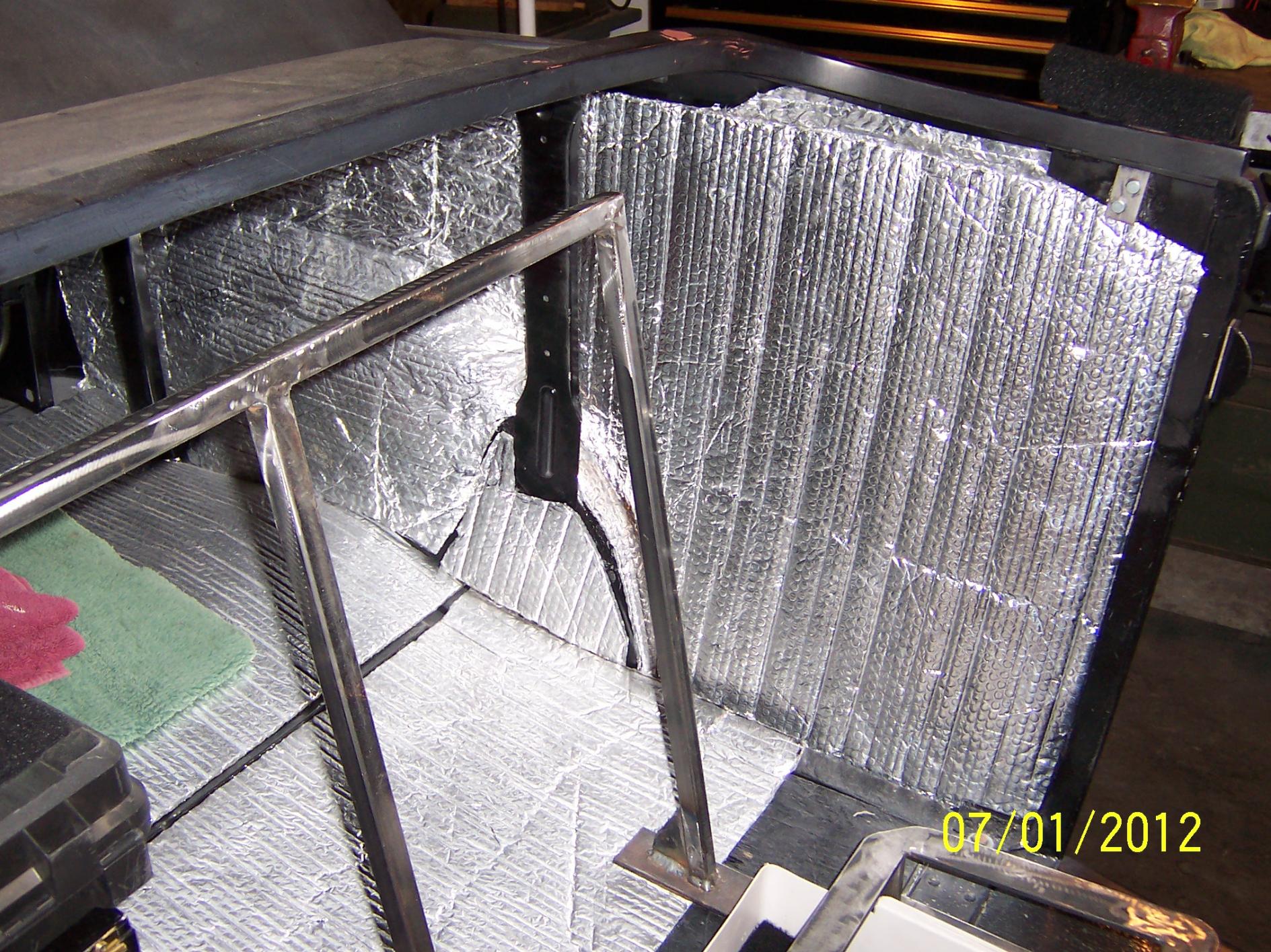

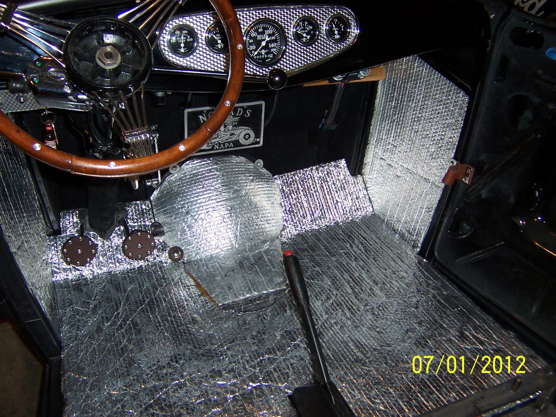

    Joined: Jul 18, 2011
    Posts: 74
    itsmeb
    I used this stuff on my 1930. Great...
