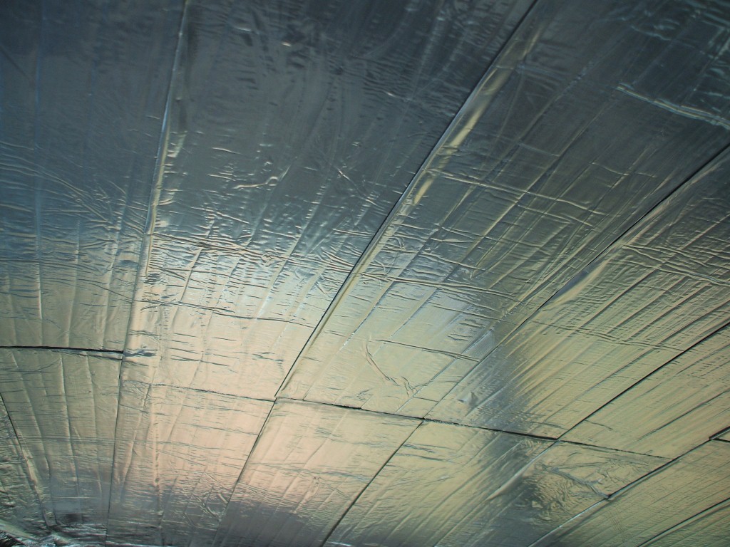

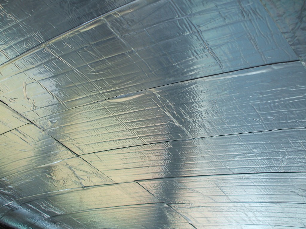

    I have to disagree about using the product on the roof,I bought this at LOWES in February and installed it they have changed brands from the former "Peel and Seal" there never has been a smell from it and the last few months we have had over 60 days with temps over 100 degrees and many over 110 there are no signs of it being loose anywhere.They do have a special seam tape I will install prior to putting in the new headliner,the big difference you can feel is between the outside and inside temperature.Here are some pix of the roof .

    UPDATE! From my post #164 The seam tape is made by Nashua Tape Products (USA Made in Franklin,KY) the Lowes sku # is 42366 99983 labeled Multi-Purpose Foil Tape 322 HVAC.It is EZ to apply and does a great job of selling the seams against "bleed through" that may happen later.
