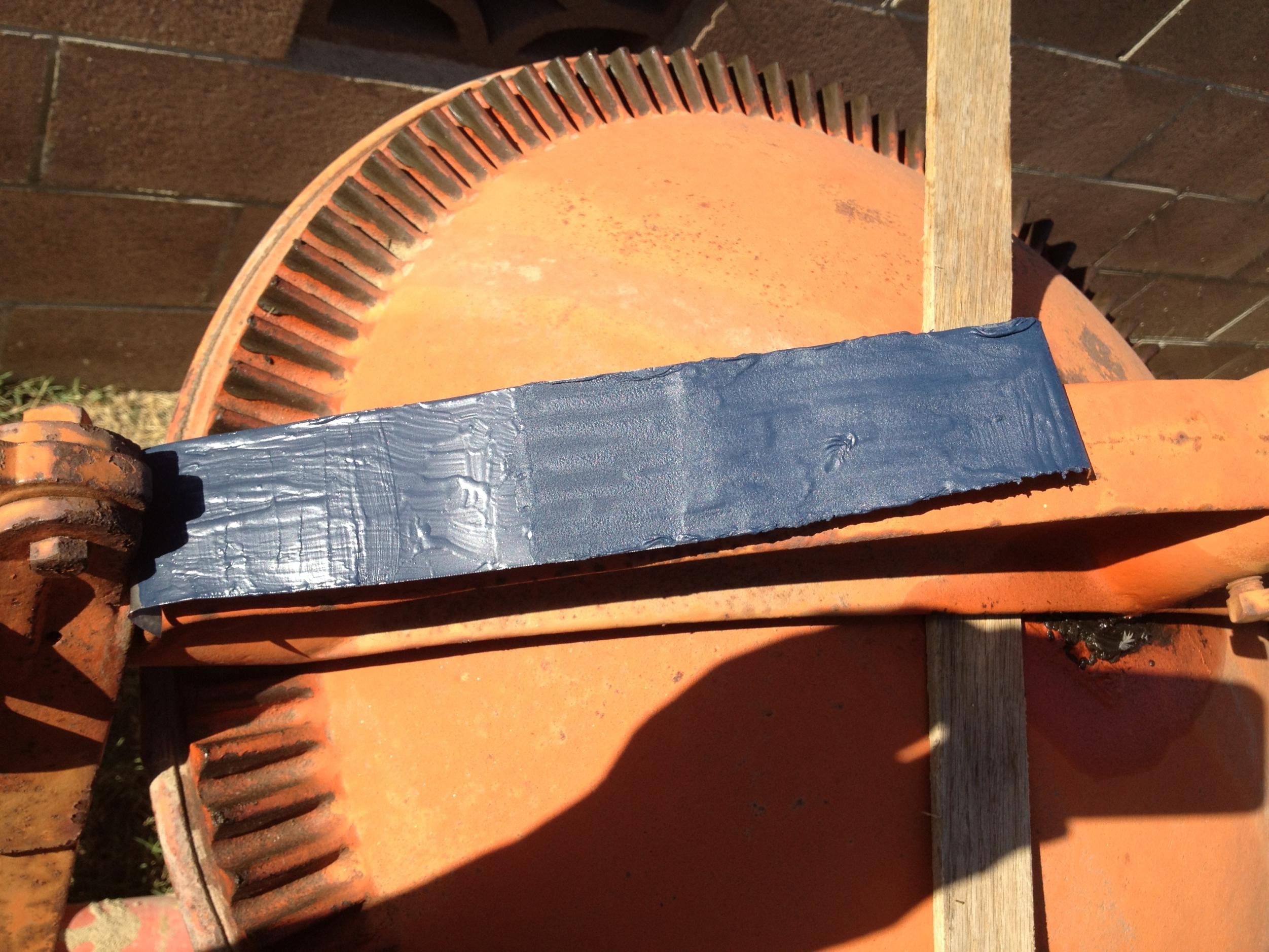

    Hi folks! So I tried making some today and this is what I got.
    Took this and added it to the paint. And this is what I got. I made a small amount to test it. I'm going to try that roof paint and just regular white paint tomorrow. I'll post the results for you guys then.

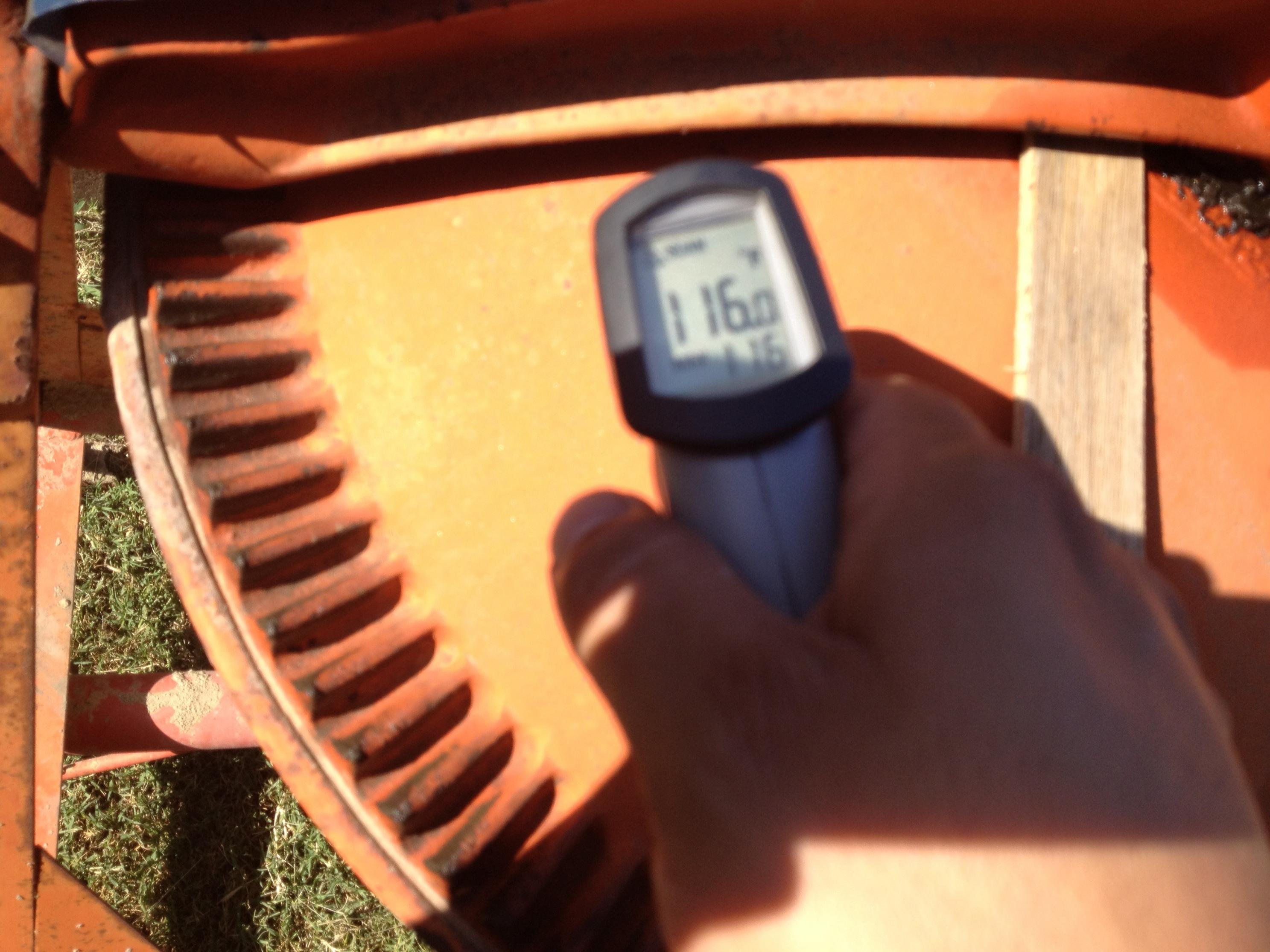

    the top of the test panel has the ceramic in it, the bottom half just paint. and then i took the temp off of the cement mixer. my test panel was only on the cement mixer for about 30 minutes. so its not much to go by, im going to try this again, but for now i just wanted to share what i got.

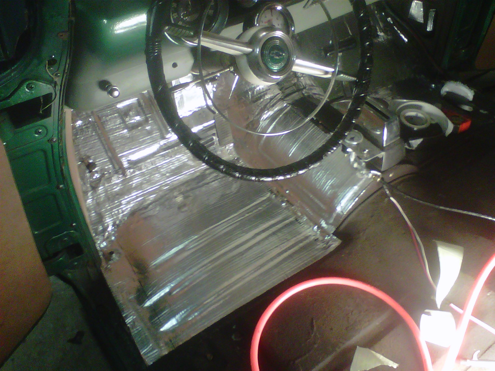

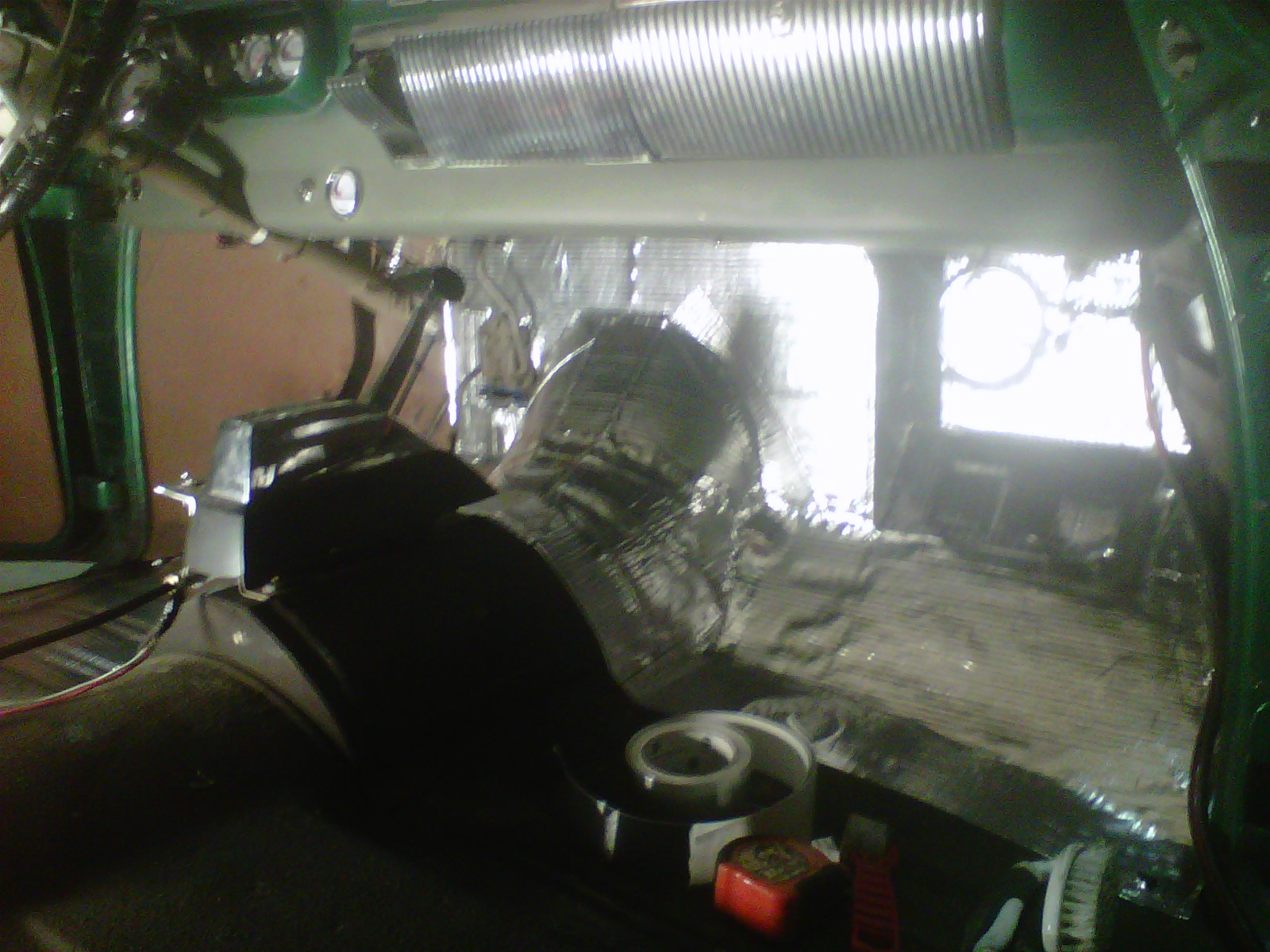

    After reading this entire post, I desided to jump on board, I started last night at the top of the firewall and running thur the entire car including doors, floors, trunk and roof. I found the BIG roll at lowes for 86$ and Im using a hand roller to burnish it to the panels, also picked up a big roll of alluminum tape for all the joints and edges.
    Some Questions by others is weight this box says it ways 32 lbs and thats 100sq. feet of it. And there is no smell, I left a piece out side in the sun yesterday 97 degrees, and still no smell.
    Godspeed
    MrC.
