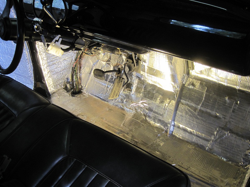

    This what it looks like in the truck. It seemed to stick well. I am anxious to see if it helps and how it holds up.
    Also in this picture is the Z gate I made for my column shifter. Last time I ran the truck I shifter from low directly to drive 3 times. I had to idiot proof my shifter.
