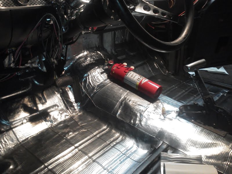

  13. johnybsic
    Joined: Oct 8, 2009
    Posts: 612
    johnybsic
    from las vegas
    I actually ended up doing this in my 55 chevy.
    I used DP90 Epoxy primer on the interior and the Peel n' seal stuff is sticking great.
    I've kept an eye on the vertical firewall areas, and it shows no signs of letting go.
    Its been in for a month now, its been in the sun alot, along with running and driving heat. Ill say its held up good.
    It applies pretty easy, and was kinda fun to do. Its one of those projects where you just FEEL like your making you car BETTER.
    I had absolutely NO out-g***ing, like null...I had to basicly stick it to my nose to smell it. IMO, the whole "Makes the car smell like asphalt" jive is just BS. IMO
    I have no carpet and the stuff has held up well to rubbing, tools, feet etc, My chick wore heels for a car show one day so i just said to be carefull as far as tearing the stuff was concerned. but theres been no issues.
    I've never noticed my feet getting warm, even on long drives :D. never had that from any of my old cars!. i LIKE it.
    now... i used it for heat, and to take some of the "tin can" sound out of the car. it has helped with both. You can tell.
    i have no radio, so i didnt use it for a ground pounding system or anything. BUT for me, it does a very good job. at making the car "More better n' plesant like"
    Also another upside is it covers up any holes you dont want in the firewall or floorboard. you can cut it out later if you decide to use the hole again.
    cuts down on road heat and draft really well.
    ***Also gives your ride that "air de elegance" Race car look ;)
    I will use it again on my next project.

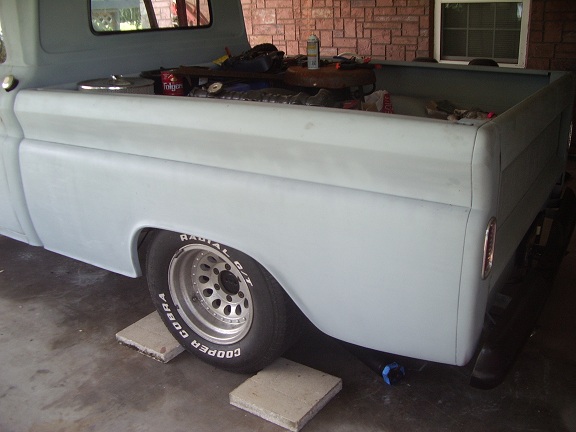

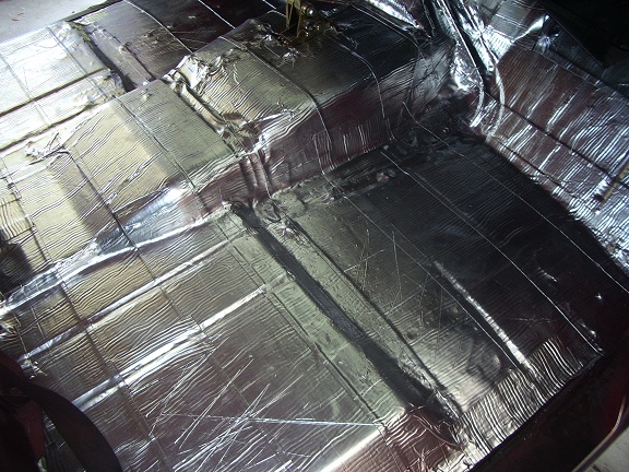

  21. brad chevy
    Joined: Nov 22, 2009
    Posts: 2,627
    brad chevy
    Did the 61 Chevy C10 this morning. 3 1/2 rolls $16.99 a roll,man this stuff is easy to work with . Got the rear lowered now too using $169 lowering springs.:cool:
