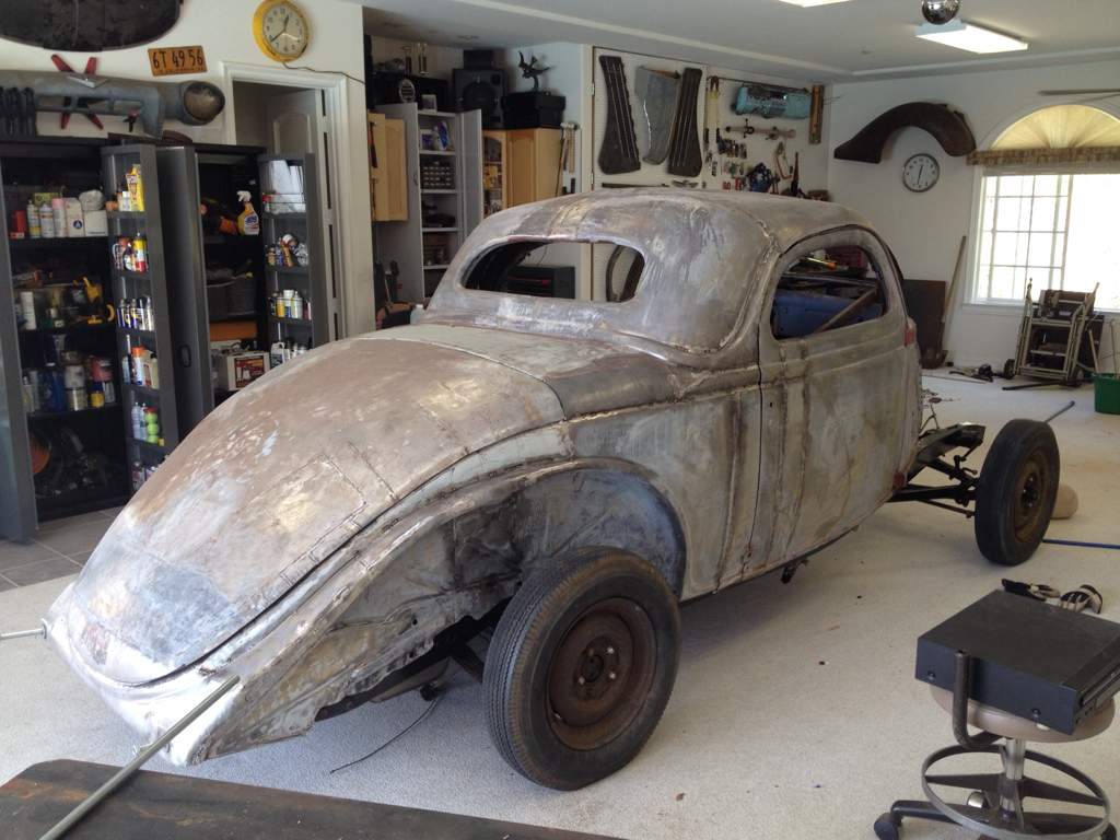

  10. Not much action. Life has seriously been getting in the way. Some dressing of joints. Found some roller wheels and tires from a 40. Put her back on the frame cause I may be moving again. butt needs to go wayyy down. View attachment 2117394 View attachment 2117395 ImageUploadedByH.A.M.B.1390011287.569368.jpg
  13. Moving day. All fenders, dash, hood parts loaded in the cab. Last few months have been all about moving. Hope to get back to it soon, having withdrawals. ImageUploadedByH.A.M.B.1397360229.435220.jpg

  26. Thanks guys. I reeeaalllyy want to get back at it. The main problem is that the man cave doesn't have a garage door so I'm bringing the car in part by part. The house has everything else we wanted so what the hay...
    So now I'm down to the stripped body and then the frame which will have to go through a sliding door with both panes removed. The garage door will have to happen later. All the carpet in the cave will have to come up before much grinding or welding can happen. Right now I'm drinking a corona and watching the padres ( kinda ) so it probably will be a few more years before it drives out under its own power. Doesn't matter ,,I'm convinced it is the journey not the destination that is the sweetest part.
  27. Had to wait til the wife went out for a few hours and the kids were at school but I got er done! I floor jack some hedge clippers and some wood scraps was all it took. Another milestone. Problem is it ain't coming back out til I punch a garage door in the place!

  29. Ok. This is for the Man, Heyitsnate, Keneth, and Kippers. I've got no excuse. You all are awesome fabricators and I'm not worthy of you all. But you motivate me. Reading your posts make me wanna get off my ass. So I hit the shop today. I worked on cleaning up welds and trying to finish patches on the passenger side. Things went well. Got the patchwork done and knocked down a bunch of internal welds. Plan is to do drivers side same way then work on channeling the floor. I wanna see this thing in primer soon. I'm gonna hold off on fixing the door tops til I get it to ride height. I wanna see if the controversial window taper stays as a signature or if it's gotta go.
