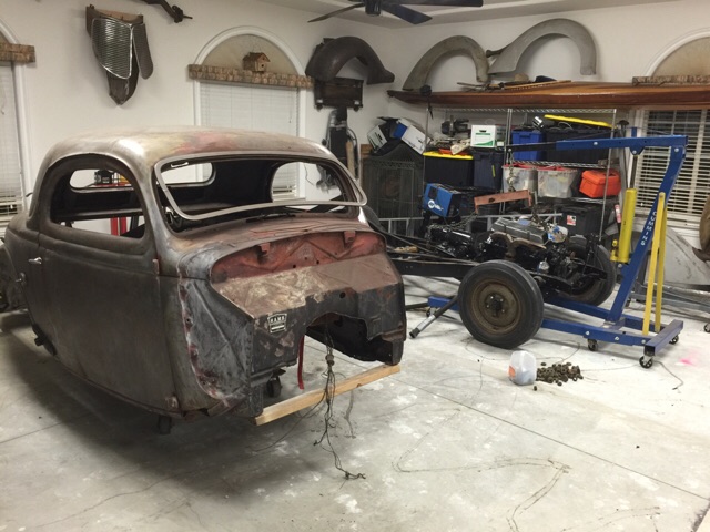

    My ADD or whatever it is said the body had to come off the frame so that frame mods and body work could happen at the same time.

  8. Wow your frame is nice looking. Most of the 36s I've seen are pretty rusty. I'm replacing 75% of mine.

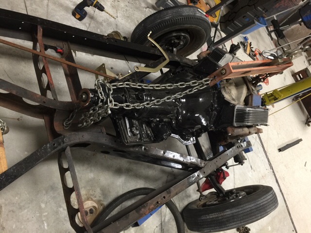

  9. Thanks all. I guess the frame is pretty good. I took it for granted I suppose. Black paint and a camera phone helps too. It does have some heavy pitting on the tops where the body rested . Nothing that would affect the strength. I managed to sneak out today and remove all the rivets holding the center section of the crossmember. About 25-30. The final one was the battery box crossmember. As the last rivet popped out the drill bit caught in the hole, spun the support 360 and whacked me right up side the temple. I'll be sporting a nice purple badge for Christmas.
    Maybe tomorrow , when things die down, I'll sneak out and make my cuts in the crossmember to make room for the tranny.

  14. I'm at a crossroads. I have done a fair amount of work to the rear frame to get the body channeled 6+ inches over the frame . The body sits down on the modified rear frame nicely. But then all the sheet metal mounting points will have to change.
    I've been having impure mustang 2 thoughts about the front..,.
    Otherwise my thought is to modify the front wishbone widening it around the tranny and extending it back 10 inches with some sort of z in the middle of it to maintain henrys original type setup. Never seen it done but seems more sensible than splitting the wishbones..... Oh the agony.......

  20. Fabbed up the rearmost sub rails. Put the body back on the frame to figure out where exactly to attach the sub rails to to the wheel wells. Have had a dry spell mostly because I couldn't decide on which direction to go. I'm sticking with my original plan of channeling the body over the frame. Apologies to The Man I was asking him to make me some CNC parts and then I backed out. Probably not the best way to do it but I'm pretending it's 1950.... ImageUploadedByH.A.M.B.1423357572.898503.jpg

    Lowcoe, Thanks for posting the pics of your rear subrails, I've been curious as to how you where going to connect the body to the wheel well/frame rail kick-up. Now, will your floor pivot on the rails from the cowl mounts rearward? Also will you need to modify the cowl mounts?

  24. Thanks telekenfun. I have to slice into the front most part of the cowl feet area as it does pivot on a spot back from the front of the cowl about 6 inches. I'll take some pics tonight. I hesitated because I know that it's gonna lead to issues hanging the front sheet metal. I envision the pivot point being the headlight stand area but am winging it a little bit. And yes I do see more work ahead on the roof. I'm hoping Kenneth can come over from Scandinavia and help me wheel out a new one one of these days. Maybe if he ever makes it out so so cal on the show circuit.
