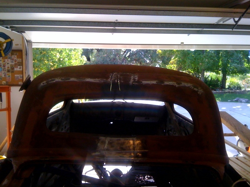

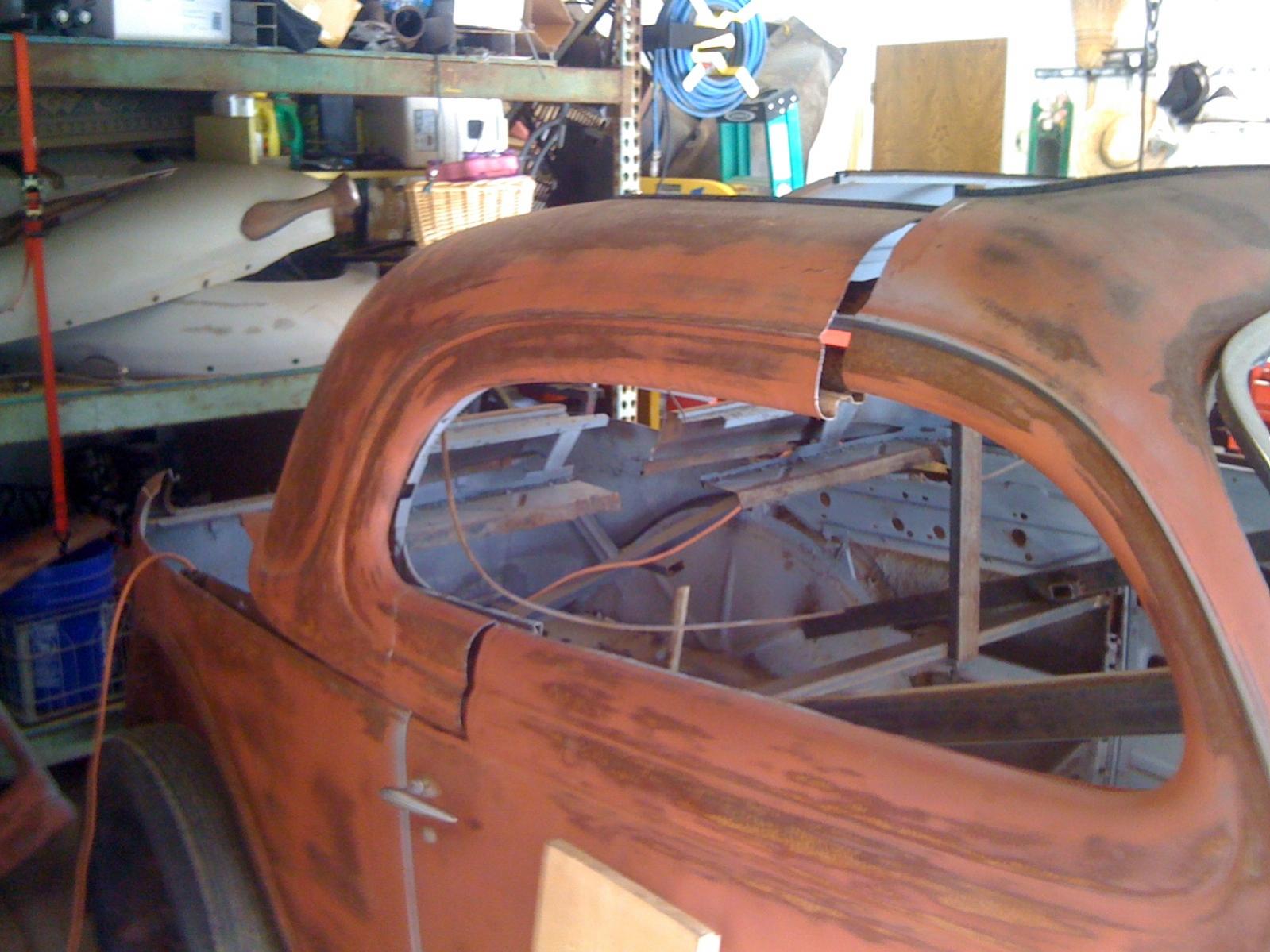

    Ok so I bet you all were thinking things fizzled. Not so. I just had to think on things a bit. The main thing I struggled with was the ch***is. Do I keep it stock or do i cut that too? Or even repace it outright with something that would get me kicked off the HAMB. Well I have decided that I didnt have the heart (or the time) (Or brains) (Or talent) to chop up the frame too. So there goes the Idea of widening the car (many would say thats for the best). What you will see in the pictures is that I am extending the doors about 5 inches. It will give the car a chopped top look without loosing the headroom. Since the floors are toast Im planning on raising the floor in the rear upwards of 6 inches to get the Taildragger stance I want. Im trying to get it to a point that it would be safe to move it because there is looking like there will be one more move in my near future. I did the drivers side first and learned a few things about where to cut. No major problems yet. Ignorance is bliss.

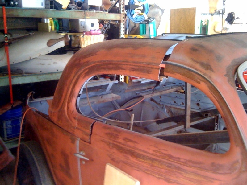

    Time for a little update. Basically I got the p***enger side to match the drivers side and then tacked it in place. I'm extending the doors about 6 inches to give the illusion of a chop but still have some headroom and leg room. Everything has gone pretty well. As I tacked it all together I had some strain so i ended up taking out about a 2 inch pie shaped piece from the curvature of the rear roof. Once i fill the gap in the midline between the two cab sides it should be secure and ready for my upcoming move. I figure my next task is to move the door jambs back the 6 inches necessary to match the window opening. Then I will work on the channel. I plan on about 6 inches in the rear. Im putting off the trunk area to last as it seems like it will be the toughest part. Also a little inspiration pic that I took at the GNRS.

    NOT widened and not gonna be...he gave up on that! (Thank you! :D)
    I think the gap in the roof section is due to the center of the car being naturally wider than the rear section that the roof originally matched.
    You're off to a good start! Keep it going!!!

    If I remember correctly the back of the sedan top is considerably more narrow than a coupe top...thus why he had to widen the top???

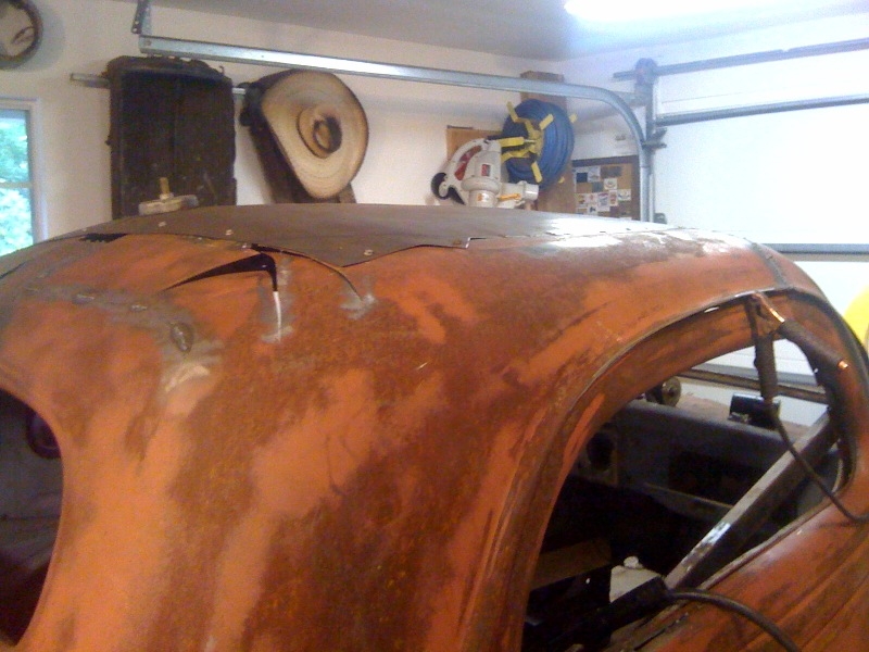

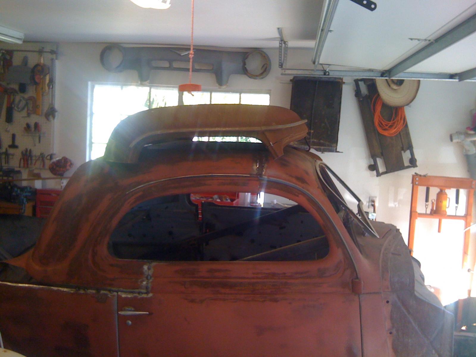

    Sorry to my friends in Norway. Here are some new pics. Tex Smith said in his book about chopping tops ( although Im not chopping the top ) that the roof off a 53-36 F 100 makes a good donor roof to fill the insert panel. Just so happens I have a friend with a burned out F-100 that was willing to be a donor. I hope that the fact that it was in a fire doesnt weaken the material. I have just finished de rusting it with the electrolosis technique : washing soda and a battery charger. I used an english wheel to remove some of the curveature in the panel. Also I have decided to turf the rolling ch***is to a friend of mine. He has probably put together 10 or more cars in his life time and is a mechanic by trade. Im not sure if I can talk about the plan with out getting booed off the site so Ill keep that part under wraps for now.
    I like the idea of a 40 trunk lid. I think I have seen that done more than once. It seems to work well on the back of these type of cars better than a small opening. Since it isnt going to be a stocker anyways it may be the way to go. I will have to look around and see if anyone has one for less than ol bob D.
    I have it setting on a rolling table at approx ride height. Before removal it was braced well. Ill work the roof through to completion and then decide what to tackle next its either rear or doors... I hope to have the ch***is back in 6 months or so.

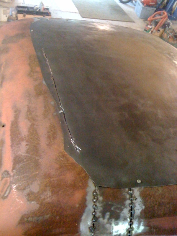

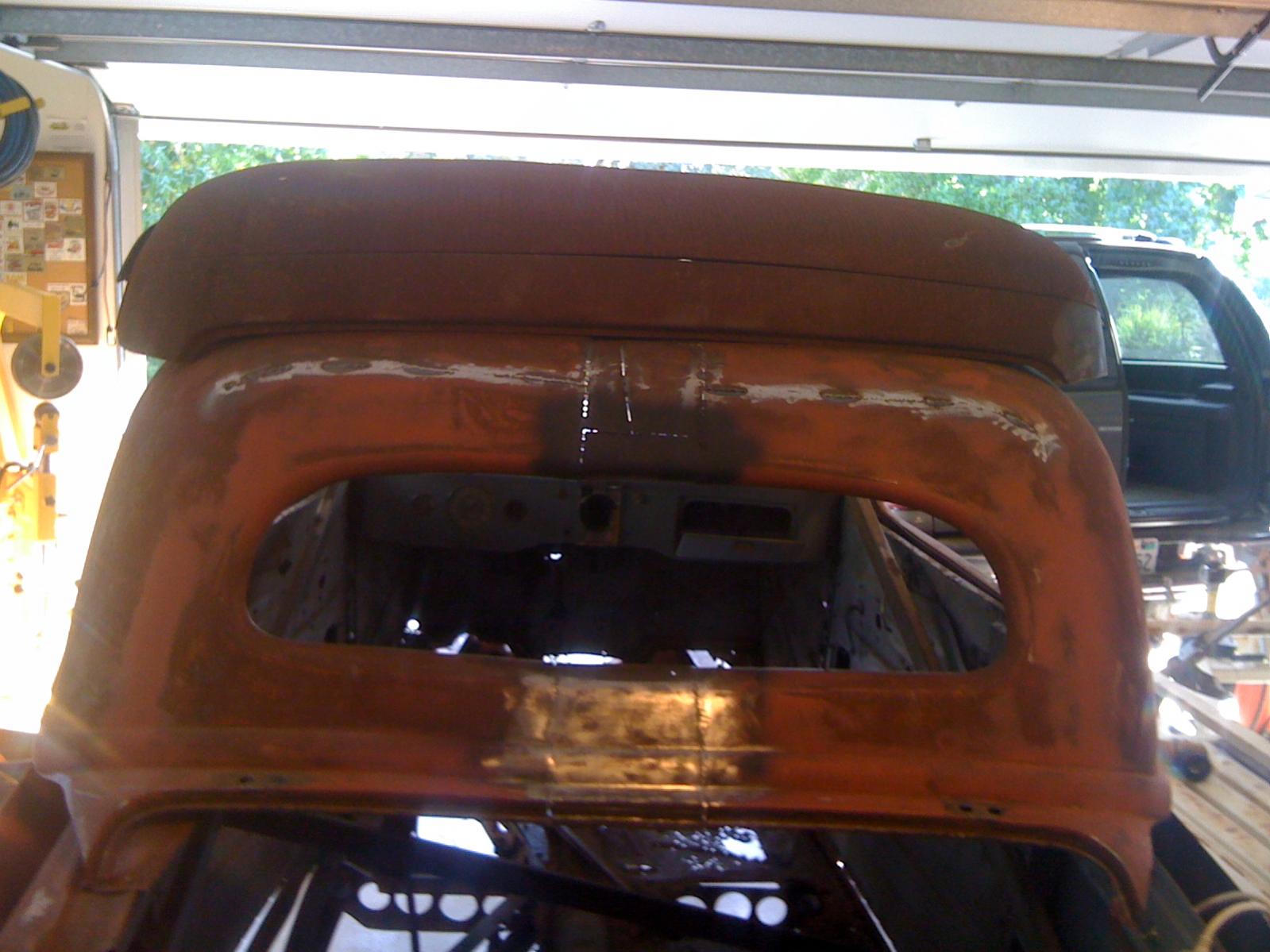

    Little update on the roof filler panel. Got it in about 75% of the way just the back edge to do... running into some strain at the rear curveatures of the roof so Ive been placing some more pie cuts in to get things to flow.

    That roof looks completely wrong Have you pushed it outside for a decent look?? Looks like a VW Hebmuller......
  30. Emperor Chris
    Joined: Oct 9, 2007
    Posts: 481
    Emperor Chris
    I agree.....I think you need to take a look at it and compare it to a 3 window. Now is the time to make the changes......good on you though to take this on. Subsribed.
