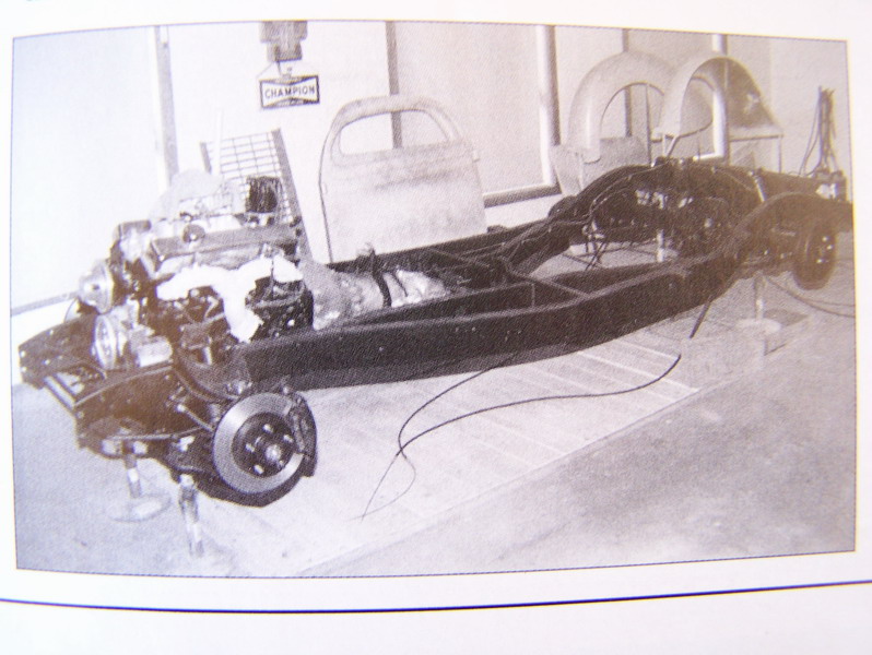

    I found a old article:
      174.6 KB
      730
      197.5 KB
      741
      162.2 KB
      632
      205.7 KB
      608
      173.8 KB
      634
      121.3 KB
      610
      150.7 KB
      670

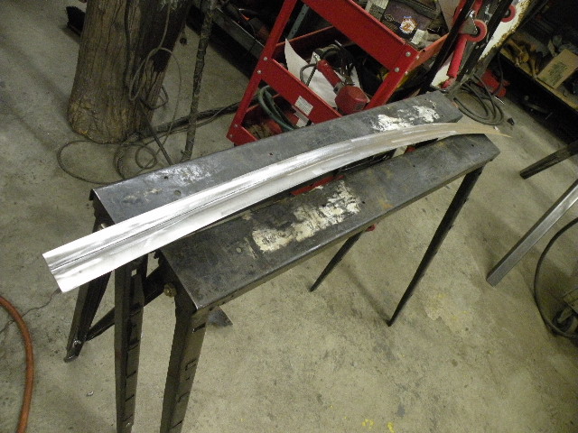

    More pics:
      149.2 KB
      487
      150.7 KB
      431
      126.6 KB
      431
      159.5 KB
      426
      116.3 KB
      416
      138.6 KB
      414

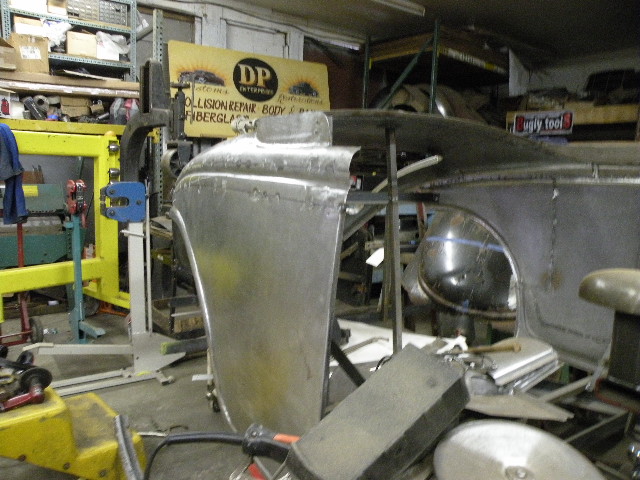

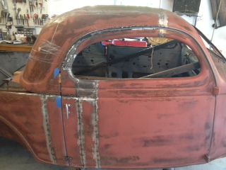

    Hello all, Betcha thought I gave up. Unfortunately life got in the way for the last six months. The usual stuff that always gets in the way. Nobody cares about that stuff. The gist is that it gave me time to think and plan a bit. I was sorta intimidated by the doors. I hadn't checked the post for a good 5 months having been a bit discouraged. I was surprised to see all the words of encouragement. That got me motivated. So here's some new pics. I lengthened the p***enger door by 5 inches. I really like the way it looks. Remember I'm shooting for long and low taildrager type setup. The curvature of the door comes from the c pillar of the trunk back. Reading over my old posts I had to laugh about getting the chasis back in 6 months. I have to come to terms with the fact that im not a Norwegian Superhero... Im on a slower track than that. Oops dunno how to post pictures from an I pad. I'll do it tomorrow.

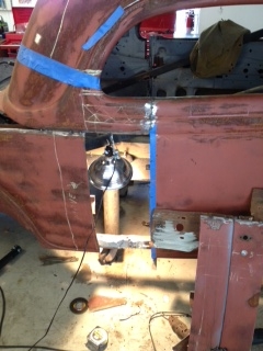

    Here are the pictures that I promised. I just have to cut along the back of the curved part of the door (yellow chalk line) to allow it to open then rebuild the inner parts.

    Door opened

    I'll take that as a complement Neal. I had the day off today so after dropping the kids at school I decided to try to get further on the p***enger door. I'm using the old square door frame and old door jam to finish making the internals of the new rounded rear part of the door. I also had to remove the cool rounded relief to make the body lines closer to the original version. I still need to raise the rear belt line as Mr Man noted a while back. I'm going to use the piece attached to the door jamb in the pictures but I will wait until I finish the drivers side door as well.

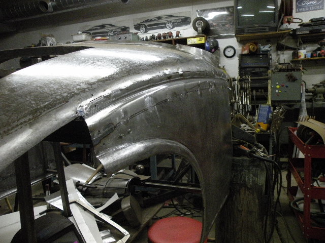

    Progress update. Right side door together still needs finish welding. Spun car around and started the drivers side. Got the outer door panel tack welded. Once I finish roughing in the drivers door I'm gonna put the body back on the frame to check that everything seems right. Then I'll move the rear window up to correct the belt line and lean the rear of the cab forward a bit.

    That looks like ****. You've taken too much out of the back of the door. To be honest i reckon you have ****ed it up completely!
  25. williebill
    Joined: Mar 1, 2004
    Posts: 3,481
    williebill
    That does NOT look like ****. Keep going,it's gonna turn out fine. Takes big balls and a lot of work to pull this off. I like it.
  26. flynbrian48
    Joined: Mar 10, 2008
    Posts: 8,693
    flynbrian48
    I'm not going to say it looks like ****, but the door top and top don't look "right". The proportions are off, is the back of the top too low? A lot of work to go to if it doesn't have the right look. Somebody else pointed out that a '36 3 window is just about perfect, if you don't get it right, it's going to look really, really wrong.

  29. The drivers side looks good but the p***enger side is too low in the back. You need to raise the back of the roof and the back of the door so that the radius is smooth and the top of the door level. Not sure how the roof ended up so different on each side. The drivers is perfect looking.
  30. i agree and the drivers side is looking great. keep at it and it will all come together. no need to rush it, time will make it perfect, youre a do'er and thats awesome! dont listen to the dreamer....
