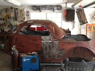

    Its getting close, to me your need lower or chop the front of the roof, basically it looks like its all sloping backwards, so hence chopping the front would help.
    Also, try and stand back as far as you can and look at it, something when your right on top of things problems or proportions arent as noticable.

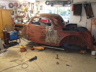

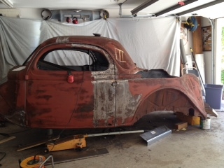

    Ok for those of you who like to squirm a little when you look at your internet...here's an update. Spent the better part of the day getting the drivers side to the Same stage as the p***enger side. Keep in mind I'm not quite ready for paint yet haha. Also I didn't have spare coupe door tops laying around or want to pay marcel to make me some so I worked with what I had. If I come across a set of coupe door tops in the future I probably will replace these. Remember the car is sitting at approximate ride height. Nose up,tail down. Next step is to raise the rear of the cab 2 1/2 inches to get the belt line right an also lean the rear window forward. Also I cut the door frame from the c pillar at the height of contour of the drip rail. Thats why there's a gap between the roof and the door top. I've got a plan. Never fear.

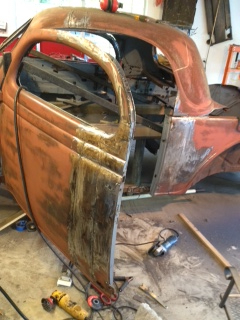

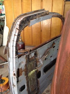

    Couple more pics. First one gives you a better idea ow how i started on the internal of the door jambs. Sorry if i made anyone nauseated. Didn't bother with the door bottoms as theyre rusted out and replacement panels are on the way. You can sorta see my proposed cut line to loose the rear window and lean it forward it's in yellow chalk.

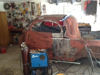

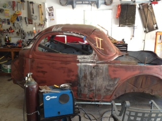

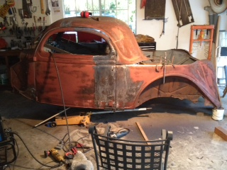

    Ok A little progress if you care to call it that. I have some pictures... I cut the rear roof loose so I could get the beltline right. After I cut it loose i took some pictures with the roof laid forward to different degrees.. As always I thought I would throw it out there for discussion. Keep in mind that things are just laying loosley from the doors back and there is much to do to get things ****oned up... Hold the pictures at arms length and get the general feel. I marked the three positions I,II,III. Personally I am leaning towards position III.

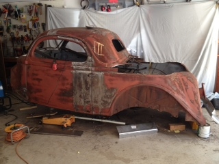

    Update: Thanks to The Man the beltline has been put back in place. The cab is tacked in the approximate position. Pissed off the neighbor with all the cutting and grinding. Apparently he likes to take a nap fridays at 3. Thanks to Rogerradar I got some new ems pieces, tailpan, door bottoms rear quarter patch panels at used prices. I will be taking car builder up on his offer for accent line pieces once i decide on how far back to set the tailpan.

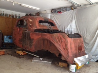

    So this is what I settled on.. Ive got it all secured with metal screws. Have to go back and cut and weld.... I was toying with the idea of getting a tig welder... I think it looks pretty nice. I had a moment of doubt when I was looking at the profile. I thought the deck was too high. I went back and looked at a ton of 36 pictures. In the end I saw the Norwegian coupe and felt that it was simmilar on deck height so I think I will leave it. Notice I have the tail pan mounted I think my length is 9 inches behind the original and that is already 2.5 inches longer than an original coupe. I also scored what i think is going to be a cool deck lid. I hope it works or can be worked in.... should get it tomorrow.

    Man, Carbuilder told me that the tailpan was made slightly oversized so it could be overlaid as a patch panel. He advised needing to trim about an 8 th inch off each side. Because I am extending the tailpan somewheres between 7-9 inches it seems that I will have to narrow it 1/2 to 1 inch as the tail tapers as it flows back. I got my deck lid today doesn't seem like its gonna work. It was off a 37 zephyr.... I was thinking coupe but it was a sedan.... The picture was grainy and the price was dirt cheap so I jumped. It's not a bad piece but it's all wrong for me. I need to go back and look at how you constructed the gutter around yours... I'm in the market for a deck lid if anyone has a lead....
