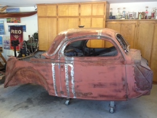

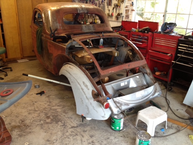

    So Ive been reading up on all the 35/36 builds. I have come to the conclusion that I am in way over my head. Nevermind that. I put in a full day today and I had so much damn fun that you all will be sure continue to be tortured with my shoddy work..... Sorry.... The roof was set today. Heres where its at...

    Are you SURE you don't want to make a Ute out of it? Third pic looks like a great start. Trunks are overrated... :)

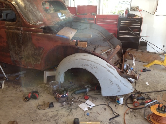

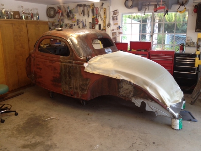

    Progress report:
    I got some motivation in the form of some new old parts from kb cookout. There were several areas where I had missing pieces and where I tried to whip stuff up from scratch I caught a lot of heat so I decided to rescue some unloved parts sitting in a field in kentucky and put them to good use. Most importantly is the deck lid gutter section. It looked rough in the pictures and unfortunately it is but it will make a good template so I get the dimensions right. I agonized on whether I truly wanted to extend the tail pan section but in the end I decided to go for it. I almost think I had to after lengthening the doors like I did. I ran out of welding gas so be warned these are more work in progress pictures... I promise some day Ill dress all the welds and make the thing purdy..... Here Goes.......
    At last no more UTE jokes...
  9. Bring down the trunk lid and it will almost look like a 1938 Zephyr back end.

    Progress Report:

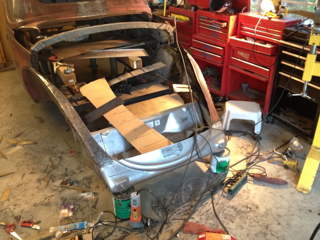

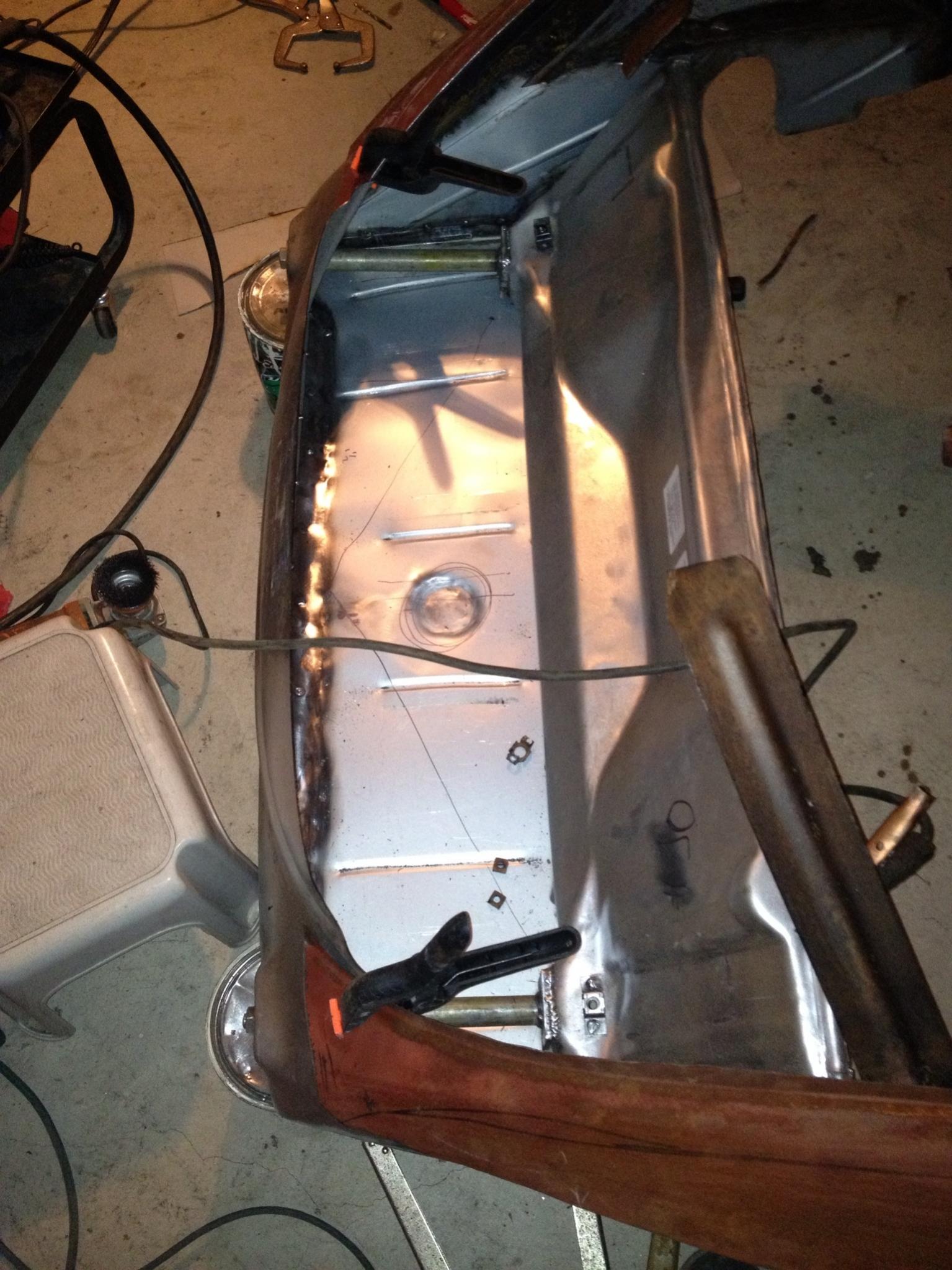

    Well I continue gathering parts. A lead on some 37 Packard rear fenders that I thought I could use to extend my rear fenders gave me a boost. (Turns out 37 Packards are very close in contour just a bit wider.) While I was talking to the guy discovered he had a pretty nice 39 deck lid. I scooped the deck lid up on the chance that I could work it into my build. I had scoped out a 37 deck lid before but it was pretty beat so I didn't pull the trigger on that one. A few days before, here on the HAMB, 2 decent 36 deck lid skins came up for sale and, luckily, I scored them as well. Now I have a good problem, too many choices! Either way someone else is gonna get a deck lid! I'm gonna fab up a basic pair of hinges for the 39 deck lid that will allow me to move it around a bunch and find just the right position to potentially graft it in.
    Also inner and outer tail pans are in place as well as the floor section in this area. Looks like a good place to stash a battery and ??

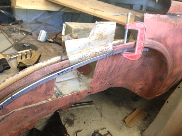

    I used the fender above the wheelwells and then flipped it over to form the curve of the trunk also I plan to use the 36 deck lid because strangely the 39 lid made the car look like a 39. ImageUploadedByTJJ1351396628.902669.jpg ImageUploadedByTJJ1351396645.419799.jpg ImageUploadedByTJJ1351396673.874401.jpg

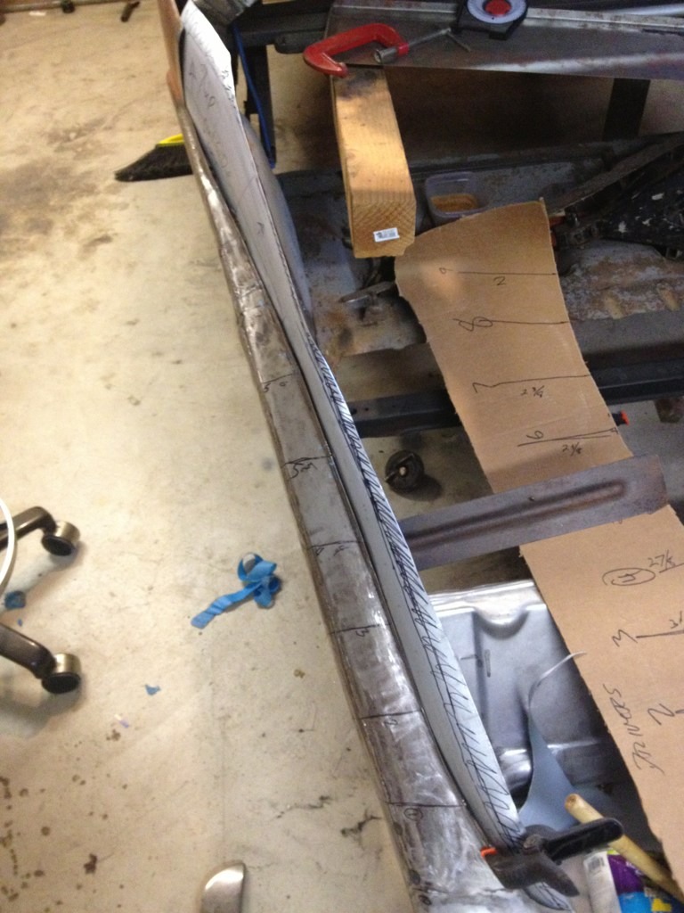

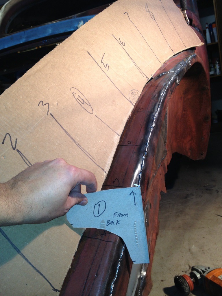

    Part 1 had been intimidating me ever since forever but it went pretty well. I scratch built the drivers side then made some templates to make sure the p***enger side matched. I'm pretty sure from here on out all the exterior skin can be recycled from original Henry steel. That's my goal anyways....... ImageUploadedByTJJ1352615924.703555.jpg ImageUploadedByTJJ1352615949.359469.jpg ImageUploadedByTJJ1352615989.417390.jpg ImageUploadedByTJJ1352616019.051163.jpg
