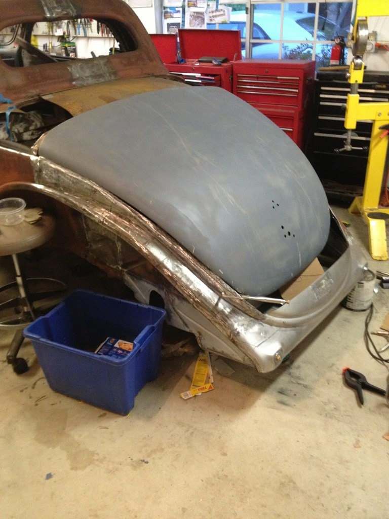

  13. Um remember when I said the 39 decklid was too nice to cut up.... I think I changed my mind. Tomorrow it gets modified to fit/flow. ImageUploadedByTJJ1354925320.568375.jpg

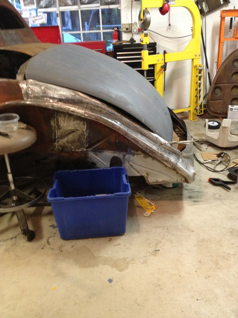

  14. I've got to make some horozontal slices along each side to take out some of the concavity. Forgive me Henry. ImageUploadedByTJJ1354927502.736239.jpg ImageUploadedByTJJ1354927545.649140.jpg

  16. Make your own deck lid

  21. Man, I'm sure he woulda let you he just woulda said "pay up sucker".
    Flyin, because I lengthened the trunk area 8 inches the decklid needs to be flattened out to achieve the proper profile if I modified the body to fit the lid it would look like someone had rear ended the car.
  22. Ok. So the hinges that I roughed out wouldn't let me open the deck lid. Much head scratching later I figured it out. The goal is a 36 profile. I made relief cuts in the lower half to flatten the deck lid out, I will add material in these areas. I think somewheres I have to remove a little material to get the proper hump. I don't want it to look like a 40. I want 36. ImageUploadedByTJJ1355016208.540626.jpg

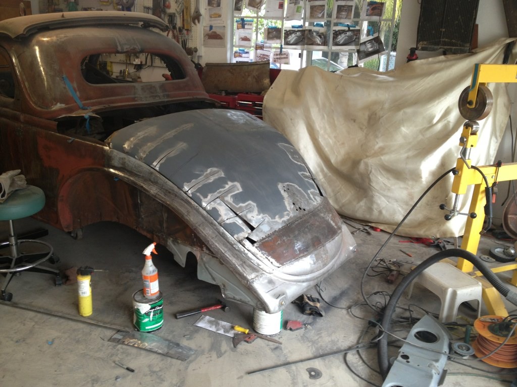

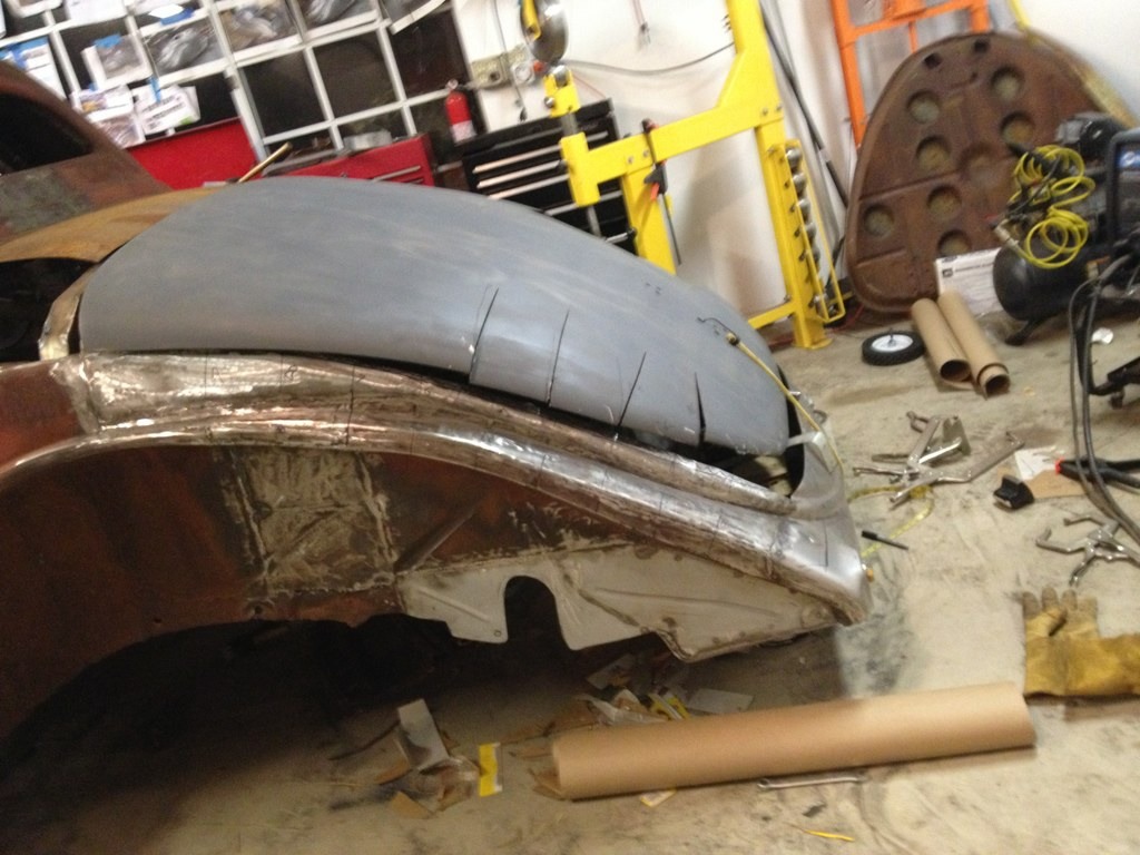

  27. Not much progress today. I was working in the yard. I played with the decklid trying to get it looking like a 36. I will make it i open at the base of the curvature. ImageUploadedByTJJ1355533952.731491.jpg ImageUploadedByTJJ1355533968.012991.jpg
  28. Got the deck lid roughed out. Still missing a couple filler pieces on the topside. Then I'll flip it over and get the underside put back together. It's somewheres between a 36 and a 40. ImageUploadedByTJJ1357110357.435102.jpg ImageUploadedByTJJ1357110376.534355.jpg ImageUploadedByTJJ1357110437.916306.jpg
