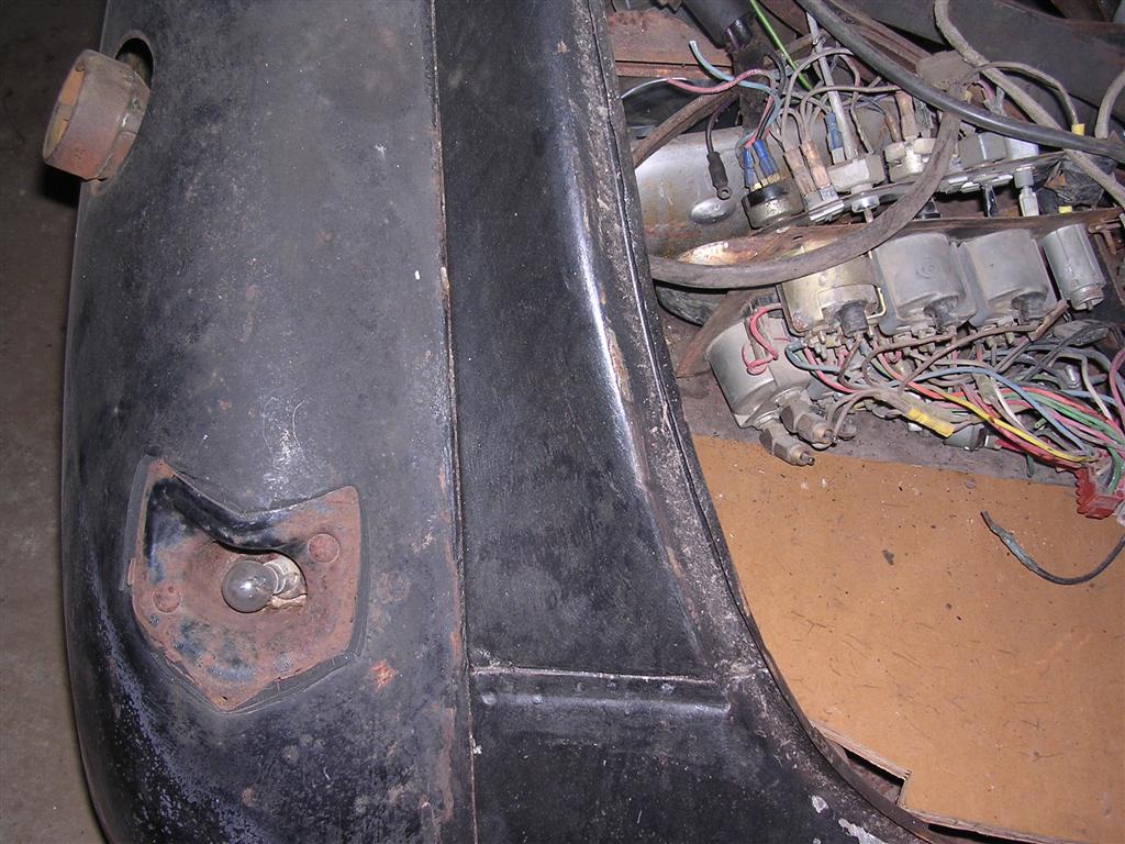

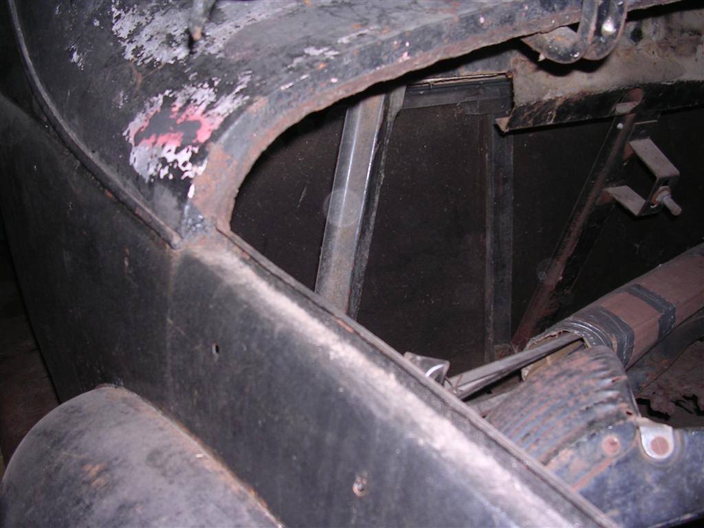

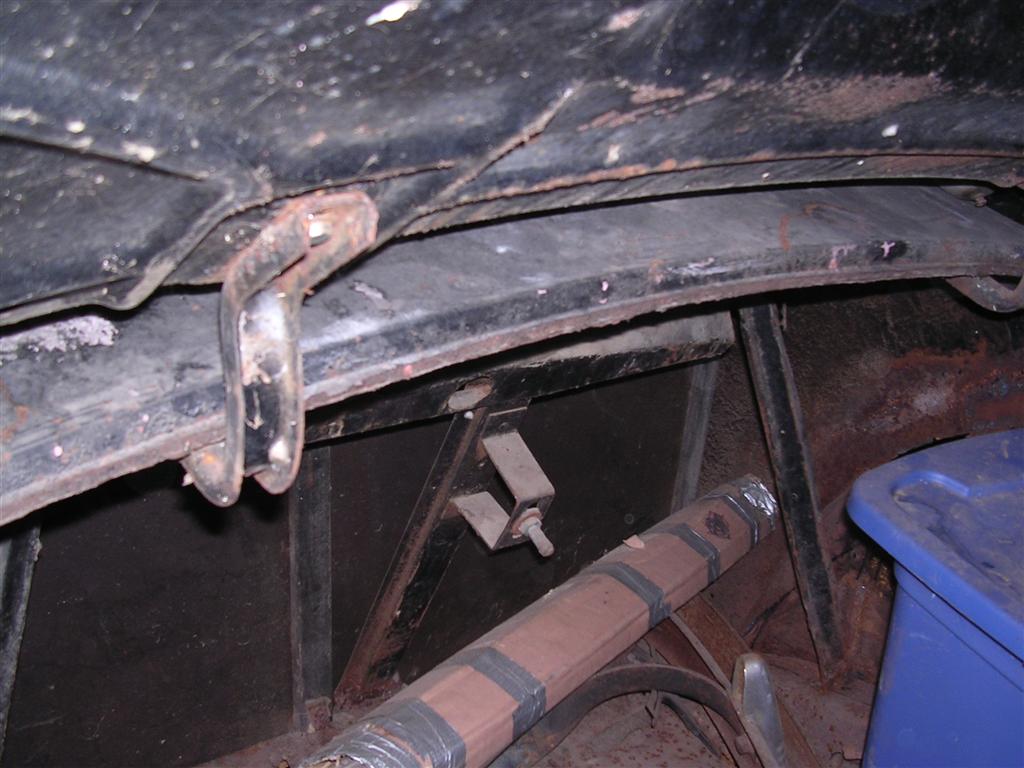

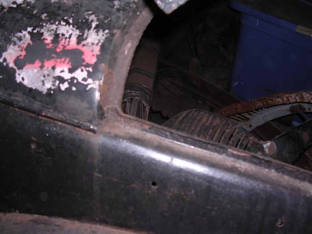

    Took some 40 coupe gutter pics today. If these are what you asked about?
  2. Thanks FJ. Thats what I love about the HAMB!. If anyone knows approximate measurements of the lip that would be great!

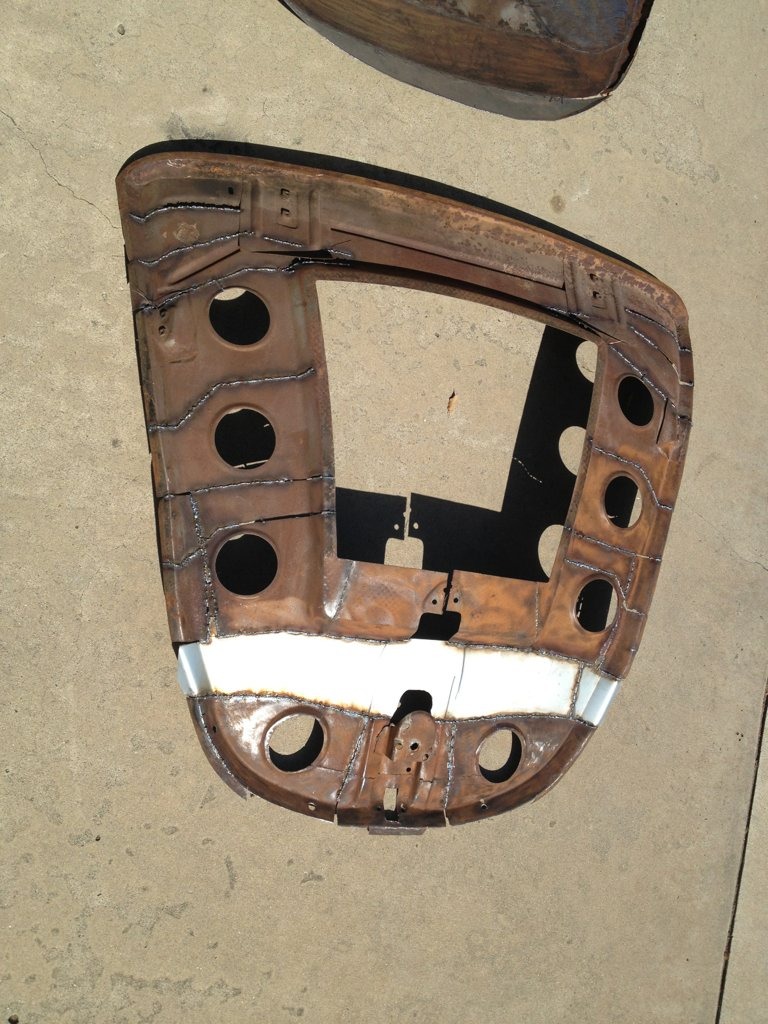

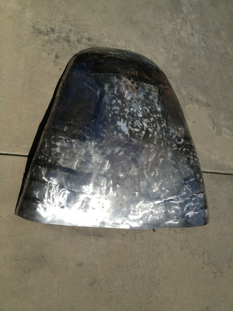

  3. I remembered I know a guy who has a 1940 coupe so I went over and looked at it firsthand. Now I know how I'm gonna attack the decklid gutter. More progress on the decklid. I should hold off on the pictures til it's all cleaned up but I just can't help myself. ImageUploadedByTJJ1357950997.179938.jpg ImageUploadedByTJJ1357951029.894236.jpg ImageUploadedByTJJ1357951056.855735.jpg

    you bought that '40 decklid from Rick Ericson in Wildomar didnt you?
  5. Ha ha. No I looked at that lid it was pretty rough for the $. I met Rick though lots of nice projects going on in his shop. I got mine from an old rodder in el cajon named Gene it was in real good condition for a great $. Very nice guy.

  10. Thanks Bob. I looked you up on the UK board. Gotta love the internet! Gonna share some of your pictures here for you. As for me I was sidetracked by rebuilding the super T 10 transmission that had crapped out in my 56. Now it's ready for Cruising Grand. I'm back to work on the deck lid but determined not to show any pics until it doesn't look like a turd!

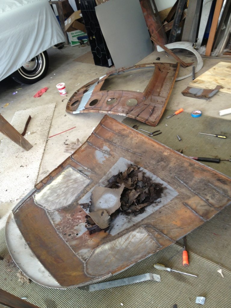

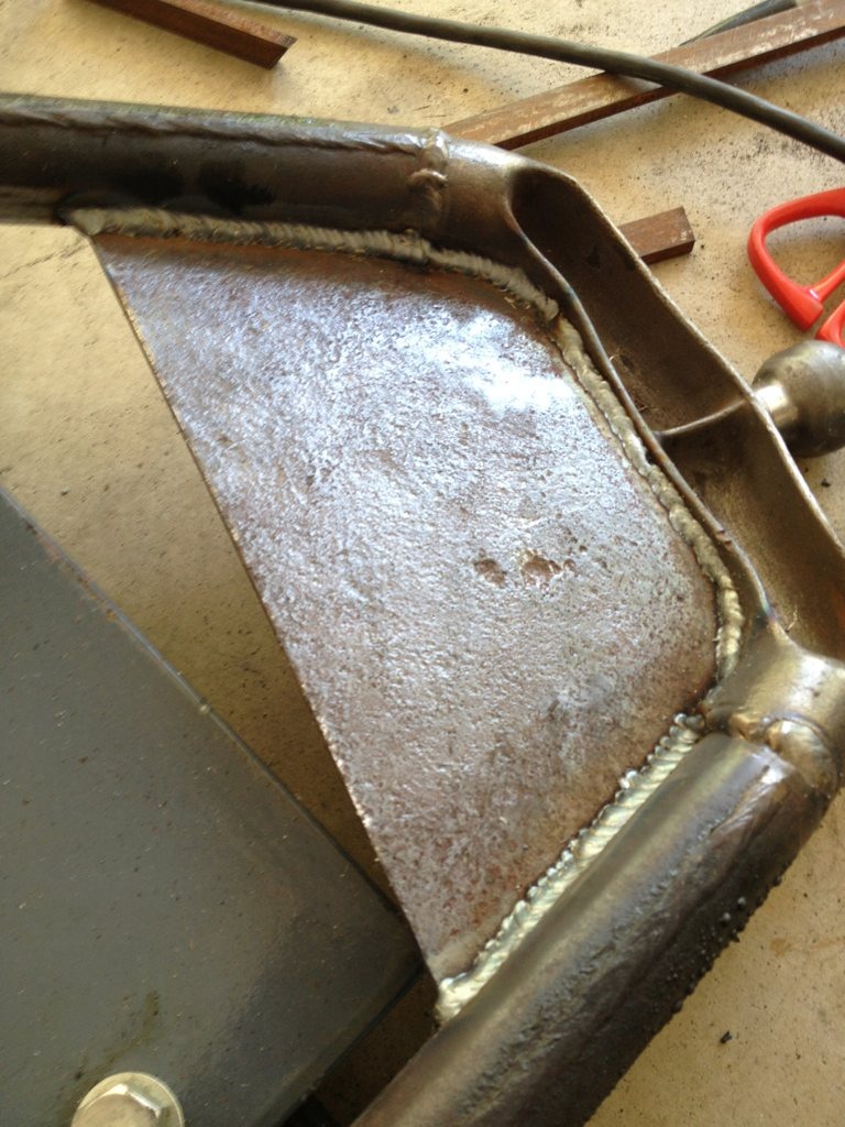

  14. Well I can't disappoint my followers. Here are some shots of the decklid. I had to split it open because I kept setting the sound deadener on fire and it smelled horrible. This has actually made progress and quality ( not Riddler quality mind you) much better. I said I wasn't gonna show pics til I was done so take it for what it's worth. I will say that the Frankenstein of an inner decklid is a shitload of welding. The most so far . ImageUploadedByTJJ1367015461.337429.jpg ImageUploadedByTJJ1367015474.734791.jpg ATTACH]
  15. ImageUploadedByTJJ1367016022.638622.jpg ImageUploadedByTJJ1367016037.870106.jpg
  16. Wow! And I thought I liked to weld. Looking good.

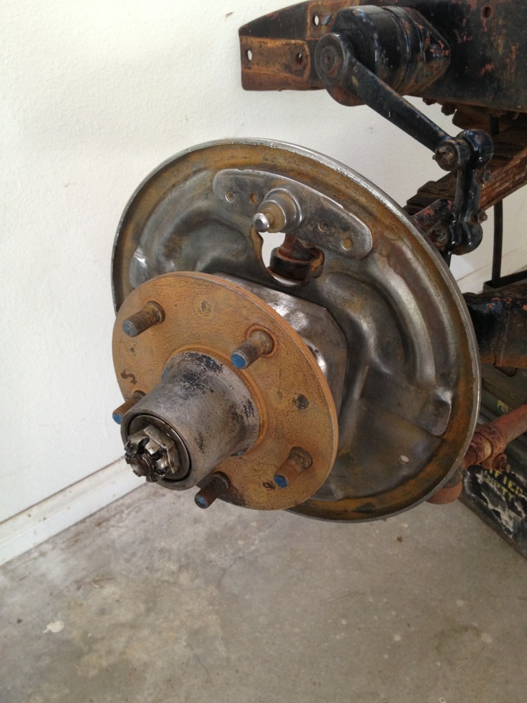

  26. I'm a little burned out dealing with the decklid so I've shifted back to the frame. I'm disassembling and cleaning the f100 brakes off my first car ( that's a different build thread). It's kinda cool to think the brakes off my first car are going on to my (probably) one and only creation. 9 inch rear end is getting cleaned and prepped as well. I'm tapping into the tech archive to graft it to the original wishbone rear suspension.

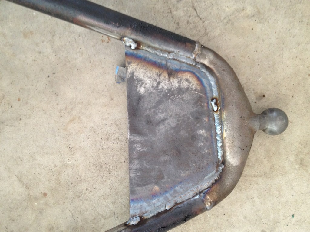

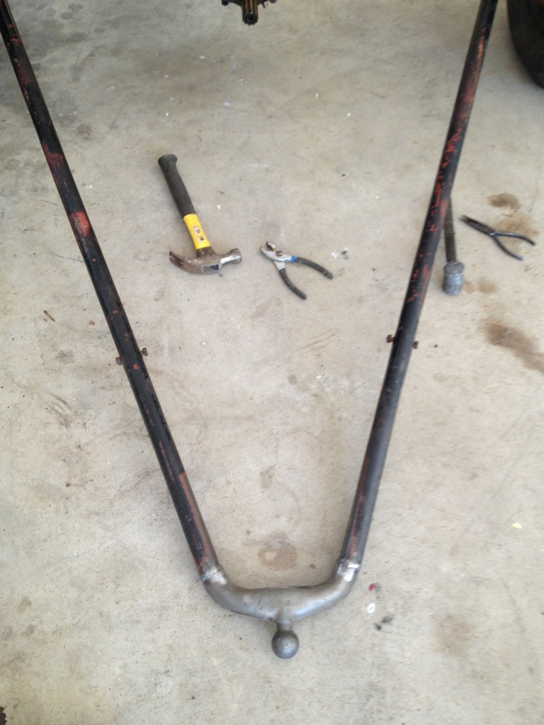

  29. F 100 Brakes roughed out on the front end. Used the Speedway Kit, no complaints. I have to pull it apart and paint all the parts. Big thanks to 117harv for sending me out a yolk for the rear end build that I'm going to do with the Help of the SamIyam's tech archive article. I'm using a 9 Inch rear end.
    I'm not dead. Nor is the build.
  30. Pictures ImageUploadedByTJJ1370645573.082368.jpg ImageUploadedByTJJ1370645590.421927.jpg ImageUploadedByTJJ1370645607.094215.jpg ImageUploadedByTJJ1370645646.886540.jpg ImageUploadedByTJJ1370645683.004375.jpg ImageUploadedByTJJ1370645712.308010.jpg
