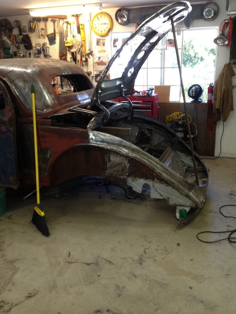

    Quick update from the red headed stepchild of 36 builds. Fabbed up some decklid hinges that started their lives as zephyr sedan hinges. Made up some struts to mount the hinges to out of 1x1tube. Recessed some cage nuts inside the tubes for adjustability. Pretty clean for lowcoe! Still working on that damn decklid. Hope to get it done soon. Then it's decklid gutter and everything else on the body behind the rear window. Loving all the other 36 builds. ImageUploadedByH.A.M.B.1376971118.918677.jpg ImageUploadedByH.A.M.B.1376971133.155627.jpg ImageUploadedByH.A.M.B.1376971157.862174.jpg ImageUploadedByH.A.M.B.1376971171.769580.jpg

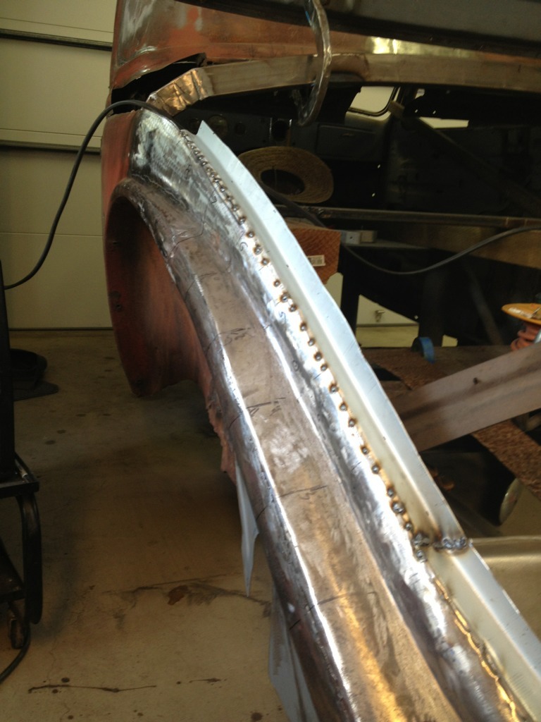

    Put the inner n outer decklid back together temporarily to see if I was anywhere near done. To celebrate I rolled the ol girl out to get some sun. Next project is making the decklid gutter rail using my brake and Shrinker. ( and hammer ) ImageUploadedByH.A.M.B.1377464584.777211.jpg ImageUploadedByH.A.M.B.1377464615.423974.jpg ImageUploadedByH.A.M.B.1377464640.782470.jpg ImageUploadedByH.A.M.B.1377464707.271335.jpg ImageUploadedByH.A.M.B.1377464735.341038.jpg
  13. lowcoe
    Joined: Jan 30, 2008
    Posts: 846
    lowcoe
    Made progress on the gutters today.

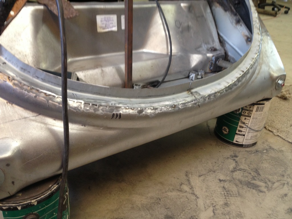

    Thanks for the encouragement 56.. I've been making steady progress on the gutter. I rolled over the 90 degree edge all around the bottom and it turned out pretty close to what I saw on the 40 ford I checked out. Also it helped to have FJ's pics to refer back to. On the top edge I used 1x1 tube and grafted it into my crossmember since this area is really tight. Lots of finish grinding to do. That's obviously my least favorite part. I promise I will clean everything behind the door jambs once I have that whole area fabbed. I won't move forward until that area is purdy. ImageUploadedByH.A.M.B.1378059726.823723.jpg ImageUploadedByH.A.M.B.1378059760.553021.jpg ImageUploadedByH.A.M.B.1378059782.274398.jpg ImageUploadedByH.A.M.B.1378059812.120845.jpg

    Worked on this panel for the better part of the day. I'm getting pretty close to a big milestone .... The whole rear end from scratch. It's super muggy in so cal these days. ****s the motivation outa you. ( usually. ) ImageUploadedByH.A.M.B.1378511228.290509.jpg ImageUploadedByH.A.M.B.1378511241.516381.jpg ImageUploadedByH.A.M.B.1378511256.127712.jpg ImageUploadedByH.A.M.B.1378511273.527212.jpg ImageUploadedByH.A.M.B.1378511284.950748.jpg

    Did you switch to galvanized metal for the filler panel between the decklid and back window?

    Chinarous the metal has primer on it.
