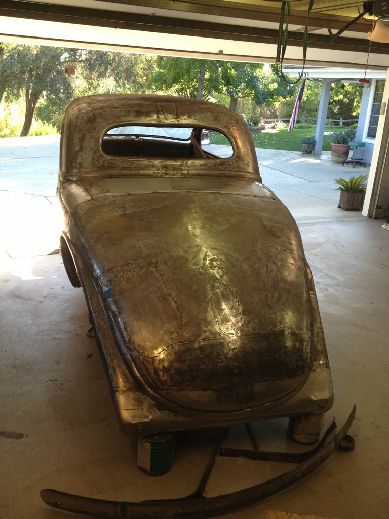

  2. A bit of a milestone. Still not dressed n purdy but I got the last piece of the rear deck fabbed in!!!!!

  5. FRICKIN AWSOME! It's always nice to finish up one area and move on to the next. Keep it up.
  6. I don't know '36s well enough to point out any design imperfections compared to an original coupe, I just know what you have done is amazing! ...and if you are doing a kustom it does not matter a bit. ...and if you are doing a hot rod it does not matter either. I think this is a great example of what can be created, just one step at a time, so long as you keep stepping forward.
  7. I'm not sure what's more fun. Working on the car or all the encouraging comments...... Thanks all.... I feel like I need to go back and do everything over again to try to live up to the quality that is all over the HAMB. (35/36 club especially) I will continue and try to raise the bar on this build with all of y'all cheering me on..

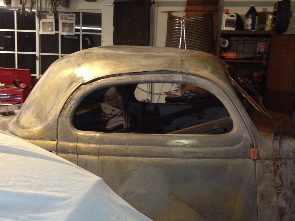

  11. ImageUploadedByH.A.M.B.1382309704.904141.jpg ImageUploadedByH.A.M.B.1382309745.120044.jpg

    This is great! Really makes me want to get out in the garage!!
    Great work man.

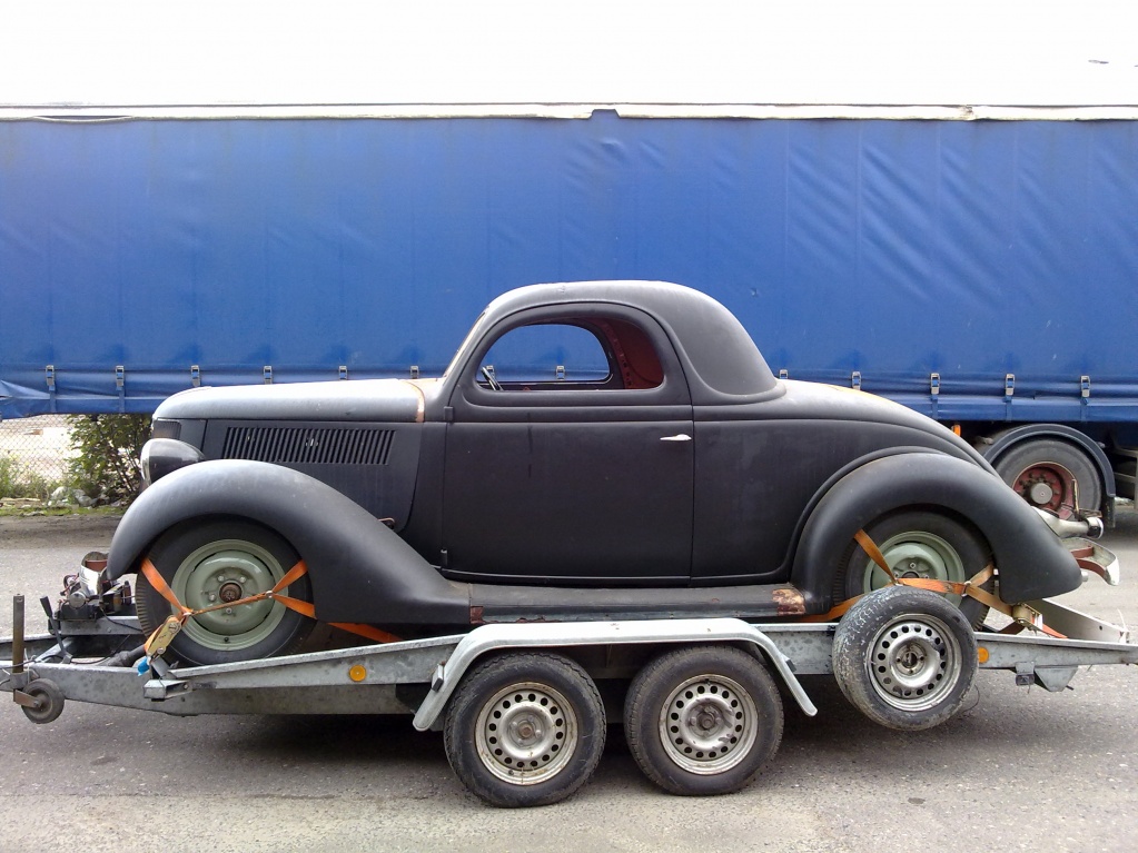

    I can really appreciate the hard work involved in all this fabrication, but am I the only one who thinks that the side window opening looks like it is backwards as compared to what it should be ?
    The small part of the window opening should be at the front near the windshield, it looks really awkward in appearance like it is now, basically backwards.

    I'm not the only one. I heard by PM from someone else. I was reluctant to say anything, as I know how hard this kind of project is.
    I can assure you there are or will be others who know what the window profile of a real 3 window should look like and recognize the backwards side windows shape.
    They may not post but they are there.
    It's your project, I hope you can carry it through and finish it but IMO it will always look "off" somehow and be awkward in appearance no matter what the rest of the car looks like.

  22. I am in full appreciation of your build as Im creating a car from a cowl, 2 doors and 2 quarters. But I say the doors also look sort of funny, tall in front. But thats not to say it won't work, its just I haven't seen one like this. Once its outside and from a distance, you will see if it flows. When I brought my car out for the first time, it got rolled back in and I had to redo the front and back of the car. Time will tell. And you will be the final judge of your car. When I built mine, I could see the big flaws. I also know that you cant please everyone but you also don't want to hear your car looks like ass everywhere you park. LOL!! Anyway, amazing what you have created so far!!!

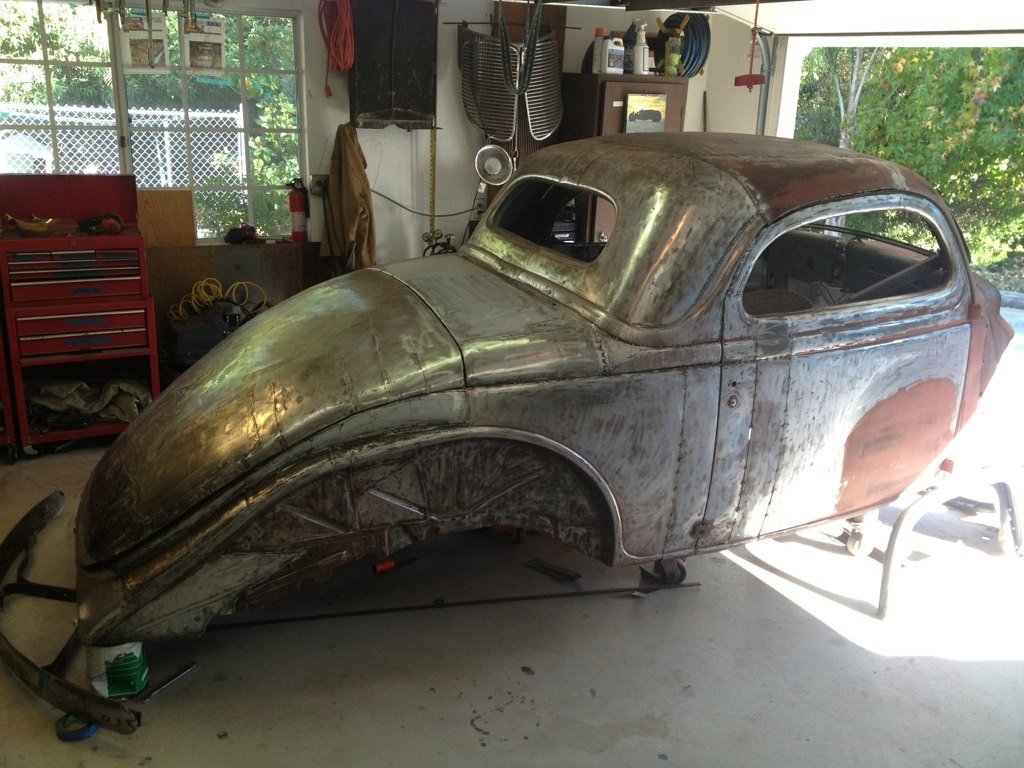

  23. Weldin, grindin,weldin, bangin,weldin, grindin...... ImageUploadedByH.A.M.B.1385412312.675360.jpg ImageUploadedByH.A.M.B.1385412327.176924.jpg ImageUploadedByH.A.M.B.1385412341.859425.jpg

    Just caught up with this thread and you have done an amazing job of transforming a
    bunch of Henry's metal into a creation that is uniquely yours ! I like the window look and think it will carry through in the taildragger design ! Do it your way because you've done one hellava nice job so far ! Proud of you!

    I had not even noticed the door profiles but it looks like a slight A pillar chop would make the door profile closer to an original.
    Minor work, if YOU decide, compared to what you have already accomplished from just a pile of parts.
