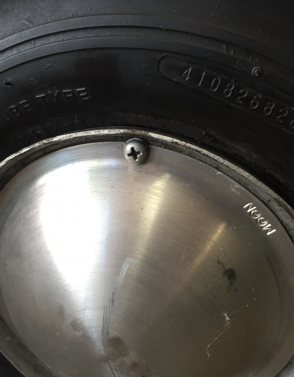

  9. cs39ford
    Joined: May 1, 2012
    Posts: 1,020
    cs39ford
    Me to. These are on my kart. I used self tapped flat screws that came with from moon in the package from 1960

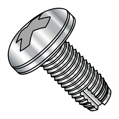

    All the non-Dzus fastened Moon discs that I ever installed came with screws that looked like this:
    I think they were 10-32. I always tapped anyway.

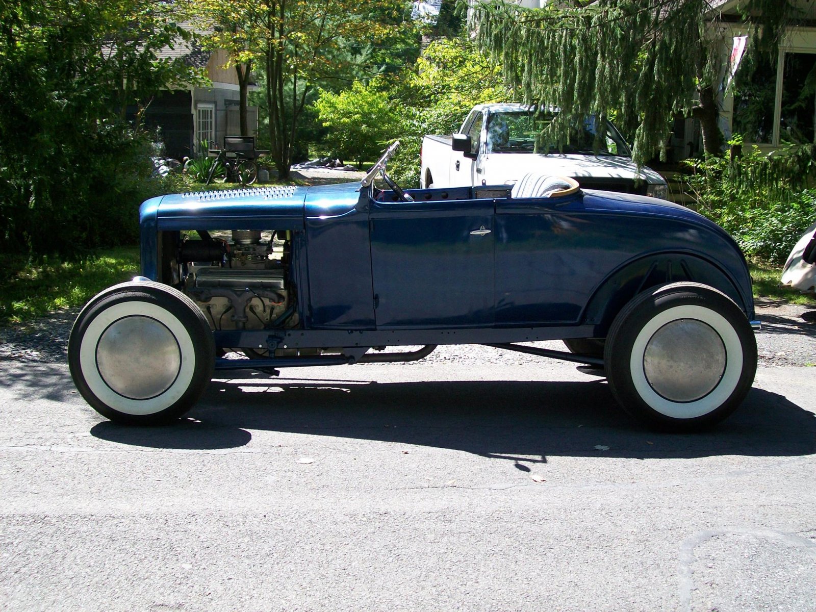

    Attached is a picture of a Moon disc on one of my cars. I used a long tubeless stem, and drilled a hole in the disc, eliminating the need to remove the disc to add air. 1135311-3c59d73e3340c13ae44077c7cec85deb.jpg 1135311-3c59d73e3340c13ae44077c7cec85deb.jpg
