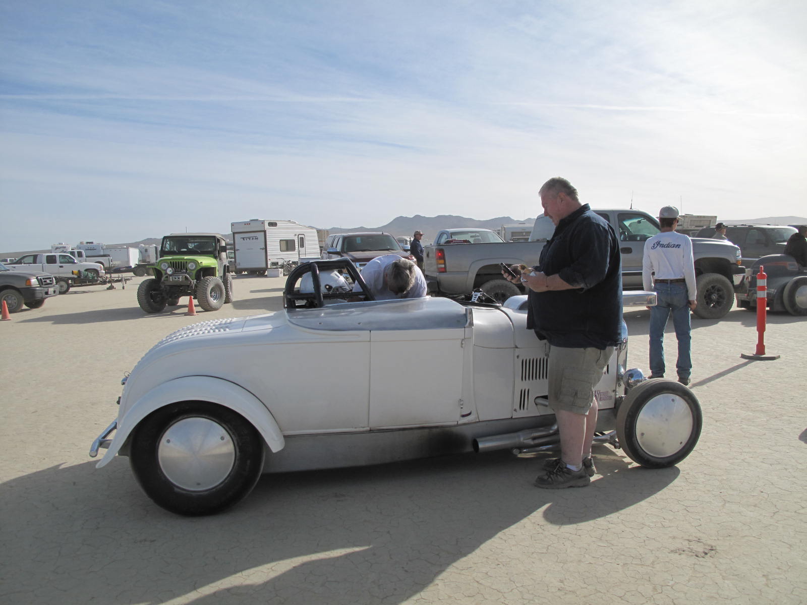

    Couple of things here . . .
    As I remember (?), Moon will "rent" you a jig to simplify the Dzus lay-out . . .
    And, some folks have moved the air valve holes to the inside of the wheels to simplify checking air pressure -- yes, that may need jacking up the car to rotate the wheel to a place for access, but not having to screw and unscrew the screwed type getting looser each time.
