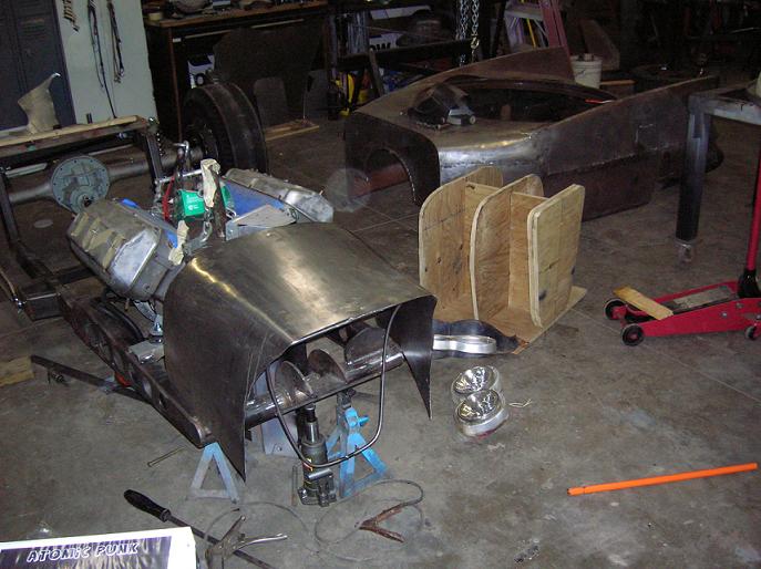

    I have been working on the grille of the Atomic Punk off and on squeezing in a few hours on it here and there. I don't know how much time I have in the damn thing, but I know it is a bunch. If I would have made it out of fiberglass I would have been done by now but that wasn't the point of the excercise....
    So...I started with the round rod shape of the grille that I wanted and I welded it to the chassis of the car. Then I laid some paper out and made a rough template of the shape I wanted.

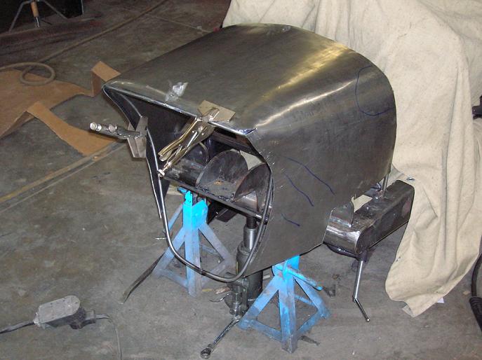

    I fought and wrastled the sheet of steel into a rough shape and I began to roll the contours in the English wheel.....
    I got it pretty close, but I couldn't really tell where the straight edges needed to be. So I ran to the local Menard's store when I got off of work, grabbed a sheet of 3/4 inch plywood and came home and made a buck for the grille. I think I used it for a whole minute to mark the edges and trimmed them up. It looks pretty cool laying around the garage though. People come in and see that buck laying there and think that I really know what I am doing! ha ha ha

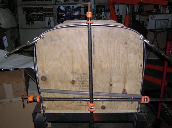

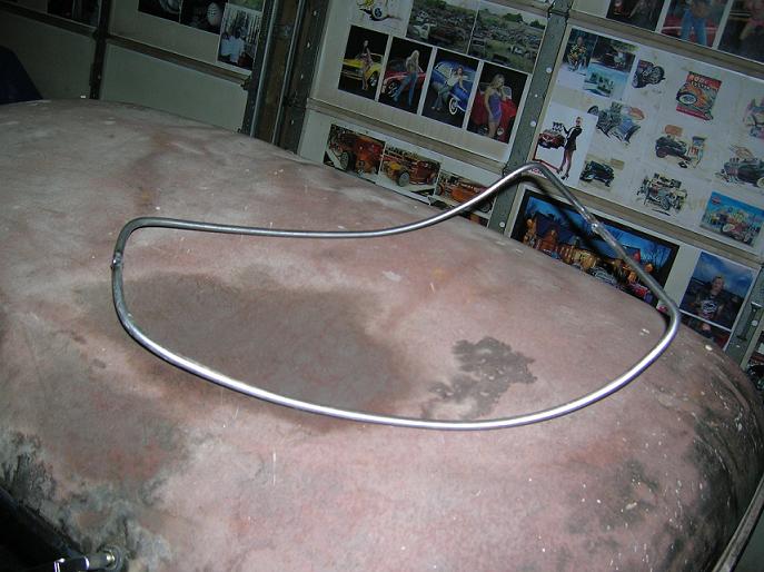

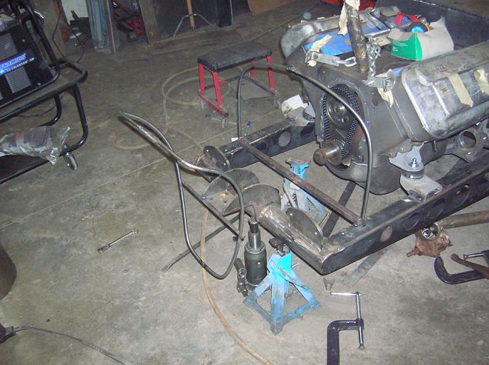

    Well the whole thing kept flopping about so i thought I would make up the structure for the back side of the grille and weld it to the frame too.
    Since I had taken the time to make that nifty wooden buck, I whipped it out and bent some round rod over it and welded it to a support that I then welded to the frame.

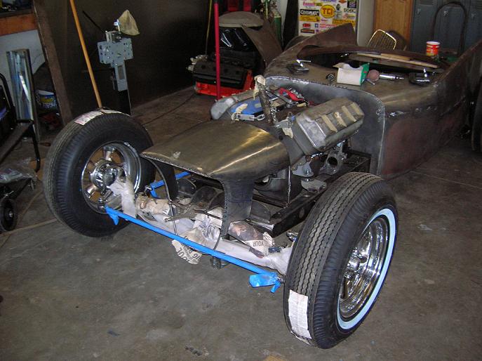

    Now that I had a rigid structure to work from, I used the english wheel to roll out the curves and tighten up the clearances on the metal.
    Once i got the rear to fit right, I tacked the metal into place onto the rear structure of the grille. I then cut it all loose and began wheeling, and fitting, and wheeling and fitting, and wheeling and fitting, the grille shell to the grille opening. As I got the metal to fit the contours better, I kept trimming off the excess until it fit nicely...

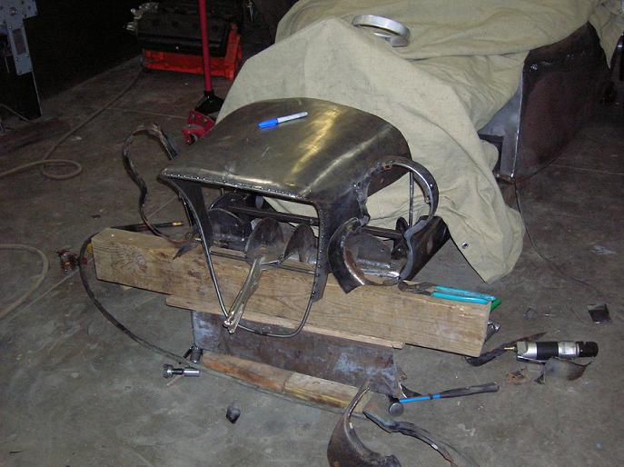

    Ok here is where it pays off a little to be a tool junkie.

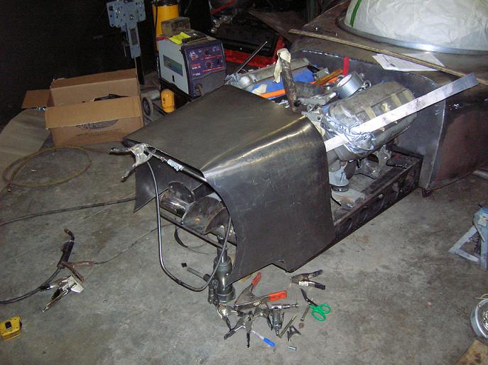

    I have one of the MetalAce bead rollers and used the Ron Covell roundover dies to roll the edge of the metal over to meet the round rod structure. I then clamped it all down and welded it to the round rod opening.
    It was then time to do the ever important check with the front end on to make sure it would actually fit on the car. I did some trimming and whatnot to make room for the next addition....the headlight pods....

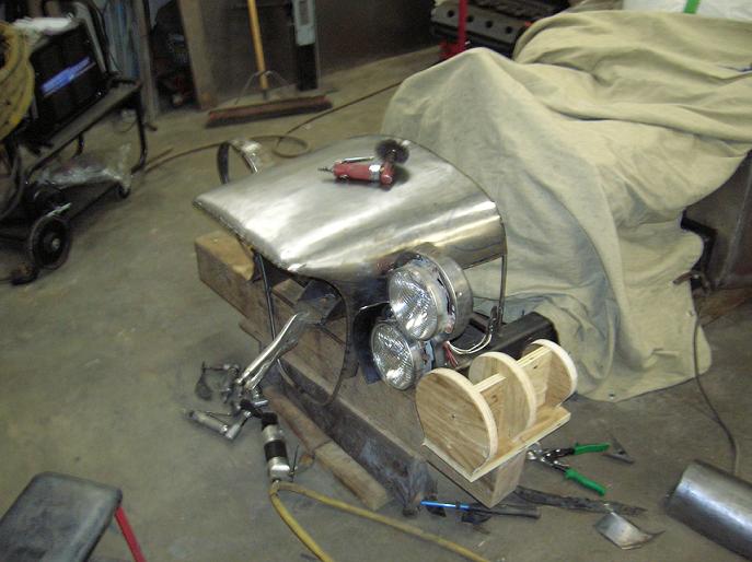

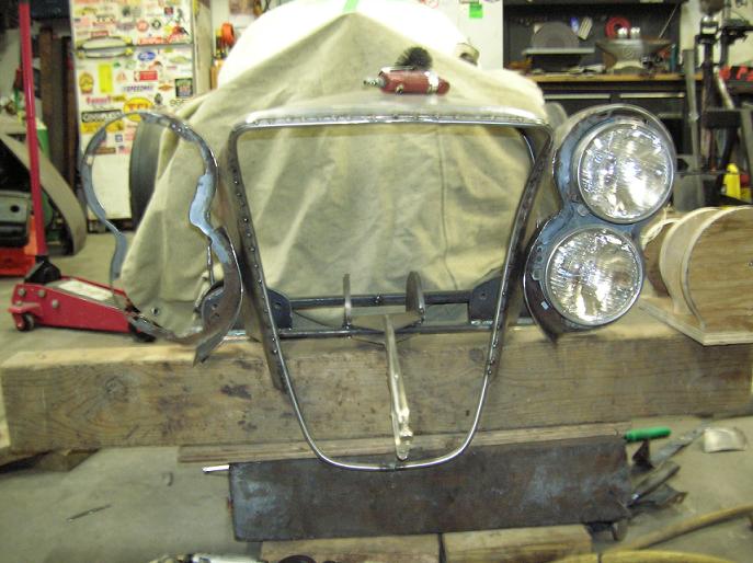

    So I have this cache of 59 Plymouth headlights that I got from Rashy. I figured they would look OK on the car since the main chunk of it is also 59 Plymouth.
    I took the sheetmetal surrounds and cut them up a bit and welded them onto the grille.
    I sitll need to do a lot of work here and use my buddy's Pullmax to make the rounded pods to attach to the grille. I need to do a lot o0f shrinking to get them to work and I don't think the english wheel is versatile enough to do the job. I made some rolled tubes on the slip roll but they were just too square to look right...so this is where I leave you....to be continued.......someday......hopefully soon.
