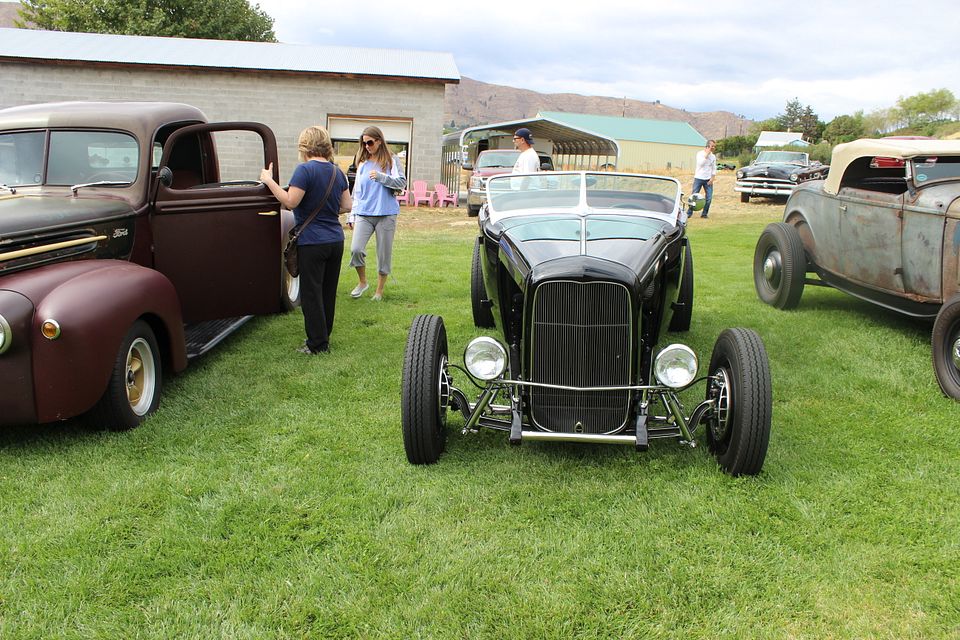

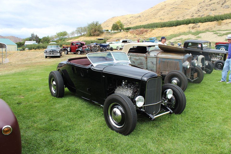

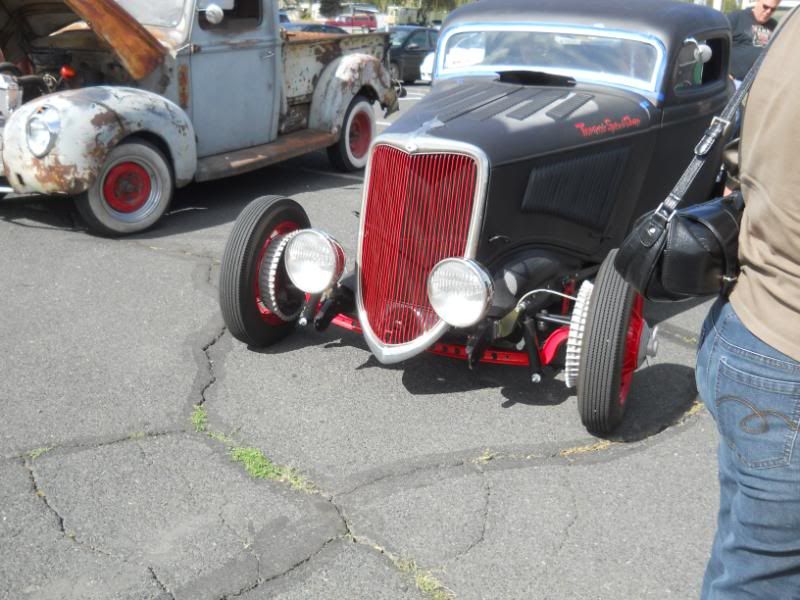

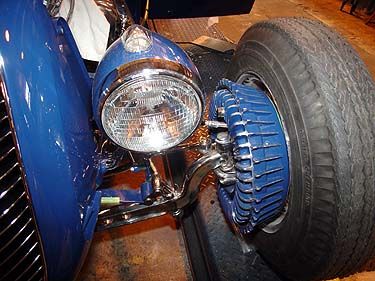

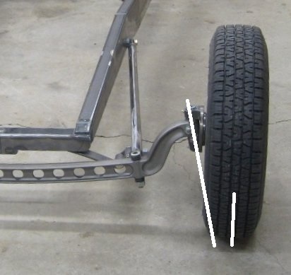

    I show 3 pictures and one must has a huge positive scrub ( big finned drums ) and one more normal or around zero scrub and also normal but maybe a say 2” positive scrub.

    Your pictures show Camber, the pic with the lines show positive camber, (wheel is out at the top) Not sure what pic# 2 is. Not sure why the wheel is out so far on the blue car. 20230212_070054.jpg
    Scrub or scrub line refers to anything that hangs below the bottom of the wheels.
    Let's say your car has 4 flat tires, does any part drag on the road?
    If you can push the car with 4 flats and nothing touches the road your scrub line is ok. The other pic you posted shows Toe-in

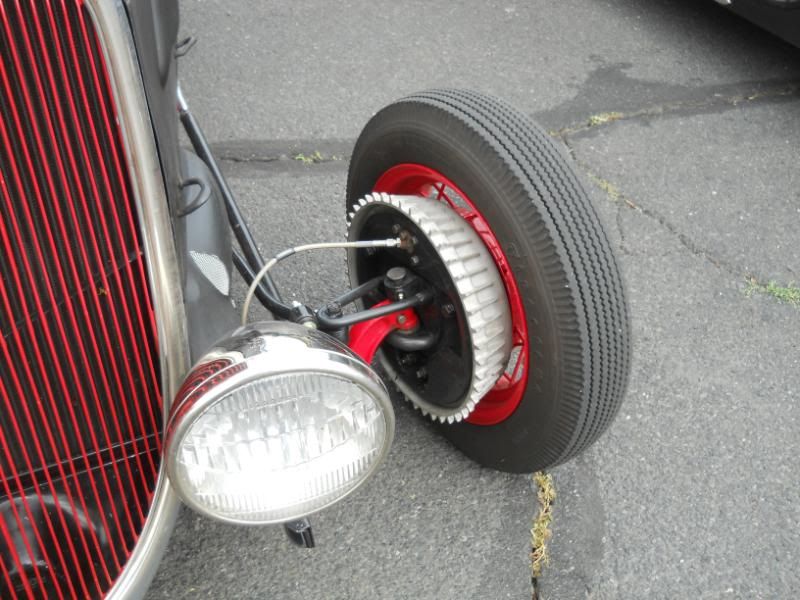

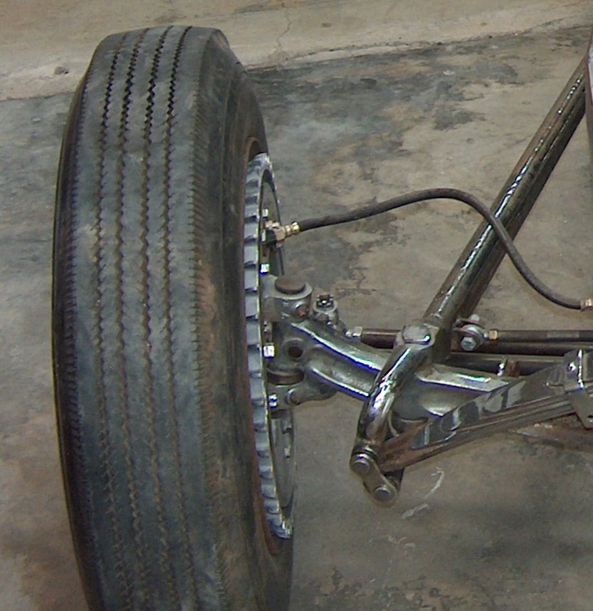

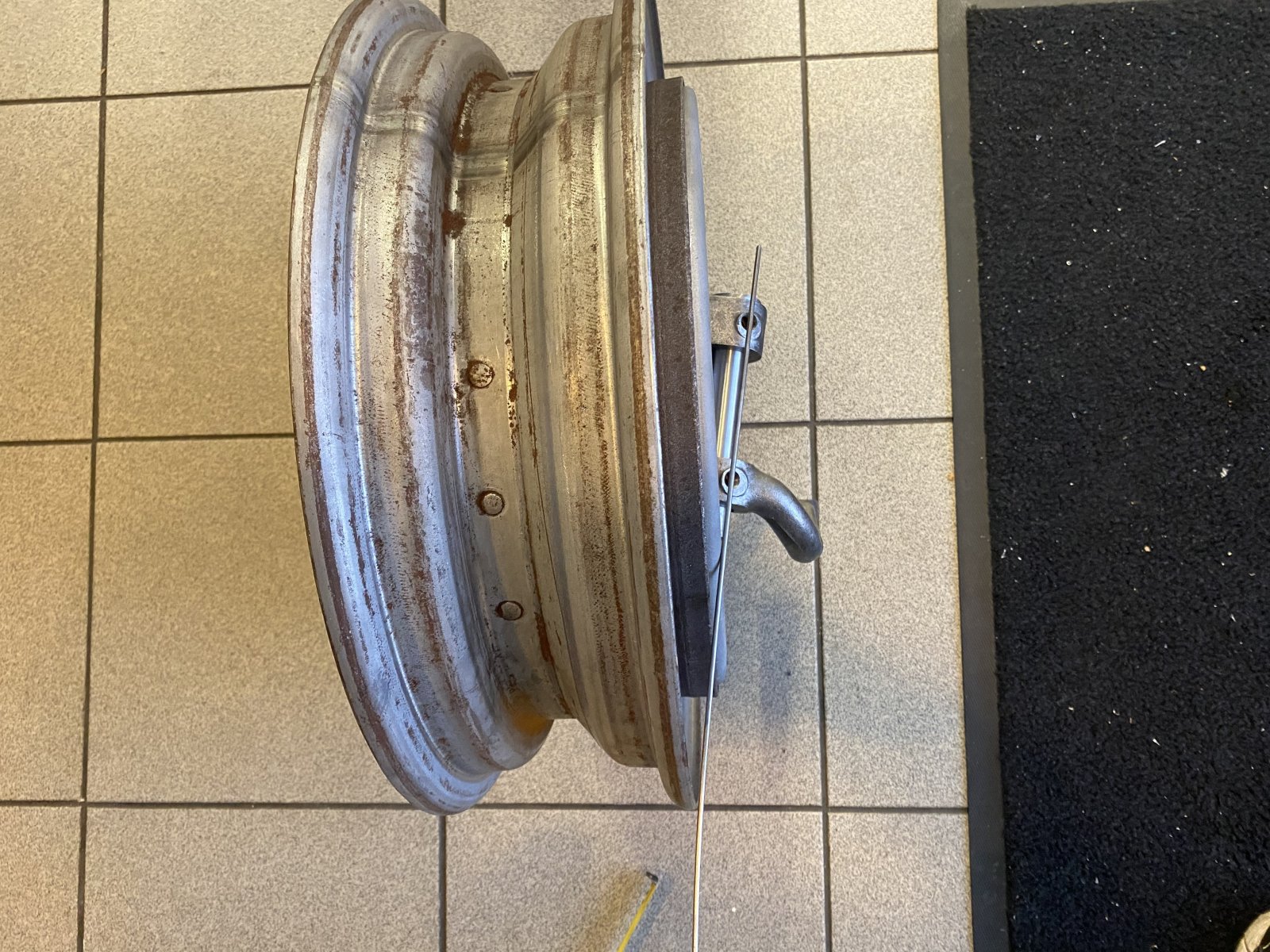

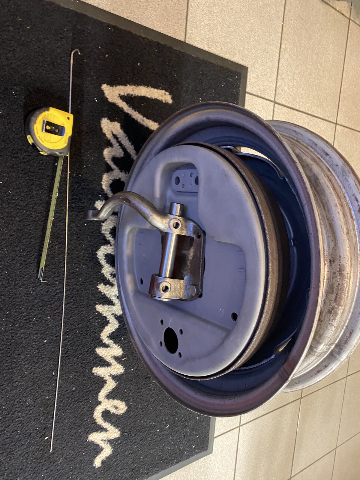

    The pictures above was not mean to show toe in or camber, just show spindle vs wheel centre ruff.
    Here is my set up on a Ford 4” 1940 wheel, Ford 1934 spindle and Ford 1940 brakes.
    It show a positive scrub say ca 2”.
    I dont know yet what a Lincoln 1942 brake will get me at scrub ( + or - ) at same spindle.
    I hardly think I can get a negative number at 1-2” if that is prefered.
    My guess we like to see a positive number at 1-2”.

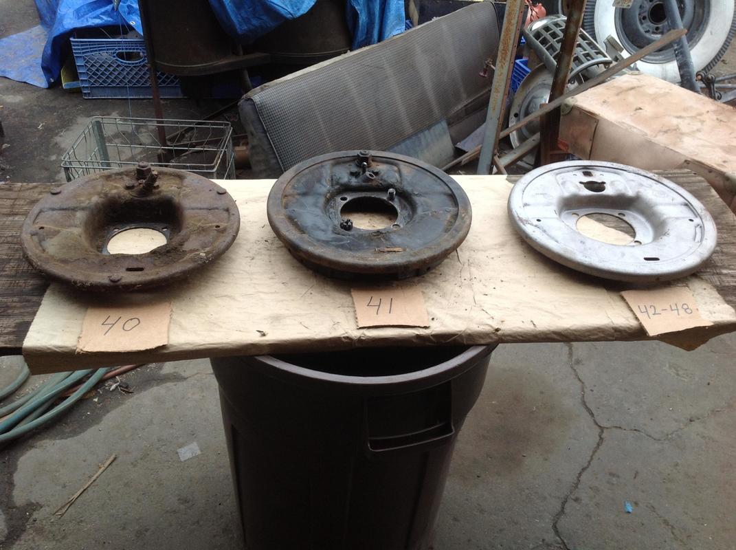

    The question do come to me when I hear by using a Lincoln deeper offset 39/40 or the 42/48 gets a 'better' scrub.
    The Lincoln 1941 has a flat backing plate ( the 2 others has a deeper offset )

    If you use either '41 or '42-'48 (with a spacer) Lincoln brakes, a Ford hub & drum, along with a normal wheel the scrub is the same as Henry designed it and be just fine.
    It's when people use goofy combinations of brakes and wheels that the scrub gets moved way outside of where it is supposed to be.

    Most cars have a small amount of scrub radius. One of its jobs is to put the steering linkage under some tension or compression to compensate for the minute amounts of clearances in the joints. Most rear wheel drive cars have positive scrub radius. This causes the front tires to want to toe out when the car is moving forward, hence the need for a toe in setting. This allows the tires to run at 0 toe dynamically, reducing tire wear.
    If you have too much positive scrub radius, like the picture of the car with the Buick drums, the tire moves in an arc when steering the car. This causes excess tire wear. It can also cause tire rub issues at full lock on a full fendered car.
    Other than initial design, (What 3w Hank is contemplating.) other things that can affect scrub radius are wheel offset and tire diameter and width.

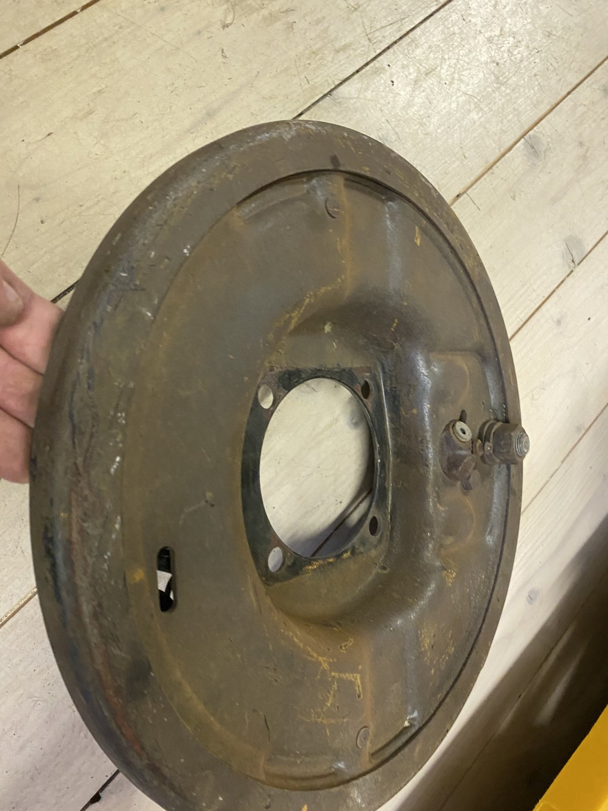

    From what I heard on seller on the Lincoln brakes was 30-60 mm positive.
    ( or say it in inches a tad over 1”- 2” ) and there I’m now on the Ford brakes ( = 2” ) and that set up is very common.
    But I will clean and mock up the Lincoln 42 brakes and get back to thread as soon as I know.
    -Maybe it get me to 1/2”, I will let you know.

    So my major question I has was ; as I was told, the Lincoln 1942 semi offset gives a ’better’ scrub over thd Ford 39/40.
    This 42 Lincoln backing plate has a offset but so do the Ford 39/40 backing plates ( I throw in pictures just show this )
    Whit that said, its 3 Lincoln models on ’offset’.
    But so far I has not test in a mock-up it and compare to the Ford 40.
    Lincoln 39/40 = deep offset.
    Lincoln 41 = less offset
    Lincoln 42/48 = semi offset.
    Note. Once install it, it is what it is since I will not change spindles ( 34 ) or wheels ( 40 )

    I'm thinking that you are going to have to live with it and be done with worrying about it.
    As Airsix very well said in post 26, you may get more and stronger feedback than you want but with the tires you will run that may not be all that drastic. It's just going to want to have a bit more wiggle in the steering wheel than you want on rough roads.
    There is a lot of extra space between that wheel and the drum but we all have to live with our personal choices. It is what it is unless you are afraid it won't p*** inspection because of the offset.
    Truthfully if I was not going through everything you have been doing I'd think you have a spacer or adapter between the wheel and the hub by the loks of things.

    I’ll just ask on experiance what scrub numbers do works best in this type cars ( no matter of combo, spindle, brakes, wheels )
    The mock up I did is not very serious just a ruff one but I has NO adapter.
    If bolted on with bearings my scrub test might change some but in big picture it shows what this combo will be and that is around 2” positive.
    My next question, why ( if why ) a Lincoln 1942 will has a better scrub ( I showed the backing plates )
