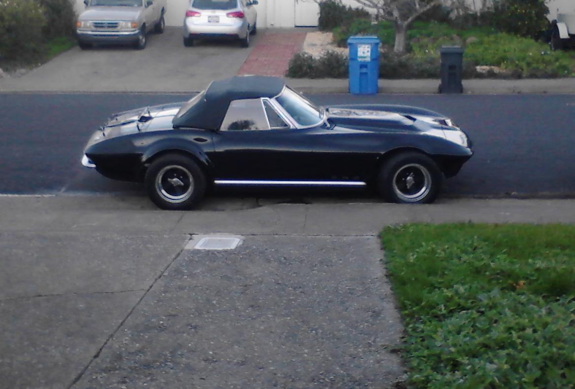

    For anyone following along with a '50-'60s car with IFS, an anecdotal story: I flared my C2 'Vette in the '80s, and somewhere along the line decided to put 10" Americans in the front, as they fit the flares great and I could rotate with the rears. I don't know how I managed to drive it that way, any bump in the road and it was all I could do to keep it on the road. Went back to 8" rims, with the 2" gone from the outside. Made all the difference.

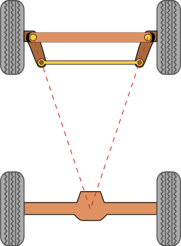

    Toe change in turns is exactly what the Ackerman is all about

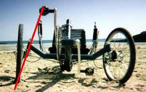

    If someone still can't grasp why large scrub radius is bad, this childrens toy is a nice and exaggerated example. The entire axle turns when you turn it, meaning it has the biggest scrub radius possible. On nice flat ground w/o front brakes it will steer fine, but if one wheel hits a bump ur front brake force is just slightly uneven the axle will turn violently, quite possibly resulting in a crash.
    Kids don't understand why, adult car builders should.
    dana barlow, tb33anda3rd, F&J and 2 others like this.

    Actually this is not a very good example as related to vehicles with caster and some king pin inclination as the steering dynamics are totally different even if the final result is somewhat the same.

    Ackermann was actually the recipient of the principle, Elliott was the discoverer.
    Elliott was a bicycle builder/mechanic, wont (good word) to solve a 'scrub' problem encountered on a 4 wheel vehicle he was designing.
    He was in his bathroom, which had two doors, opposite each other, swung from North, so they were 'parallel'. He tied them together, made some marks, and voila.
    Observing that when adjusted 'progressively', they were no longer parallel, so an imaginary 'outer' wheel would make a linked arc that was controllable via 'spindle arms' that connected in a line between the 'hinge' line (king pin center) and the center of the rear axle.
    Ackermann 'borrowed' the writings, and patented them. (From 'off the bathroom wall'..., ergo, "off the wall"). :cool:

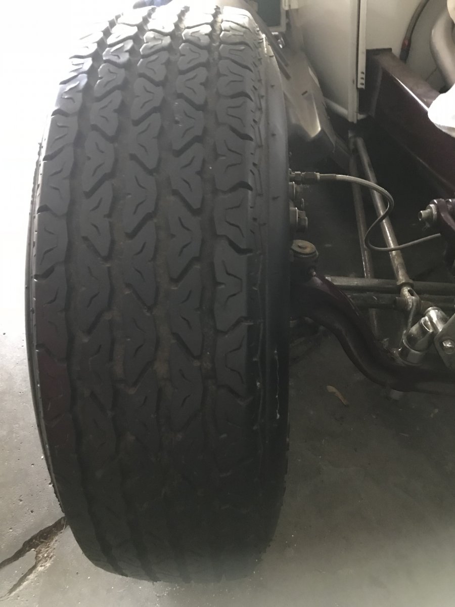

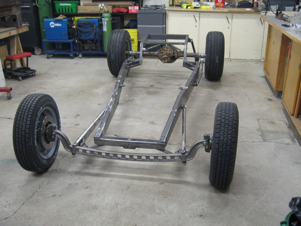

    Okay I’ll weigh in here, since Frank has chosen to basically drag me through the mud claiming that I’m ignorant and don’t know what I’m doing etc., etc.
    I misread his post on my other thread when he mentioned scrub radius (my first thought when I saw the word scrub was scrub line,things dragging etc) so right away he jumped up and said I didn’t know what it was. :rolleyes:
    https://www.jalopyjournal.com/forum/threads/transverse-front-suspension-travel.1132416/
    Anyway he ranted there and here how I don’t know what I’m doing and I’m building something sketchy etc.
    It’s easy to look at pictures of something someone is doing and then say it’s terrible without actually knowing what you’re looking at.
    Supposedly my scrub radius is way off.
    So today when I came home from work I spent some time in the shop and did some measuring of what I actually have for scrub radius.
    Some careful measuring shows that my scrub radius is + 2”.
    So much for being way off.
    Unless I’m wrong I think that’s acceptable.

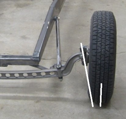

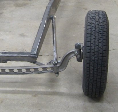

    006.JPG 007.JPG Maybe camera distortion fooled us but the kingpin line appears inside the edge of the tire.

  16. Atwater Mike
    Joined: May 31, 2002
    Posts: 11,618
    Atwater Mike
    Do you have a clear plastic ruler? Just lay its edge down the center line of that king pin. 'Camera distortion?' No. The spacer inboard of the inner bearing is the first 'member', as the kit herein utilizes a 'flat rotor hub', and, spaced accordingly (OUT???) makes for a simple, non-stepped bracket for the caliper.
    We used a deeper disc hub, machined the 'stub' of the Ford spindle, and got the caliper 'inside' by milling a 3/4" blanchard ground plate, water cut. Everything nice and 'Ford-narrow'.
    There was some flim flam about the Volvo disc setup used in '72...Tex Smith penned the story in R&C. The Volvo was adequate in stopping a 2800 lb. street roadster, AND 'tucked-in' nicely.
    The addition of stacks and stacks to achieve a w-i-d-e tread is fruitless.

    Not really, it looks like about a couple of inches of scrub radius.
    But Rich B is right, Blue did change to a drum brake system with backing plates and drums fro Boling Bros.

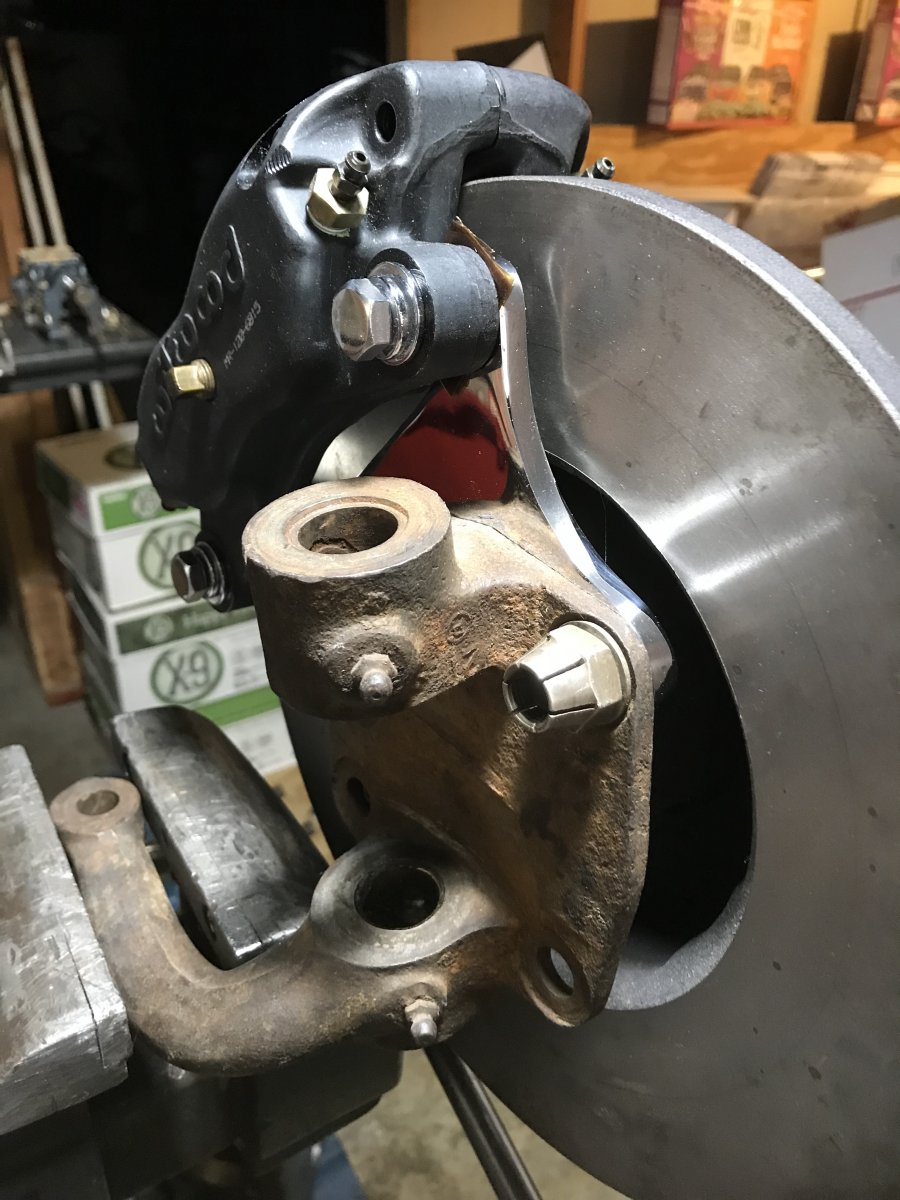

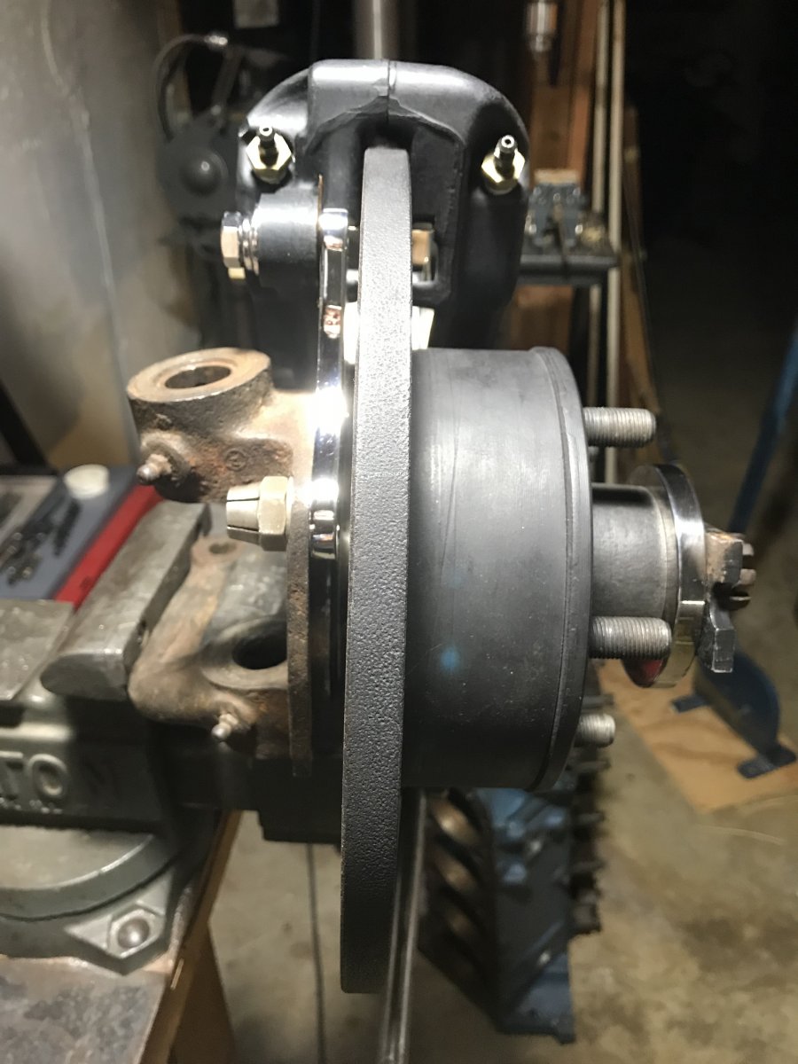

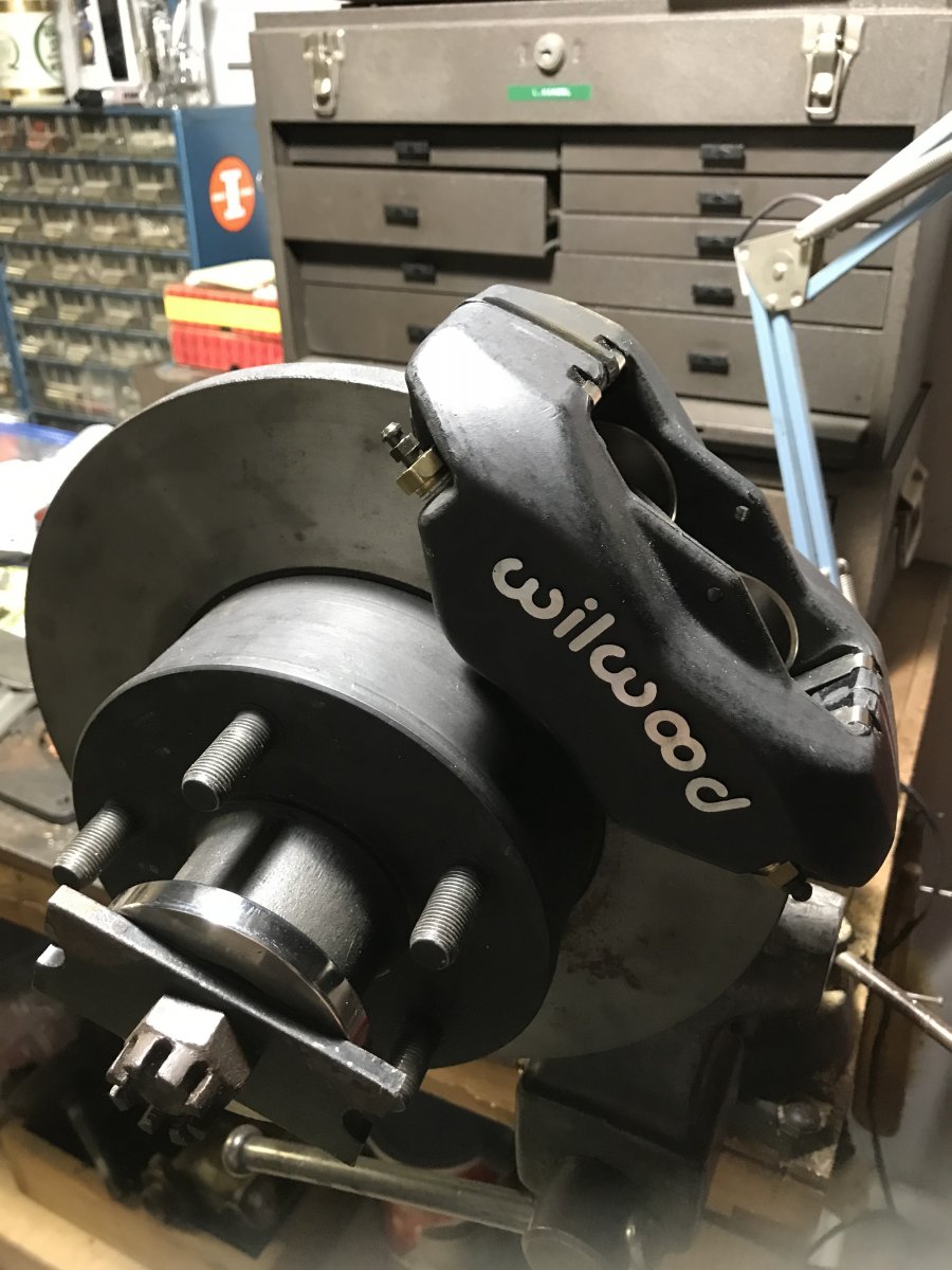

    C631ED31-55F0-4DFA-952F-8285A4A6FA6C.jpeg F4991CA6-0BDD-4ADC-8158-600B63703D28.jpeg 3EF7C762-02DE-4052-BDEF-5EA143EA75B9.jpeg 7E1B22E4-83F5-4DE4-87BE-E0DEE0908026.jpeg Not accurately measured but scrub on my coupe is estimated at about 2” positive with a 3 1/2” backspace wheel and it always handled great, no issues. The brakes are PSI aluminum hubs and 3/8”rotors from Gene Scott BITD with Airheart calipers.
    The brake mock up on the bench is slated to go on my Fordor this Spring. I found NOS 1960’s 122S/P1800 Volvo rotors and the calipers are 4 piston Wilwoods with the 5 1/4” mount spacing. There is no spacer for the inner bearing, but the spindle does need machining to move the outer in 1/4”. Checking wheel mounting surface from hub to inside of spindle (surface where backing plate was mounted) is 3 1/16” compared to a ‘40 front brake ***embly still on the spindle that I measured at 3 5/16”.
    Poor photo of the coupe brake/wheel but it’s the best I have right now. Disregard the odd fasteners on the mock-up, they will be replaced at final ***embly. I have no qualms with the solid rotors, they have always worked fine on the 5 window.
