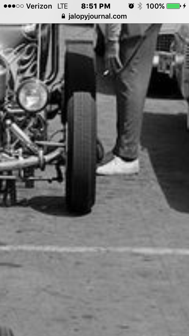

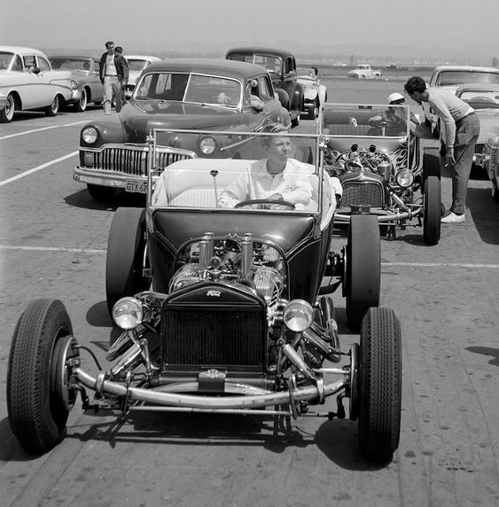

    It seems the easy way to poor scrub radius is to reverse the front wheels. Been happening a long time, it may be "traditional" but it's a bad idea.

  4. Not everyone
    Check the one in the background
    Blues4U, town sedan and Hnstray like this.
  5. Blake 27
    Joined: Apr 10, 2016
    Posts: 1,568
    Blake 27
    I guess Norm knew more than TV Tommie!

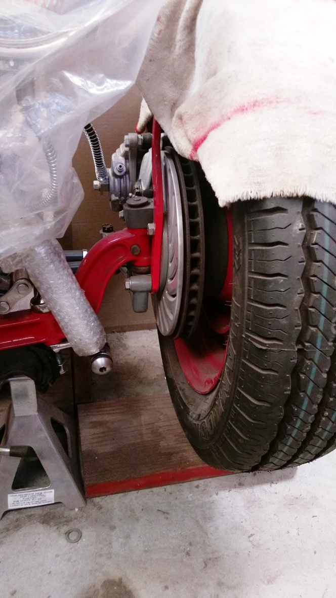

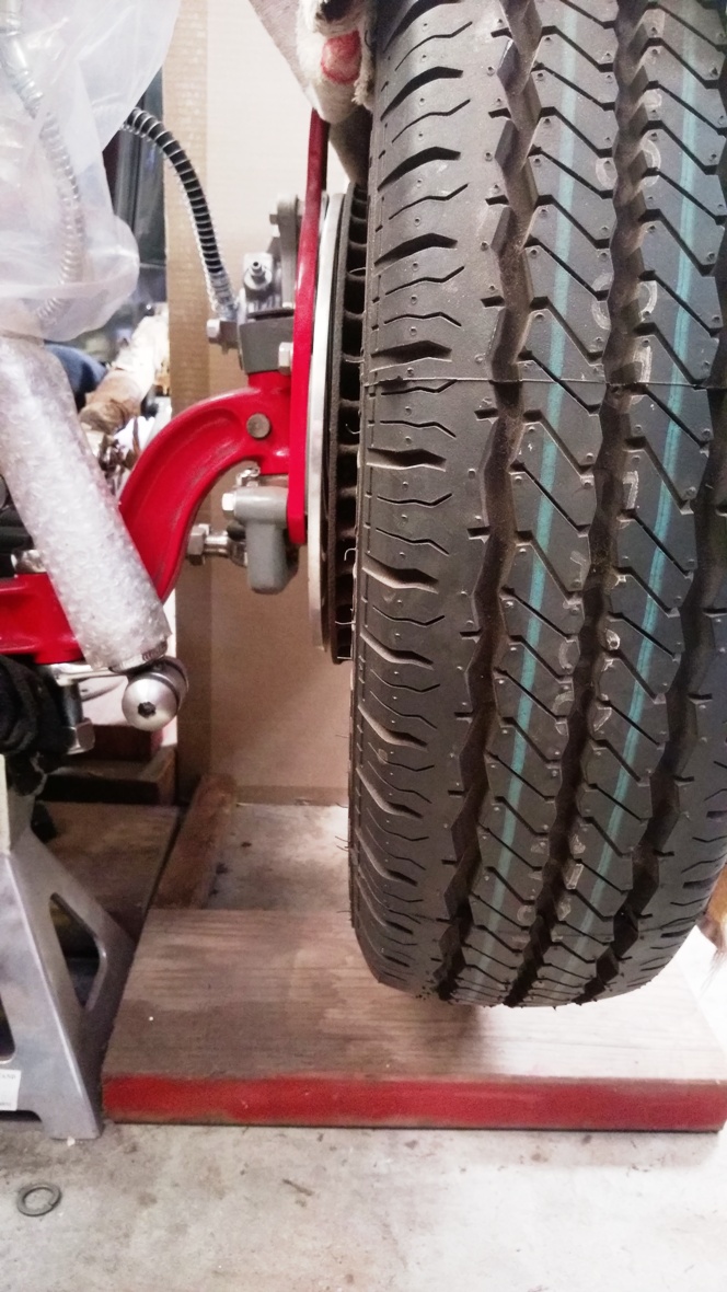

    So just out of curiosity, how bad is this setup for scrub.
    To me it looks to be about 1" out of the tire tread contact IMAG1189.jpg IMAG1190.jpg

    pretty bad. However it's a good example for this scrub radius thread to show that disc "kits" and Ford wire wheels with their spacers simply don't belong together. I believe Ray mentioned these wires w/discs earlier, and on other threads.
    This is also a perfect example of copying what people have seen done time and again, and therefor simply don't have a reason to "think it over first". A few hambers that try to point any major issue out on somebody's build, often take verbal hits from keyboard warriors.
    The bad part is that you have painted yourself into a corner as far as you are now questioning your own build that is now a finished ch***is..... even as far as custom built cycle fenders to fit that incorrect offset. The good part is that perhaps this thread is why you and others might benefit in the future from Blake's scrub radius thread here.
