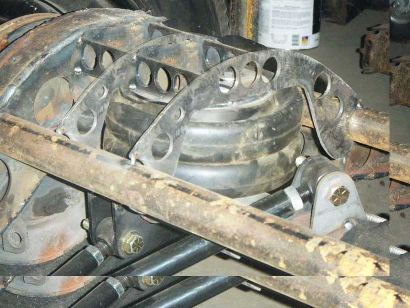

    I'm just glad you won't be driving that death trap near me or my family.

  4. I am being sincere here. You REALLY should rethink those bag mounts. Peoples lives are at risk.

    I actually am going to.... I had an original idea I am going back to actually. And thank you for being somewhat respectable about things.

    Nope, just hate to have someone put stuff up like that and then not listen when PROFESSIONAL ch***is guys tell you its ****ed up and you come back to say if I had any doubts about it I wouldnt run it.
    SORRY I was concerned with the safety the folks on the road besides yourself.
    By all means, run it. when it breaks and kills someone, you can always say I didnt know, Oh wait, no you can't.
    If your going to change it then I guess I did my job.

  8. Listen to Datinman, he happens to be a pretty well rounded fabricator and race car builder. He has yours and your customers best interests at heart.

    See how easy the trash talking can be? Lighten up and try and learn from the input. Those pictures show flimsy ill thought out mounts. Now, lets see the other idea you mentioned.

    Never questioned your professionalism, you put it in question posting that stuff. As for doing this for a long time, so have I, and my stuff isnt the stuff that "kids beat on".
    Had you posted this as a how does this look, or do these mount look strong enough, I would have been less of an ***hole and more like the beloved Tman.

    Photoshop to the rescue. Do this, then gusset everything.[​IMG]

    Kinda had something like that in mind, then this other thing, then... Ah ****...

    I have to agree with the 37kid. I'm in the process of doing a 49 Cad ch***is that will be detailed to the max. Ford 9 with polished Winters center section and Strange polished pumpkin. Chrome link bars with everything powdercoated and looking pretty. When I put the body on noone will ever see whats underneath. But I know it's done right and will withstand any abuse I throw at it. So yeah you had a kool idea but build it to take some abuse and you'll sleep better at night. Pretty only goes so far:D

    Those mounts look a lot better, and still have plenty of style.

    Now this is much better. But I would just skip the holes,Gusset and burn them in good and hot.
