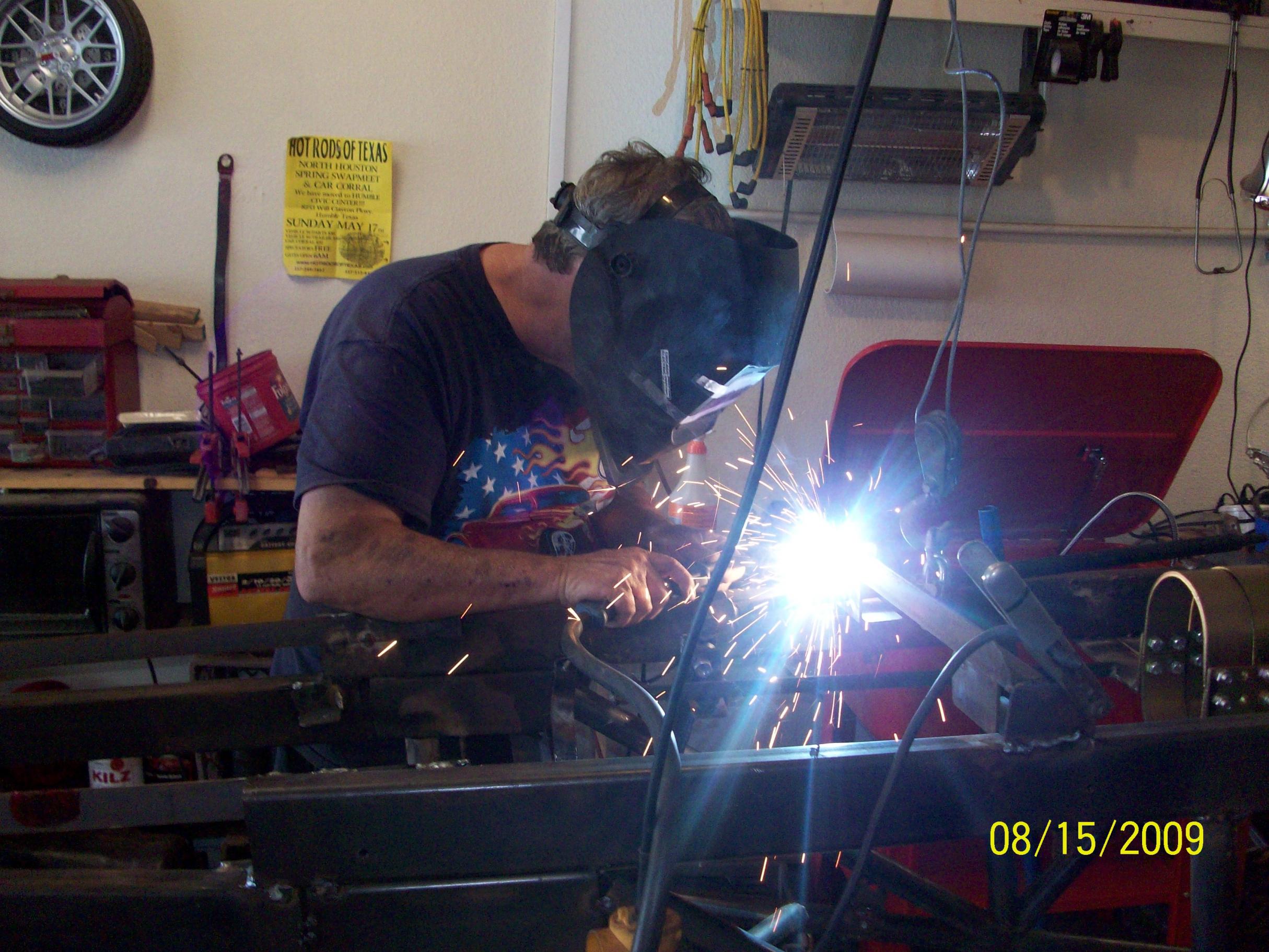

    Well, the car is completely disassembled and the welding has begun in earnest.
    My wife says I am most photogenic when I'm welding...see the helmet covers my....aw forget it.
    Lot of material consumed in a NHRA spec cage. Looks like at least 3 small spools of wire and three bottles of gas.
