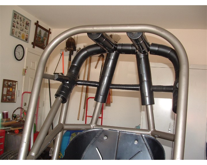

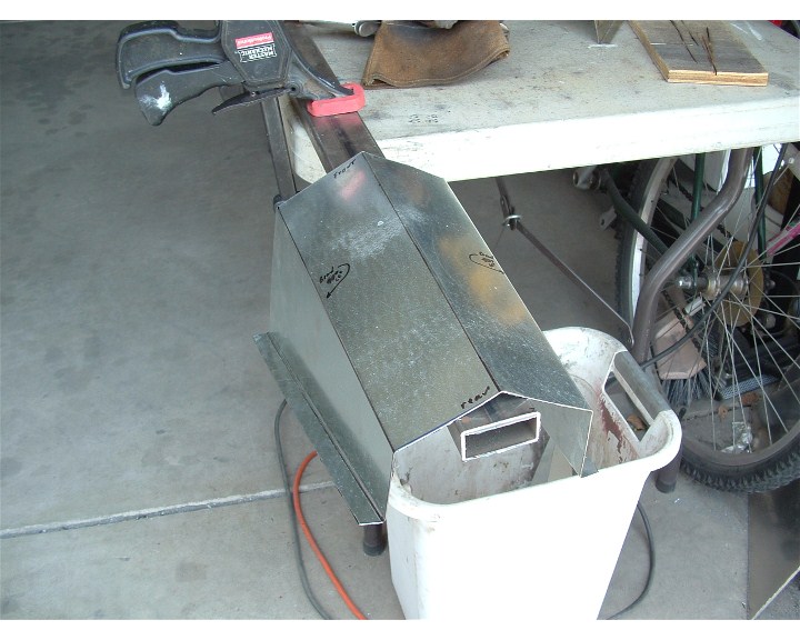

    Got started on powerglide cover today. For those that are not up on the rules on "open trans" and "covered trans",per the NHRA Tech rules you need automatic transmissions covered in the driving compartment if you want to use SFI-5 safety equipment, if you have a open trans you are required to use SFI-15 gear. Cost a lot less to cover the trans than to invest in a 15 suit.
    As you can see from the pictures I have don't have a sheer or metal brake so I cut it with a 4" grinder and bend it over some tubing, paint cans, front and rear tires to get it close. it ain't pretty but it works. Hope to finish tomorrow.;)

    Your work's nice and neat, very clean looking. However, I'm jealous of how nice your pictures come out. Mine always come out too dark, then when I lighten'em up on the computer they get grainy. Is there something I could learn, or is it just plain a better camera? :eek:

    Old6rodder -- Dick, I have always taken my pictures with the flash on so I don't have to lighten them with the computer. My camera takes the pictures at a very high resolution 1280 x 960 size (497KB) and I have a Microsoft Picture It program that reduces it to 720 x 576 that most all Web Sites can except. The camera is nothing special, 12 year old Fuji that we have shot 1,000's of pictures with. I really can't tell you how any of this works, I wish I could, not that sharp.:confused: Thanks for the good word.
    Skip Pipes -- Skip, No I am a realest, I'm learning more each day on how to do this stuff at home and not have to send it out. Being retired puts a little more push on the self fabing when the cash ain't there. It's all good. Thanks ;)

    Well I got the trans cover done today. A little racer tape here and there just to keep it honest. Next is locating and mounting the throttle peddle, setting up the shifter & throttle cables, wiring. I know one thing for sure, the closer it get to being race ready the smaller that driver compartment is getting. Along witjh that my weight reduction program is in reverse, but it's all good and Im still having fun.;)

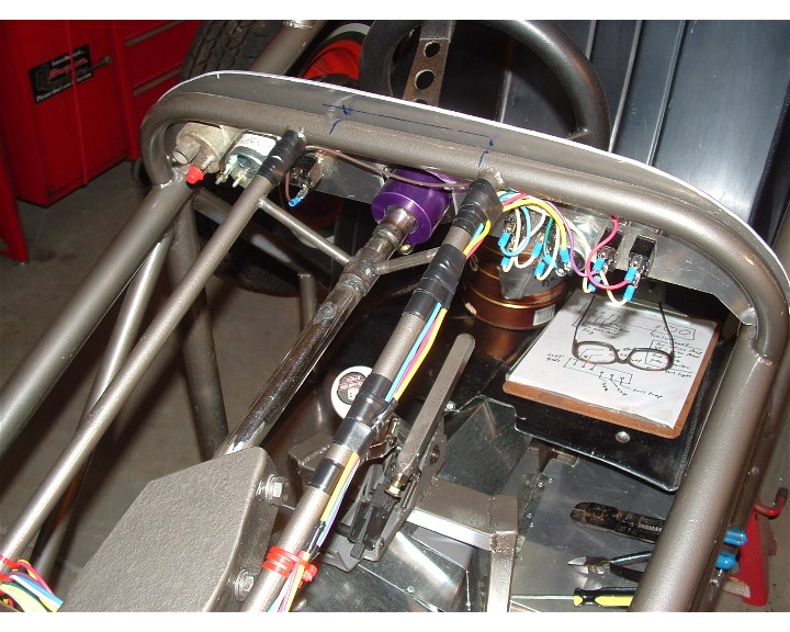

    Got 90% of the electrical done today, need to go to my welding supply store to get material to build the hot wire lead to the starter in the morning. Hope to have electric all done tomorrow.
    Got some cage padding on today. I don't really like how it looks, but I may leave it until after we run the first time. Don't need SFI padding, but this looks to bulky.:mad:
    Working on the riser for the gas peddle that should help me when getting out of the car. Will install another heal stop on the brake side also.

    You're really bookin' on your car, it looks great. :D
    I went with an idea of Gary's (Gorilla Trap). Though I'm using commercial padding (one sided, off-set), I wrapped all of it in cheap, thin, black electrical tape. It mounts it far more solidly than the glues or velcros, and it looks really great, very old school.

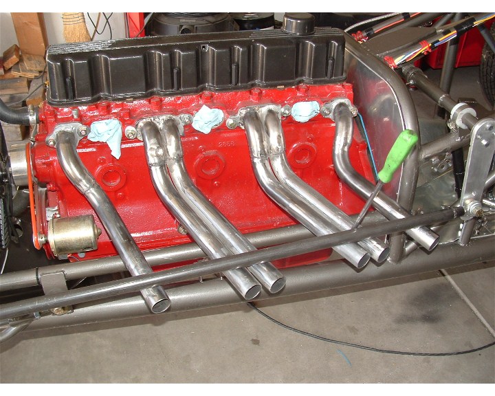

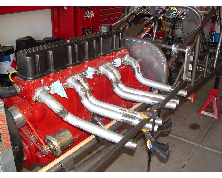

    Spent some time the other night laying out some different header patterns that would work with my top frame rail and clear the steering link. I talked Dick (ThingyM) into passing on the old one he had on his car and with some cutting and welding they look like they will work out fine. See how they look painted and in place with the old modified stock intake bolted up.
    I am trying to set the car up the same a Dick had his so I can see what the "little 194" will do before I start modifying the drive train. It will have the same stock intake (Has been opened up were the one barrel sat) and will still use 2 - 94's like he had it. Motor is still the same as when it ran before. After I get some good runs and information, we will start modifying it to see what she will do with some low dollar changes.
