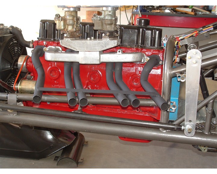

Tom, just remember the arc of the pitman arm will raise the drag link as you turn. Make sure that it doesn't cause clearance problems at lock in either direction. Only mentioning this because I have had problems crop up after "simple modifications" that had not so simple overall effects.
64 DODGE 440 - Thanks Tom, The 3/4-1" of clearance is with the link in both lock locations. I even put the car weight on the front axle so it will be at normal ride height. All looks good and I think it will improve the overall steering setup.
28, I use a MSD coil that was recomended where I got that box. and just followed the instructions. Maybe I just got lucky. Because I am not an electronics guy or mechanic, and this is the first and only car that I have ever built, it took me a year and a half to build it, but it was still easier than learning to ride a unicycle that I did when I was 39 years old. Oh by the Ron Golden told me which box to buy. goldenri@aol.com Joe
Tom, I have a MSD 6A with a Mallory single point distributor on my Anglia with a 355 small block Chevy. The magnetic pickup connectors fron the MSD are not used. Instead, the wire from the distributor connects to the white wire from the MSD unit. The black wire from the MSD goes to the (-) side of the coil and the orange wire to the (+) side of the coil. Steering-wise, I just slowed my steering down. Much too hard to turn the wheels when standing still. Joe, sounds like it was an expensive learning curve with the slant 6. I Googled "Star" pistons and came up empty. Do you have a web address?
Bobw, we ordered them thru a guy that has a auto machine shop, just north of Tulsa (Ow***o Oklahoma) Scot Johnston, that's Scot with one t. we sent a right and left piston (Ross) to them and asked that they copy them. I will look on line also. It only took about 2 or 3 week to get them, I was supprised. I also made my steering slow, because I wanted it to handle on the top end. But I like your idea also, I did not think of that.
Tom W. As you know,I run the VW steering box also.. But my pitman arm is 7" center to center with the steer arm at 8".. And a ****erfly wheel. Steers like its power steering. I think if you get the geometry wrong it will steer like a truck..See ya Thursday..
That's cool, what I did on ours to speed up the steering was make a link in the middle that changes the ratio. It also served to shorten the drag link and line the heim joints up better.
Joe Hamby & bobw - After I sent a reply to Joe last night I pulled my MSD Wiring book out and saw how the MSD 6AL is hooked to a points distributor, and it all makes sence know, I'm just a little slow on some of this stuff, that's why I like pictures so much. With all the FM dragster and altereds I have run I pretty much don't turn the steering wheel without rolling the car at the same time. Just got used to doing it that way. With the dragster axles layed back so far and the steering is very light duty it is a good practice to get into. The new longer pitman arm has my lock to lock at 1.33 turns now. With my hands at 10 & 2 on the small 10" steering wheel I have a nice amount of wheel movement with a 1/4 turn each way. If I have to turn it more than that on a run, I need to get off the peddle. Joe, it has been my experience that the correct toe in has more to do with the car running straight on the top end than the pitman arm length. I have always used 1/8"- 3/16" toe-in on my 8.60 @ 145mph altered and up to 5/16" toe-in on my 7.20 @ 190mph dragster and both ran straight on the top end. As I was told your toe in must be as close to "0" as possible when you cross the stripe on the top end. Others may disagree, but that,s how I do it. I really like the feel and look of the steering link being below the headers and I have a good inch of clearance when it is in either lock position. I'm getting real good at making these pitman arms with hand tools. I think the 3/8" thick alum was fine for the short one I first had on the car, but I may make a second new longer one out of 1/2" Alum to beef it up a little.
Amazing how good it looks for having been done by someone who keeps saying that they are not a builder.
64 DODGE 440 - Tom, thanks for the good word. I must say that I have learned a lot about building and making parts work on this project. The main force into doing the work myself is there just ain't the expendable cash when you are retired.
ThingyM -- Whats with the "Mr Welch", even the kids on my street don't call me "Mr". They use TW because there is another Tom two houses down from us. I did not even try it today, I am going to replace both U-Joints with new on Monday. Just thought that it would be dumb not to while it is out. It's going to fit fine. I spent some time today studying the steering after we talked yesterday. I re-installed the short pitman arm that is 5.5" cl/cl and drilled 3 new holes on the front steering bracket that was 6" cl/cl. I am using one of the new holes that is 4" cl/cl, this gives me a little quicker steering ratio of 1.37 to 1. The old system was 1.08 to 1 (basically 1 to 1). This setup feels about the same and has quickened it a little like I wanted. I think I will try it there the first time. I was starting to set the valves today and found one of the rocker studs was loose, so I pulled all 12 out and I will clean them up and reinstall with new loc***e. Must have been from that killer cam. Sure glad I came down yesterday, I think we got our full years rain today and I just heard the G****vine is closed do to snow. I bet Butch is glad the race was not this weekend.

Well I got the head off the block and had a good look at it. I think while I have it off I will have 194/160 SBC SS valves installed and have the guide tower cut for seals. I am going to have Z28 flat tappet springs installed that are good for most any cam I will run. There is some damage to the #2 & #4 lifter bore and if is going to cost to much to repair I think that taking the 230 standard bore block I have and dropping the 250 crank in with some 307 FT pistons may be a better choice at this time to get a motor up and running. The 194 motor is a first year block (1962) and I was a little surprised at the different numbers for the piston top to deck measurements. My 250 motor was right at .035 on all 6 cylinders. The 194 was from lowest at .042 to the highest at .076. it has some old replacement .040 over pistons in it, but the deck does not look like it was milled
Sounds like the little 194 needs some serious TLC. The 250 with 307 pistons is what's in my T, nice ol' motor. Good luck, P=Dog.....
I bought one of those early 194's for the head. That's when I found out about the siamesed exhaust ports on those early heads. S**** metal. Some of the slant 6 guys find quite a bit of taper front to back on the top of the block. Is yours random for deck height variation? Sure hope you build the 230/250. That could be a real performer. We will learn about the cause of cam failure tomorrow, right?
P-Dog -- Ya a little TLC + cash, I like the idea of the 307 piston, only problem is finding forged pistons. Cast may work fine as I am builing for 6200-6500 max RPM. What are you using? bobw -- Ya the early 194 with the siamesed are good anchors, this one has a later 194 small chamber head that may have been changed when they went .040 over. No the deck variations are lowest at the front and get bigger at each cylinder as you go towards the back. I measured at 4 places on each piston (3/6/9/12) and took an average on each one. If the machine shop has to bore and sleave the lifter bores, I think I would rather put my cash in a bigger cubic inch motor. There is a lot of good stuff on the head and they would work great on a bigger motor with some additional work. With .060 cut of the head and the block -0- deaked I can get about 10.75 - 10.90 CR with FT pistons. I hope to figure out the cam problem tomorrow and include a few pictures, we will see. I had high hopes to race this season, but it may be a short one at the end of the year.
