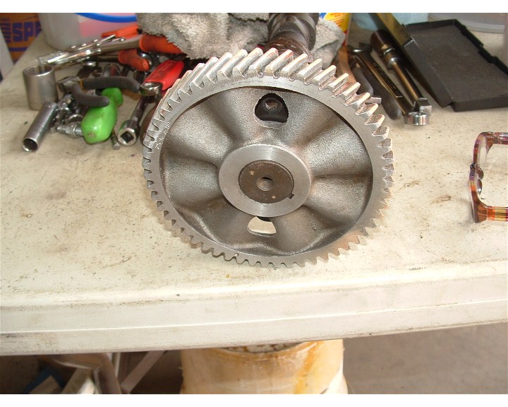

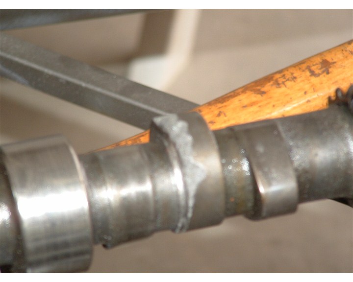

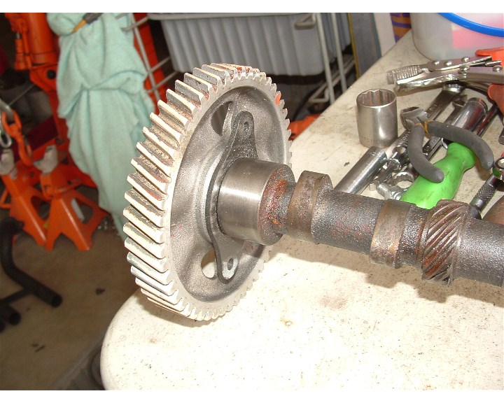

    Well racers and builders I have spent 5 hours this morning installing and removing both the 194's Clay Smith Cam and the Erson Cam from the 250 motor I have. I am not that good with putting this out to read so I included a few pictures. I did not take a picture of the cam gear when I removed the cover, you will just have to trust me with that part.
    First I installed the Erson cam that has the gear and plate in the right place and checked out the lobe location in the bore. They were very close to the center of the lobe being in the center of the bore.
    I removed the Erson Cam and installed the damaged Clay Smith Cam and it was very apparent that the lobe location was more towards the rear of the motor about 1/4" and the right side of the lobe was in the bore center and you could not see the left side (picture shows it).
    The only difference in the two cam setups was the fiber gear on the Clay Smith Cam was not smooth cam/gear on the ends, the cam was back inside the gear about 1/4". Note the cam is junk so what I did next was to reset the two screw plate on the back side of the gear and hammer the gear all the way on. This is a pressed on fit and I was able to move it with a normal ball peen hammer ( not a sledge ). It was not that tight on the cam. I reinstalled the cam and the lobes match the Erson cam.
    From the damage I have found one or two more p***es and all the lobes and lifters would have been damaged. I am going to try cleaning up the #2 & #4 Exh bores with a wheel cylinder hone to see if I stay with this motor or not. one of the pictures shows where the cam was back so far that the #2 lifter took a peace out of the fuel lobe.
    It's been a long couple of days and this is way to long so I'm out of here for now.

    Oh OUCH!!!
    I think I'd be very tempted to drill and tap the front end of that cam and use a retaining bolt, bolts are cheap, cams aint!
    I'm happy you found the problem :~))
    Take an old lifter, you should have about 12 of them now (sorry) and drop it down in any lifter bore that has damage around the bottom end then tap it around with a hammer, sideways to the lifter bore, and that should push the material back out of the way and allow the lifter to move easily in the bore. Don't forget to deburr the hole after your done to keep the loose kwap out of the oil.
    Thanks for the post and the pix, GOOD LUCK,
    P-Dog

    P-Dog -- I agree with you about the retaining bolt & washer for the front. Chevy installed the retaining plate to stop the cam from walking forward, but only use the cam gear for rear movement and it don't work so well. As I did not install the cam I am unsure if the area where the gear slides on is straight or tapered? Also is the key angled so it get tighter as you reach the meeting point at the back flange? I will know more when I talk to Clay Smith Cams later this week on a replacement.:confused:
    I know some of this is old hat for some of the builders and racers out there, but if it helps someone in there build it was worth the time to get the information out.;)
    I have built lots of SBC & BBC race motors in the last 40 years and this is the first time I have had a cam problem like this, or maybe I was just plain lucky.:D

    Old28,
    The cam snout should be straight with a key, just a basic press fit that didn't hold for some reason, shaft to small/gear to large but close.
    I'd sure toss that fibre gear about as far as my aging body would allow.

    When cam gears've been pressed on and pulled off a cam too many times it can leave the shaft and/or the gear worn enough to be unable to hold properly by the intended friction. You can use a chisel and hammer to carefully "****** up" (raise some ridges on) the shaft a bit (only a bit), then sweat the gear back on rather than pressing it again. I've had to do this a couple times (awhile back :rolleyes:), it only costs a bit of O/A, and it works nicely. I haven't, however, tried it with a fiber gear, but it should be do-able carefully.

    P-Dog -- I cleaned the two lifter bores with some fine paper and WD-40 then used on of the still OK lifters and worked it up and down until it would drop to the lobe on the good Erson Cam. Turned the motor over by hand a few times until I could bring it up the bore freely. Worked great, I did all 12 holes and they are fine. Ya that fiber gear is gone, I only use aluminum gears like are on the Erson Cam. I am going by the machine shop tomorrow and see what it would run me to have (my first stage head work done) SBC SS 1.94 Int/ 1.60 Exh, Z28 Flat Tappet springs, Hardened seats, Cut for valve guide seals and mill .060 off the heads. Second stage is for later ( Lump ports ). All it takes is money.:rolleyes:
    Old6rodder -- **** I have used that exact modification a few times myself. This was a new cam & gear that was pressed together and should have not been a problem. It's hard to say what caused the failure, I have a couple of ideas, this is why I like to build my own motors. ;)
