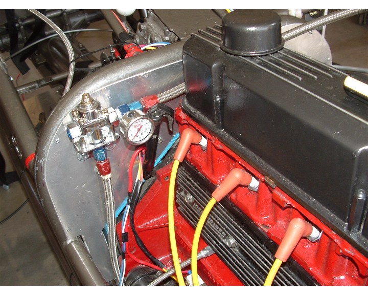

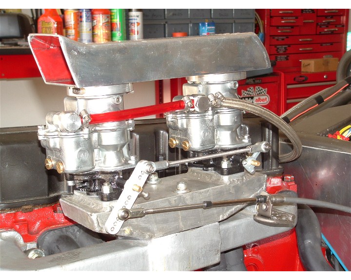

    Well the carbs, linkage and fuel lines are done. I need to get a vacuum source for the PG so if I want to leave in in high gear it can shift by it's self. Some times it works better if bracket racing (more consistent ET) even tho you give up some 60' time.
    Hope to fire motor later this week. :eek:

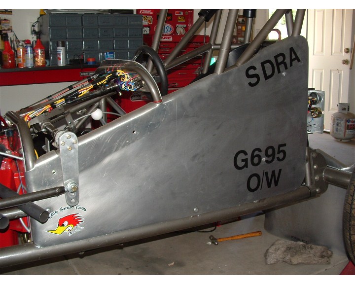

    Ya ****, I tried to fire the motor yesterday and must have missed a hole I bored through in the heat chamber as I had gas running out the bottom of the intake. I am removing the intake so I can epoxy the bottom heat chamber. Hope to have it back on Tue & try again.:rolleyes:
    No paint this year, just letters & numbers on alum panels. Will paint it during the off season if I don't put the cash in a new "BIGGER INCH" motor to run with the 300" Fords & Chevy's.:eek:
