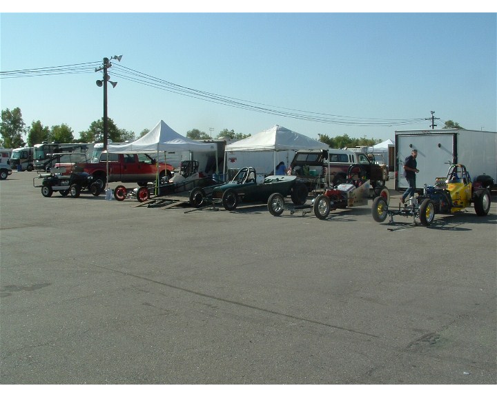

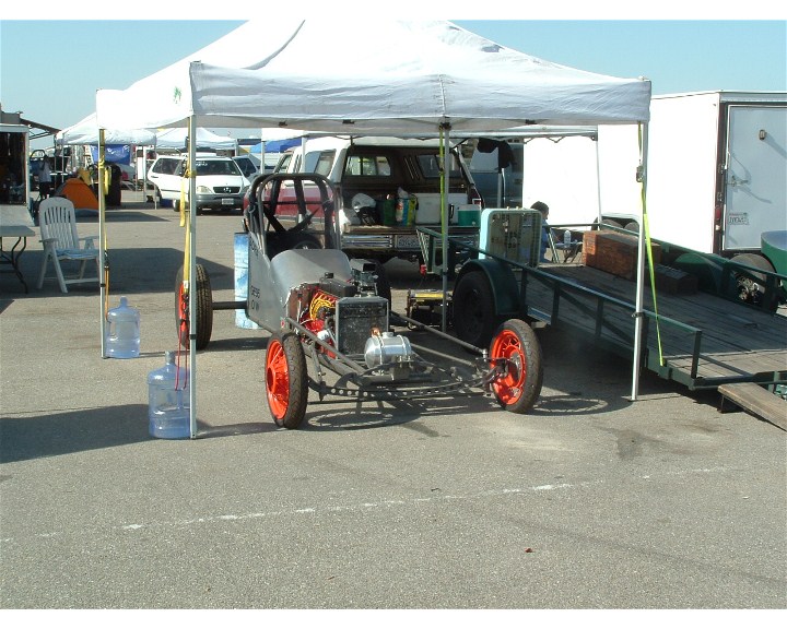

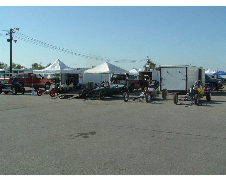

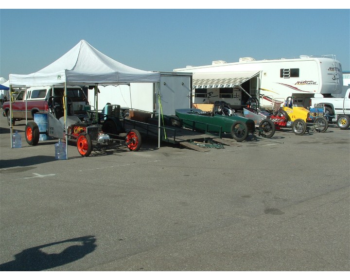

    Well this weekend at the ANRA Nostalgia 2nd race, Famoso Dragstrip, Bakersfield, CA was about as hot as we get in this area at 104 deg on Sat and 106 deg on Sun. It felt like 120+ in the stagging lanes. The only good thing was the humidity was 8%, I know you guys in Tulsa would take that over 85% any time.;)
    The 2 regular HA/GR of Joe & Jenna along with ****s HA/GMR were there to race and I had my SDRA ride there so I could promote the cl*** and have the car tech to see where I need to make changes. I am sure old6 will fill you in on the racing as I took off after the first round. :D
    Tech was no big deal, only a couple of small things. I need to completely modify the brake system and the steering before the Aug race. We fired the car up and it sounds real nice, it was running fat, I need to change out the jets as we had a CA (corrected al***ude) of 4800 feet both days and it will be the same in Aug at the 3rd race. Normal is 830 - 1500 ft.
    A couple of pictures of the cars in the pits.

    Nice to see all the cars lined up. Whew! That would be too much heat for me.

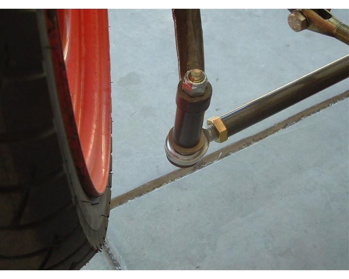

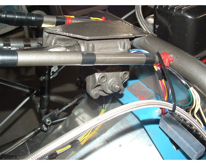

    I'd like to know also ,I saw your steering setup with the spacer between the drag link and the steering arms, looked like a good idea but was wondering if it would p*** tech, i'm getting ready to heat and bend my arms to clear my wishbones , but if that will p*** and it seems to work OK, I'll go that way , Thanks Tim Jones

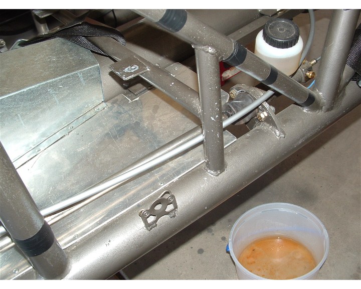

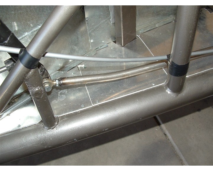

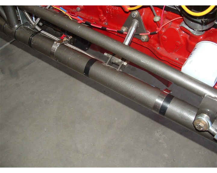

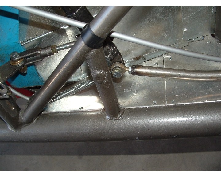

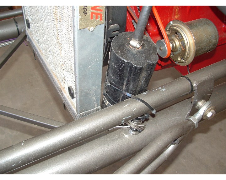

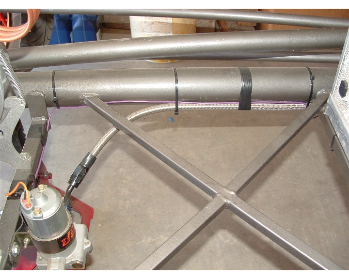

    bobw & injected27 -- Most all the problems were small items.
    1 -- Securing fuel lines with "aircraft quality" stainless clamps along the frame, no water hose clamps or tie wraps.

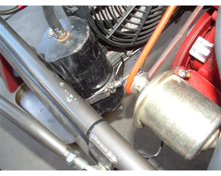

    2 -- Need a second SS hose clamp on water overflow can.
    3 -- Need to clamp rear brake line on the housing, no tie wraps.

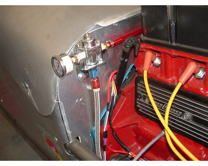

    4 -- Need to relocate fuel regulator to the front by the tank, it must be no closer than 6" from the flexplate & cover. Going to mount near the fuel pump.
    5 -- Need to drill out the Rosetta welds on the front loop were we sleeved it and reweld the Rosetta holes and "DO NOT GRIND THEM", I new that they would get me on that, not a big fix.
    The main ch***is, front end, rear end, steering, shifting, trans cover p***ed with no problem. There was no tech steering problem, I just need to tighten up the play in the VW box or replace it with a rebuilt one.
    I am going to rebuild the brake lever system and replace master cylinder with a Wilwood unit.
    Pictures of the area's that need fixing are shown below.
    Will post fix pictures in a few weeks with any luck.

    old sparks -- You can read the above reply that lists the item's that need to be changed. Not a big deal at all.
    The biggest item was welding. Just remember no grinding of any welds in the driver area ( more or less from the firewall back ), our tech really looks at that stuff.
    Just a note, fuel & brake lines need to be solidly secured (no tape or tie wraps) any wiring can be tapped or tie wrapped.
    Also try to route your fuel line so it is 6" plus away from the flexplate cover area.
    Another thing is make sure that when you build your cage that you have the required 3" clearance from the front of the helmet to the face of the front hoop. They tagged 6 open wheel cars last year on this rule and they measured mine with a helmet on Saturday.
    I will post pictures of the changes in a few weeks when I get them done.
    The nice thing is that when you get through our tech at Famoso in Bakersfield you will be able to p*** tech most any place.;)

    dragsled -- Tim, I am not a fan of heating spindle steering arms, I know it is done a lot, but not for me. The 1 3/4" spacers you see on the bottom are installed with grade 8 bolts and heims and work real well. The small round spacer on the left side spindle top is cut on an angle to help the front steering arm heim run more true. Again with grade 8 bolts. I have used this system before on my race cars and had no TECH issues.
    What are you building? Have you started a build thread? Thanks Tom

    Thanks Tom , I really didn't like the idea of heating them either but until now thats what I had heard what was done back in the day so to speak, My build thread is my signature just click on it to open thanks again Tim Jones
  16. Old28
    Joined: Jan 11, 2009
    Posts: 1,390
    Old28
    Tim, a couple of close up pictures.

    Thanks a bunch Tom , another one of the many odds and ends figured out, thanks again Tim Jones

    Tom, thanks for posting pics of the details. You pointed out a few things I need to address.

    bobw --Glad to show pictures and I hope they help others. Anyone tells me that they built their car and it was perfect the first time is full of (you know what).:rolleyes:
    Worked on my steering box today, I had about 2" of play on the 10" steering wheel before any sign that the tires moved. I was able to tighten up the gear adjustment in the box and I added a new larger bolt with a tighter clearance were the shaft extension is bolted, the first hole was junk and most of the play was there. Now I have about 3/4" max play, I will try it and see if I can live with it. I run a hex quick connect and the are a little on the loose side and some of the play comes from that connection.;)
    Then I got started on the brake system next, tested the (I don't know what brand) master cylinder and it works fine, checked the lines & flow to the wheel cylinders, all OK. Will start working on the peddle mounting tomorrow.
    Pictures of the changes when I am done.

    Well I have most all the little tech item's taken care of (still need to get the tig welding done). Before I started on their stuff I wanted to dry and get my steering a little tighter and redo my brake peddle mounting system.
    As I told bobw above, Worked on my steering box today, I had about 2" of play on the 10" steering wheel before any sign that the tires moved. I was able to tighten up the gear adjustment in the box and I added a new larger bolt with a tighter clearance were the shaft extension is bolted, the first hole was junk and most of the play was there. Now I have about 3/4" max play, I will try it and see if I can live with it. I run a hex quick connect and the are a little on the loose side and some of the play comes from that connection.;)
    After talking with old6 at the race a few weeks ago along with him trying the car on for size it was clear that I needed to make some changes. The two main problems were the shaft could come out of the master cylinder and the peddle mounting pin was flexing when you got on the brakes. The pictures show the changes better than I can talk about them, but this is the short version. Build a new 3/4" CM actuator shaft, added boot to master, built a pin support to take out any flexing, install a free peddle stop & a spring to bring the peddle back to start position. Works real nice, no pin flex at all and I have about 2" throw at the peddle top. I still need to build a new peddle, need to try this first on my street.;)
    Know for the Tech Item's, Installed T-Clamp on the water overflow tank, Moved the fuel regulator from the fire wall to the front and re-plumbed the system, Installed T-Clamps to the fuel lines & back axle brake lines, But a second spring on the carbs (must have 2 at carbs even if you have 1 on the peddle.
    If the world is right at the next race I should be through tech OK.:eek:

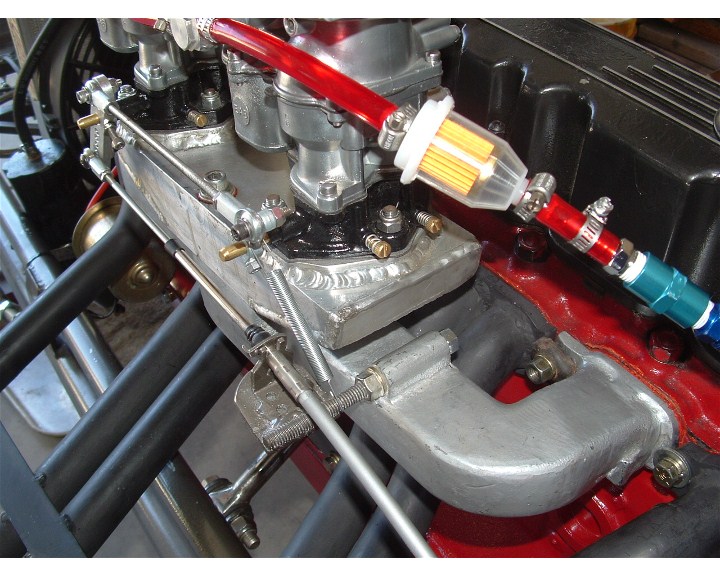

    Got a little more done today. The new soft plugs are in the head and sealed good, filled the system with water and tested, no leaks.:rolleyes:
    I changed the jets in the two 94 carbs from 54's to 51's and ran the motor to get some heat in it, sounds better, not so rich. Both the water system and the newly plumbed fuel system worked great. Motor idles about 700 RPM (just a guess, no tac yet). I need to install a longer screw to adjust the linkage when setting the idle.
    With the fresh oil and filter in I ran the motor for about 5 min and was able to test the powerglide & converter, able to go through the gears and spin the tires. All worked good and the rear end sounds fine. I need to raise the RPM 100 as it pulls down a bit to much when it is in gear at idle.
