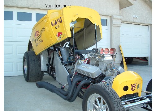

    injected27 -- Jason, these are the last two cars I ran from 1994-2010.
    The dragster shot is of my wife at Bakersfield, CA on the top end. This car ran NE-1 & Pro 7.0 (7.50 & 7.0 index). Best p*** off the index was a 7.01@199.63 in AZ. Motor was a home built 468 BBC all iron motor, blowen & injected on alcohol with a PG.
    The 1928 altered roadster was a NE-2 (8.50 index) car that ran a best off the index 8.03@161.54 at Woodburn, OR. The body was a true street rod unit with all the bracing, not a real light drag body and the car weight was 2113#. Motor was a another home built 501 BBC all iron with a tunnel ram and injection on alcohol.
    Wish I could have keep the dragster as it was the best handling car I ever ran and the old school lettering and paint style was all 60's. Lace inserts in the paint and gold leaf lettering all old school hand work.:mad:
