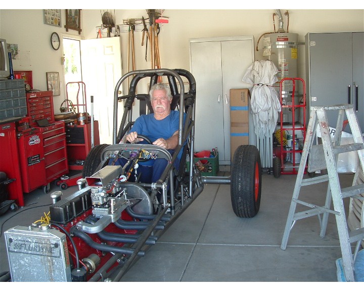

    Well got my old school seat cover back and I think it looks cool and fits the car style.
    As you can see in the picture I still need to get my Rosetta Spuds re-welded in the next few weeks and we should be good to go for a T&T before the August ANRA race.

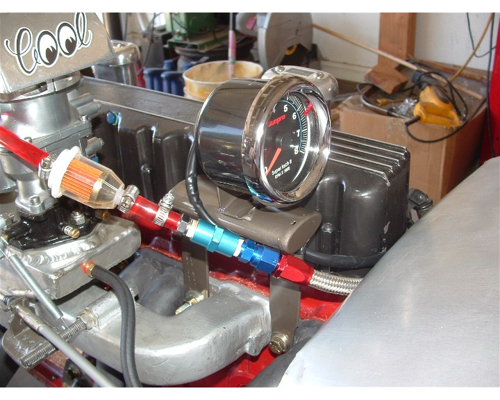

    Well friends I have been a little under the weather the last few weeks and have not worked on the car. Feeling a little better today and put the finishing touches on my tac bracket, got it painted and wired. Tested it out with a motor run and she works fine. I will say it is nice to be able to set my idle a little closer. I will need to get one of those "Go Pro" cameras to record my runs as I don't think I have ever look at the tac on a run in my 40+ years of racing:eek:.

    Looks good, Tom. Just so it doesn't shake too much mounted on the engine.
    I too, never see the tach. Frankly, I don't know what I look at during a run.
    Glad you are feeling better.

    Ya Bob, I thought about that when I was building the bracket. My aluminum body and firewall vibrate more than my motor. The needle was very solid through the RPM range and at idle (were most of the vibration happens) it was OK. Maybe just luck!
    With me not looking at the tac during a run it don't really matter if it vibrates or not.;)
    It's like gauges, most of us look at them when we start the car, never looked at one during a p***.:rolleyes:

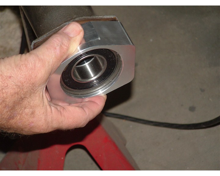

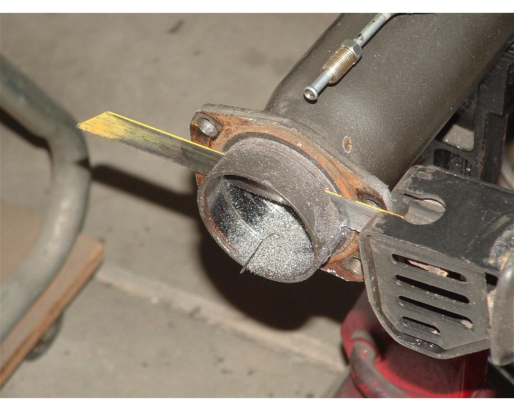

    Well I got a little more done on the axle housing today. My new inside puller showed up yesterday and make short work of removing the inner bearings, took about 2 min to get 2 bearing out. Am***ing how well things work when you have the right puller.:D
    Cut the tubes and checked the Moser C-Clip Eliminators for a trial fit. All looks good so far. Will trial fit the eliminators with the backing plates to make sure they match up true and then take it apart and have the eliminators pressed on the axles.
    More in a few days.:rolleyes:

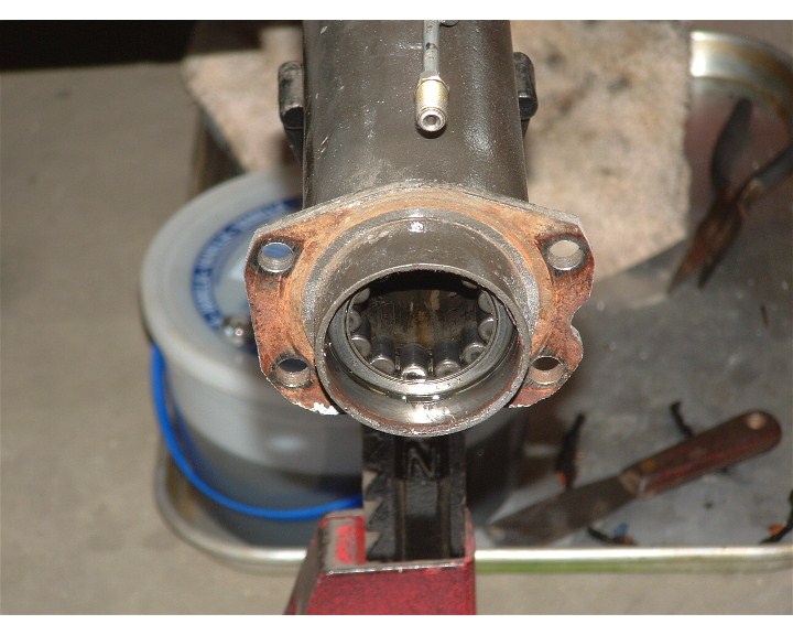

    Well got my replacement Moser C-Clip eliminator kit on Friday and had the other unit pressed on, went fine this time.
    A little run through for anyone that may do a Ford or Chevy C-Clip replacement, they are both about the same. Remove the roller bearings and cut the housing as per their work sheet. Clean up the cut and try the eliminator by hand to make sure you have cut and ground enough.
    Press on the eliminator units as per their work sheet. You will need to cut off the old C-Clip saddle on the end of the axle so they wont hit the center spider gear pin, they tell you about this.
    Be sure to do a trial fit with the backing plate in place and the eliminator unit on the axle and bolted in place. If all looks good remove the axle with the eliminator and put sealer they supply on the face that contacts the backing plate ( take your time and get this right as this is the area that leaks if you have a problem). Re-bolt the unit in place with thread lock on the bolts. I torqued the grade 8 bolts to 45 pounds as they are seated in an aluminum housing.
    The rest was just getting the stuff back together and adding rear end lube. Was not a bad job and I am glad I removed the C-Clip setup. Be aware that it takes a very good press to get the units with their bearing and seal on the axle.

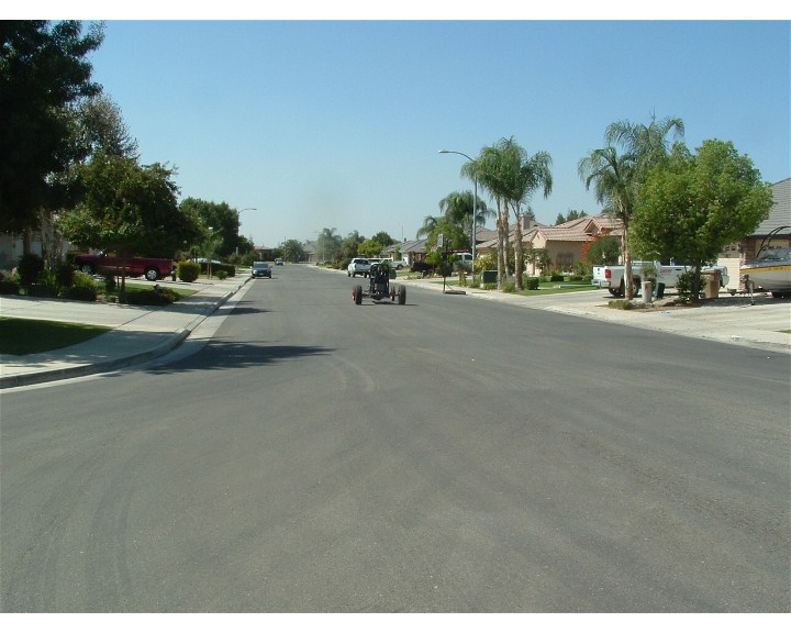

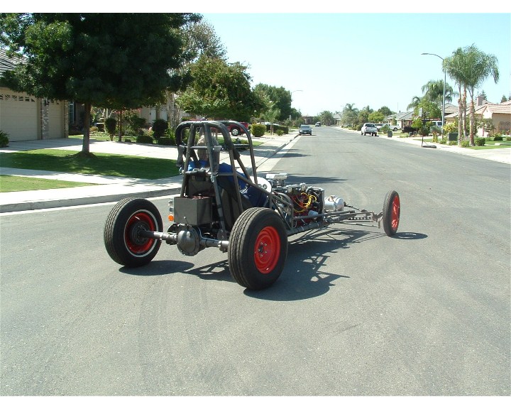

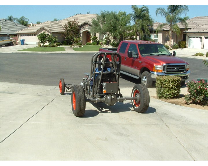

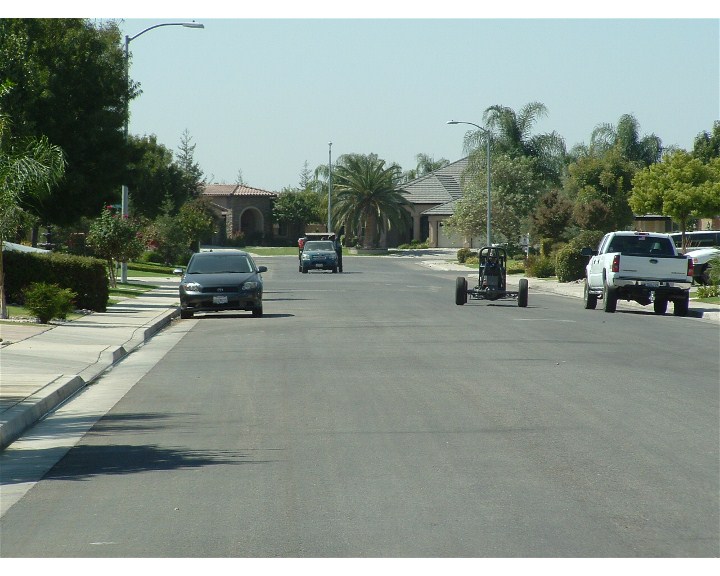

    Well after a little less than 1 1/2 years of building, I made my first street test on my SDRA ride. May not seem like a big deal for some out there, but after two medical scares, one operation & a continuing back problem it's a big deal to me.:D:eek:
    My mind still in the 60's but the body says your dreaming, so I will do what it takes to keep me in this car as long as I can.;)
    Was only able to take some pictures this time, maybe a video later this week. No rubber as my street is full of kids. Have to do it at the track in a few weeks.:cool:

    I hit it a few times and it felt good, but this test showed a couple of things that I need to take care of before we race in two weeks. Race cars are a never ending build & it don't matter if its a 7.50 or a 15.0 car.:rolleyes:
