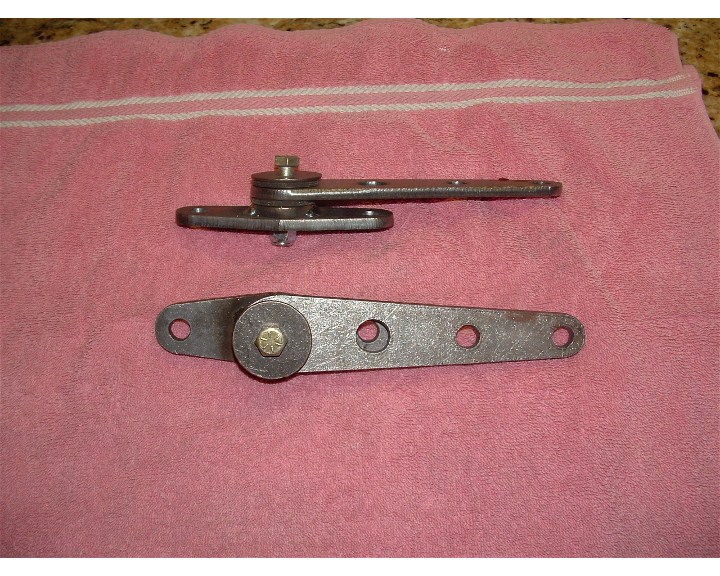

    Bobw & any others -- Bob I just got the friction shocks I ordered, they are just like the ones you built and run on your dragster and 27 roadster.
    As I have never ran this type of shock and was hoping that you could give me a starting point on how tight to set the shocks. Is there a way to test the up & down as they are tightened up?:confused:;)
    I sent you a PM but would like your reply to be posted here so all can see the comments.:)

    Tom, I ain't no expert on friction shocks, or much anything else. What I did was before connecting the link from the shock to the axle, I tightened the shock so it felt similar to a fairly soft hydraulic shock when moving it by hand. Did you get yours from RPM (Ron Pope Motorsports)? They're nice.
    Your car sure looks great.
    The tire pressure information was interesting. I didn't know what bike tires run so I put about 28 lbs. in mine.

    bobw -- Ya Bob, those are the ones he sells on the bay, with my tools it was a no brainier at $33 a pair. Thanks for the information, I will try that.
    I don't know if you have the same side wall type tires, these are road race tires that have a stiff side wall, I really wanted a touring type tire but could not find one in the size I wanted for a descent price. These tires have a max pressure of 20# and can be run at 6-10# for a little more flexibility.
    Thanks for the nice comment on the car, I have started to remove all my brake pedal system and master cylinder as I could not modify it to my liking, so I am going to build a below floor unit with new 3/4" cylinder.

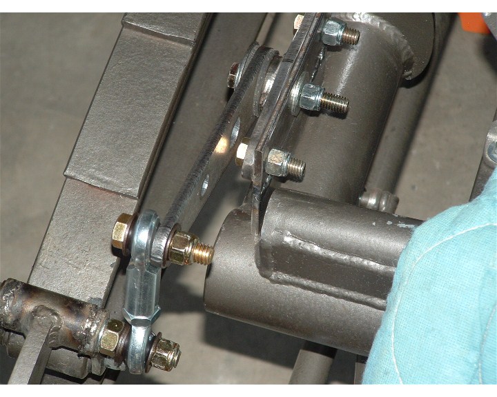

    Got a little done on mounting the new friction shocks. Rebuilt the top shackle mount that is welded to the axle and installed a 7/16 grade 8 bolt to connect the arms to. After looking at the total movement up & down in an arc I think I would have only 1" up/down as they sit now. :mad::confused:
    Thinking about mounting the base 3" higher and making a short link with rod ends so I can get at least 3" up & 3" down with no bind. Should not need more than 6" total travel on most of our tracks, but more is better.;)
    I'll take a new look in the morning. Love this 70 degree weather.:) Makes me want to get out in the shop and fix the mistakes I made in the build.

    Tom, you need a link between the shock arm and the axle. It will bind the way you have it. A couple inches of wheel travel should be enough, unless you are going rock crawling.:D

    Jason, just got started a little today and I already see some problems.
    Bob, When I looked at the start today I could not see any way it would not bind without adding a link to the system. I may have to build a mount that is about 3" higher and build a link as short as I can. I think it will all work pretty good when it is done.
    I TOLD YOU GUYS THAT I WAS A DRIVER, NOT A BUILDER .:D:rolleyes:

    tom, i made shock links useing 4 orchard hardware 3/8`s rod ends (8$ each). two male and two female with a locknut. the total is only about 3 inches long. you might want to install limiting straps as i have had the shackles reverse during hard launches and it scares the heck out of you when that happens. just saying.

    Dan, great way to get them as short as I can. May have to order some from Speedway as most stores don't carry 7/16 that I need. I think we covered the reversal when we welded that top steering side spring shackle at the races Sunday morning. Pour mans Pan Hard Rod,old dirt track trick.

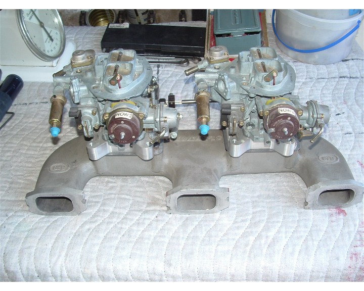

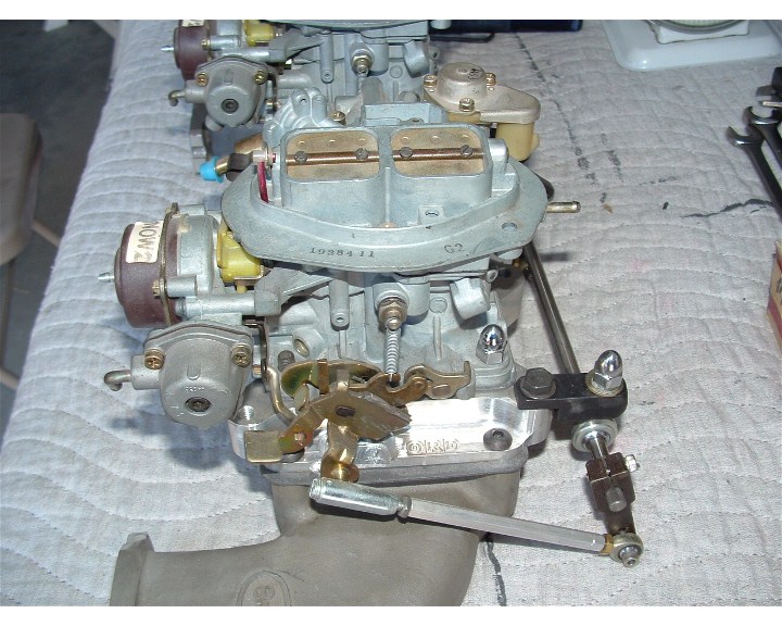

    Well just got the intake carb setup that I purchases from guy on the HAMB on Monday. Price was to good to p*** up and I plan on running it on the built Chevy 250 that I hope to get done mid season 2013.;)
    It is a Clifford 2x4 intake, two 2x4 adapters, two Holley 5200 progressive 2Bbl carbs (about 185 cfm each) and a custom linkage setup. Everything is new, carbs have never seen gas.:D
    Still waiting for my link parts to finish front shocks. Started removing all the old brake pedal setup and will start on new system in a few weeks.

    I run a similar 2 x 2 on my Willys coupe with Autolite 2100s and I love it, it works well even without manifold heat.

    THE FRENCHTOWN FLYER -- That a real nice setup you have on the Willy's, looks nice and clean. Do you run chokes on both carbs or lock one open and run electric choke on the other? Never played with this type carb before so I am just learning. I think it will work well when I get it all sorted out. From what I have read so far, they say that these carbs are a little hard to get jetted correct for each application, but when you get it correct you don't have to mess with them very often.

    Wow like that intake, double pumper the hard way , will look good on the car.

    be careful tom you`re falling into that old trap all of us old drag racers do. you`re trying to get the most out of your combination. imagine that, ha.

    Thanks Al, I hope it works as good as it looks. Those carbs were used on early Ford, Merc, Pinto, Vaga, Mustang 4 & 6 cylinder motors.
    Well Dan, that's what racers do, we are never satisfied.;):rolleyes: I have not got the car so it can make a full p*** and I want more HP. I am also looking at making two extra adapters so I can try running my 94 carbs also. I would like to drop that intake with the 94's on the existing 194" motor and see how it works.

    Nice intake/carb set up, Tom. That should work out well.
    I've looked for those carbs all summer & fall at swap meets but no luck.

    bobw -- Well Bob, they always say out this way that if you have a "Long Hot Summer" you should have a "Mild Short Winter. With April - Sept temp at 90 - 115 it was one HOT/HOT/HOT & LONG summer. I do know what you mean about a long cold winter. My 16 year old grandson played there second Prep State Final game last Friday and when game started 7pm it was 56 deg and 2 1/2 hours later it was 36 deg at the end game.;):)
    I am real happy that I fell on a great deal (4 bills) for everything you see in the photo's. I am already building a second adapter plate with 1" risers that I can try my existing Holley 94's on. The intake should breath a lot better than the old modified stock unit. I am going to use the bigger carbs on the Chevy 250+ build.:D

    Got a little more work done on the front friction shocks today. Thanks Bob & Dan for the corrective comments and ideas, never to old to learn a few new tricks. That link setup is nice and short and the shock does not mount to high. Should be no binding problem with the links. Some grinding & welding and we should have one side done tomorrow.;):rolleyes:

    nice job on the shocks. i wish i`d have found that intake before you. i think you will be pleasently suprised with the new intake. my opinion is the less convoluted the induction is , the better the intake charge is. less chance of hesitation on a lower rpm hit. that is the theory behind the sidedraft install. i`m thinking about using 3 or 4 harley carbs after i get the car sorted out.
