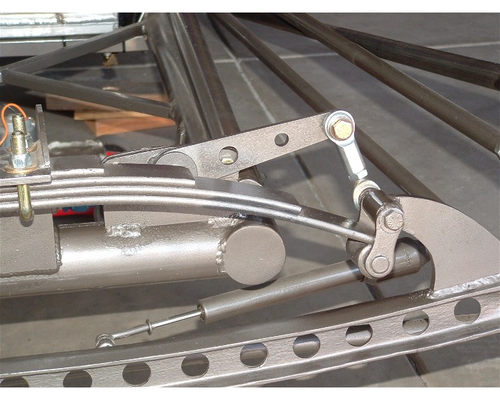

    Well I got the friction shocks installed on the front end. Strange how it is so much essayer to work in the shop when it ain't 115 deg. I love this 65-75 fall weather in the valley.:)
    I think I have covered all the suggestions and ideas to control the front end side to side bounce. Checked rim trueness (OK), Balanced both rims, Installed friction shocks, welded top of left spring shackle so the left side leaf setup aces as a pan hard rod to keep the the chassis from moving sideways in the shackles (we had about 1 1/2" movement each way) and I will run my front tires at 6-8 PSI as the cycle boys do.;):rolleyes:
    Now it's on to a brake system that works & will hold 2500 - 2800 RPM at the start.

    The installation looks excellent. If you still have a problem then I would suggest you move the spring perches outward so they are 3" wider apart that the width of the spring when there is no load on it. For example, if the spring is 26" wide, the perch eyes should be 29" apart.

    bobw, Bob, thanks for the good word and the comment on the perch eyes. I really like the shock setup and think it will work real well. After all the work and checking all the components, I really think that the lack of shocks and the high front tire pressure (we ran 22# at the race) was the cause of the problem. The rims and tire balance was not off that much.
    Like I told Dan, I will check it out at our first T&T in late Feb 2013.

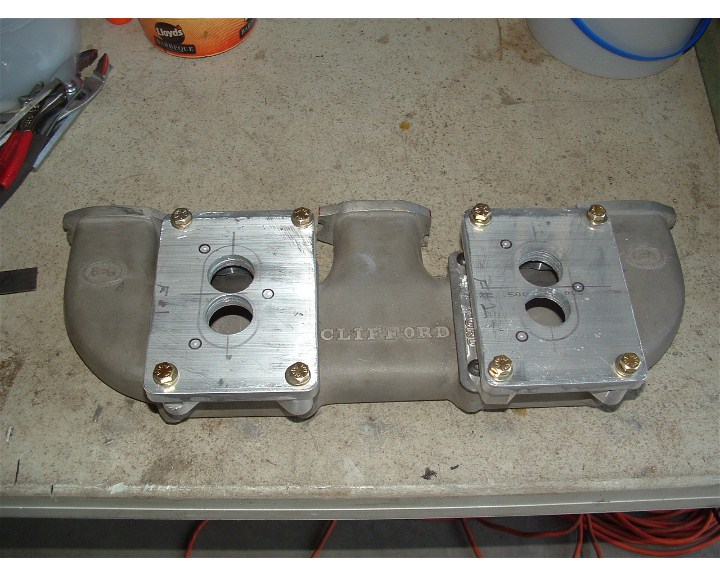

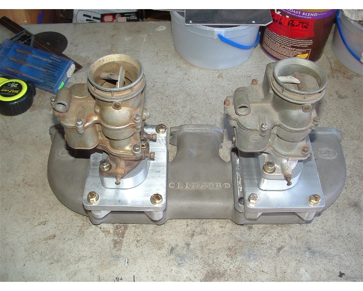

    Had some time today to work on the adapters that will mount to the Clifford 2x4 intake I got with the Holley/Weber Progressive 2 Bbl's. They have a 4 to 2Bbl adapter on them so I made some simple 1/2" thick plates to mount to them. Sat a couple of parts 94 carbs on it to see how it looks. I am going to run 1" risers so all my existing linkage will work. I think this free flowing intake will work out good with my existing Holley 94's on the 194 motor.;)
    As with everything I have done lately we will just have to see how the test goes.:rolleyes:

    The intake adapters are looking really good. Nice work.

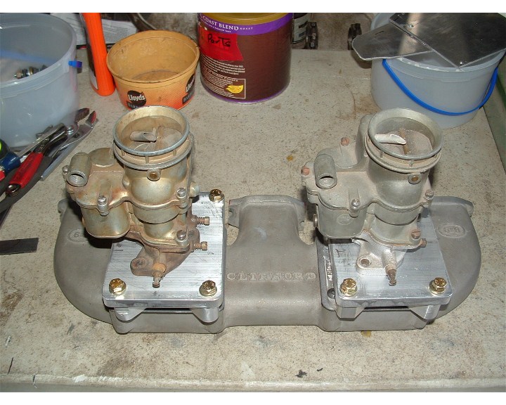

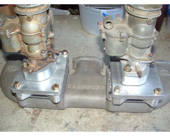

    Well the 1" carb risers showed up today so I had to put it all together with some old 94 carbs to see how it looks. The risers give me clearance on both side of the throttle shaft so I can use my existing linkage.;)
    I will leave my existing 2x2 setup built off of the original intake on the car until I am able to make 2-3 full passes as a baseline, then I will install the Clifford Intake with my existing 94's and see if it makes any difference. If there ain't a good improvement you might see some nice parts for sale on the HAMB in the future.:rolleyes:
    I put in a couple of pictures of the existing setup and the new one.

    A person would think the Clifford would be a major improvement. It will be an interesting test. I hope is runs like "Jack the Bear".

    Well lets hope so Bob. At this point I would just be happy to make a full pass to see what the current setup will do. I started modifying the sub floor support so I can fit the new brake peddle / master cylinder package. Cash is a little light so I will order it later this month.

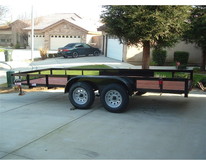

    I did take the first step towards down sizing as I sold my enclosed 24' trailer and will start work on modifying a 16' dual axle utility trailer in a few weeks. Will be building a upper level 6.5'W x 9'L on front trailer section to hold my pit cart and the dragster will ride on the trailer deck below.:D:eek:
    When trailer is done I will be selling my Powerstroke Diesel Crew Cab and start looking for a Chevy truck (1949-65) as a new pull vehicle.:)

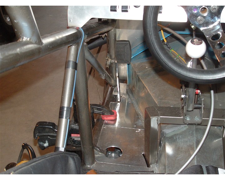

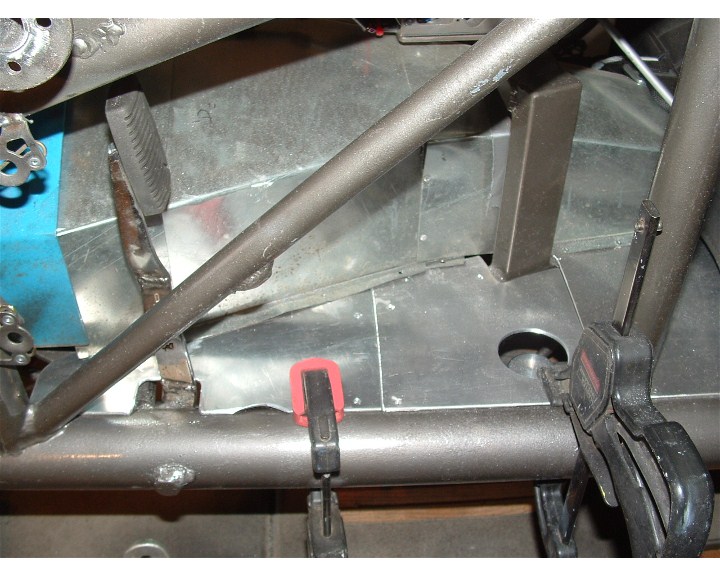

    Well got a little more done on the brake pedal & master cylinder remount. The new system has a pedal that works out to 5.8 to 1 ratio and it operates a new CNC 3/4" master for some additional wheel cylinder pressure.
    The pivot is 5/8" grade 8 bolt in a sleeve through the frame and welded both sides. Nice strong setup. I was able to move the pedal forward
    2 1/2" for some additional foot room. Just need to plumb line from master to rear end. Maybe street test next week. Welded pedal is only temporary, if all works out I will cut a new one.

    So ...... street tested yet? :D
    New system looks good. :cool:

    Street test this weekend if it don't rain. The movement of the pedal operates much more normal. Not sure until I test but I think the old master cylinder was not operating correctly, the new one from CNC works great with only a 6" tube connecting pedal and master. Also I was able to move the pedal 2" forward for a little more leg room. We will see this weekend.:rolleyes:

    Going back a bit, did you use a hole saw for the throttle bores on the adapter plates you made?

    Going from a 1" master to a 3/4" master gives you an instant 75+% increase in pedal power over your previous system, a healthy improvement. Your 5.8>1 pedal multiplies that factor far more than your old 2>1. That's 2.9 x 175%, or just over 5 times as effective.
    There's also a leverage improvement for your leg from the extra 2 1/2" distance of course.
    Without base numbers all I can factor is the percentage of improvement, but all in all, 5+ times is a good thing, yes? :D

    Ya Bob I will try to get the 12 year old that lives across the street to take one with his Ipad if he is around this weekend. 12 years old and he knows more about smart phones and computers than I ever will. Gotta love em.
    Yes I did use a hole saw in my drill press to cut the bore in the adapter plates. The riser came from Dashman with the bores & stud holes drilled. The hardest part was taping the stud holes and getting them straight.
    I had 7 pictures of the work so I put them in.

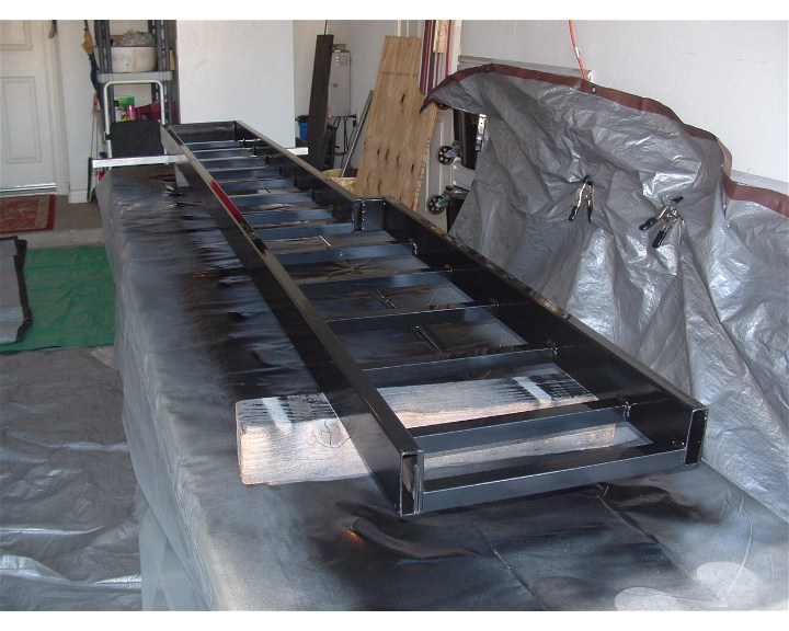

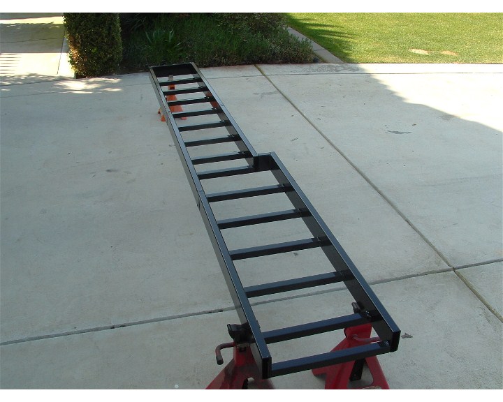

    Working on building the tire runners that will be mounted to a raised platform 36" above the deck to hold my pit cart. Trailer is 16' long by 6.5' wide. Dragster will roll in under the pit cart. Will be mounting a small winch that I saved from the old trailer to pull pit cart & dragster on to the trailer. A few pictures of pit cart runners.
