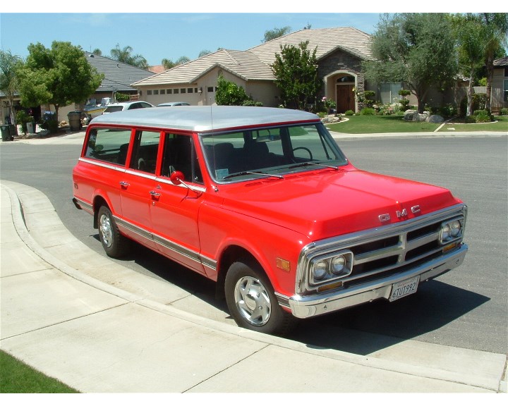

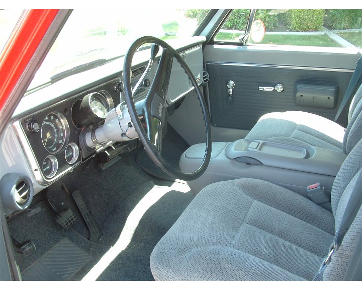

    Well it was a good weekend for me as I found a new (OLD) tow vehicle to pull my trailer. I was looking for a pickup or an early suburban. Found a 1969 GMC Suburban, only second owner with 73,030 original miles, Factory AC (front & rear), PS, PB, rebuilt 350 V8 with a 700R overdrive trans, newer interior with all three seats. Need to get hitch & trailer brakes installed when I get back. Had a good road test getting it home, 120 miles, 95 deg, up and over the G****vine with the ac on, ran great with no issues.

    you have surely broken some kind law to find ride that nice

    Larry, long time no talk, those ET & 60 ft times you posted sure set a high bar for our regular races.:eek::)
    Ya I think the ride was a great find and I have to thank my sole mate with the good eyes for spoting it last Sunday. I think it will work out real fine for the way I want to race.
    The real good stuff is 1) no more CA smog **** 2) no more CA one ton fee at $287 a year added to you already out of sight $300 registration on a 14 year old crew cab. I hate the CA DMV almost as much as NHRA, both are all about the money and don't care one bit about your ride.:D:eek:

    Dang Tom, that's one pretty tow rig. Just needs a push board on the front to make it right. :D

    Great find, Tom. With gas going over 4 bucks for regular yesterday I'm thinking of towing with a Smart Car.

    Tom, Congrats on the great find, should make for a great tow vehicle.

    64 DODGE 440 -- Tom, I couldn't agree more, will work on that. ;)
    bobw -- Bob, with what I save in registration will pay for a lot of gas. That crew cab diesel used a lot of fuel at 4.30 gal. Towing with a "smart Car" means changing your thinking on race car weight.:eek:

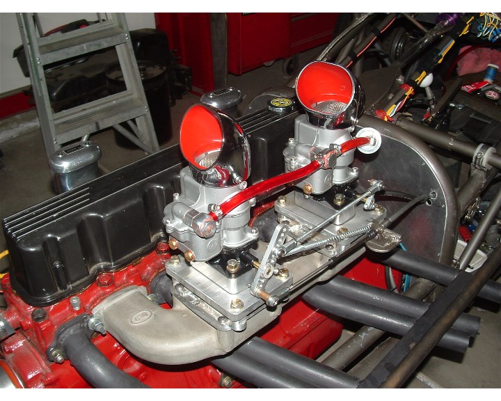

    Make a couple of 2hr carb work sessions in garage today (104 deg ), work for a while, go inside cool off for a few hours, then back out again. Got my rebuilt carbs mounted, plumbed, linkage changed a bit and ran the motor a few times. With the full load of gas from the accelerator pump the squirter's work fine and motor has no stumble when you hit the peddle hard and fast. So far , so good.;)
    I am going to play with my ignition timing and advance a little in the morning and see if I can get the motor to idle a little smoother and a few less RPM's. With the Clay Smith Cam that's in the motor she likes 900-1000 RPM. I have no problem with that if I can get the converter loosened up so I can hold car.:D
    With the 8" 5500 stall converter and 502" BBC Alcohol Injected motor in my NE-2 (8.60 index) would idle at 1800-2000 RPM, when you put it in gear RPM did not change and the car had to get up around 2800-3200 RPM to engage the converter. If I can get a converter set so it will idle at 1000 RPM with no real braking needed and run it up to 2800 RPM to leave I think it would work fine. Still may modify my old 8" converter.:)
    Going to start taking it apart Wed afternoon and hope to have motor/trans/converter out by the weekend. We will see what the old body has to say about all of this work and heat.:eek:

    My old used 8" race converter will start to take hold when foot braking at 60% of it's rated stall, that 5500 converter will start pulling around 3300 RPM. This is all without a trans brake. We plan to open up the converter and reset to a 4500 stall. So it should start to come in around 2500 - 2700 RPM range. Going to talk it over more with my trans guy (has a local race shop) when I get the 10" converter out in a few days.;):rolleyes:
    If I use the 8" converter it is setup for a 30 spline TH Shaft and I may change my PG input from a stock 15 spline. See what we come up with.:D
    Got my rebuilt carbs set and changed the timing a few degrees back to 32, motor sounds real good. The new intake setup wants more fuel and we may have to make a jet change at the track, we will see.
    The old body was good for two 2hr work sessions today (102 deg), but I got some stuff off the car. Going to modify my rear trans mount and Shifter pad (going to be bolt in) so I don't have to pull the motor. Should have set it that way the first time.:(:)
