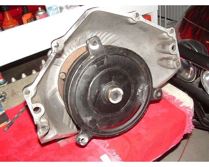

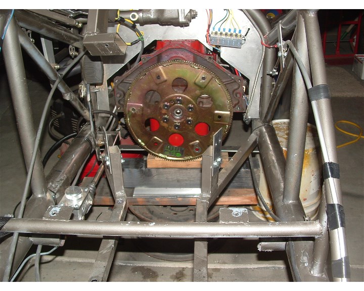

    Got my new larger 168T flexplate and mini starter in place today. For any out there that are going with Chevy motor they used 153T flexplate and the dual pattern does not have a 11 1/2" bolt circle like the 168T has. Also you need to change to a dual straight bolt pattern starter.
    Installed a used race 9" 5500 stall converter that I had from my N/E-2 days. Got the car back together enough to run the motor and see if hot rod would hold 1200 idle RPM with only my hand holding the brake. Dropped it in gear and RPM stayed at 1100-1200 fine. Was able to stop wheel from turning with light brake pressure. So far so good.:D
    Need to get the seat and the rest of the junk back in so I can get in and see how high I can foot brake the converter and stall it up to. Maybe Monday if all goes well.:)

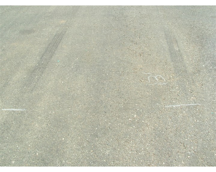

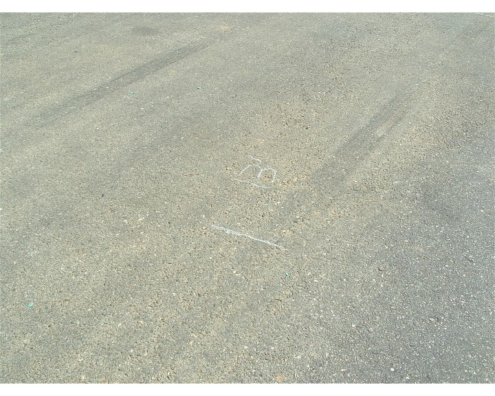

    Well it was a good day as I was able to get in the car (back is a little better) and make a few street test leaves with my used 9" BBC converter installed.:D:);)
    Was able to fire the car in park and it idles at 1300 RPM, drop it into drive and it drops no lower than 1200 RPM with light footbrake pressure. Next I tried to see how high I could footbrake the stall up to, went to about 2200 RPM and that was all I could hold with the small 1 1/2" by 9"" mustang drum brakes. With more braking I am sure I could have stalled it up to 3000-3500 RPM. Very rewarding for a small change.;):)
    With this information I tried two leaves.
    The first was with the RPM at idle 1200 and it left good, no hesitation and spun the tires for 10 feet. Both rubber patches were even so I know the traction lock is working correctly. Not to bad for first time.:eek::D:)
    For the second leave I stalled the car up to 2200 RPM and let it go. Again a nice matched pair patches 13' long. Motor was a little stronger on the leave at 2200 RPM and pulled hard after it got hooked
    up.:D:D:D
    Not to bad for a basic 194 motor with a mild cam and 2 old school 94 carbs that makes maybe 145 HP. This has been a good day.:):):)
    Now on to the track to see what she will do.

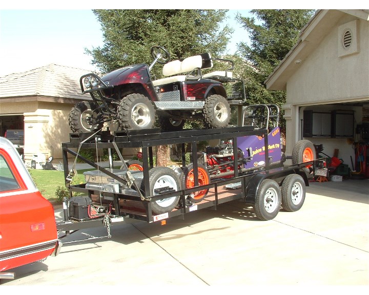

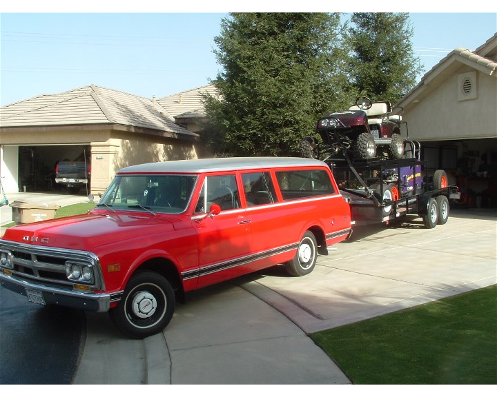

    Well guys & gals It is looking real good for Eagle Field this weekend. Got the dragster and the pit cart all loaded. This is the first time that they have been on the trailer I built last spring and I am real pleased with the way it all came together. :)
    I am going to make 1 or 2 p***es and if the hot rod is good to go then Kay (old6's better half) is going to try it out for a couple of blasts. :D
    I ain't counting my hogs until I am in the pits Friday afternoon and ready to run Sat. Remember I don't have a real good record this year for getting the dragster on the track, maybe this is the weekend.;)
