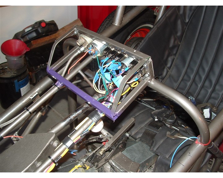

    Well started to take motor apart, head is at machine shop, Will install bigger 1.84/1.60 sbc valves, new stem seals, Good 3 angle valve job and mill .060" off the face. No cash to lump port it this time around. Will start working on the new 257" build in a few days.
    While car was down thought I would see if I could remove existing dash and make some extra room for my leg & knee when getting out of the car. It is much better with about 4" more clearance up to the steering cross bar. May even cut hand holds so I can grab the bar to help get my big --- out of the seat.
    A few pictures of before & after. Should have switch panel and cover done tomorrow. Need to see if my existing cowl cover can be make to work with a notch cut out.

    bobw -- That rattle can will take care of the mistakes. That cowl does not like being mounted a few inches lower as the metal has a set of its own, going do have to make a few modifications on how it attaches to the side panels. I think I will cut hand holes so I can grab the steering cross bar to help pull my old bones up out of the seat.:eek::rolleyes:
    injected27 -- Well the switch panel looks ok on top, but it was more about knee & leg room and I did gain some needed space. I don't know if NHRA Tech will p*** it for a defector, but they never said a thing about not having one before. I sent a PM.

    Rather than mounting the cowl lower, why not mount it at the height that it was before and that will leave room to get your hands in to grip the steering cross bar? Just a thought.

    64 DODGE 440 -- Tom, I tried that and Cowl will still not fasten to the side cover like it was. I am going to try re-shaping the middle cowl section and see if I can make it fit like you said, if not I will roll another cowl. It's only time and I got lots of that and its finally cool so I can be in the garage (shop). :)

    Tom, I hope you can reach the switches with the arm restraints on. I cut hand holds in the cowl but I find it better to grab the top of the steering wheel. The hand holds are too wide.
    The gauges and switches on top of the cowl in their own section looks very cool. Definitely adds a personal touch.

    bobw -- Not a problem reaching the switches with arm restraints, that's the main problem with this ch***is in that ever thing is to close to me. I have a quick connect wheel that I remove to get in and out (don't have to but it makes it a lot easier). Only need one hand hold on left side, it will help a lot. Got medical stuff first of the week so maybe a little more work on Wed.

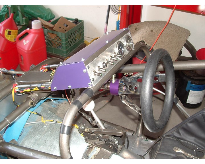

    Got the switch panel in place and rewired, notched the cowl section to fit around the new panel and cut a left side hand hole in it to help pull my
    BIG ;) Old :rolleyes: bones up out of the seat. A little rattle can paint and she looks OK.
    Just got my 194 small chamber head back from the machine shop. Put in some bigger valves (1.84/1.60 sbc) and milled .060 off the face. Because the 194" FT pistons are still .035" in the hole the CR is only 8.60 but the head should flow a little better. Hope to get the motor back togeather in a week or so then start working on a pair of 3 into one 28-32" headers for it.
    Real happy with the extra leg/knee room getting the switches and gauges out of the driver area. We will see how it street tests next month some time.

    Looks real good Tom. The office looks roomier. Have you found 3 into 1 collectors?

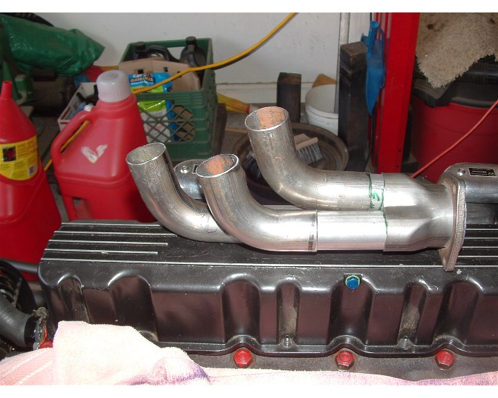

    Well got started on the headers this week. Had to grind out the flanges so they would take a short 1.5" ****** that is inside the 1 5/8" short 90 elbow. Trying to make the parts I have work and not go for some new 1.5" 90's.
    The flanges & 3 in 1 collector are for 1.5 tube and all the other stuff is 1 5/8". May not be the cleanest setup, but it will do the job. Never built a set of regular headers in my life and this may push my lack of build & design expertise to it's limits.;):rolleyes:

    I'm confident you will do just fine. What length are you making the primaries?

    Looks like the primaries will be about 22" with a 10" collector on the end. I would have liked to have primaries a little longer but clearance and space is tight. Even with this setup I know they will work better than the old
    1 1/4" zoomies. ;)
    I'm averaging one primary each work day so I should be done in 6 days, fat chance that will happen, I'm thinking more like 3 weeks.:eek:

    With 194 cubic inches to work don't worry about using 1 1/2" primary pipes. I have done considerable dyno testing on small block shortie headers and on a stock Mustang 5.0 GT V8 the 1 1/2 headers worked best, even better than 1 5/8 or 1 3/4 aftermarket headers. Longer primaries would be better, as you say, but tyou are only going to give up around 5 hp running the "shortie" headers vs optimal length.
