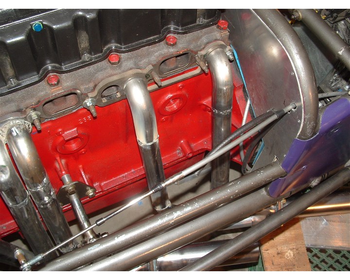

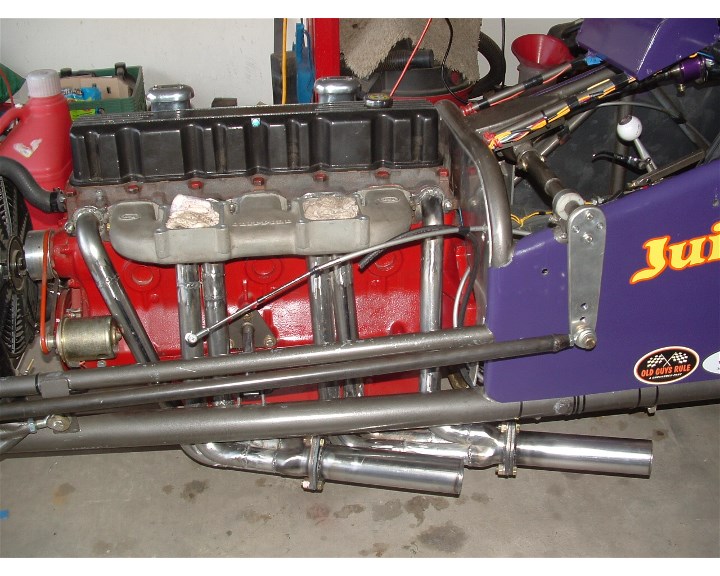

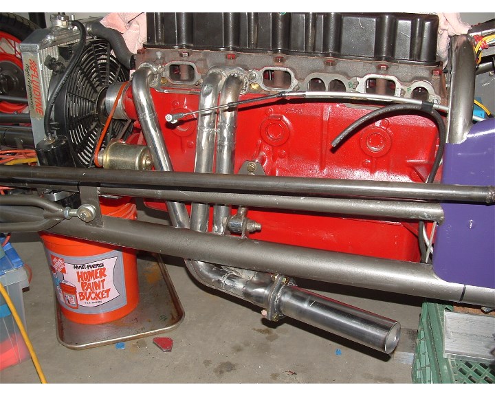

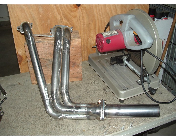

    Well I got the first (1-2-3 cylinder) header together. I like how it fits and looks. Not real happy with the welding but it is solid and a little grinding and header paint will make them acceptably. With Holidays on us it will be January before the other one is done. This year has went by fast.

    Old28, looks like ya got a good start on the headers.

    Tom, that's a very nice header. Santucci says 1.1 times displacement for a healthy street engine.

    Bob, I sent a PM to FRENCHTOWN FLYER and got a reply back from him on a few idea's I had for the motor. I will PM you about his reply. Did you get the PM I sent you a few days ago about the friction shock settings?
    It's a lot easer to get 1 for 1 out of 230/250/292 than it is out of the 194 motor because of piston limitations.
    Thanks for the good word on the first header.

    4x4machinist
    from Missouri
    Nice looking header!!
  7. canadianal
    Joined: May 15, 2012
    Posts: 164
    canadianal
    from canada
    Looks good nice positioning on the car

    4x4machinist -- Thanks for the good word, I am starting to really like them.
    canadi**** -- Thanks Al, I like the header tucked inside the frame rails, but it made for a little shorter primaries. The real nice part of having them inside the frame is that I can now change my steering shaft on the pitman arm without any interference from the old zoomies.

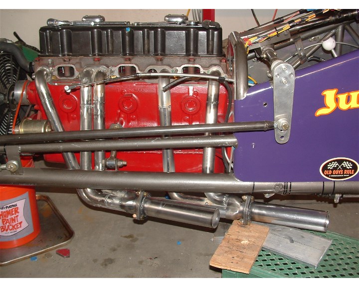

    Got a good afternoon in today and have the second (4-5-6) header about 3/4 done, hope to finish tomorrow.

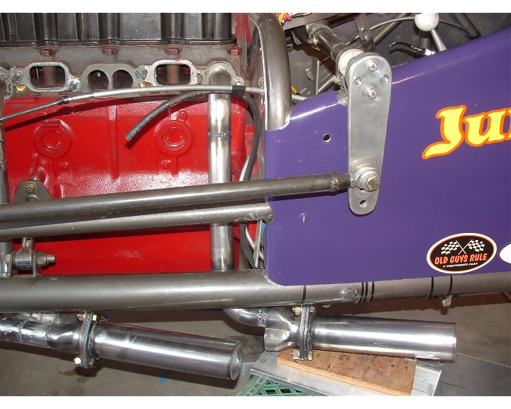

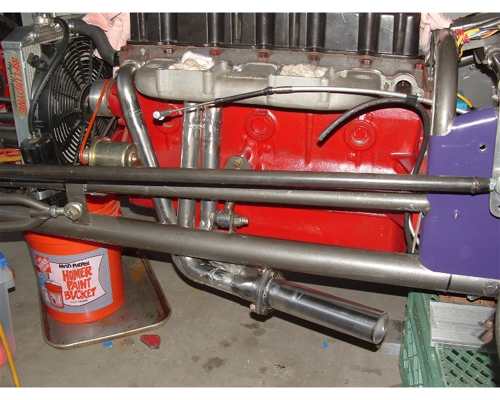

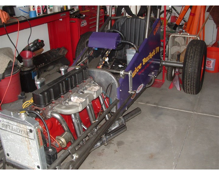

    Well I had a good day and finished the headers. I really like the tucked inside the ch***is look. Welding is so/so, but they are strong, coating covers a lot.
    May be some "Chrome High Temp Powder Coating" or more than likely just VHT 1500 rattle can.:D

    Tom, You've done a great job on the headers. Flux core and all. I've heard it's very difficult to weld with flux core. They do look real racy coming out underneath at that angle.

    Hey Tom we need to hear what she sounds like. I love the look of the pipes tucked in nice and close like that, well done sir. Nigel

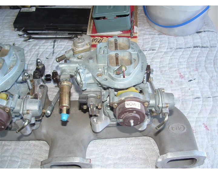

    That intake is just cryin' for a couple of Autolite 1.02 venturii 2Vs. So easy to work on - much nicer than Holleys. Ask Santa for a couple.

    OBFB HA/GR -- Nigel, thanks for the good word on the headers, like you I hope they sound good & add a little power to the small inch 6. Be a few more weeks until it makes noise again.:D

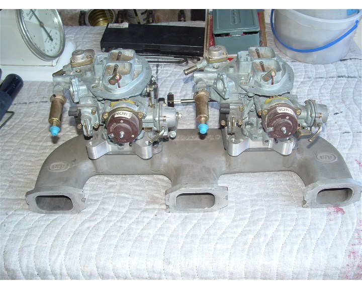

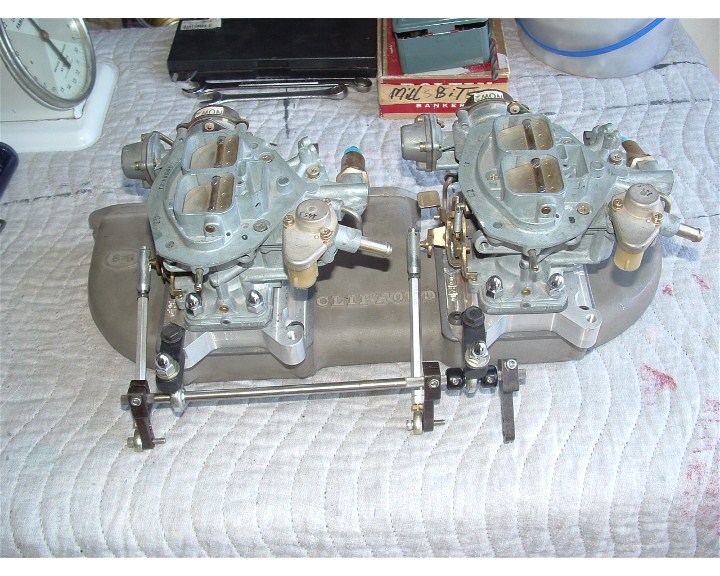

    THE FRENCHTOWN FLYER -- Like Bob I would like a little information on were to find Autolite 1.02 Venturii 2Vs? I have never looked at them before. My next carb move was going to be two new adapters and two more Holley 94 to that intake ( about 620 CFM ). Tell use more about the Autolite carbs please.
    When I purchased the current Clifford Intake it had what I think are dual Holley 6500 2V with the complete linkage. Pictures below. Are these even worth trying? I think they are Holley 5200 or 6500.

  15. THE FRENCHTOWN FLYER
    Joined: Jun 6, 2007
    Posts: 6,092
    from FRENCHTOWN
    Autolite 2Vs were used on many many Ford (and AMC) applications from the late 50s through the late 80s so they are available in junk yards or from aftermarket carb suppliers. They have several advantages:
    -they are available in several venturii sizes - stamped on the outside of every carb
    -they use the standard Holley bolt pattern for mounting
    -they have annular discharge boosters (a Ford 'first' sold to Holley)
    -they are easier to service than Holley 2Vs - the bowl can be accessed for jet changes without draining fuel or disconnecting the fuel line - leak free!
    - they use common Ford jets and power valves - Holley power valves also work
    -they can be had for dirt cheap - $5 or $10 will often get you a rebuildable
    The most common venturi sizes are as follows:
    .98=190 cfm
    1.01=240 cfm
    1.02=245 cfm
    1.08=287 cfm
    1.14=300 cfm
    1.21=351 cfm
    1.23=356 cfm
    1.33=424 cfm

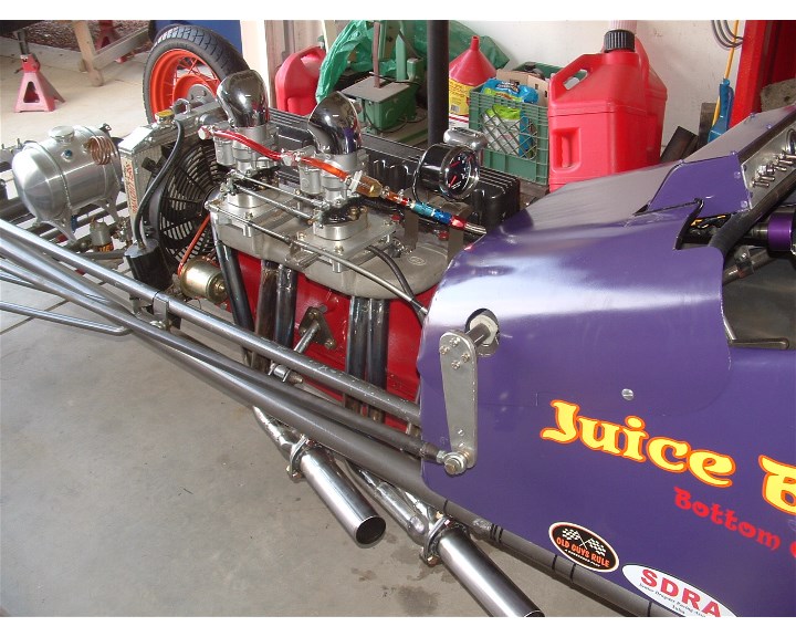

    Well the old Juice Bucket is back together with a new rebuilt head and bigger valves along with a fresh set of home made headers. Fired the car up today, ran fine and the new headers worked and sounded great.
    My wife Dixie shot a video of the motor startup and it is on (YOU TUBE), just Click This http://www.youtube.com/watch?v=pbJf9IYgCHk or put in "SDRA dragster for the coast startup" to see it. I think it works when you click on it.
    Hope to get the car out for a couple street launches this next week. Maybe I can talk Dixie into another Video.:)
    Hope everyone is moving forward on changes and completions as our season is right around the corner. T&T starts end February.:eek:

    sounds good. If you are not finished yet you may want to invest in some plug wire separators or some rerouting of the plug wires. The way it is now with what looks like from the video a couple of wires laying on one other or in close proximity you MAY get some inducted firing from one wire to the other at the wrong time.

    That sounds like a 12/80 103 idle to me L J

    Engine looks great and love the sound of it.Can't wait to hear that lil' Chevy sing on the big end!

    Tom, the car sounds really, really good. It should give you a fun ride.
