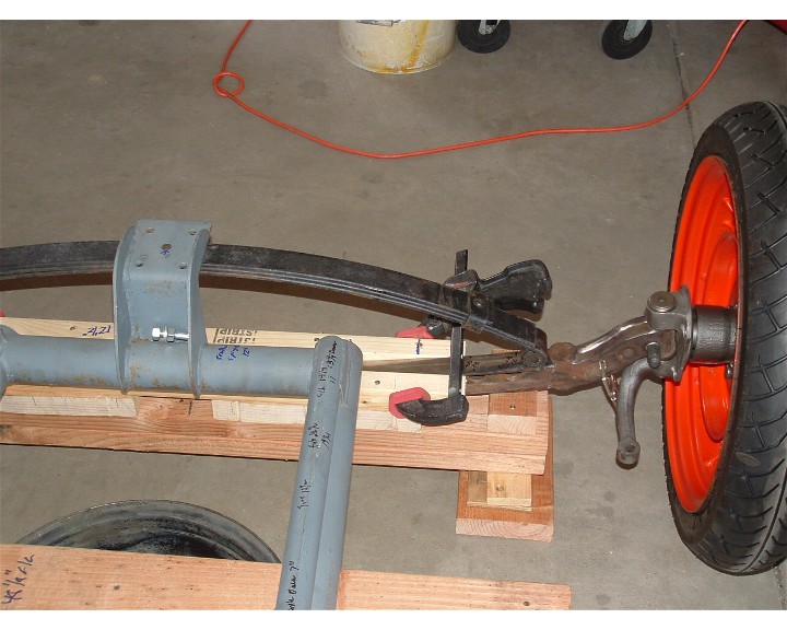

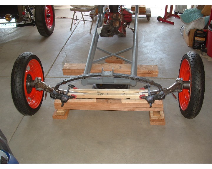

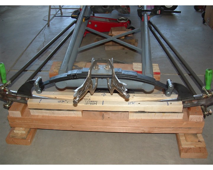

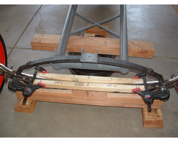

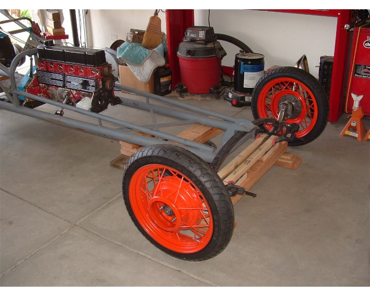

    Well it has finally cooled of a few degrees in the Central Valley and was 86 deg yesterday and seemed cool after two months of 98 + weather here in Bakersfield, CA. I'm sure we are not out of the woods yet, but maybe by Oct 1.
    Got some more done on the front end, Hairpin Axle Brackets, Steering Arm Mounted, Hairpin frame mounting plates tacked, Steering quick connect ready to weld. Working on some braces for the steering shaft support. Hope to get my buddy Danny V to finish weld some stuff first of the week.
    Not a lot to show for a months work, Had to go the Fenton, MI to see my grandkids play football & Soccer for a couple of weeks, they keep me feeling younger the more time I spend with them.:)
    I will just keep moving forward and I will have a roller soon.;)

    Your front end is nicer than mine. Now I have to change mine to catch up.;)
    One thing, make sure the front spring shackles are horizontal (with no load on the spring) when welding the brackets to the axle. With that spacing the shackles should be at a 45 degree angle when the ch***is weight is on it.
    You are doing a great job on your ch***is.:)
  28. Old28
    Joined: Jan 11, 2009
    Posts: 1,390
    Old28
    bobw -- Nice to hear from you again. Thanks for the nice comment, but it will be a cold day in (you know were) when anything I fab up looks better than your build stuff, you are a craftsman, I'm just a driver trying to get a car together and have it look period correct.
    I know what you are saying on the spring angle. With the mounts tacked I removed the wood saddle so the weight would be on the front end with the motor & trans in place and they moved only a few degrees. With the car in the same position I stepped up on the frame about 2' back from the axle to see what my 250# would do and the shackles only moved a few more degrees. My car is 125" wb so I have more wt towards the rear than a lot of these cars. The spring is very stiff and it makes the front suspension more like a sold mount and this is how I wanted it.
    I hope it works like I want, but maybe I should move the brackets out to start/end near a 45 deg angle. What do you think?
